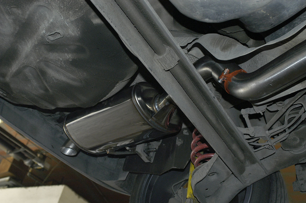

Hi everyone this is just a warning to all who have purchased an Oreca Exhaust to check at the back of the backbox where the centre pipe is welded on, a crack may of appered over time if so ring ktec or where ever you got yours to see if your exhaust is still in warranty.
This is the crack!!!!

I wouldn't of fitted something with that bad welding tbh!
After fitting a BTB at the weekend makes you really appreciate properly made systems additional bracket, split pins etc..
  172 Ph1, Lupo GTI
Really a plate should be welded in that location to join the pipe and backbox as its a weak spot on any exhaust system.
  172 Ph1, Lupo GTI
To my untrained eye it does not look as if the weld is properly penetrating either.
