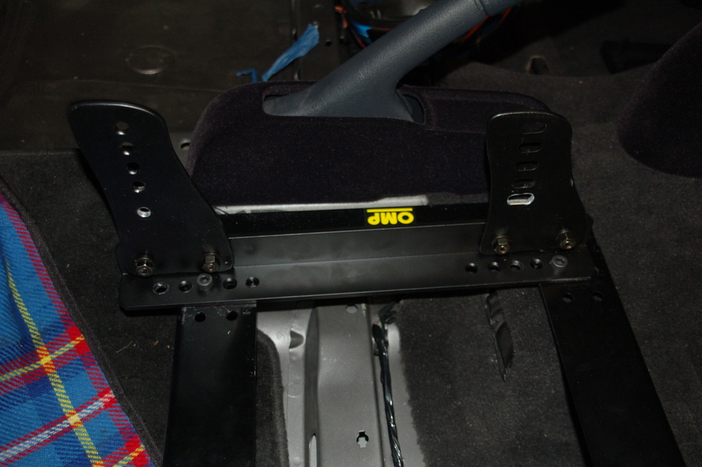

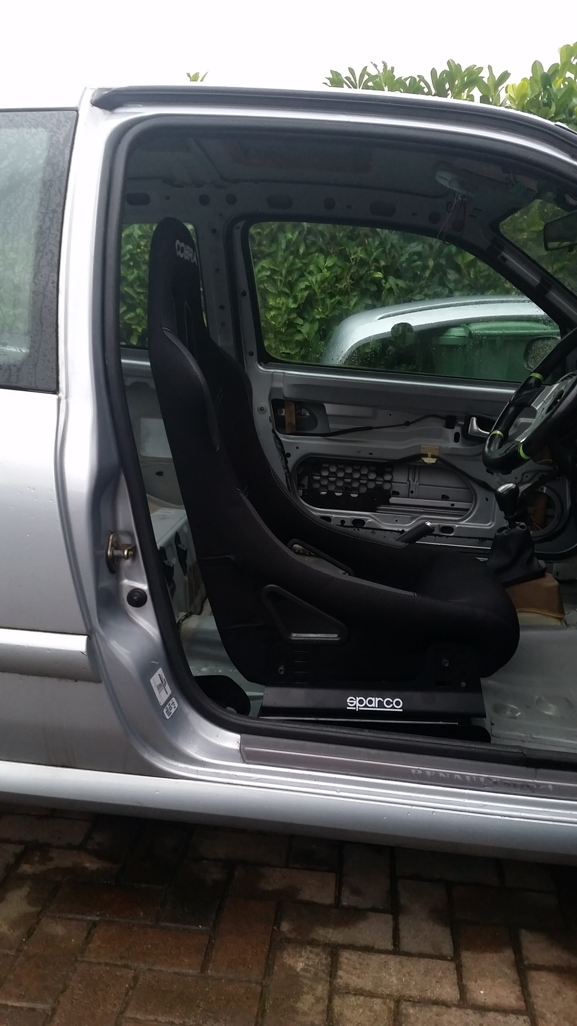

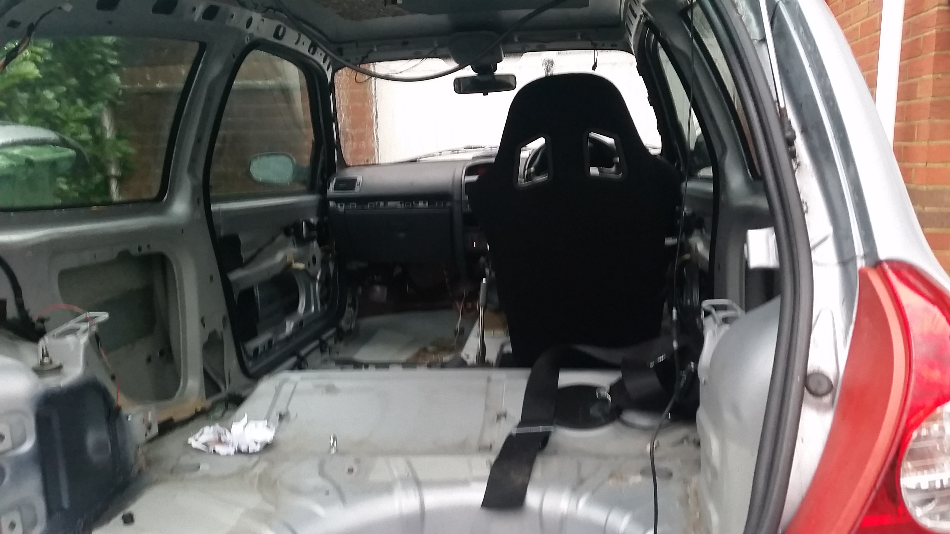

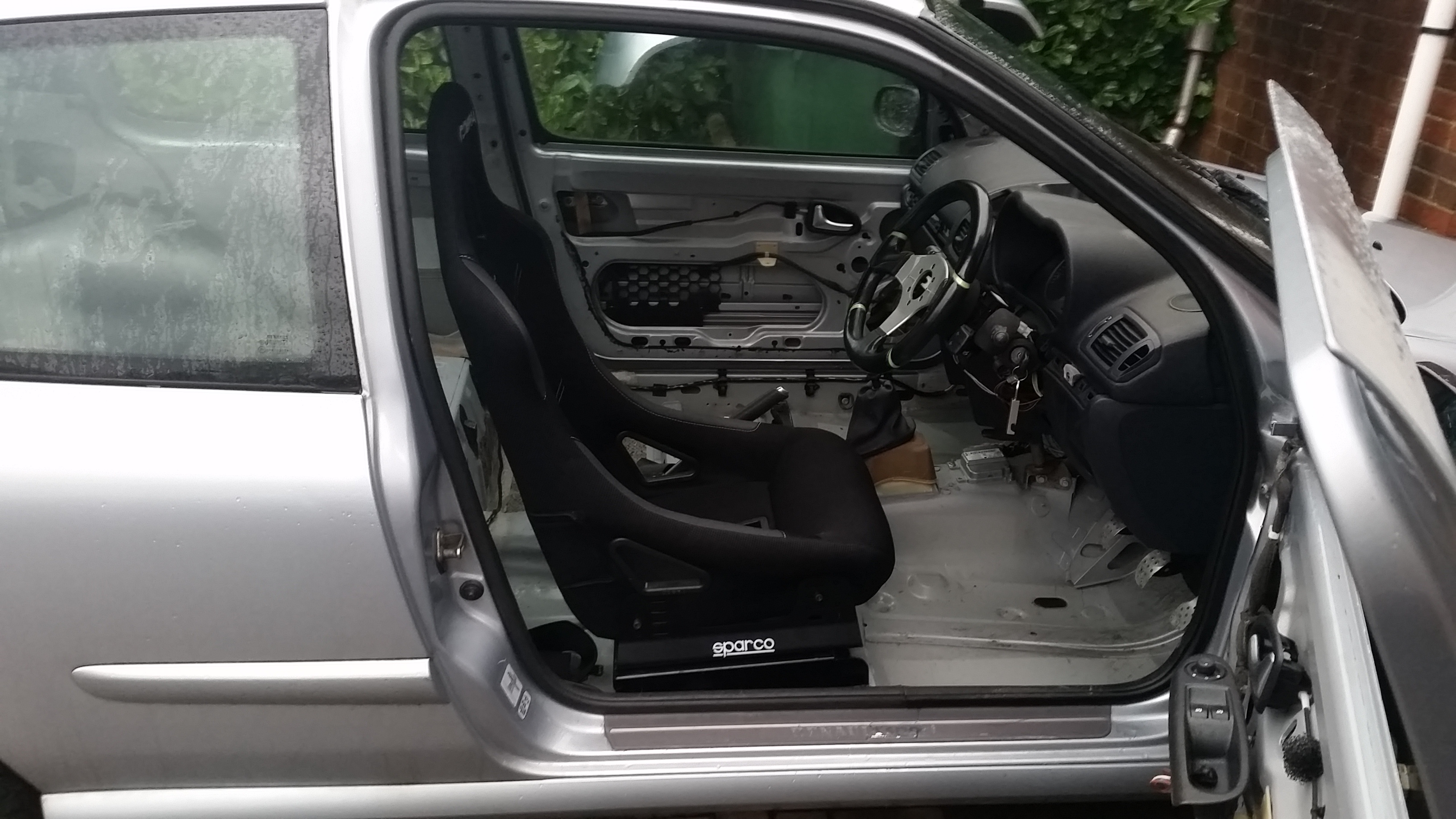

I use one with sparco side mounts and had no issue, will get sone photos later to show seat height
  Clio 172 Merc ML55
Omp subframe, sparco side mounts and plastic renault bits removed from floorpan
Seat is only in temporarily until cage is fitted, can go lower on side mounts as well, for me it's a comfortable position neither too high or low (I am a shorty though)

Looks great , I have now got OMP bases , was thinking of leaving the Renault plastic bits in to give a bit more height, , my missus will drive it now and again and she is a short Arse ....lol this also means I have sliders on the seats for forward and back for the same reason ..

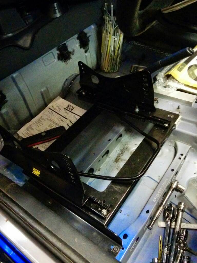

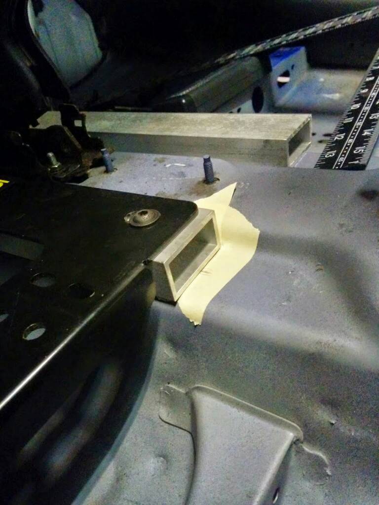

BTW, the omp subframes end up slightly lopsided (can't remember which way possibly inwards), doesn't bother some people, it did bother me. I ended up not using the Renault plastics and using some aluminium box section to act as a spacer bar that ran along the exhaust tunnel, made it perfectly level. BTW, make sure you use high strength bolts.

That spacer looks a good 1" thick , are they really that far off level as that would bother me for sure

I was going to say no but having looked at it again it's more evident than first appeared
This is mine, couldn't get a beeter photo as the mrs car was sat in front and I was too lazy to move it first.

eon172 could you let me know how thick the alloy bar you used is ... looks like I will be needing some !!!!!
