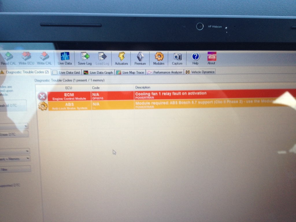

Hi my oil and stop lights keep coming together intermittently. Is seem more like a wiring/sensor problem rather than an actual oil pressure problem. I put the rs tuner on to see if there were any fault codes coming up- this is what showed
Any ideas

personally don't trust rs tuner as diagnostic, twice not brought up faults on cars with management lights on!!
