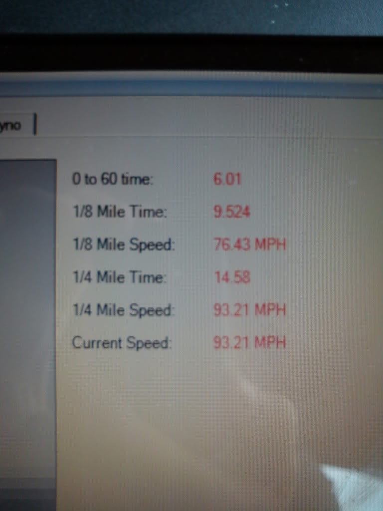

I had a little with play with my laptop/OBD reader last night and was just wandering how accurate they are when timing 0-60 and 1/4 mile sprints. My car is a standard 2004 172 and all the times i recorded (about 5-6 runs)were under 6.7secs, but the best are on the pic below. Are these good, bad or average? ..........And NO! I am not a chav! I just tried it out of interest to see what it could do

Software used is called Digimoto. I know the book speed is 7 seconds, so how accurate is this likely to be? i would have thought it was correct if its reading from the cars ECU. the worst time did was 6.9 with the esp on and which gave a bad clutch burning smell afterwards, i assume it was the clutch anyway.
And yes it was on old airfield by the way

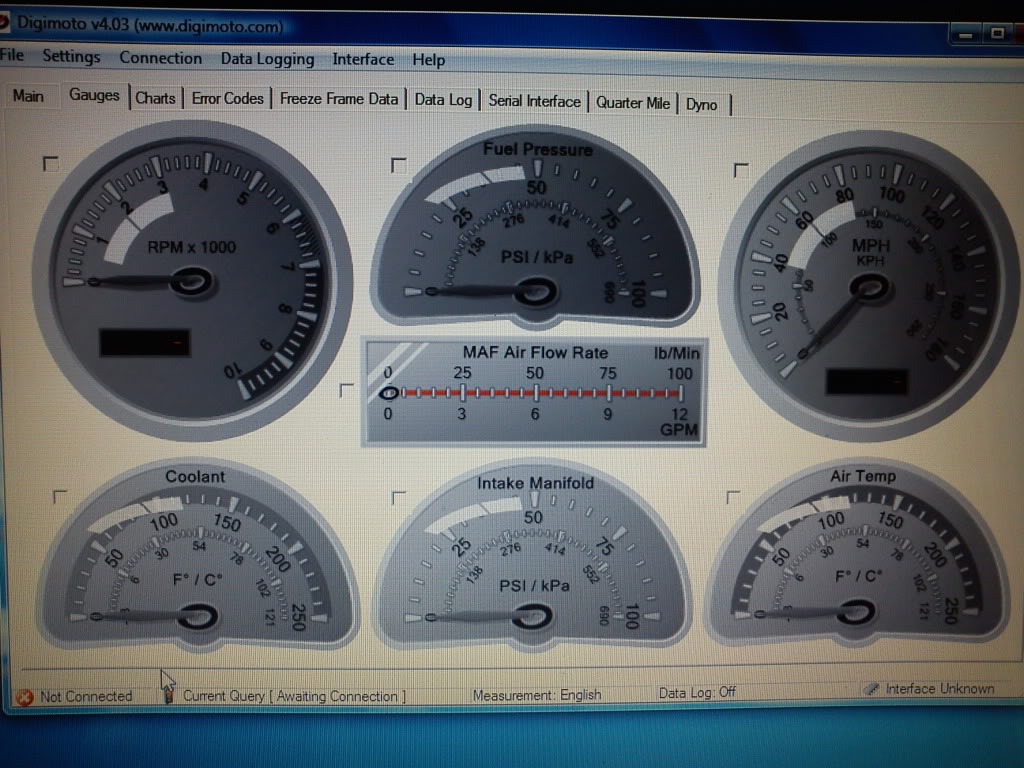

Same question here please? and what ODB reader did you use?
ODB reader is an ELM-327 USB

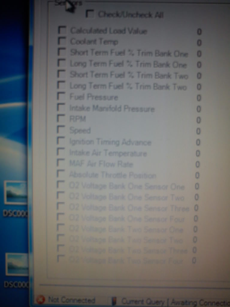

not very good pics but just took these of my laptop screen
obviously reads and or resets faults and turns off warning lights

This kind of thing is to be taken with a pinch of salt as it uses the cars own systems for measuring distance Vs speed/load to roughly work it out. They are pretty good if you do it on a long flat stretch but try cheating it firstly by going up a decent % incline and then again only coming down it and then see how different the results are.

Basically they're not very accurate at all. Theres a couple of problems, first is refresh rate. The OBD speed runs at 3-4hz so you have 0.5 seconds error already (starting and stopping). Some programs also use the gps which on a phone will refresh at 1hz or you can use a seperate adaptor than can run at 5 hz.
When I plotted a graph of gps speed Vs OBD speed I got a large difference on acceleration but no difference at constant speed, I'm not quite sure what was going on, wheel slip maybe.
My best recorded 0-60 time is 5.5 secs which was part of a 1/4 mile run that had a 99mph terminal speed, both of which aren't possible.

Yeah the reasons for error sound about right tbh... I got a 0-60 of 5.39 and a 1/4 mile of 14.2 @ 98mph properly times at York so the actually times/speeds are about right if a little too high for a std car
