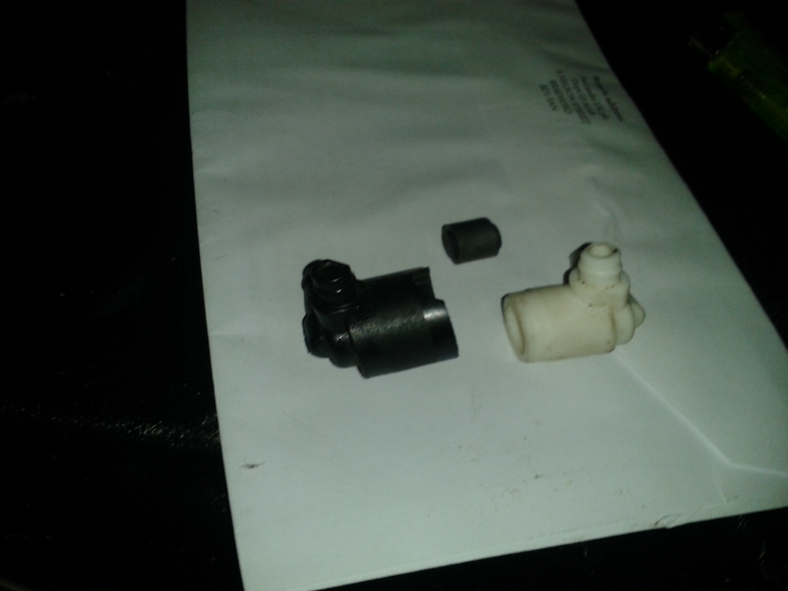

Probably the pump, there's a seal inside that swells over time and they leak internally so the impeller can't produce the pressure needed to pump the fluid.
My bladder has an internal leak.
The piston can swell, and remain seized at one end, but liquid will emerge somewhere unless the pipes or jets are blocked.

As @STEVE.M mentions, often its the valve that sticks and causes these issues. I went one step further than normal for the headlight washers and removed the valve completely. Although they now get a double spray its one less thing to worry about.
Also most of the aftermarket pumps are pretty s**t. Best to trim down the rubber seal and keep the original.
