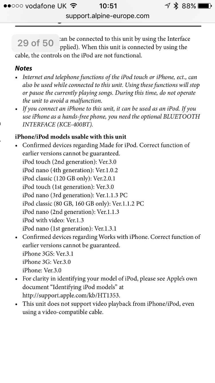

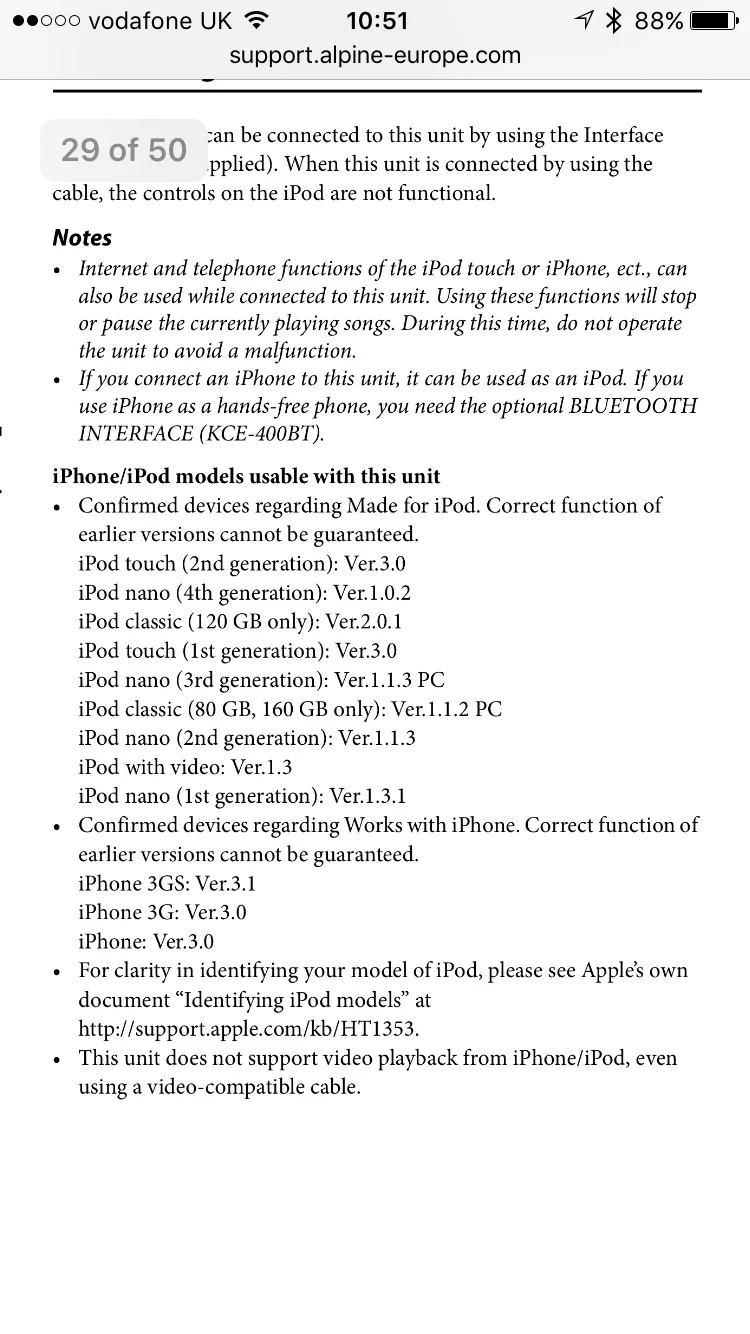

Quick google ;) - possibly not compatible? - im presuming this hu is not a new line?
Louis
I Park Like a C**t
Quick google :wink: - possibly not compatible? - im presuming this hu is not a new line?
If you didnt do such a quick read (;)) of the thread you'll have seen it was working for years prior
