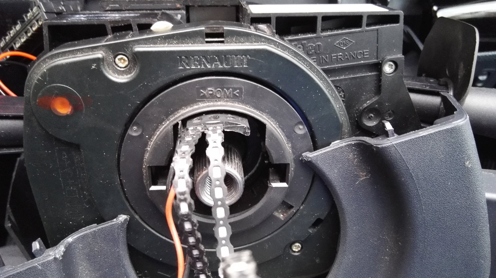

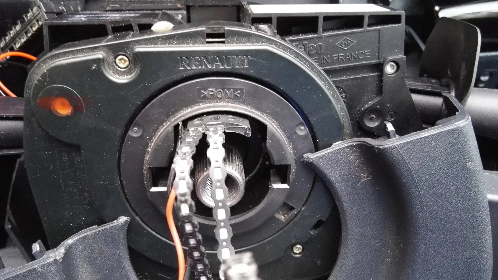

Hi! Recently I bought a car with not working cruise control, today I menage to take off airbag and there's no plug in car loom... Where it should be? Is it same like to airbag, with that plastic coating or whatever it is? Where it should go? And where I can look for it/retro fit it? Thanks

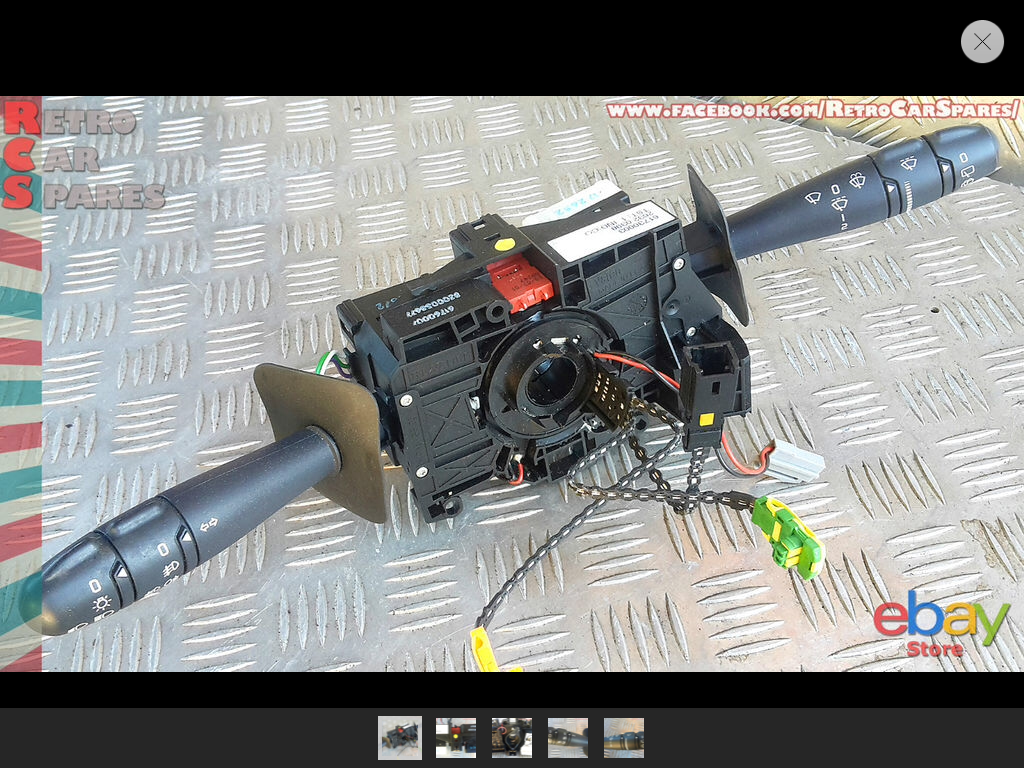

Cruise control wire has been snapped cut off - it's should be next to the other 2 black thick plastic coated wires.
And yes you need a new squib with all 4 wires attached.
