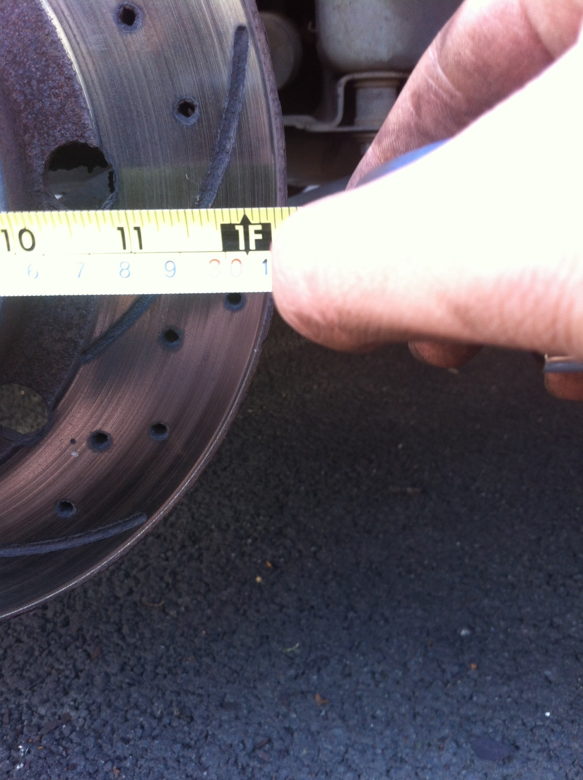

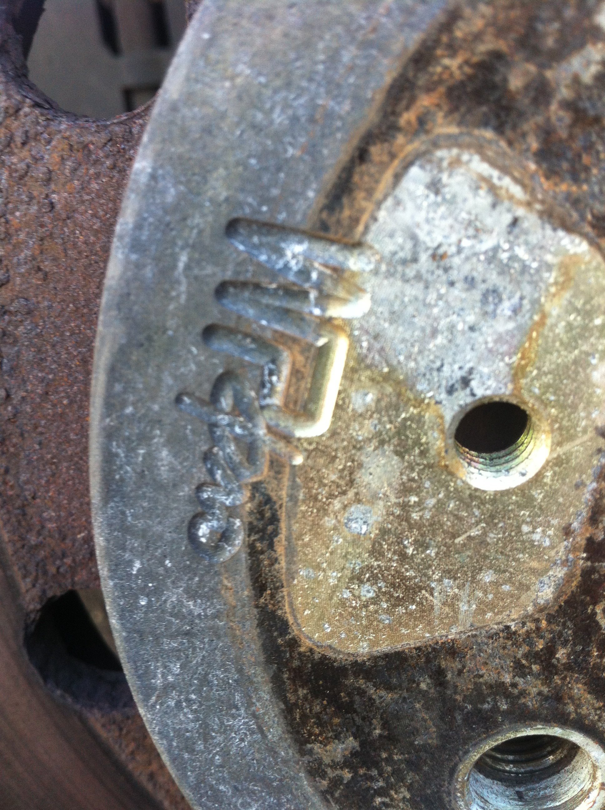

So ive come to change the pads and discs but im confused to the set up. they look like a standard caliper but i ran a tape across the disc and they appear to be a 310mm disc. Reading on here standard discs are 280mm? From what i can see there are no spacers etc to push the standard caliper out to accomodate the larger disc.
This is probably a stupid question but here it is anyway, is it possible to put a 310mm disc in a standard set up (i wouldnt think it is) and can i simply put back a 280mm disc (i would have thought it was to small).

from what i can see, currently on the car is:
WP Pro 310mm discs

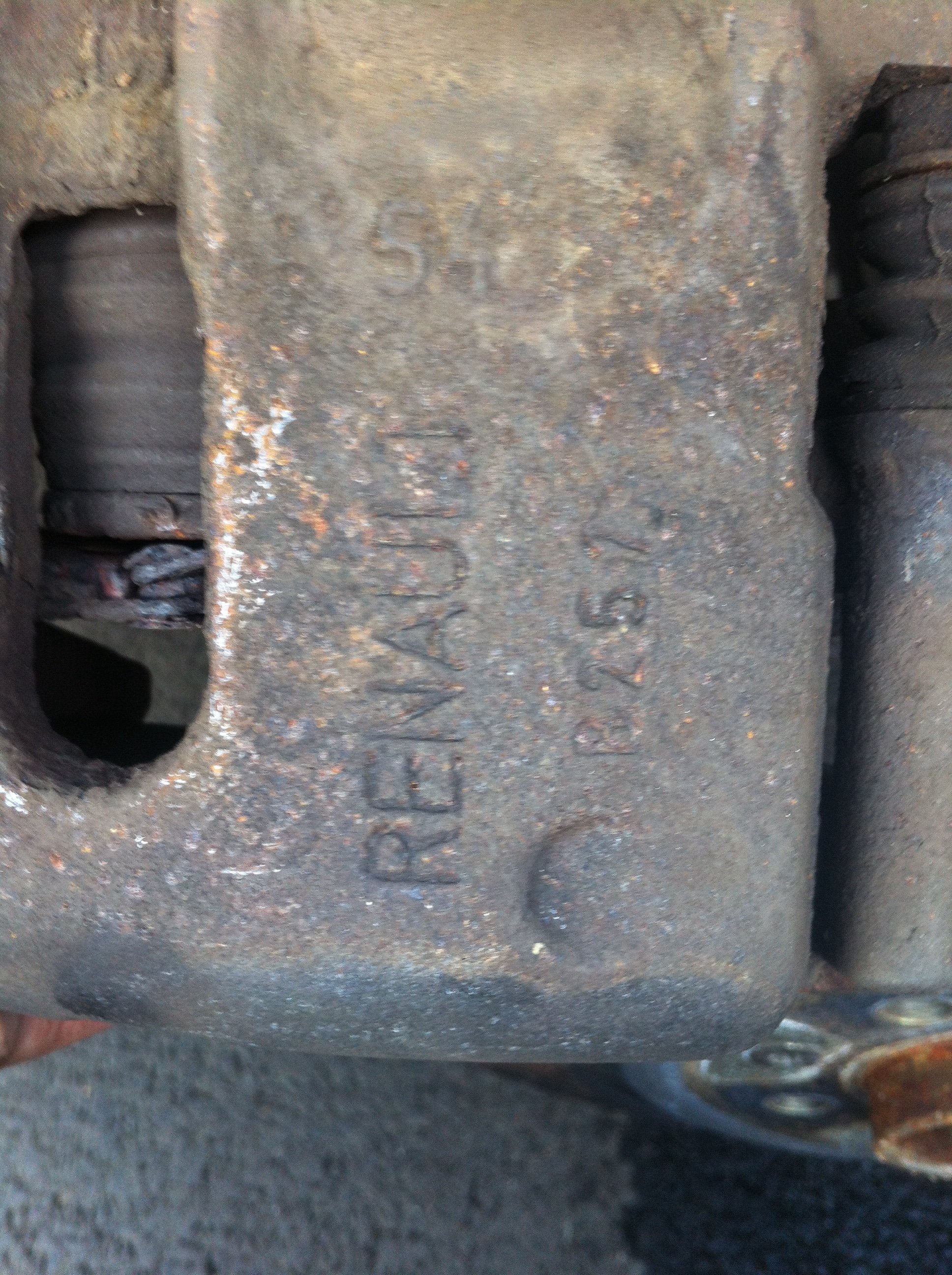

Renault B257 54 Calipers
is the caliper a standard 172 caliper?
can i put on a 280mm disc?
i have no issues putting another set of WP Pro`s on but not sure where is best to buy
Please be nice im no mechanic but have no problem using a spanner.

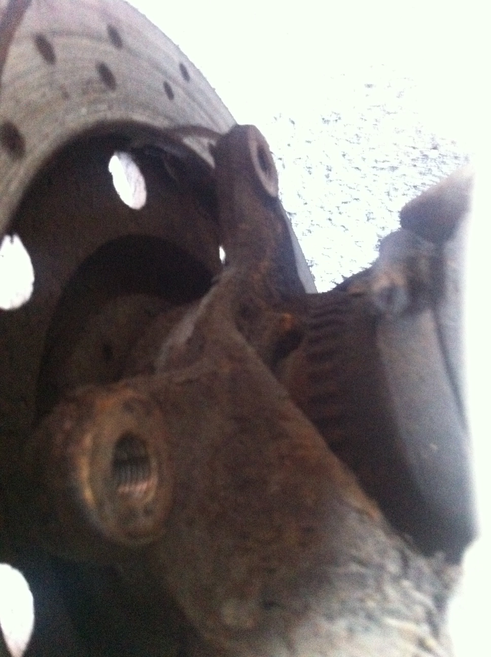

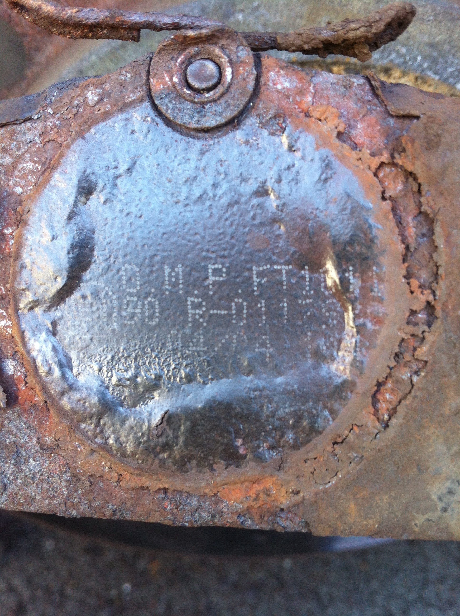

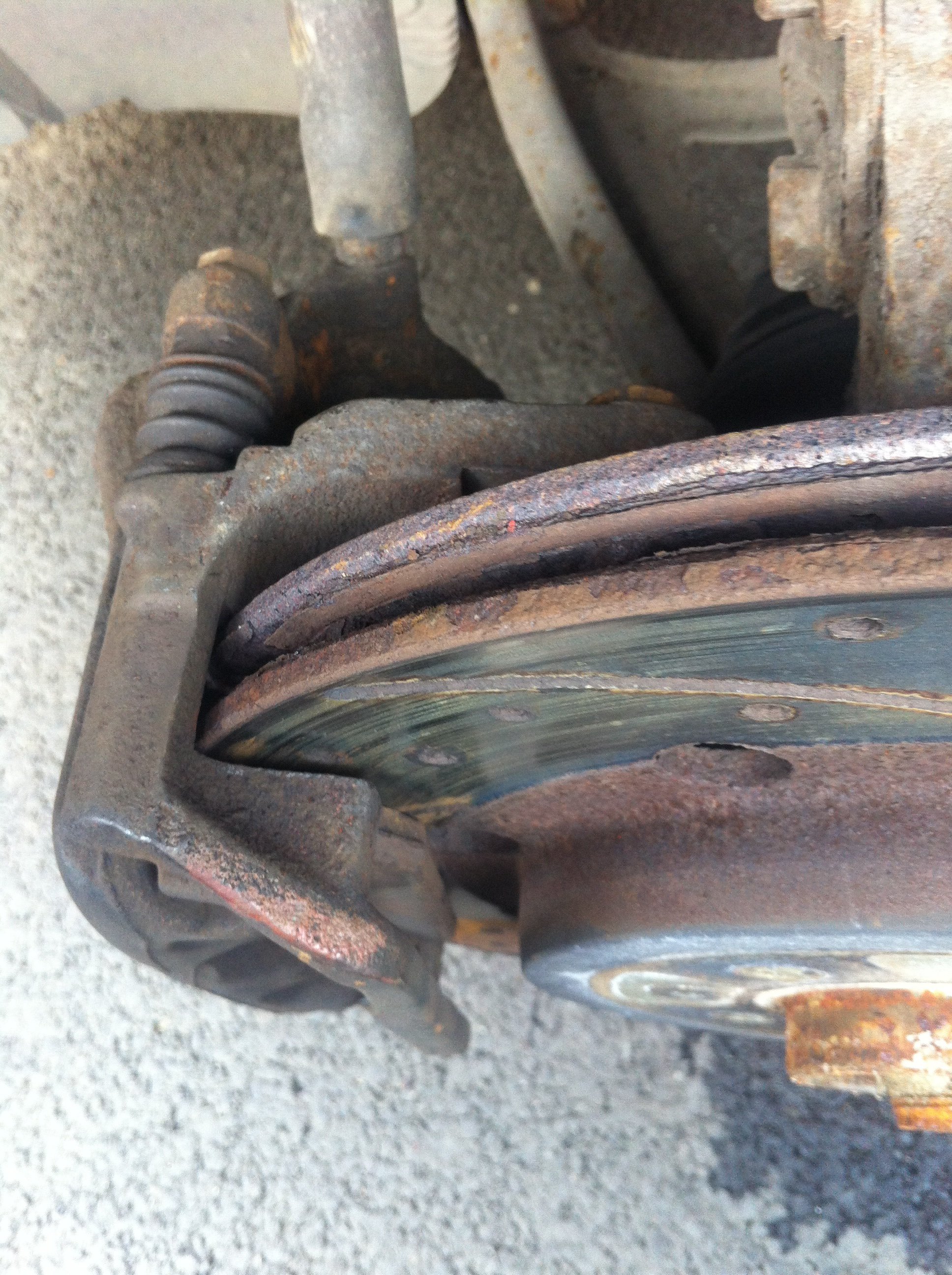

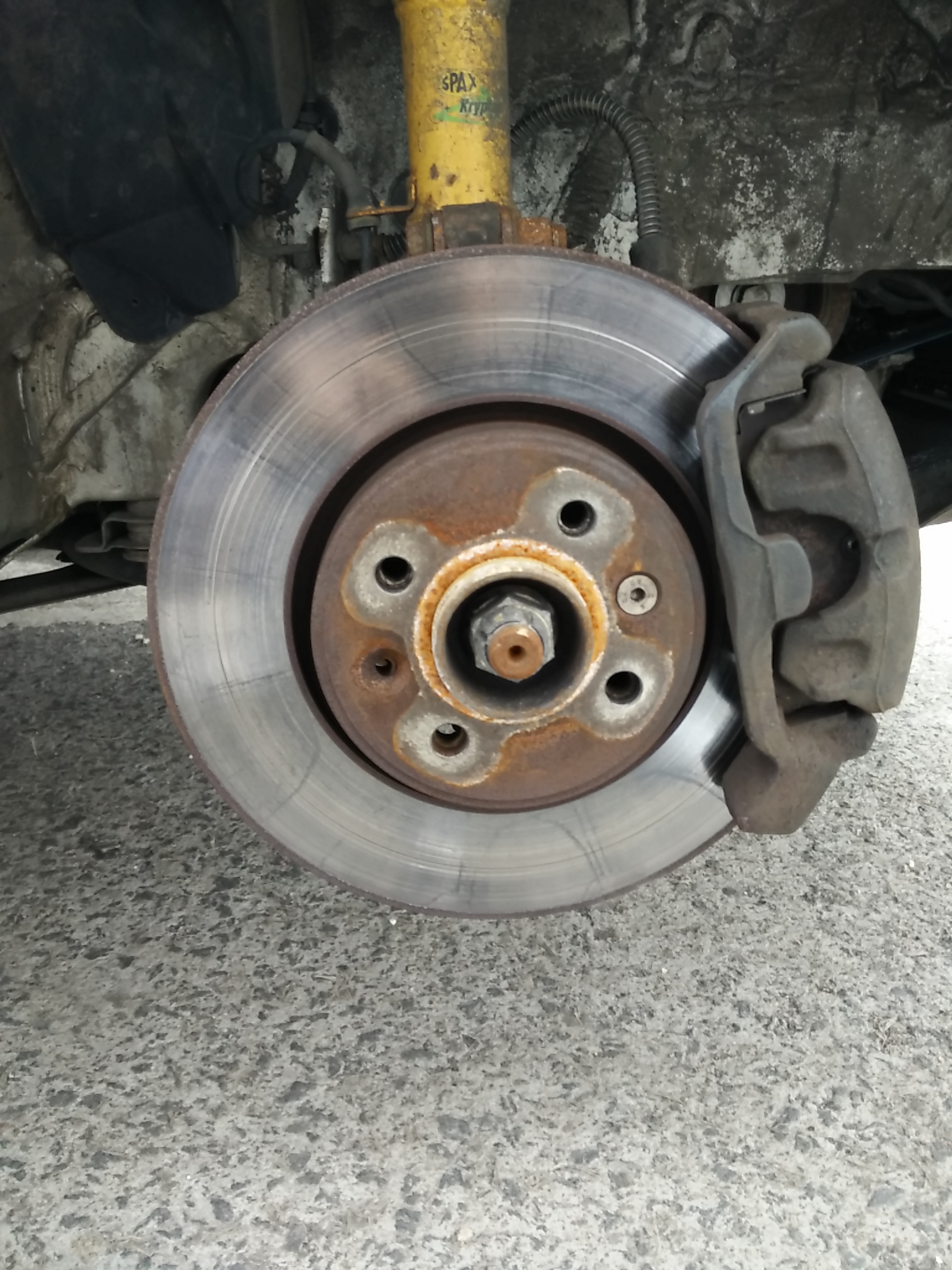

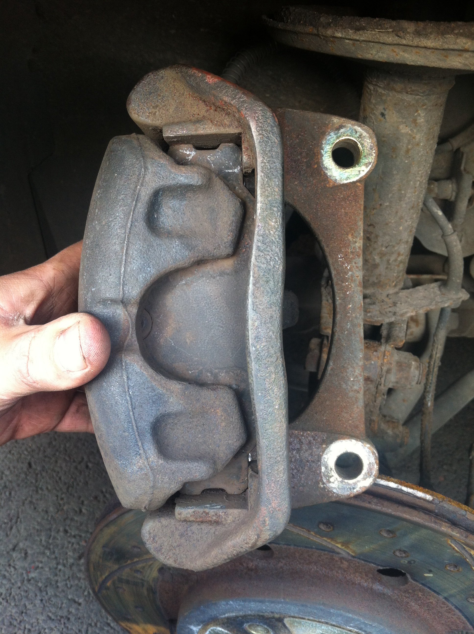

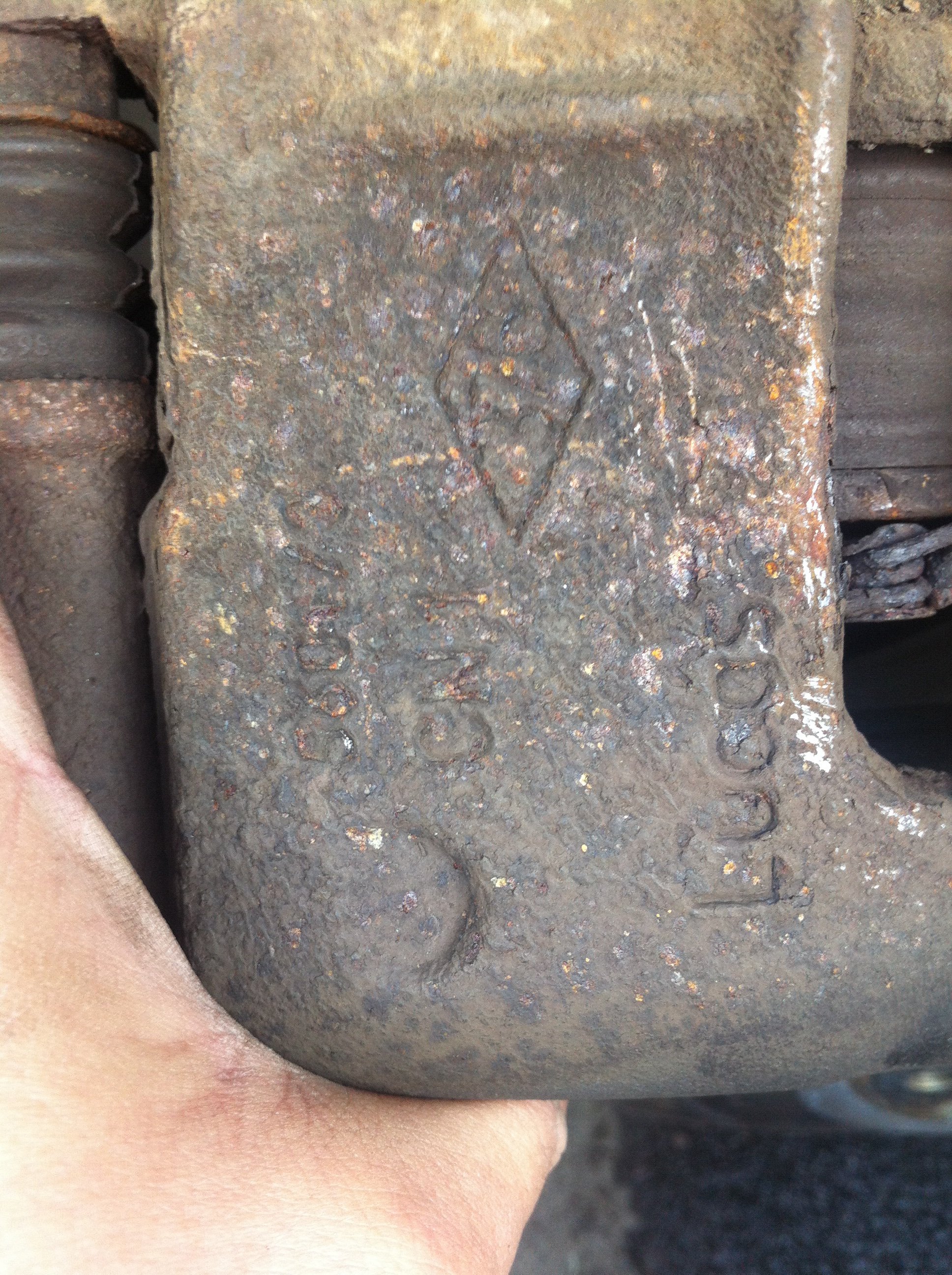

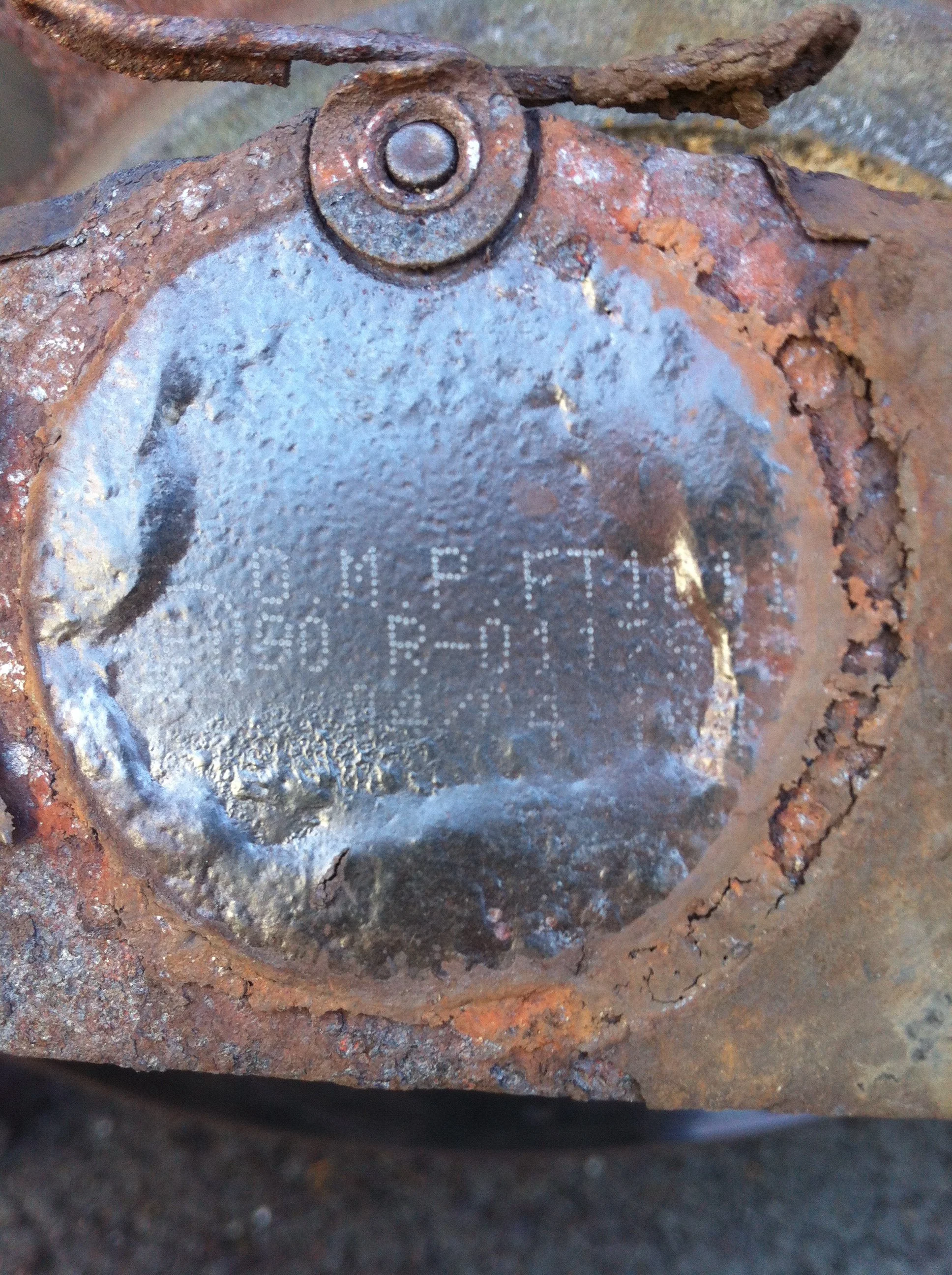

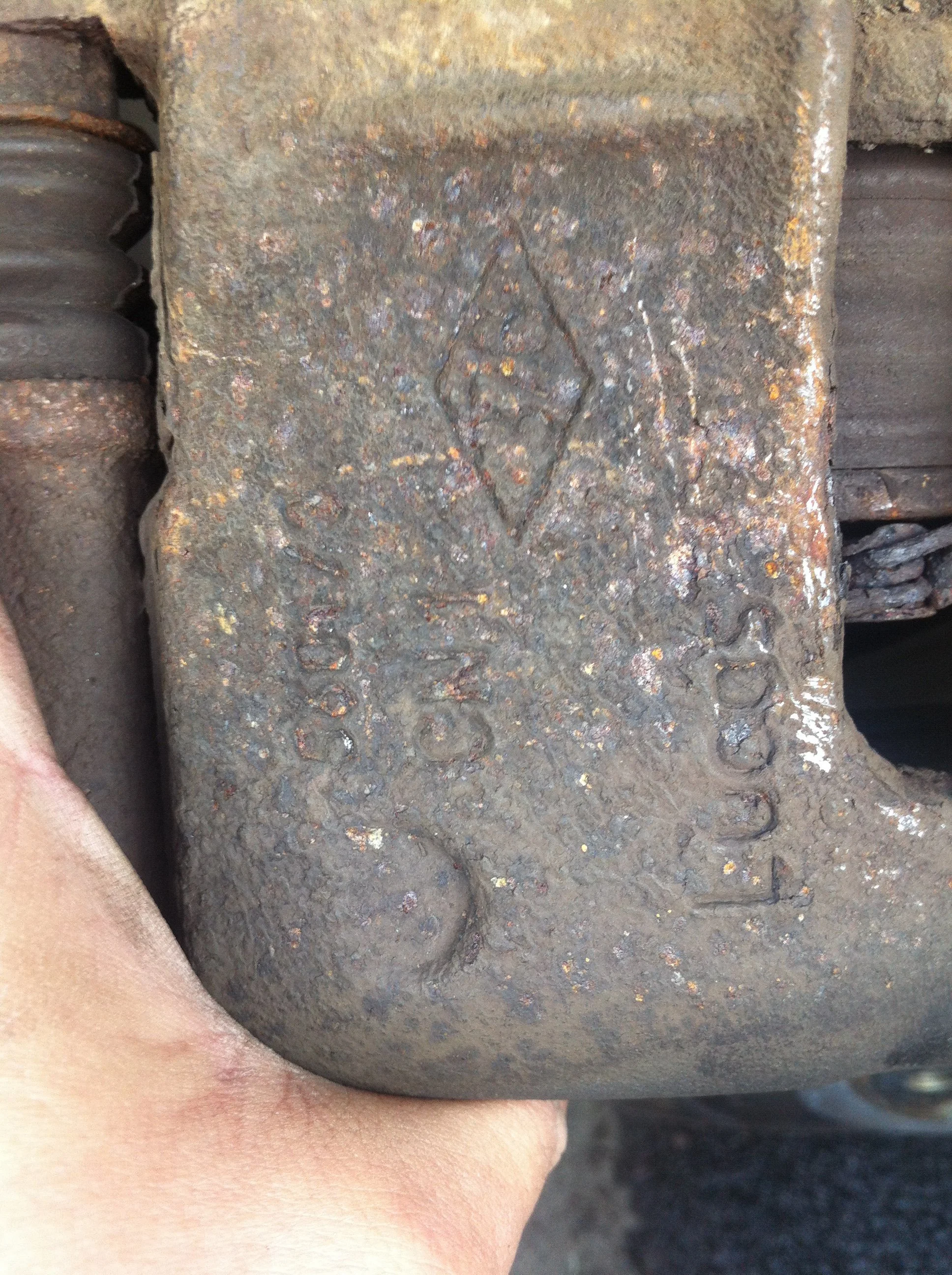

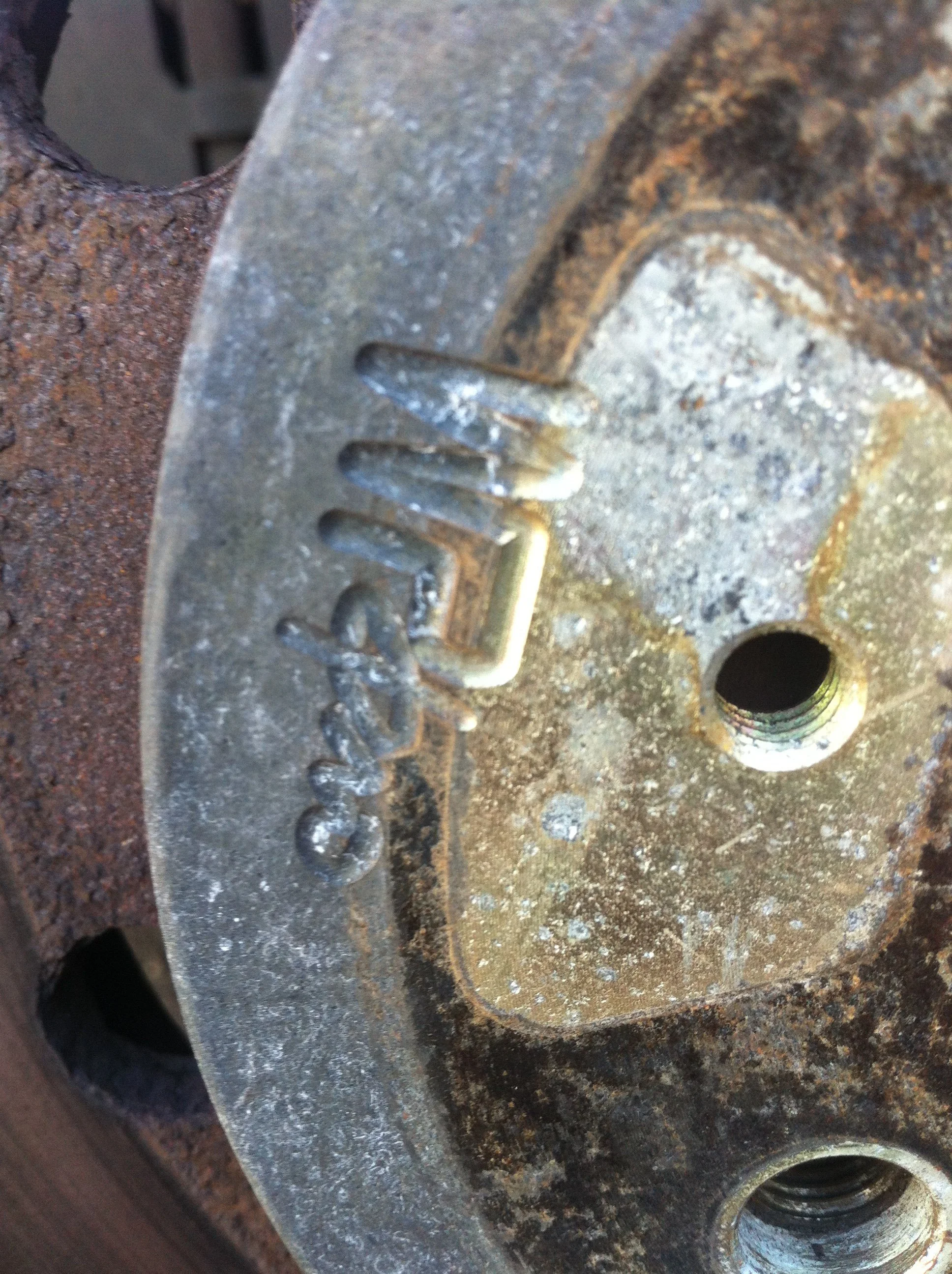

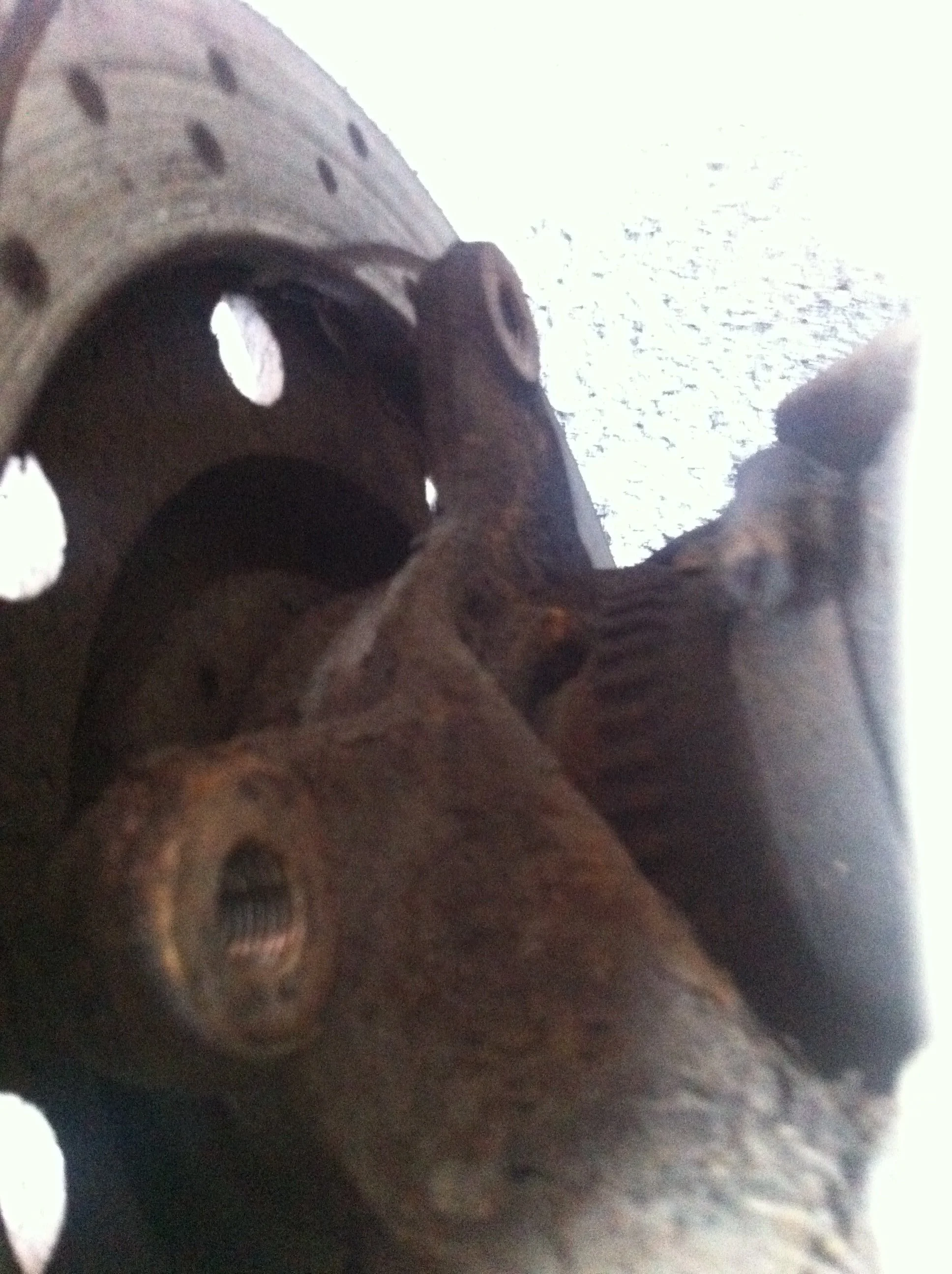

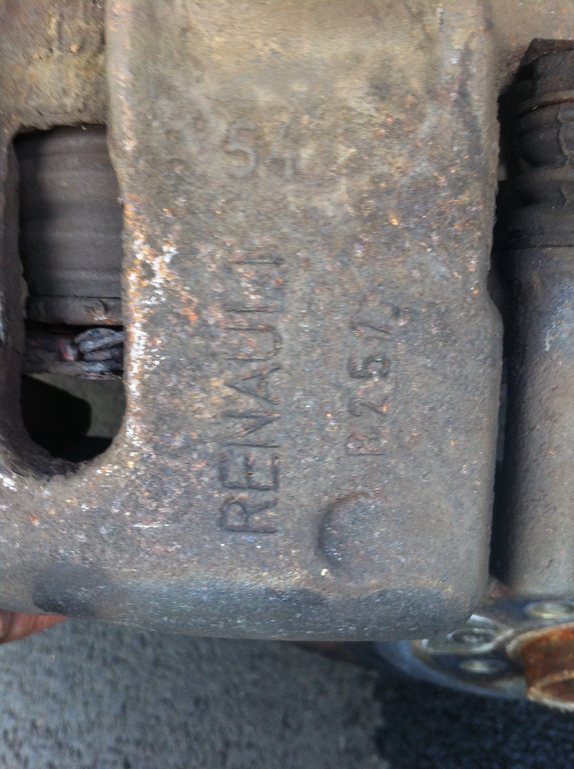

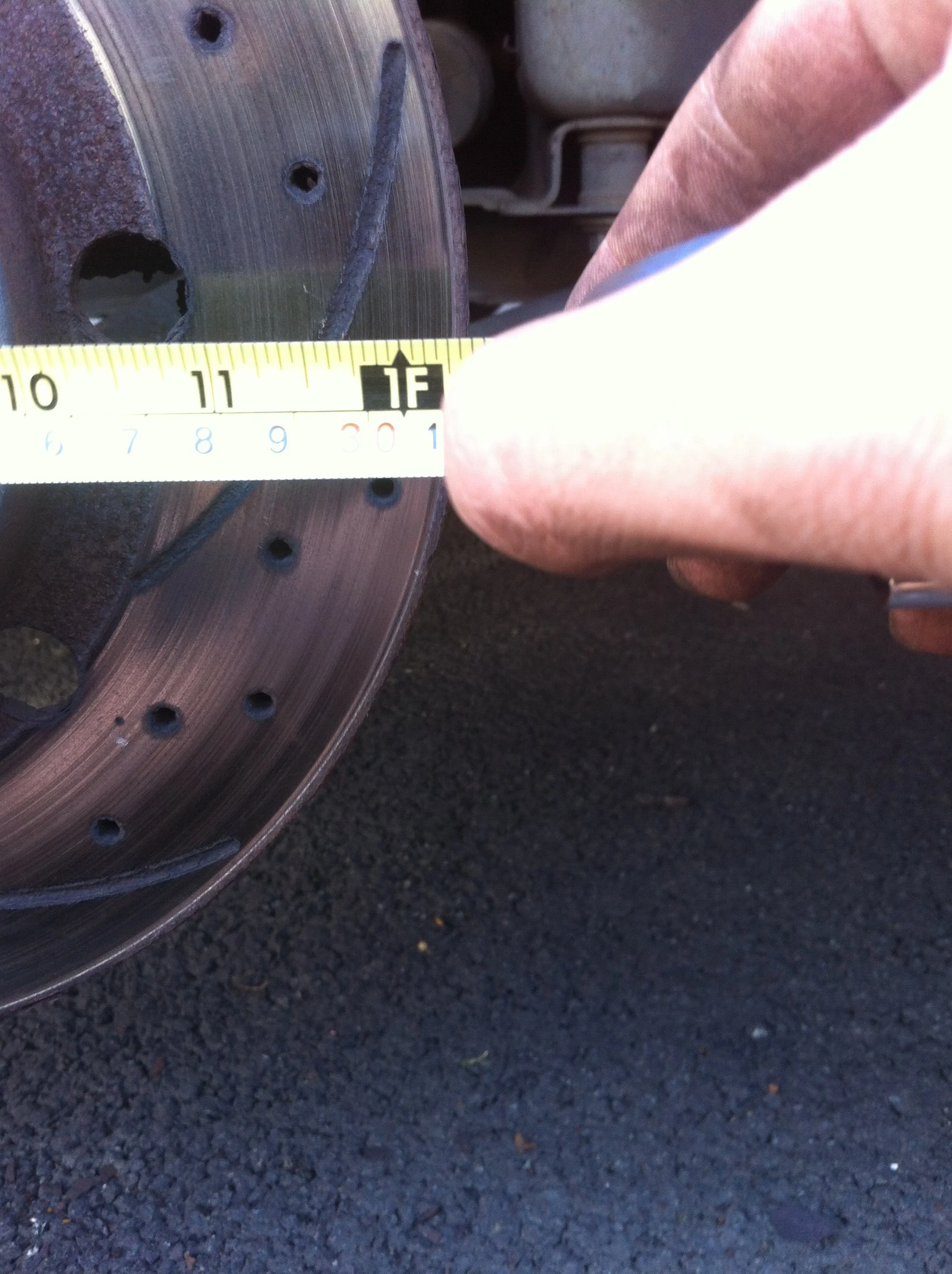

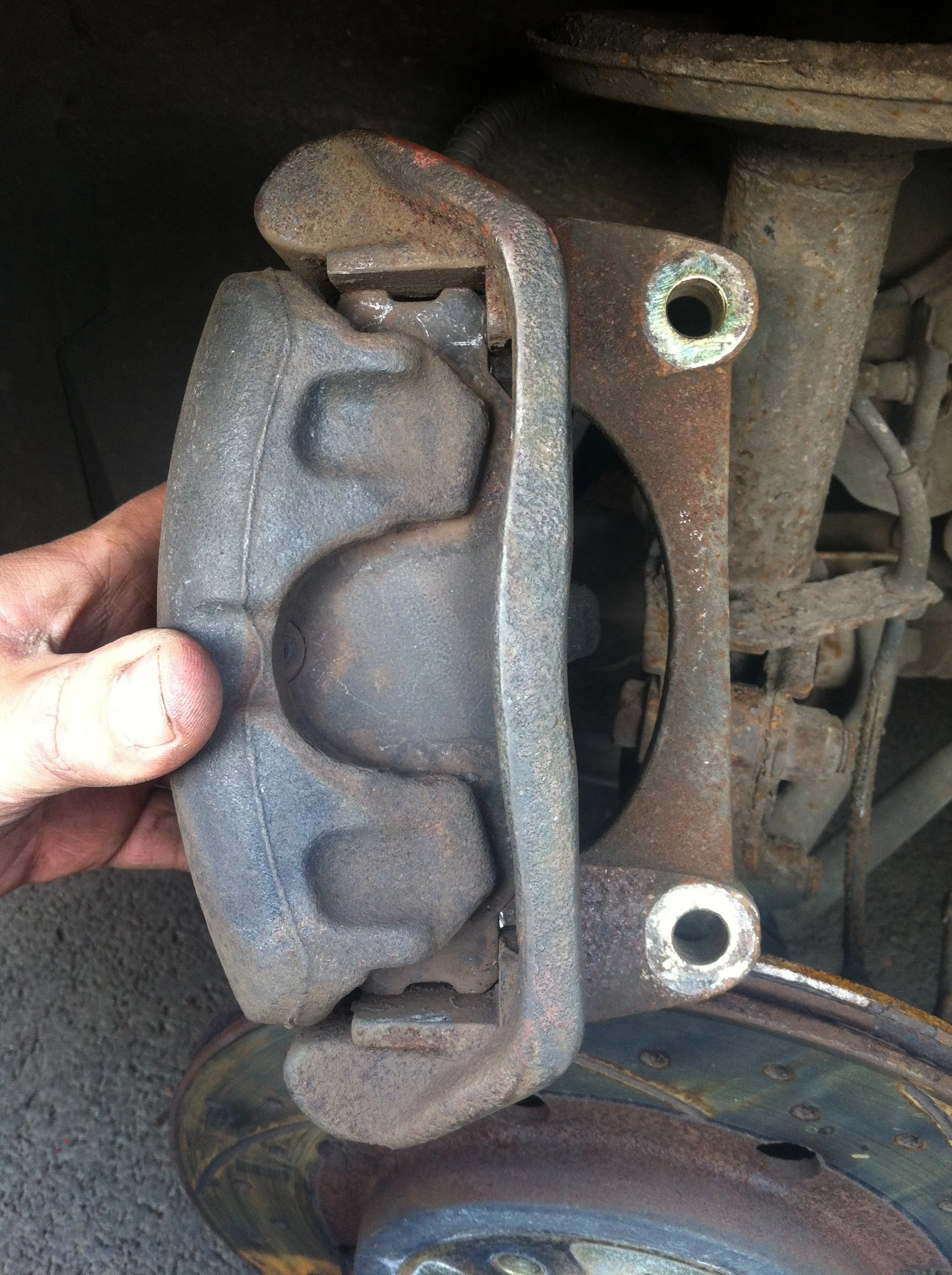

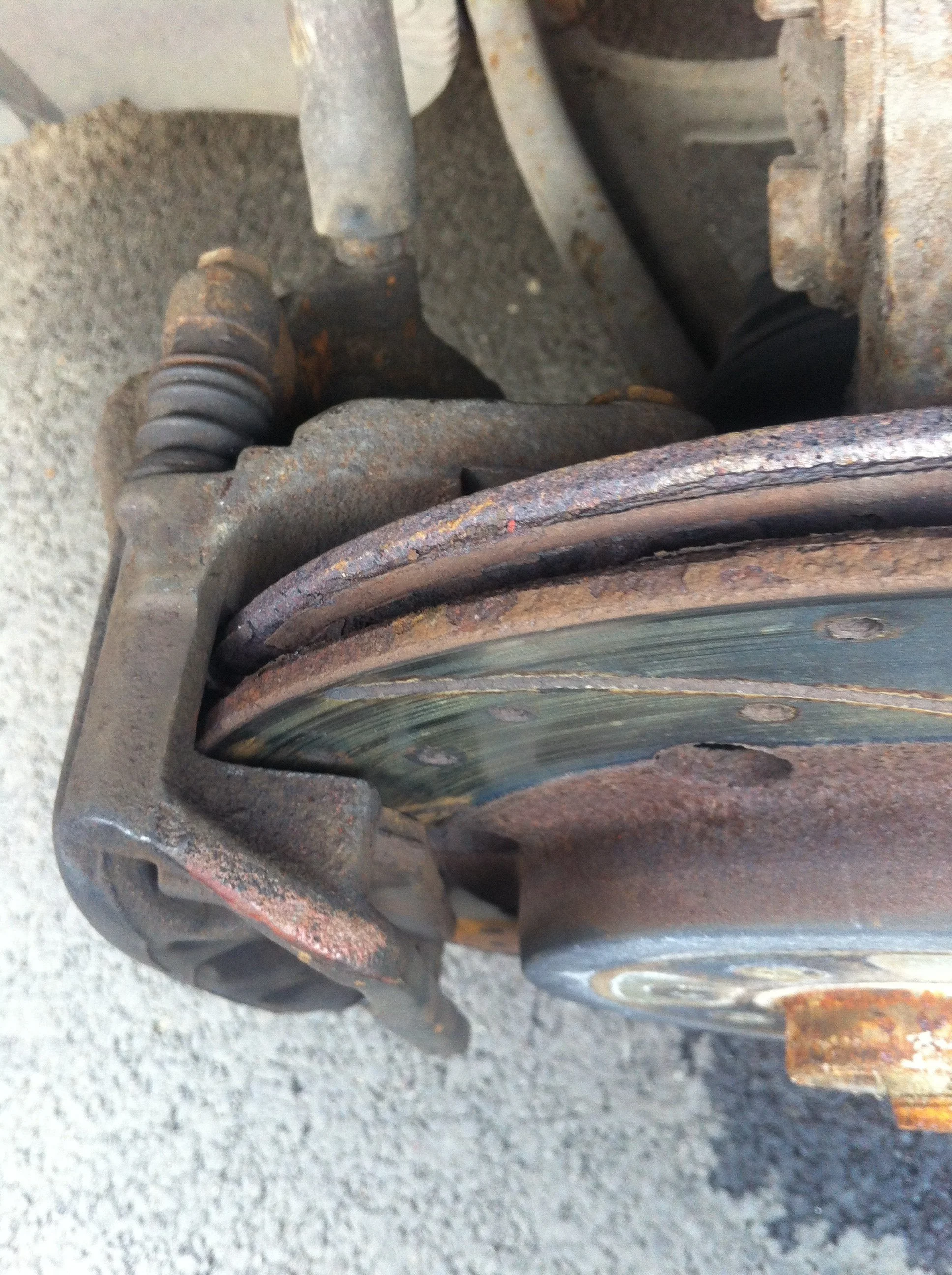

Some pictures attached of what's in the car at the moment like I say they are pretty messed up.
Any help is greatly appreciated
Thanks
Dave

The caliper itself looks standard but the carriers look different to me. Its as if someone's used a carrier for a larger setup to mount the caliper out further and accommodate the bigger disc if that makes sense.
This is how it looks on my ph1 172 and I'm 99% sure the setup is the same across all 172/182's
  Clio 172 Sport
Thanks, I see what you mean they do look different. Are the standard carriers easy/cheap to get hold of? eBay?
