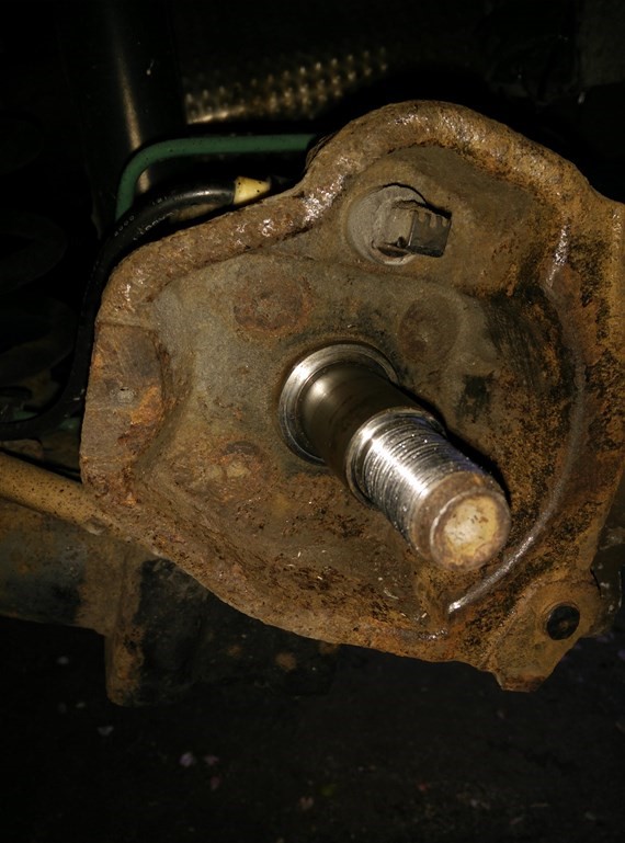

Bought Mintex MDC1997 via eBay och fitted them today.
But when I torque the 30mm washer att 175nm it is possible to wiggle everything.
As I can se the spacer is in place and it just seems very odd.
Is there anyone who have had this problem before?
Would like to get the car running this evening.
Going out to take things apart again and look at it.
cheers
  Clio mk2 ph1 2.0 16v
So, I put things apart again and looked a bit. Mesured the old one and the new one. There is no differens between the two.
So with this in mind (http://www.cliosport.net/forum/show...cer-that-go-behind-rear-discs-on-Clio-172-182 ) I looked to see if that could be the problem.
Is it misssing? Or is it the thingy in the bottom?
I can't move the thing in the bottom so I guess that I am missing the spacer.
Looked at the two discs and there is absolutley nothing I can see that isn't the same.
If they are missing I would like to know real quick so I can get them (hopefully) tomorrow.

Yep they're missing and glad my thread came in useful
If you can't find them locally to you , I always stock them and can post them out to you
Yeah. I say your thread and that was what guided me towards this.
Impressivly(?) this havet been working for a wile.
The brakes are a couple of Yeats old, at least one year and probably 2-3. But the old bearings is really bad.
Shipping to Sweden takes about one week and if it takes longer for them to get it here I will PM you.

They come in singles so you'll need to order two. Part number is in my thread
