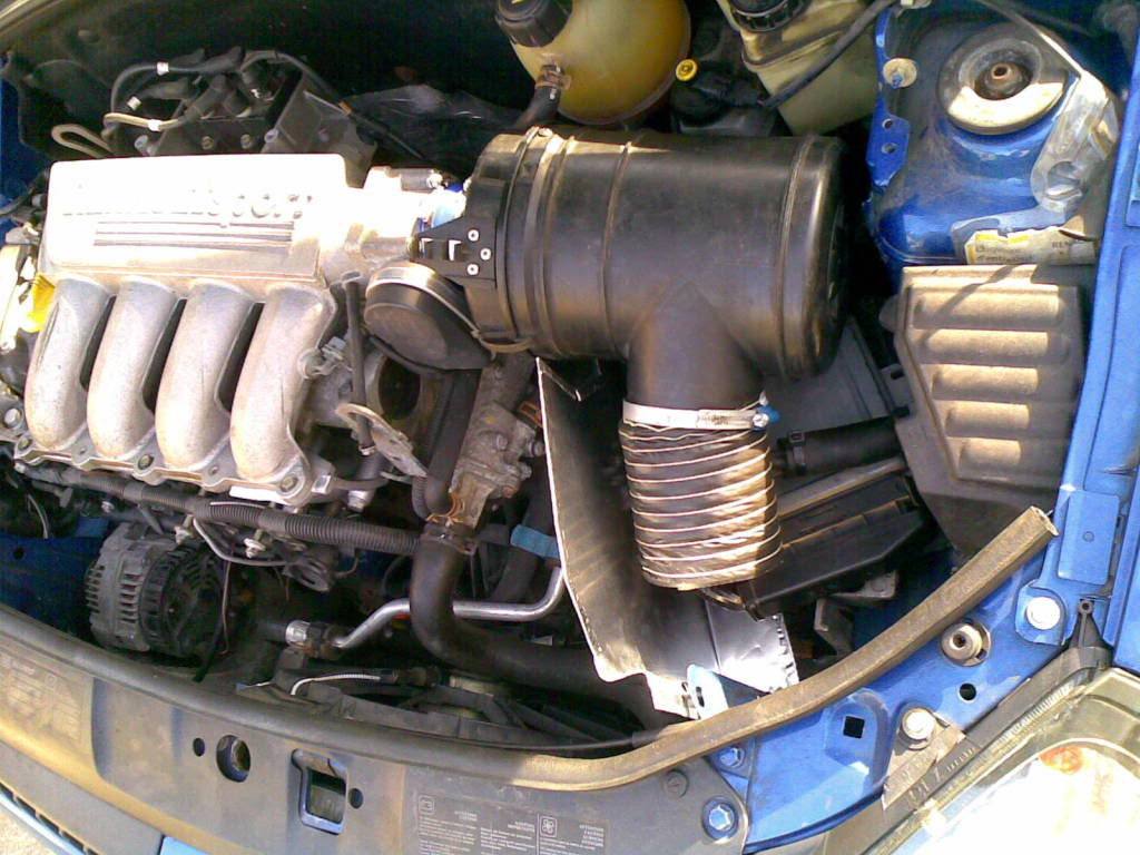

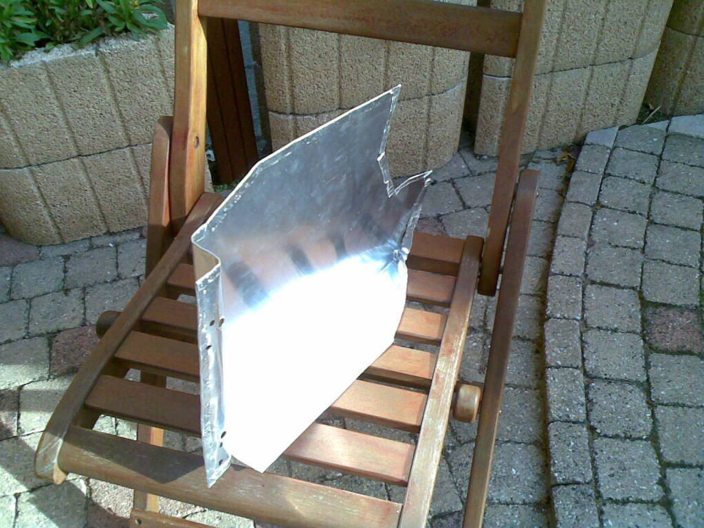

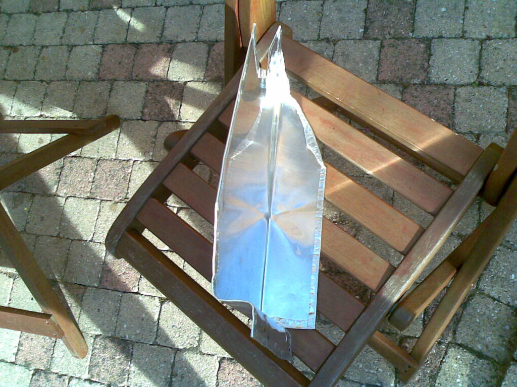

i was reading 172Ben's thread , he got some nice trumpets on there now :) , and saw that before the Throttle bodies came on he had a phase 1 airbox straigh on to the TB. Similar to the Cup racers setup, looked to be allright so i also gave it a trie !

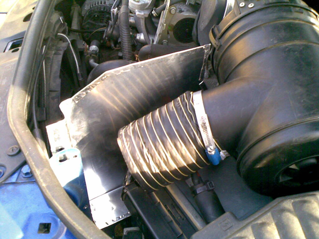

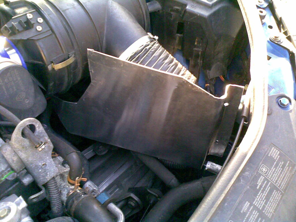

Battery was already in the back, got the ecu out of the way by laying it on its side and finally made a ghetto heatshield. Worked out great ! I was very surprised by the car being a lot more responive and it seems a way better drive , i'm quite happy with it. Thanks Ben ;)

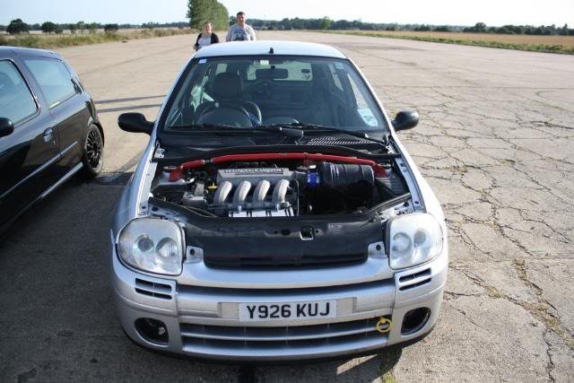

Yep , seen that also on a couple of cars. This setup i did is also done by teams here in Holland (maybe they trie different setups ?) . Had a look at two of them last year and this setup was used .
By eliminating the elbow there is a real difference in throttle response, very direct and seems to have gained midrange too. Was just out for a little run and it feels really good, no flatspots anywhere just GO
i can say is its a big recommendation especially when on cams+inlets , exhaust ofcourse ! :D

^ Is'nt yours stuck/rubbing on the right against the suspension ?
Because if so ; cut some more off the silicone tubing because it looks like it could lose some . Makes removing the filterhouse easier and allows for more "play" with enginemovement

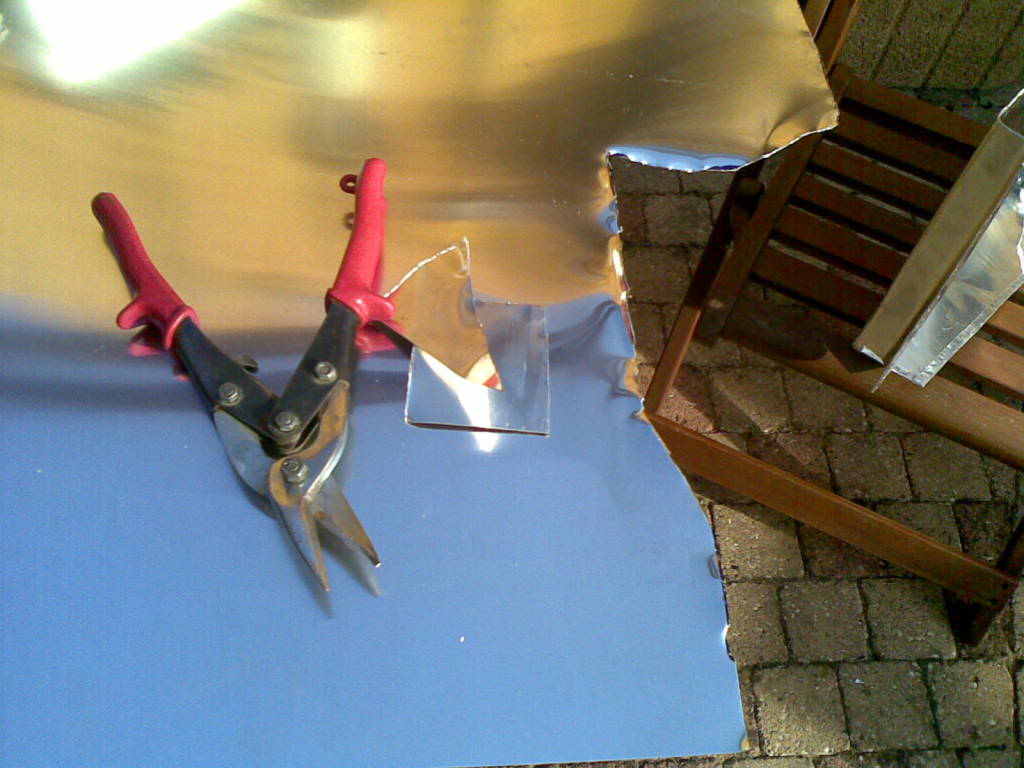

btw; When i did'nt have a decent caf on + without the heatshield you could defo feel heatsoak going on when been in traffic.. afterwards was a lot better ! suggest you trie the cheap mod (piece of 1mm thick aluminium plate 100 by 60cm = 7pounds ! and a bit of airfeed + 15 pounds, or less ! )

It is touching the turret yes! I can get away with another 15-20mm off of it I reckon. I've got some piping the same size as the hole in the box that went into it when it was down on a 45!
I'll get some more for it and seal it then a heat shield won't be needed :)

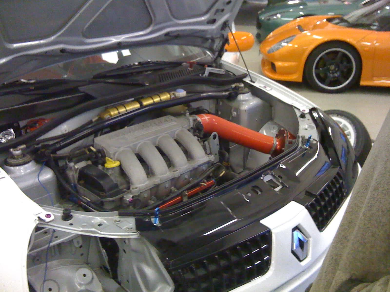

Rob, was yours used in the magazine topic where different airfilters were tried/compared? Your pics without the bonnet seem familiar ?
  RS RIP
just noticed the engine mount is different in there. wierd.
engine does'nt have mounts as we know it on a race/cup car. When it would be flexible the sequential box would have difficulties so all the flex is taken out. No flexible engine mounts on a cup
