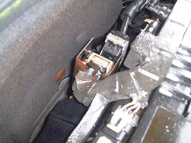

you don't happen to have a pic of where this is, or a description of where to find it, might need to check mine out.
  BMW M135i
Haven't i'm afriad, the ECU is mounted on the back of the engine (don't ask!) theres a cover on the top it which is a pig to get off iirc. It cuts into the loom there with the movement of the engine, if its still on there get the cover off and leave it off.

  172 cup'd extreme
The is the effected area, it happened on mine back in 04 i repair the wires and it was good again.
You can see where the cage has rubbed through the wire causing a short.

Got ya, the casing on mine has been loose for as long as I've had the car, shall have a look at it later on.
Cheers for the pic btw.
