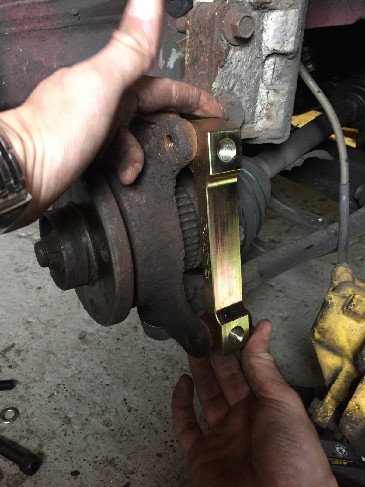

Just thought - you're on the earlier PMS brackets. Mine are the later design ones, and these had some clearance designed into them, so that could well be where your problem is stemming from mate.
They are these ones if you can make them out. Are they different to yours?
Nope they're the same as mine! I thought you'd posted a pic recently of the brackets you had and it was one of the old style. Wrong again! 🙈
I was hoping that was my solution! So it's a proper mystery why both sides of my car are different. Typically it has to be mine! It might have been someone elses pics you'd seen lol.
The Pure Motorsport ones. I'm a bit gutted I've had to use the spacers due to just one side touching the caliper but there was nothing else for it!
Undo the bottom ball joint bolts i am fairly sure theirs some give in them it maybe be all you need for clearance.

Genuinely, how does that work?
The wheel is a circle and the wheel bearing that it's attached to is in the centre of that circle. The calliper is placed relative to the wheel bearing, not relative to the balljoint. You could put the balljoint anywhere and it would have no impact on calliper clearance - case in point Northloopcup's RC correction kit moves the balljoint by 2 inches or so... Don't mean to come across cranky.

Just testing, the cheapest option would be to sand a little off the brake pads or go for a different brand.
Not the pads hitting... whatever you think the pad can hit.[/QUOTE]
Just read the instructions on the pure motor sport site.
Whats wrong with putting washers inbetween the mating faces of the rear of the calliper mounting points and the hub faces
