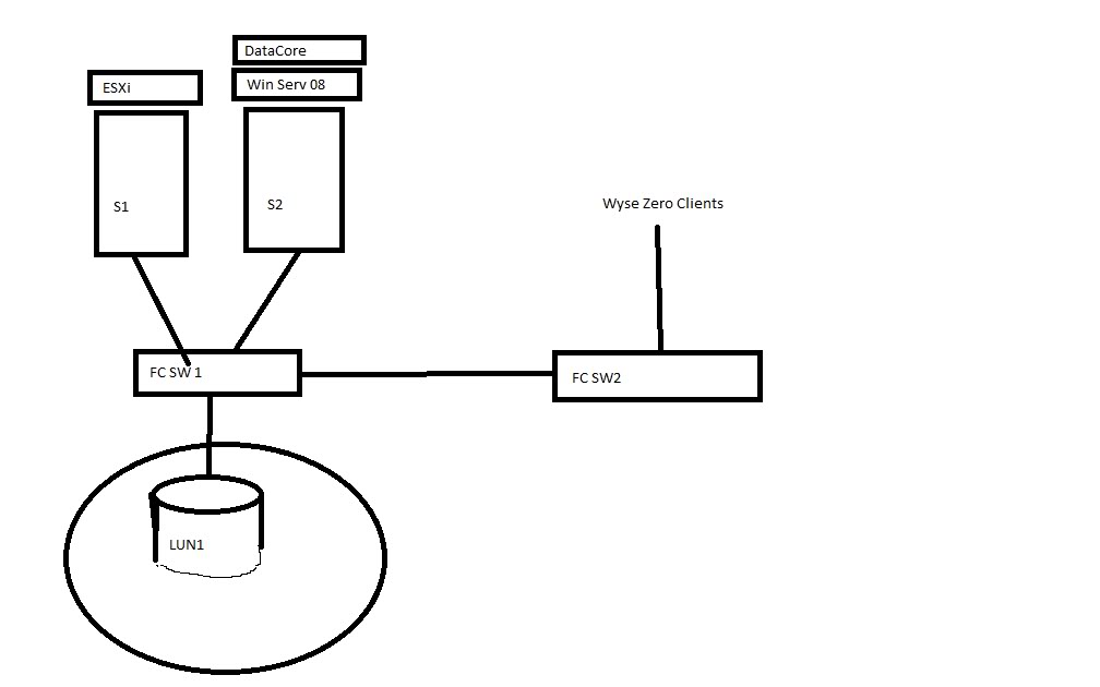

Well tbh DK, its a uni assignment I have to do . Ive looked at 3par and stuff. But the main two im considering are datacore, a hosted instalation over server 08, and then netapp.
I need you to look at this from both sides here and tell me which would be the better option. I need to design the infrastructure of a data centre (Not the network side of things), SAN's and a virtual desktop deployment (Ive gone with VMWare, and wyse clients).
As pathetic as this sounds (I didnt write the assignment) I have to design Google a data centre infrastructure, ive already done the switching infrastructure for it (Can you imagine how hard theyd laugh?!), and im doing a routing assignment where im connecting 15 datacentres worldwide and s**t. Its all CCNP related.
So I doubt theres a problem with budgets. Theres no right or wrong answer to this, but Im not sure im seeing the whole picture.
Netapp seems to be a real big boy in the world of SANs, but so does Datacore. I just think it might bea more simple approach if I were to have 2 Primary Servers, one with a bare metal instalation of ESXi and the other with an instalation of server 08 and Datacore on it.

My existing infrastructure is as follows, although the one on paper is far more detailed and has redundancy and auto failover etc , then a DR site with an exact mirror with auto replication over the WAN. ;
To install Netapp, would I need to have another server, as Id want to keep Server OS for its Active Directory.
Or does Netapp have its own controllers as part of the SAN.

no, monolithic is different, it is a unified storage platform, mixing a nas with a modular array, ultimate flexibility.
that pic doesn't look right btw, you wouldn't have the terminals connecting into the fibre switching, the san array would utilise both fibre switches for redundancy on the local site, the esxi servers would also connect into the fibre switches and then the terminals would just be on the normal network.
if you went netapp you wouldnt need the windows server, you would always have a minimum of 3 esx servers though, so that if you lose one you are still left with redundancy.
as cookie says, the netapp has its own controllers, doesn't require a server to run on. if you want the datacore to be resilient (you always want local resiliency) then it'll need to be on 2 servers i'm guessing, thats if its a software based san which installs onto x86 hardware.

Yer my origional had 4 switches, two FC and 2 normal (Primary/secondary), the normal switches branching off to the local network....but i figured thatd just add latency if the servers were to go through a normal switch and then a FC switch. There are 4 servers in total at the moment, 2 primary and 2 secondary, that design was mirrored. Im going to have to have a think about this.

The data drives are presented over the fibre switches to the servers and the network traffic goes over normal network switches, so the servers are connected to both networks, the fibre and Ethernet. Then the thin clients are just connected to the Ethernet switches which allow them to connect to the esx server where I'm presuming vmware view will be running, the desktops actually being stored on the fc San.

I think what youve described is what ive got....almost.
My server/s connect to an ethernet switch, which then connects to a FC switch. Then connecting to the SAN. The thin clients connect to the esxi server through the ethernet switches.
