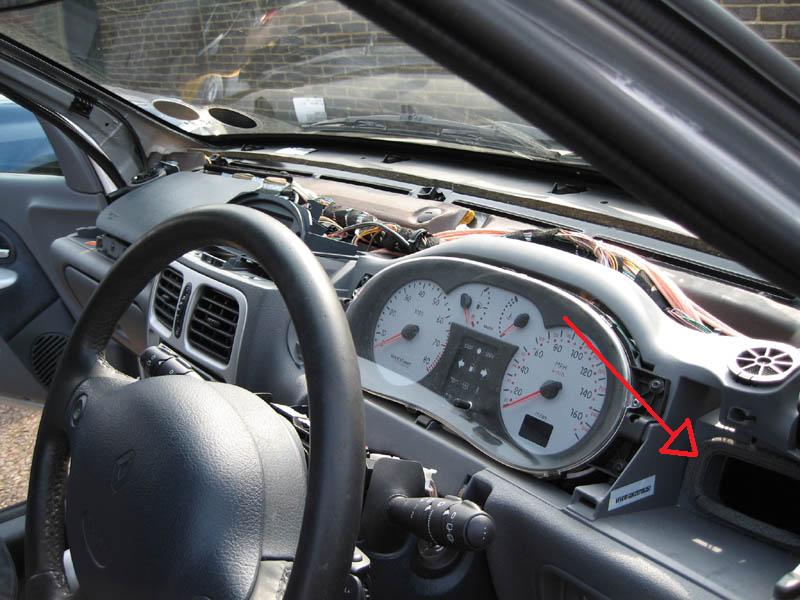

When sticking the dash on it knocked part of the tweeter off (they're in 3 bits) and its fallen down the air vent thing that blows cool air into car!
How the hell do I go about getting something out from there? :S

Have drawn an arrow on this picture from Fubars guide to show the vent it went down.

if it remeber correctly take out the instrument panel and see where the feed pipe goes pull it off and hopefully it will be in the pipe if not it make have fell right in to the heater box.

I got the fker!! Because it was the bottom bit of the tweeter I knew it had a small little metal spring on..
Problem was I didn't have any magnets, so I ripped apart one of the old renault tweeters and used the magnet from it tied to a bit of fishing line.
I then spent 45 minutes solid dropping it down the vent until at last it gripped the spring and I slowly pulled it up :)
