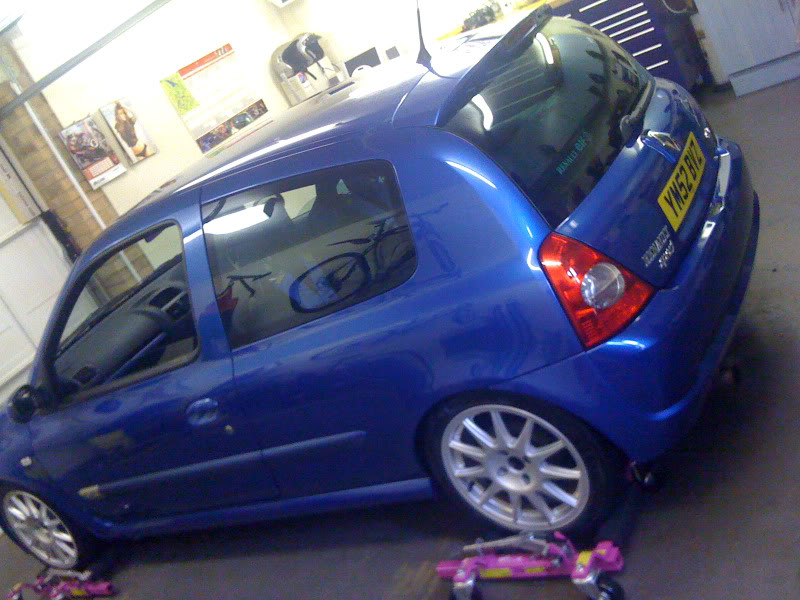

It's been a while but thought i'd treat the old girl to the 1 bucket method and a bit more!
Spinning a clio is fun, so onto the trolleys..

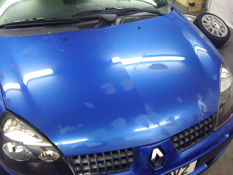

Then, a bit of this.
Some wet & dry..

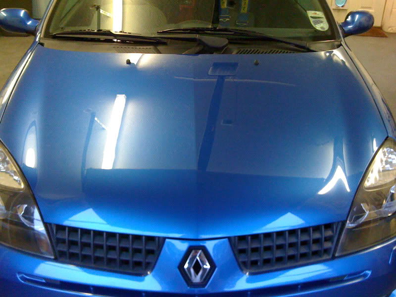

and we got a fresher clio..

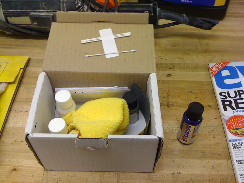

At a guess we filled in 20 stone chips so a Paints4u £16 paint chip set delivered can't be bad, borrowed a DA and got sanding and the headlamps were so knackered the light wasn't as strong. Saves a £200 front end spray...for now;)

Johnny it was a DA, not the best finish and it could do with some more polishing but it's good enough for me.

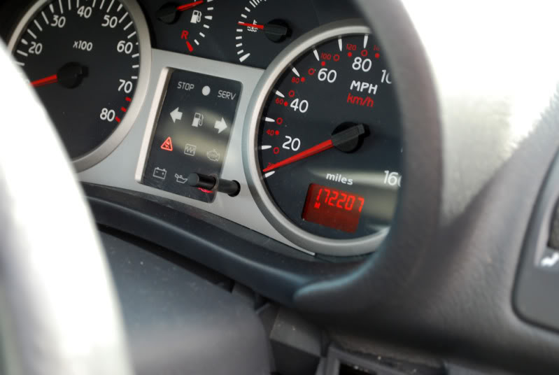

It's re-assuring to know these are still running well at such high mileage.
  197 FF Glacier White
Looks superb! I'm 100k behind you! Reassuring to know the carry the miles that well! Is it your daily driver? I suppose with that mileage and only your ownership, it must be!

Where did you get the stone chip kit? need a capsicum red kit (Edit paints4u) £13 is good:)

Yes faz, started with 1200 and worked to 2000 grit then just using a normal workshop compound carefully buffed it off. They're not 100% perfect but the front of the car looks so much better.
Not much else i can do really other than what a bodyshop can be done.
