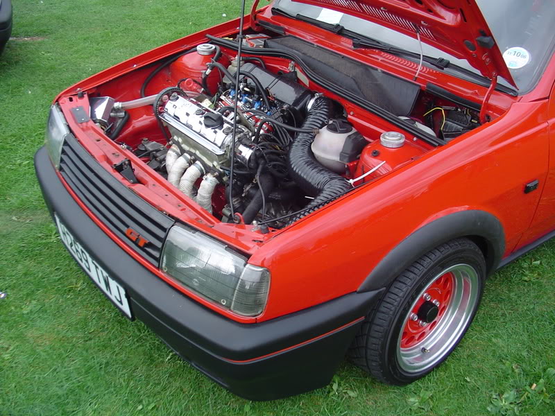

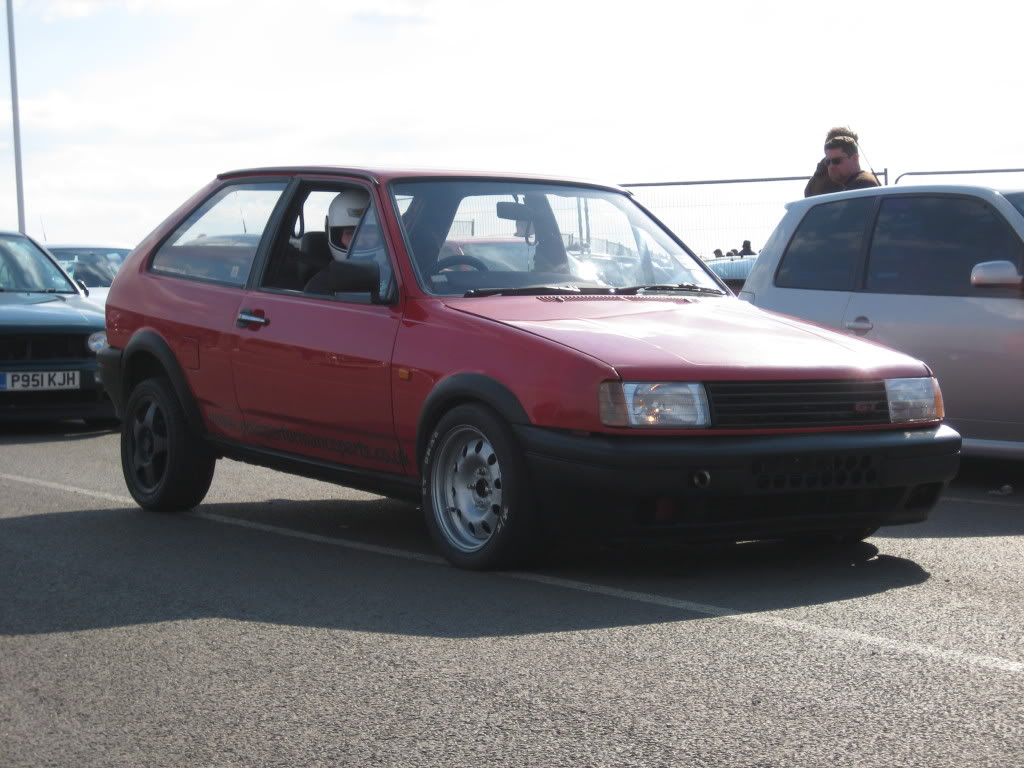

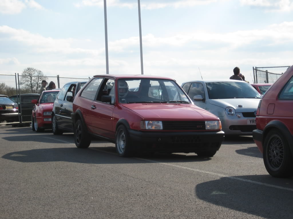

My car started as a 1991 Polo GT, seen here:
Didn't start life like that, was probably after 2 years or so, used to run a 90bhp 3f engine and 80bhp of nitrous ;D

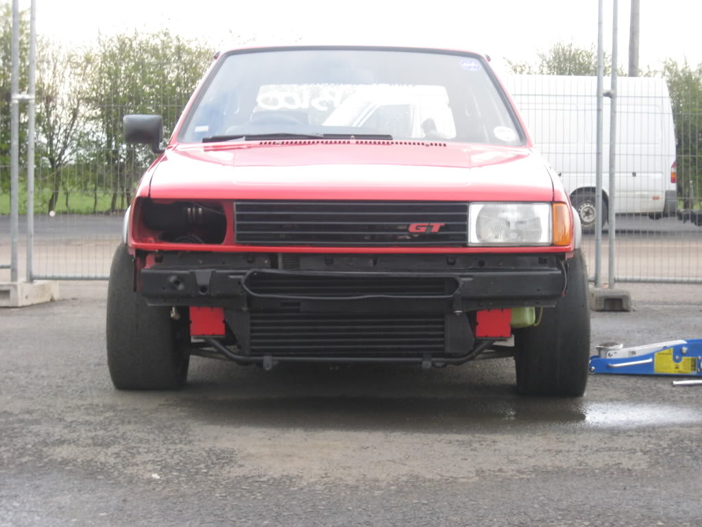

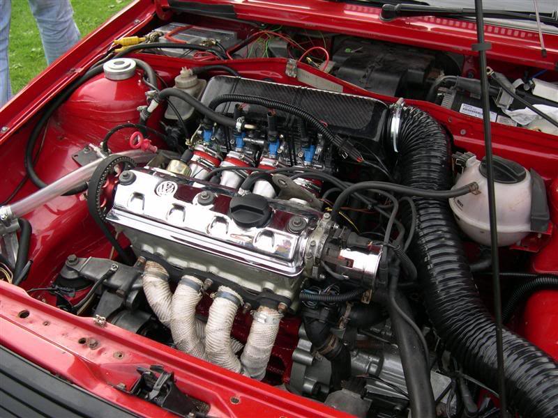

Then, once that got boring a new challenge was set (throttle bodies on a budget- was still 18/19 then!)
Hence:

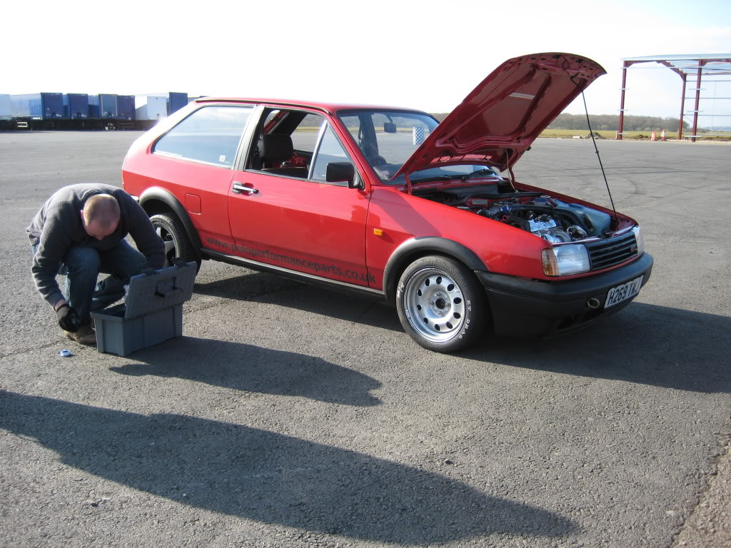

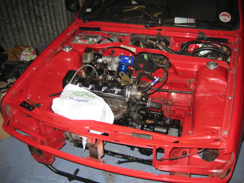

Once myself & Andy had done the megasquirt it ran well, needed more tweaking but I went turbo instead:

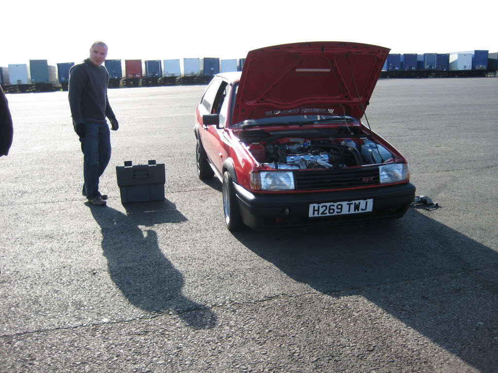

Car before running a low 13sec @ Santa pod:
Note the Subframe peeking through- proper research & development being done!!!!

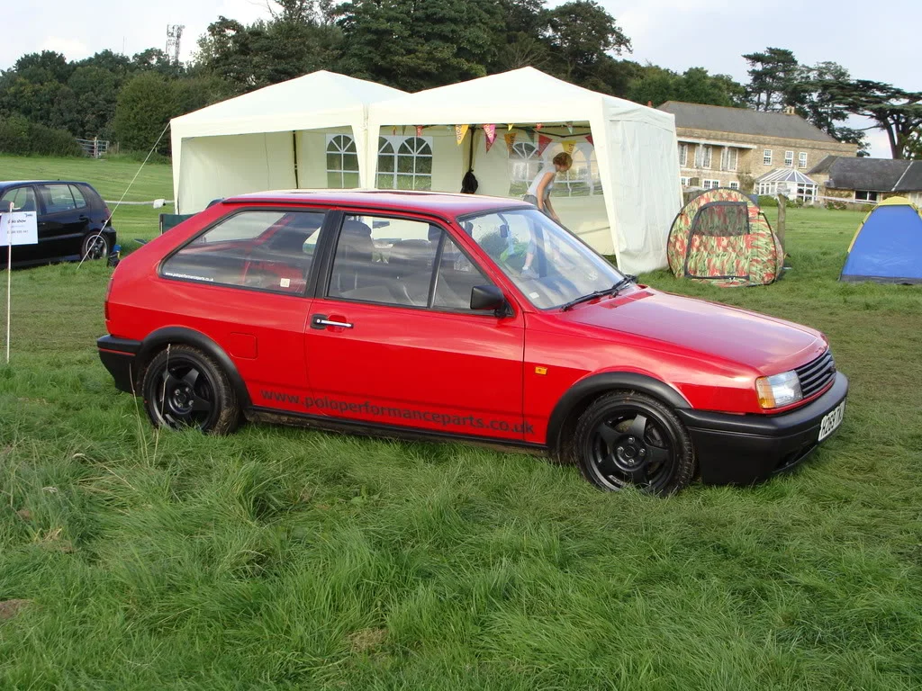

Polo Show in Sept '08

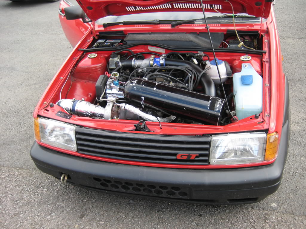

Made 203bhp & 187lbft without nitrous at 21psi boost- G40 RR Day @ Aldon Automotive
Made 223bhp & 210lbft with nitrous ;D

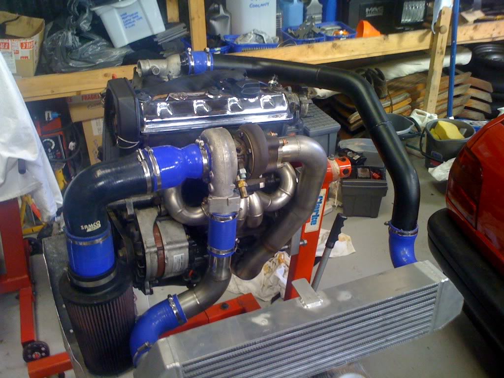

Obviously this wasn't enough, so for 2010 I've got a little something extra:

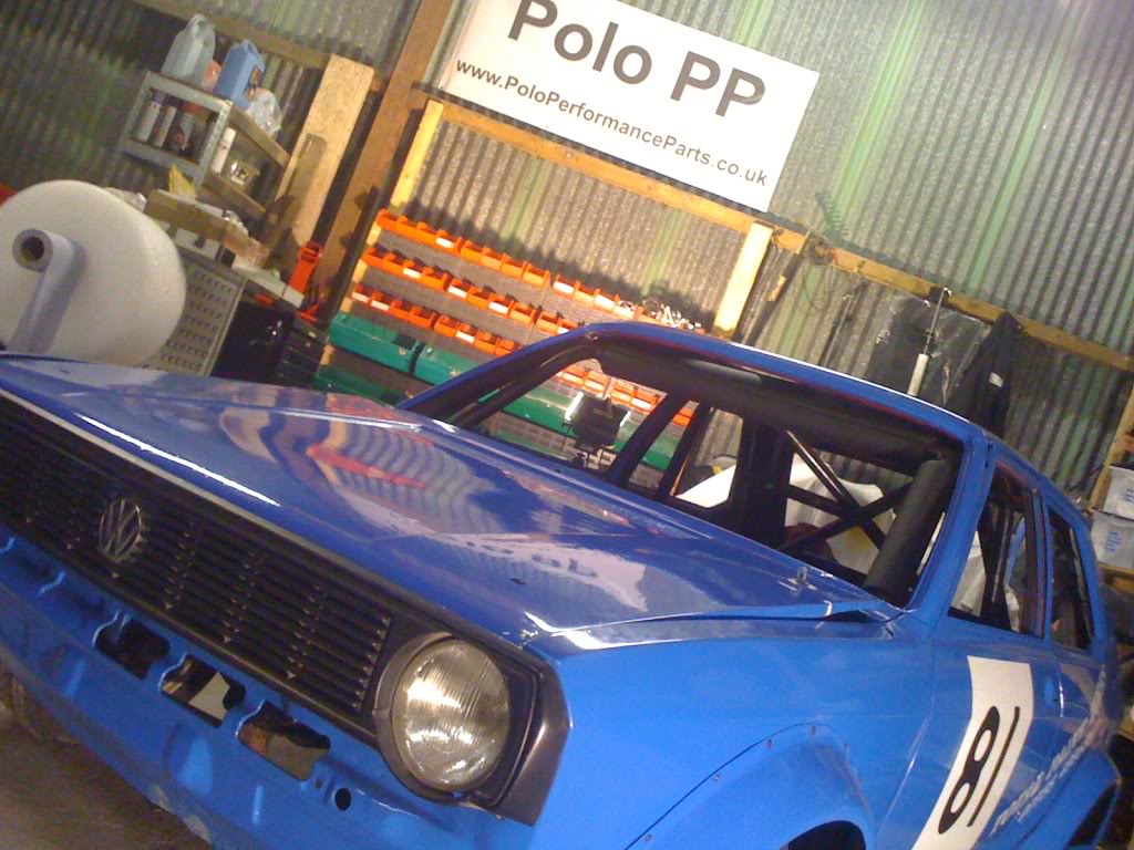

Here's my other polo:
Once I've got the red one rebuilt I'll start on that- it's waiting for a Saab 9000 Aero motor, 350bhp and 400lbft :cool:

At that pressure your turbo must be cooking your inlet air temps even with a beefy intercooler. Have you not considered a TD04/T25 hybrid? Its compressor map would be more suited to your needs, would it not?
  Polo G40 & Clio 17Poo
Fortunately it's got a decent sized cooler on it, and runs a water/methanol injection aswell.
The turbo you see in the pictures is a GT2554R, will probably run 18psi. Old turbo was a K03 removed from a 20v Passat, good for 20psi+ on the 1.8t so not really inefficient on a Polo engine.
Would consider a TD04 (as I have them readily availble) but I'd like to go roller bearing instead of journal.
I'll take my blow job later thanks.
FYI My inlet temps never get higher than 20'C above ambient- whilst on the nitrous the throttle body frosts up :)

The GT2554R (is yours from a skyline R34?) is a good turbo i ran one on my Turbo MX-5. Then i went to a GT2556R as the 2554 seemed to get very hot with its odd exhaust port size (I was killing my post turbo wideband sensors monthly even with a huge heat sink).
What was thinking for you was a TDO4/GT25 hybrid i just missed the T off. I half built one for the MX-5 and then i found out i didn't have room for it lol
Bought it straight from Garrett- I believe it's the standard upgrade for a Lotus Carlton (with two obviously)- as it's a 1.3 I'd struggle to spool anything much bigger, even with 9.3:1 CR.
TD04 are really solid turbos- run them at work and rarely have problems, although now need to change as they're approaching their upper RPM limit.
