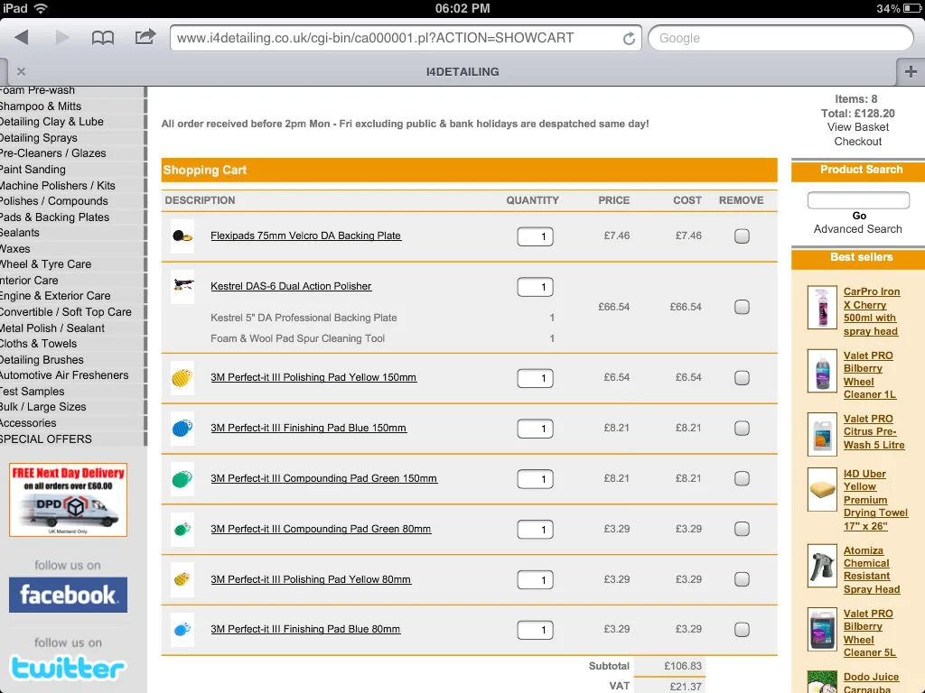

Looking into purchasing my first DA.
This is my basket atm
Is there anything I've missed off that I'm going to need?

how much are you planning on using it, I didn't see the point in paying extra for the pro version and the difference in cost paid for all my pads and compounds and got on just fine.
If you feel you need the extra power when polishing have a look at the EP800 rotary from CYC
I'm planning on using it a fair bit tbh. Going to hone my skills then offer a detailing service to friends family etc.
I don't quite trust myself with a rotary quite yet tbh. Want to start off with a DA then progress up.
My budget is around £150 for machine and pads etc.

I don't like the Kestrel machines, too big & heavy. Although, that was the rotary, not sure on the da?
Gally
No offence Emma but that's simply crazy that basket!
A compounding pad?
I know you don't know much about detailing but people should spend longer researching before jumping in feet first.

I personally would buy an EP800 ocer a DA these days. A rotary is much much easier to use and if you listen to the right people you won't do any damage.
If you're going with a DA just stick with the kestrel. If you're spending more buy the rotary. It's a false economy otherwise.
Find that thread and read it. Then come back in here and ask away.

Why would you buy polishes like ssr when there are polishes like menzerna out there. The price difference is negligible.
I hate to sound harsh again but it shows lack of research. I could count on one hand the amount of times i've heard ssr mentioned on here.

Thanks gally. I did read the thread you mentioned.
Im not 100% sure on the pads I'll need. I'm pretty set on a DA to learn then if it works out with doing other cars then I shall progress onto a rotary.
So what pads would you guys recommend for me.

There's simply so much info in the above thread. James' basket is still pretty spot on.
Sadly people are still a little obsessed with the word "correction". It's not really quite as simple as that.
Ok thanks Kev. I know you reccomended the chemical guys hex pads in there. I'll just order the same :)
Only reason I didn't have them in my basket is they don't have them a i4detailing and it was the cheapest place for a DA
It's better spending the extra money elsewhere and get the right stuff.

offering a detailing service to people is a bit ambitious, no offence. the experience needed to do that you'll have worn out your DA. I had people asking me to do it and I was turning them down, I would only clean and seal, never correct or enhance and do it for free or an invite to a summer BBQ. I only ever did two enhancement detail for a close friend and they only paid for the products. I reserve that for my own cars, unless I particularly want to do it to a family members car.
Get it wrong and you're in the sh!t. Look at Toby, someone who I thought of as being pretty experienced :quiet: go through the clear coat wet sanding. A DA is just as dangerous in the wrong hands as a rotary, more so with a more powerful DA. I watched people burn paint with a finishing pad and compound with DA at a recent training course on scrap panels.
As is always said, start with the softest pad and least abrasive compound. even pre wax cleansers like lime prime and SRP can offer a small amount of cut when used by machine. get a scrap panel and work it to get the hang of it, try burning through so you no the warning signs. Please don't go into it without watching as many videos and reading all the guides available

So after my dressing down yesterday :eek: I revised my basket at cyc to the chemical guys hex pads.
Quick question though, I want some smaller 4" spot pads for the small intricate bits. The hex pads don't do the blue pad in the 4" version. What else in that size would be recommended?
  Golf GT & A4 Avant
I went for orange, green and black Hex spot pads, the black is very soft and have used it for finishing and glazing
Thanks Dave.
I read the black one is for lsp.
Just thought it might be a bit weird using a blue pad on the larger areas and a black pad on the small areas.
Might just order the black pad in both sizes.

unfortunately I bought without asking, so ended up with yellow, orange, green, white, black and red 6" pads, and the above 3" pads. I use black for finishing generally
