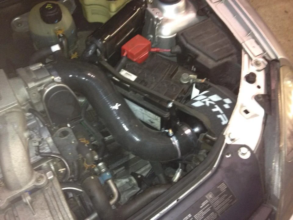

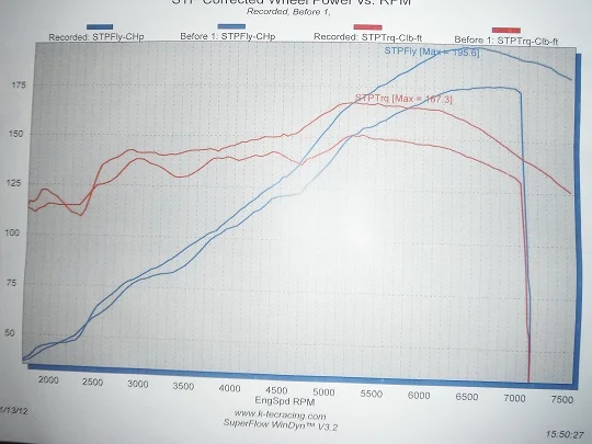

So today i had a long day at k-tec, had the 438 cams, dephaser, all belts done, water pump, induction kit and pops and bangs remap ( sounds ACE ) results:

Looks like quite a dip in torque between 2-2.5k rpm.
I might have read it somewhere or might be imagining it, but is this a trait of 438's? Glad you're happy though, bet car is transformed..

The car is now great the power increase is just so good and the way the car drives and sounds, happy customer.

nice apart from the stupid banging from the exhaust. sure iv read as well there is a dip in torque on these cams at low revs but the gains after that are very impressive.

I got mine done the other day i made 196 and 174 lbs well chuffed with the results defo noticeable through the mid range

Check the before graph. Major dip there so it looks to be a big improvement.
