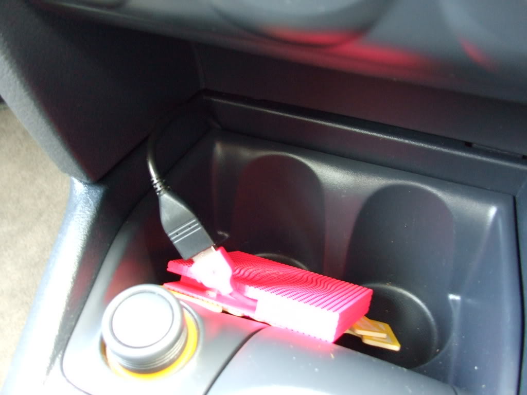

Lacie hard drive:
Great bit of kit, looks a bit camp but whatever. Had mine almost 2 years now, been dropped, abused, plugged into hundreds of computers, been on for days at a time and still looks and works spot on. Bear in mind this is a small internal disc which uses much less power than the larger portable drives so is much more reliable when using it with a car stereo.
Sure you can find somewhere on google that sells them, think i got mine from scan or ebuyer.

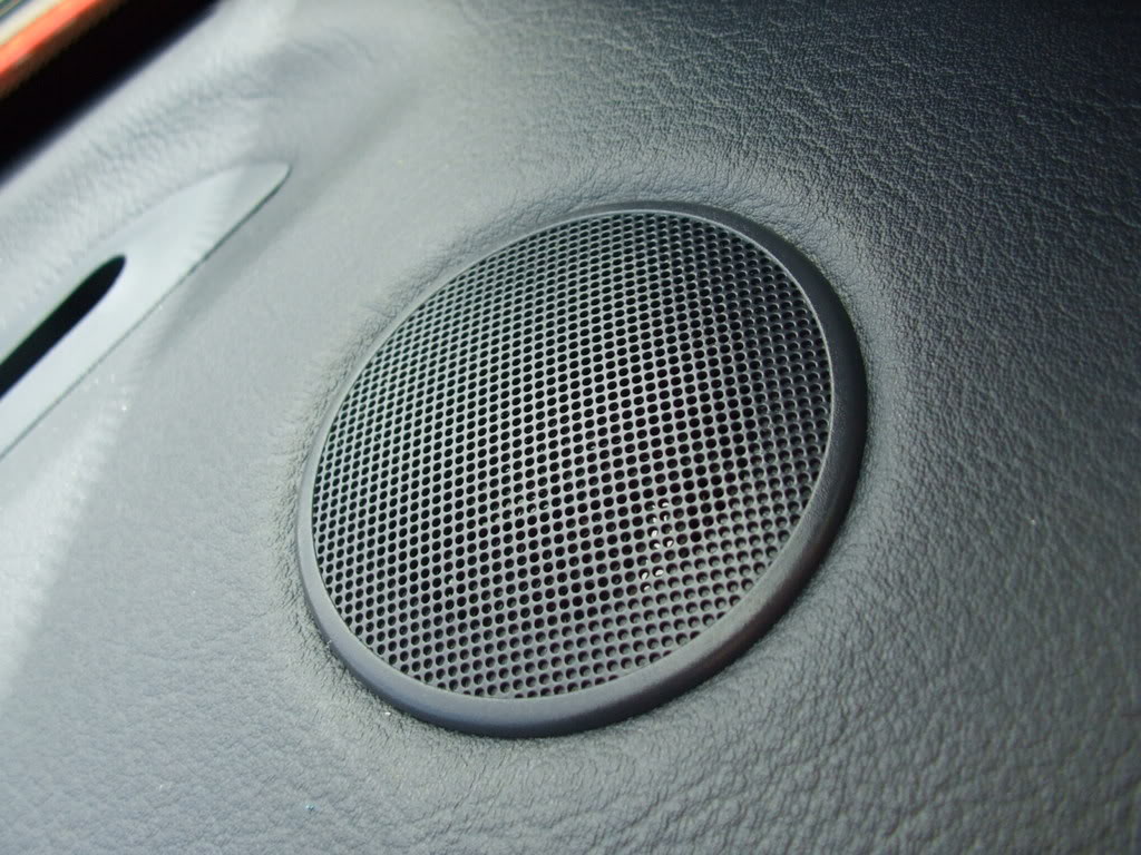

Front speakers(usually with grilles fitted) aren't noticeable to even the eagle eyed:

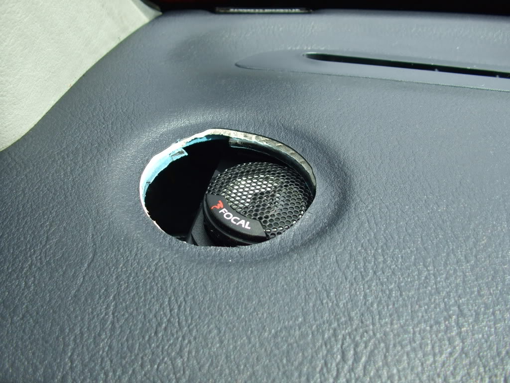

Sans tweeter cover:
What a ballache to fit.

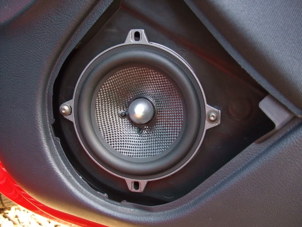

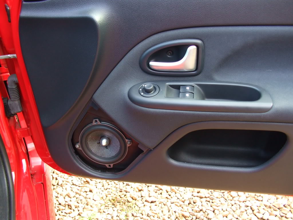

Anyway i've always liked the sensitivity of focals and the sweet treble that they give. Also they are french so should keep the snail-eating car happy, i doubt it'd like english or japanese speakers.
With the crossovers set at -3db on both sides the treble isn't too bright and overpowering, midbass is great and they seem to be sounding very good, sure they'll loosen up after a week or so of easy listening. Also a great value buy from CAS @ £80+P&P. I'd definitely recommend buying these over some mainstream speakers that cost the same or a little less.

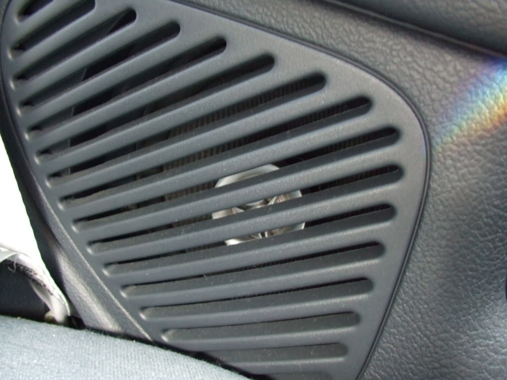

Rear speakers:
Piss easy to fit compared to fronts! Just using them to fill the rear of the car with sound, faded forwards by 5 so that they don't dirty the lovely sound of the fronts but they are a million times better than the standard crap anyway and will keep back seat passengers happy. Treble is overpowering as always with JBLs

Those Focal mids would respond well to a well deadened & sealed door, MDF baffles and a nice amp to wake them up....
Just my opinion of course....

yeah, i "customised" the standard tweeters to keep these in place, they look at a strange angle but the dash is curved, the tweeters point straight up.
i thought it was going to be really hard to get the dash off but it was easy!

You may want to consider trimming the plastic speaker mounts on the door card, if you do this you can then mount and mdf/ply baffle on the door its self, this will improve you're midbass response from the speakers, as will sound deadening once its done.
