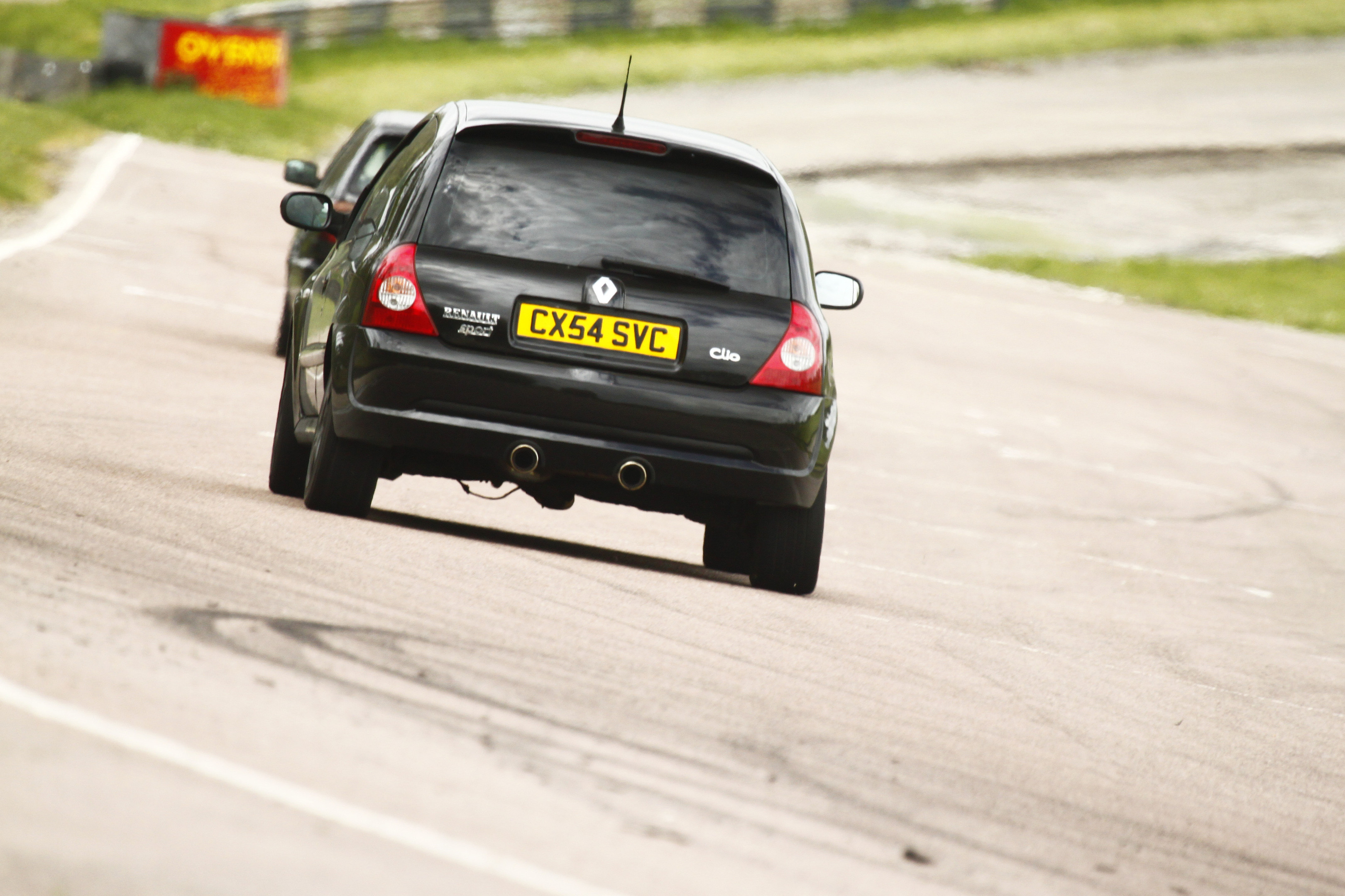

trackday was a success, had a great day and learnt a bit about how the clio handles .
got quite a few vids and other than the wheel nuts coming loose all round was a fun day.
car was faultless and did well,managed to get the brakes smoking and nearly fail entirely despite braided lines,new fluid and ds2500s up front.
i did 70 miles at lydden and managed 13mpg lol.

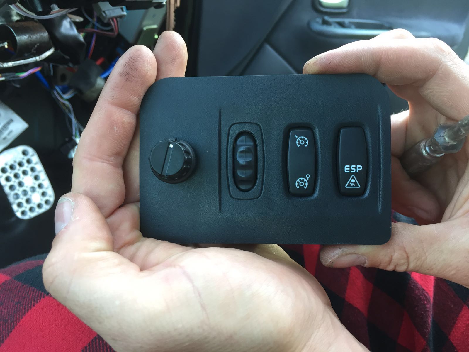

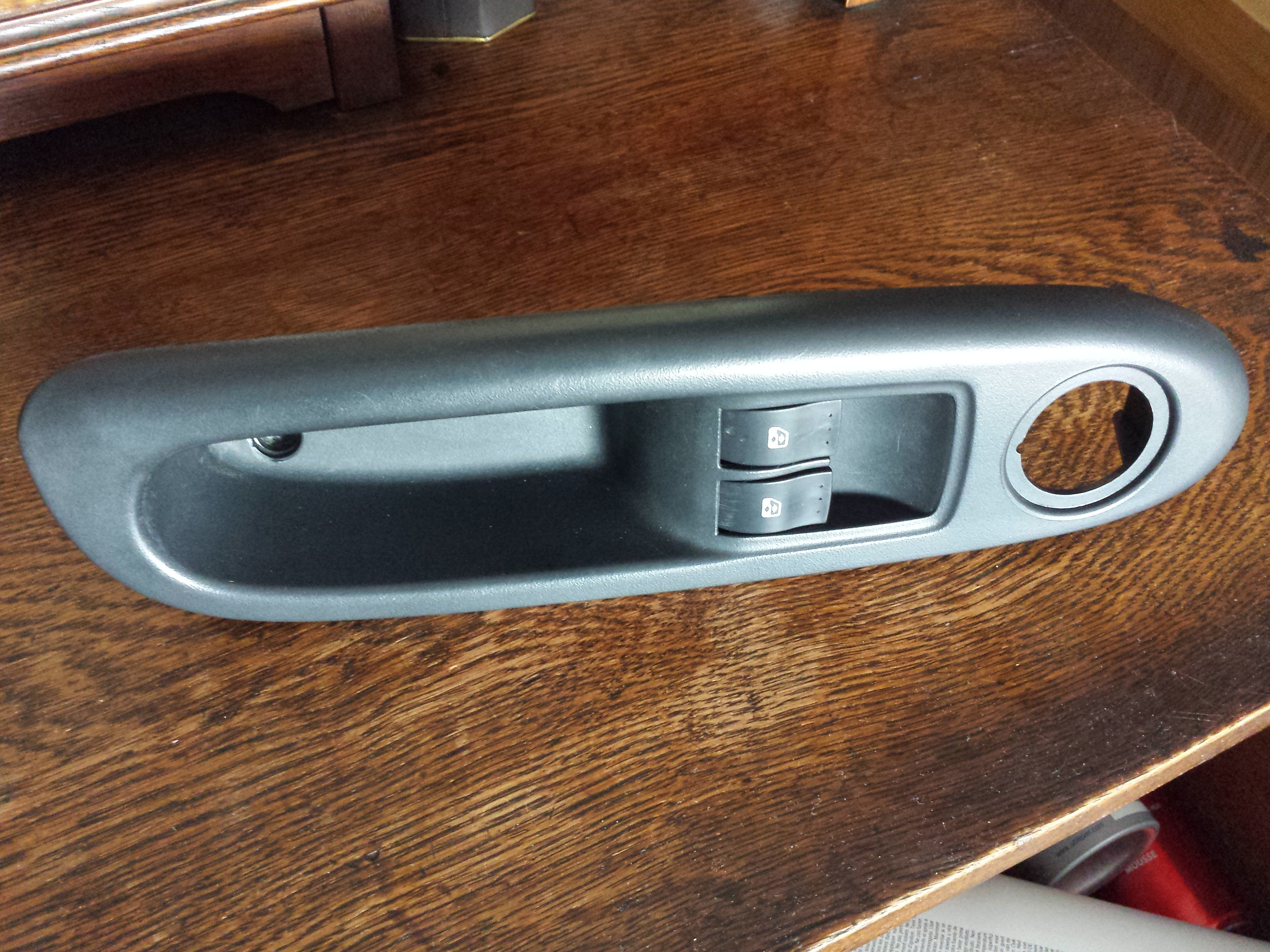

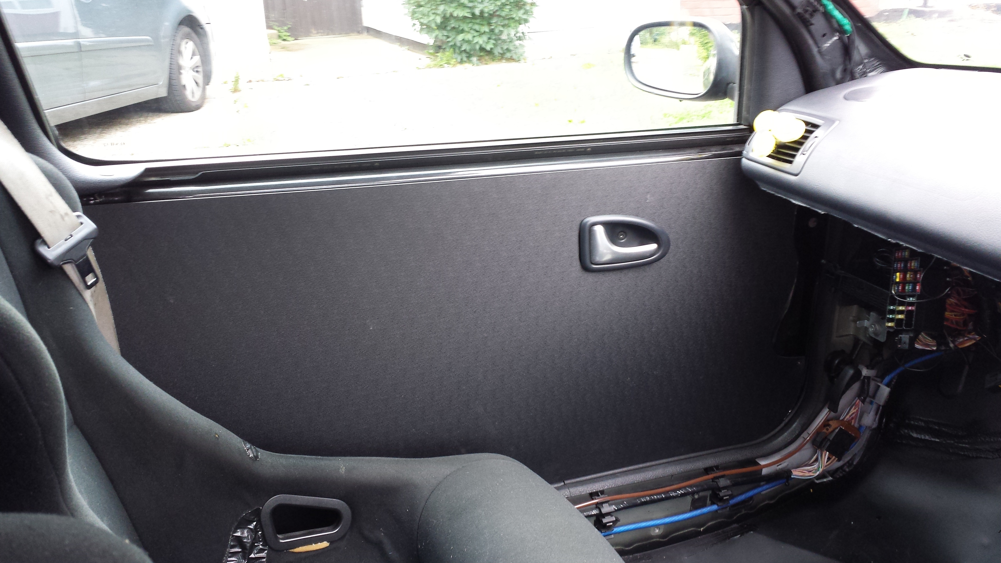

Managed to get hold of a new drivers door handle and window switch as the handle on me car currently is worn and shot and the switches are intermittent.

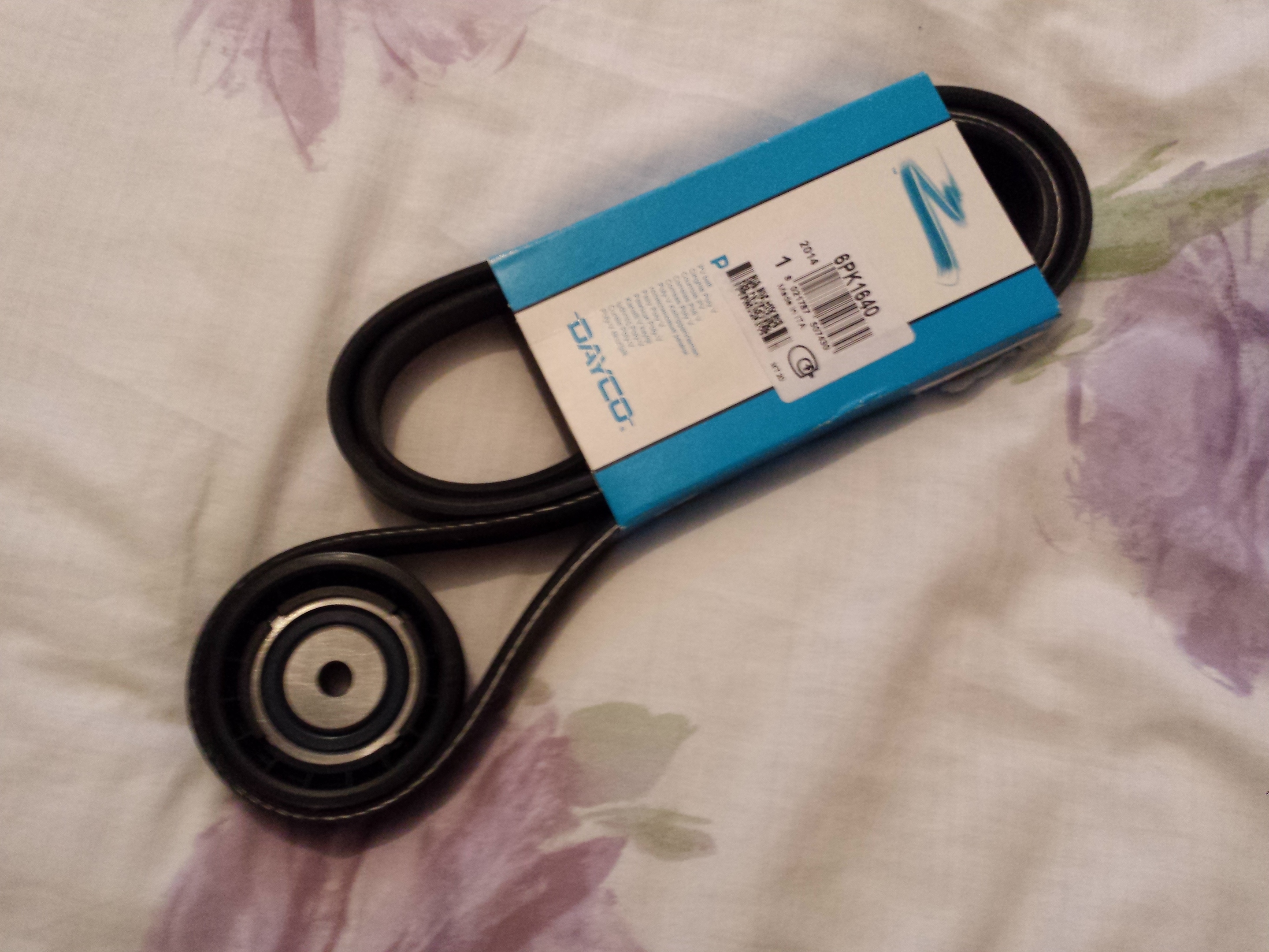

Firstly my aircon delete belt and pulley have arrived and will be fitted very soon.

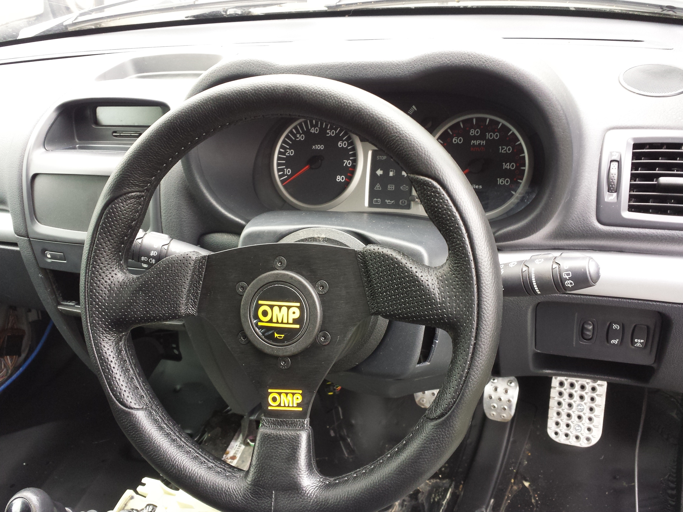

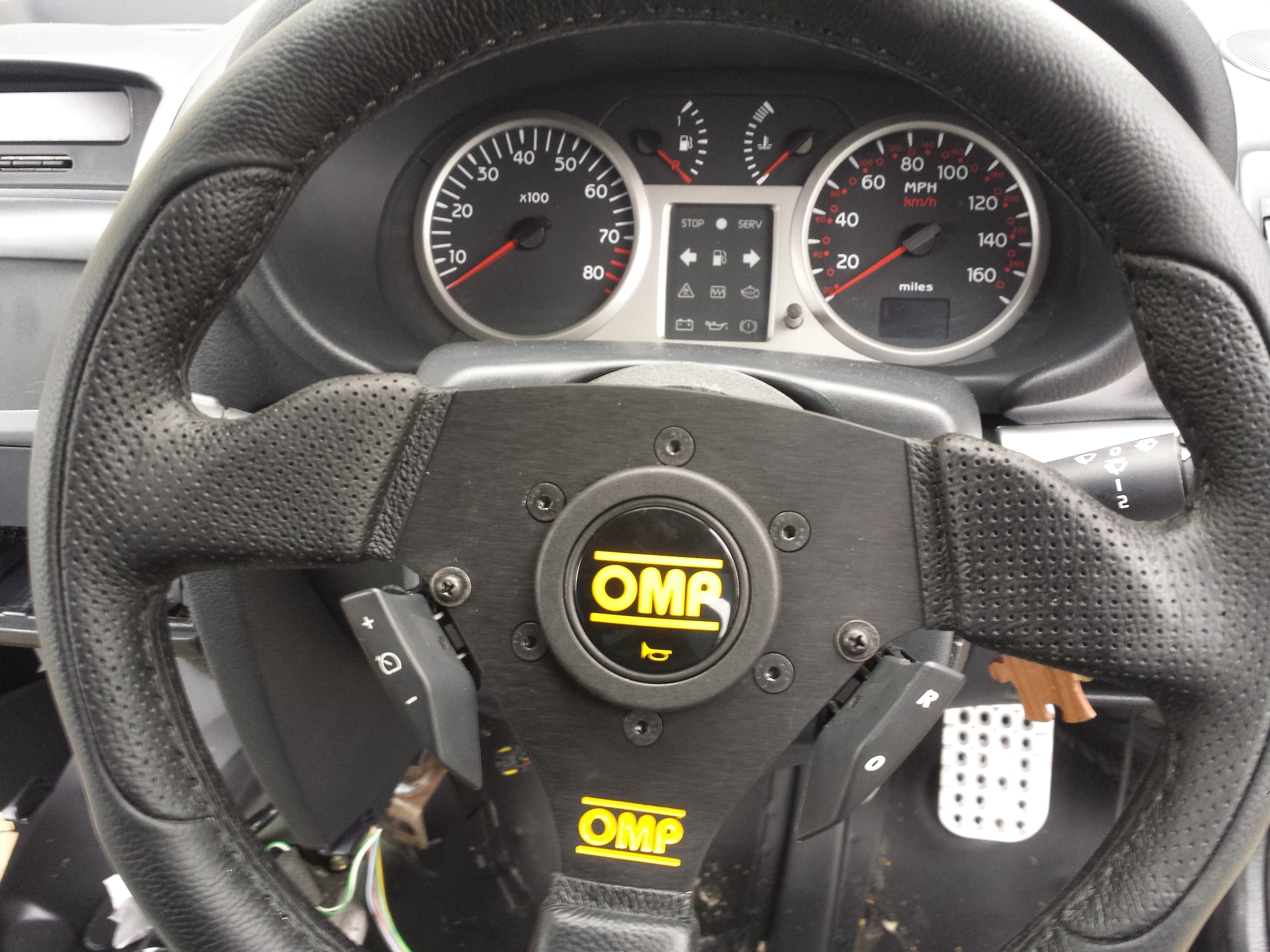

My new steering wheel has arrived and been fitted as original was knackered and also way to big.i bought a 300 mm omp with boss

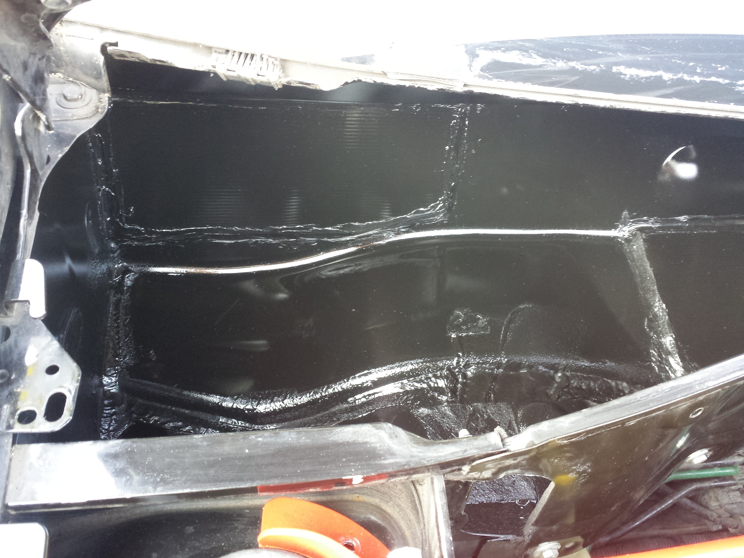

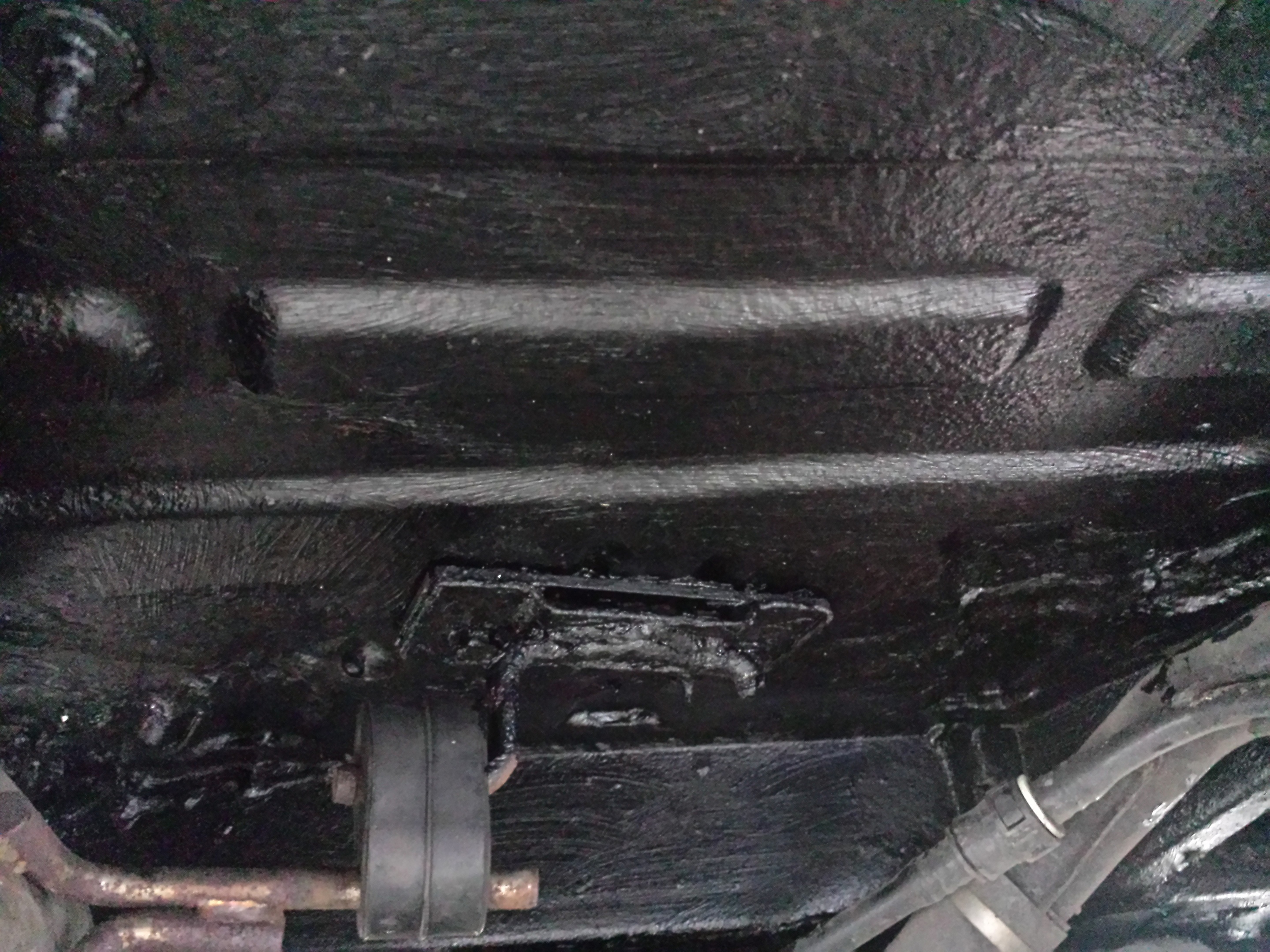

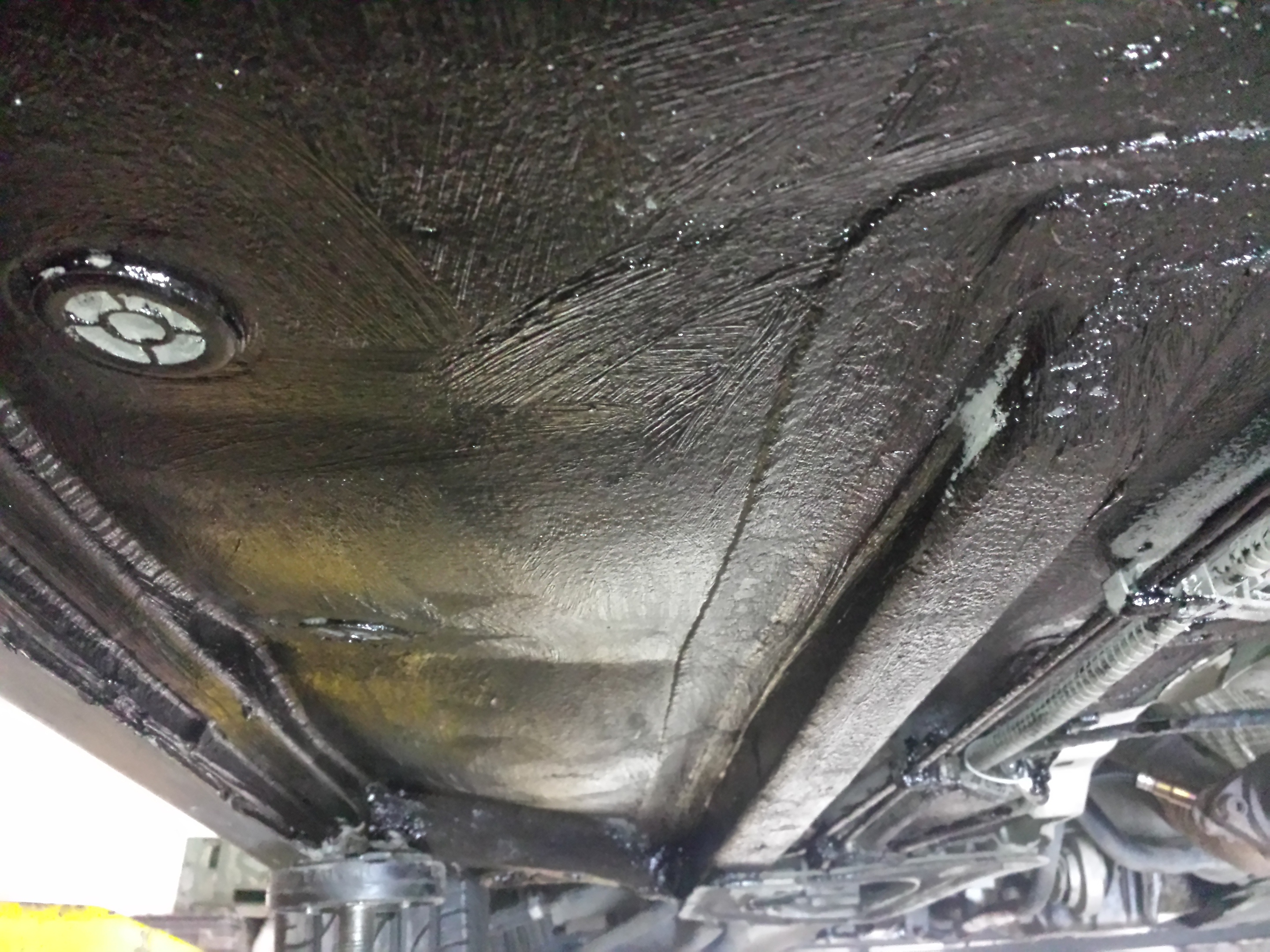

And lastly I went to my mates workshop last night and he kindly let me use his ramp and I undersealed the whole underneath of the clio.

Had time to retro fit the cruise control on the new steering wheel as it's a great feature I wanted to retain.

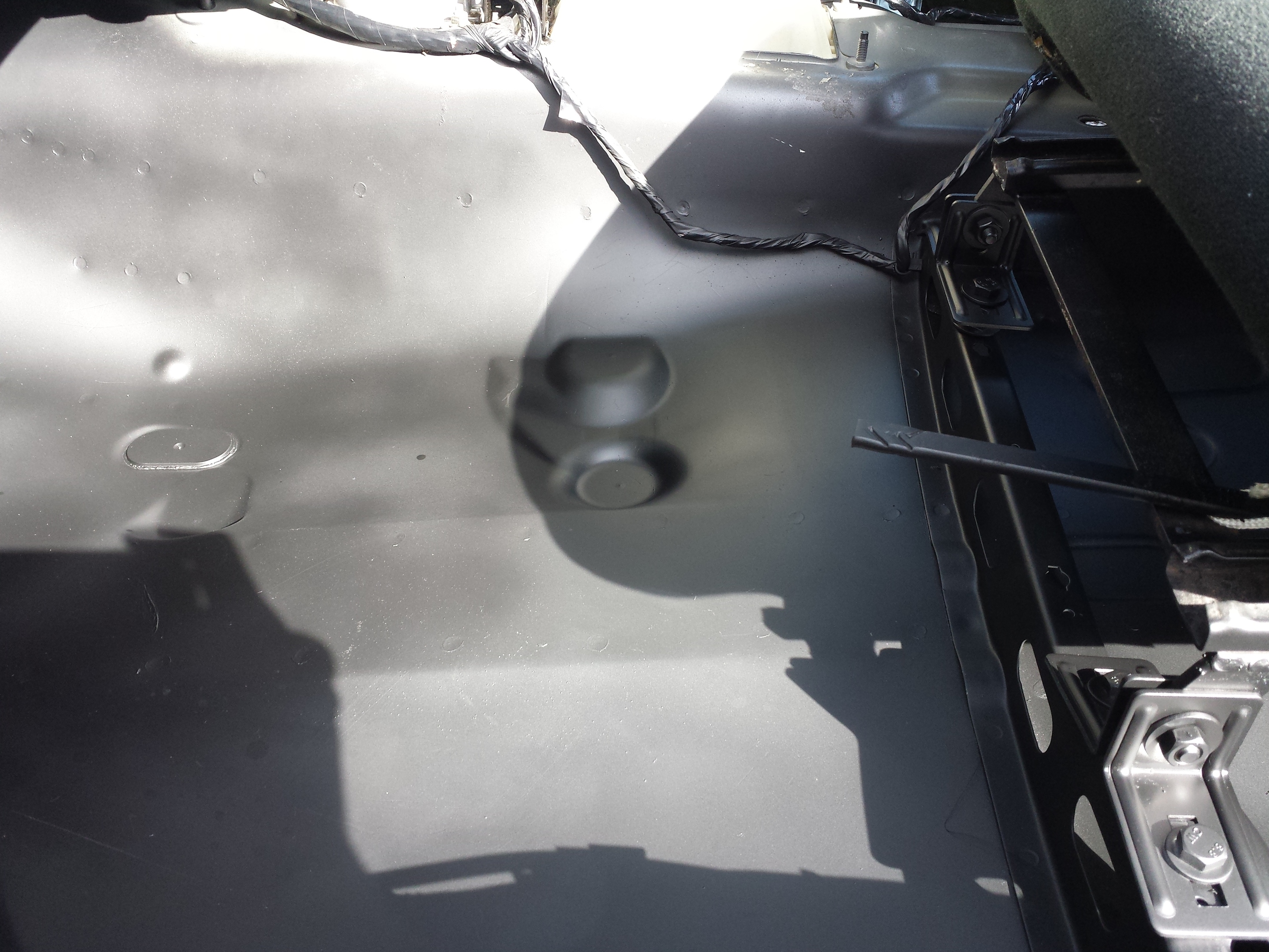

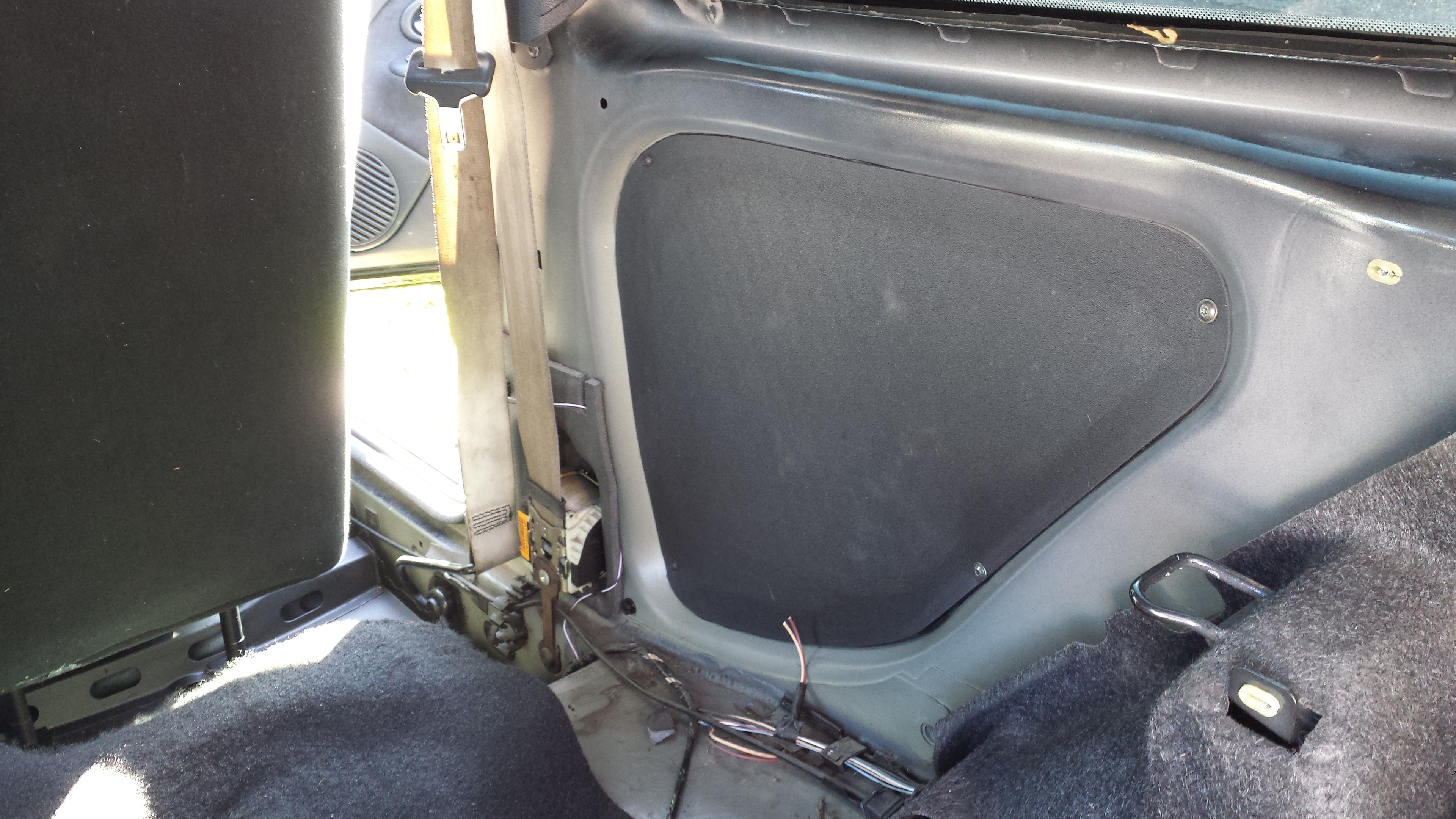

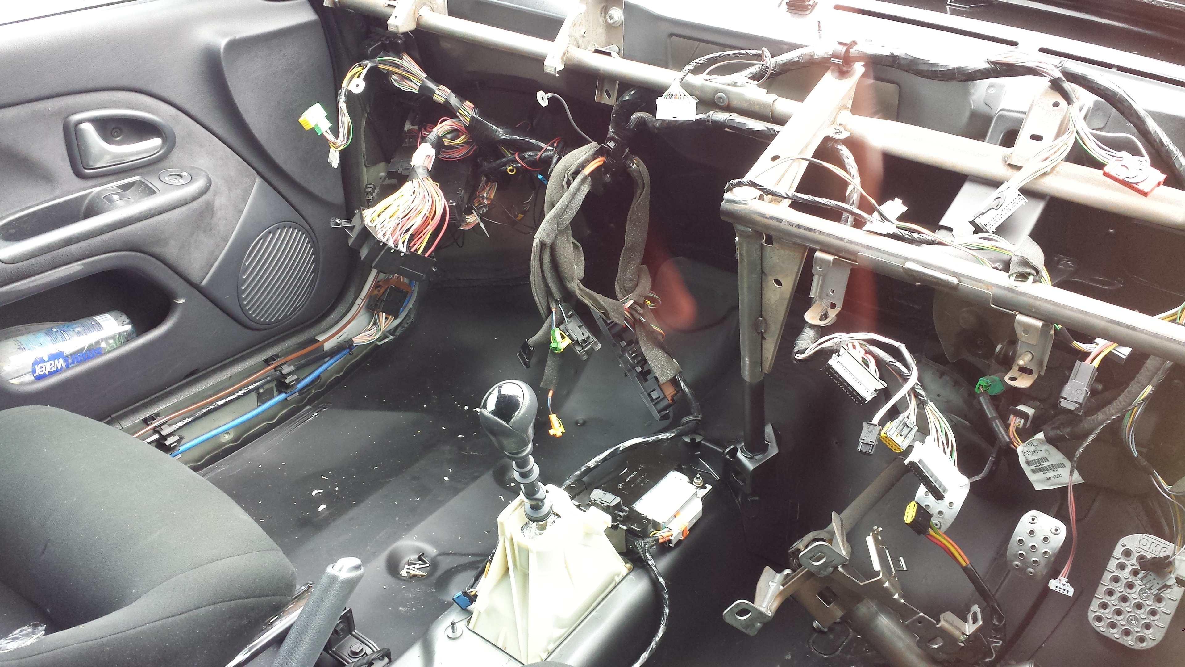

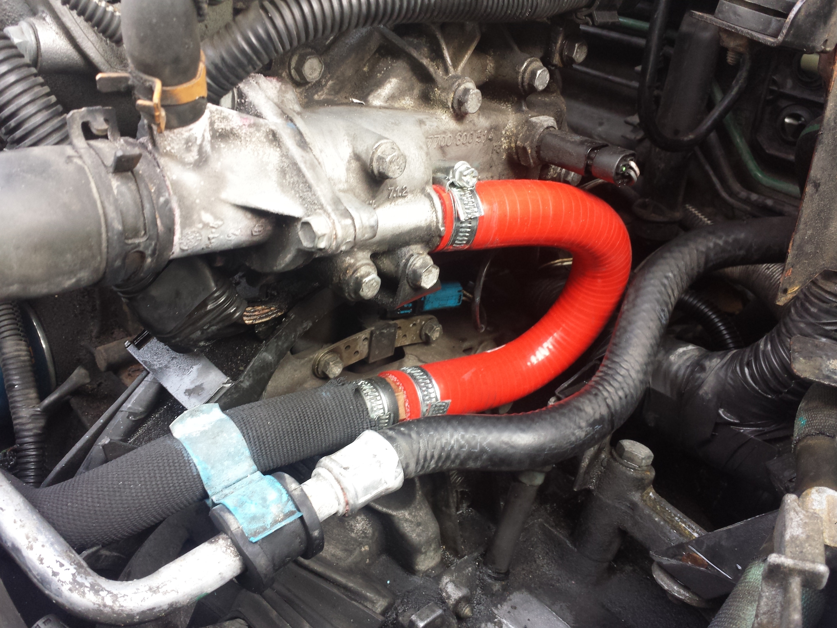

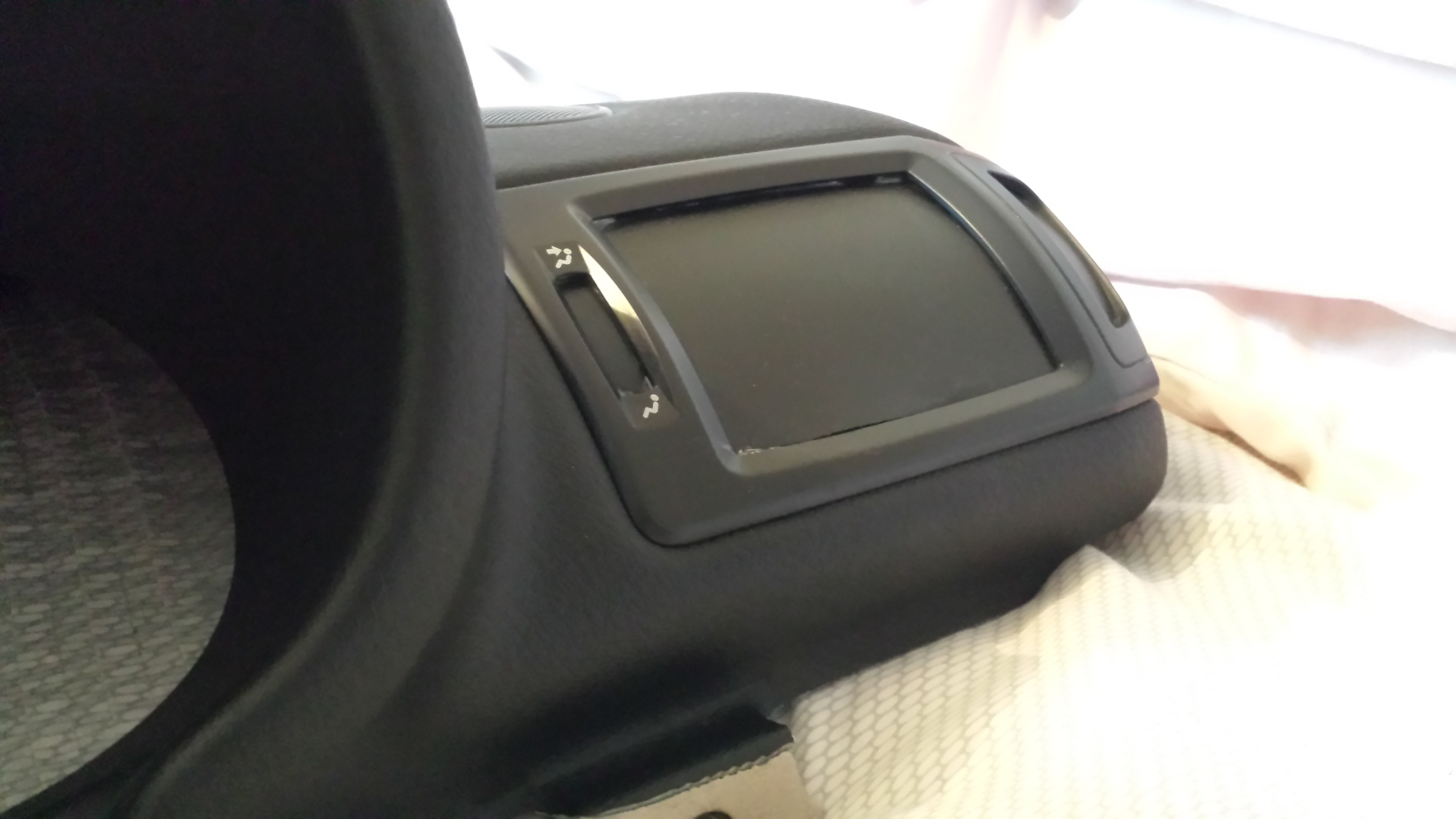

Today was working on car and started to remove carpet and big problem. The foam underneath carpets is soaked in red coolant so obviously the heater matrix is leaking coolant into the car. Solved this by removing the whole system including the aircon which was going anyway.
Had to u bend the two hoses that used to go into the heater matrix......
Also cleaned up,removed sound deadning and sprayed the scuttle panel insides...

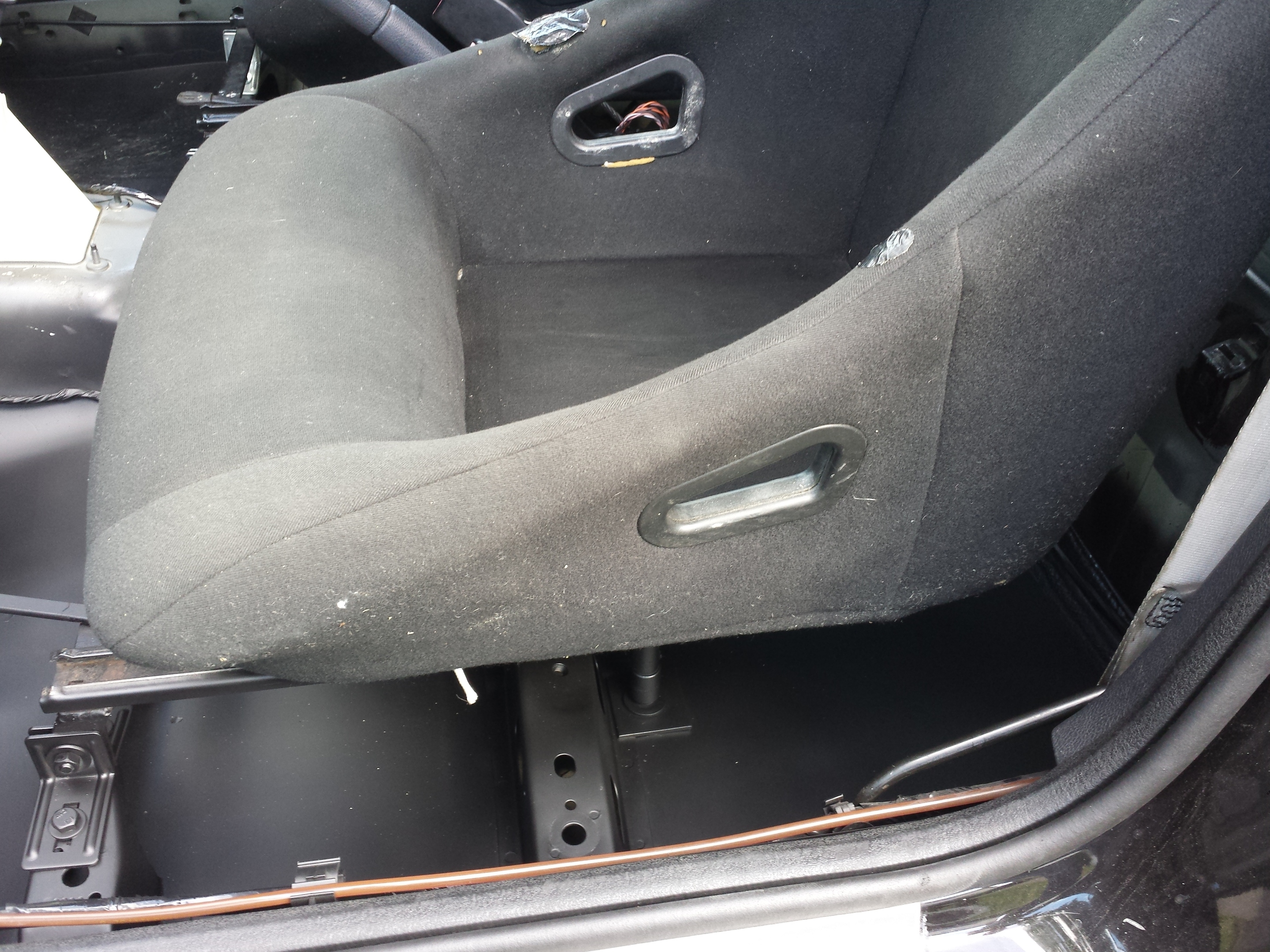

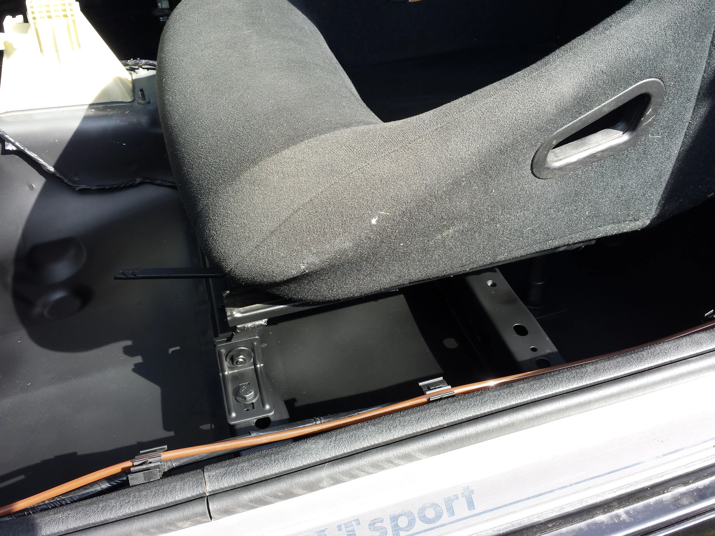

So tonight I managed to fit up my bucket seats.made up my own mounts onto the the sliders.
Also continued on with the floor spraying after removing the sound deadning the other week.

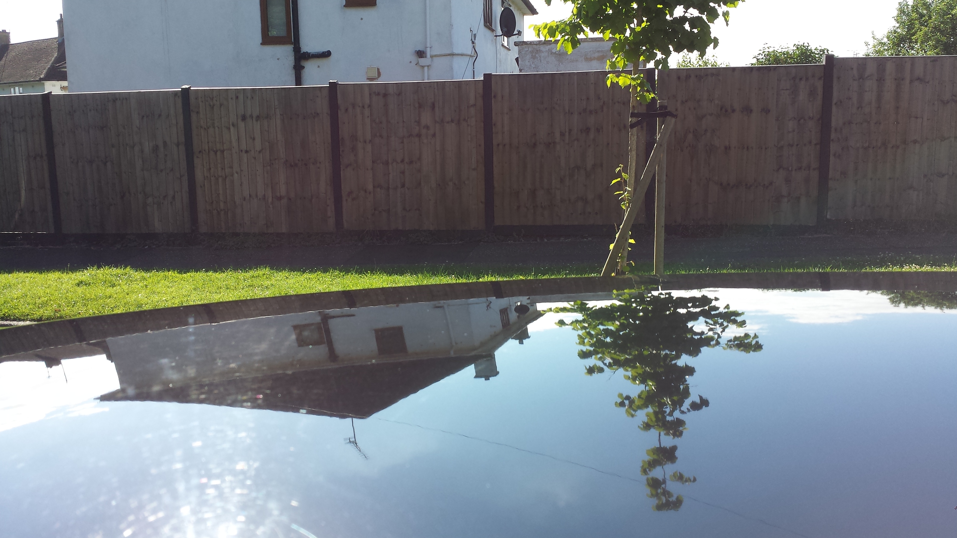

this morning as with every sat before work i washed the clio,but as an extra i also claybarred and resin polished,and waxed to finish.
the results were superb as always with these products.

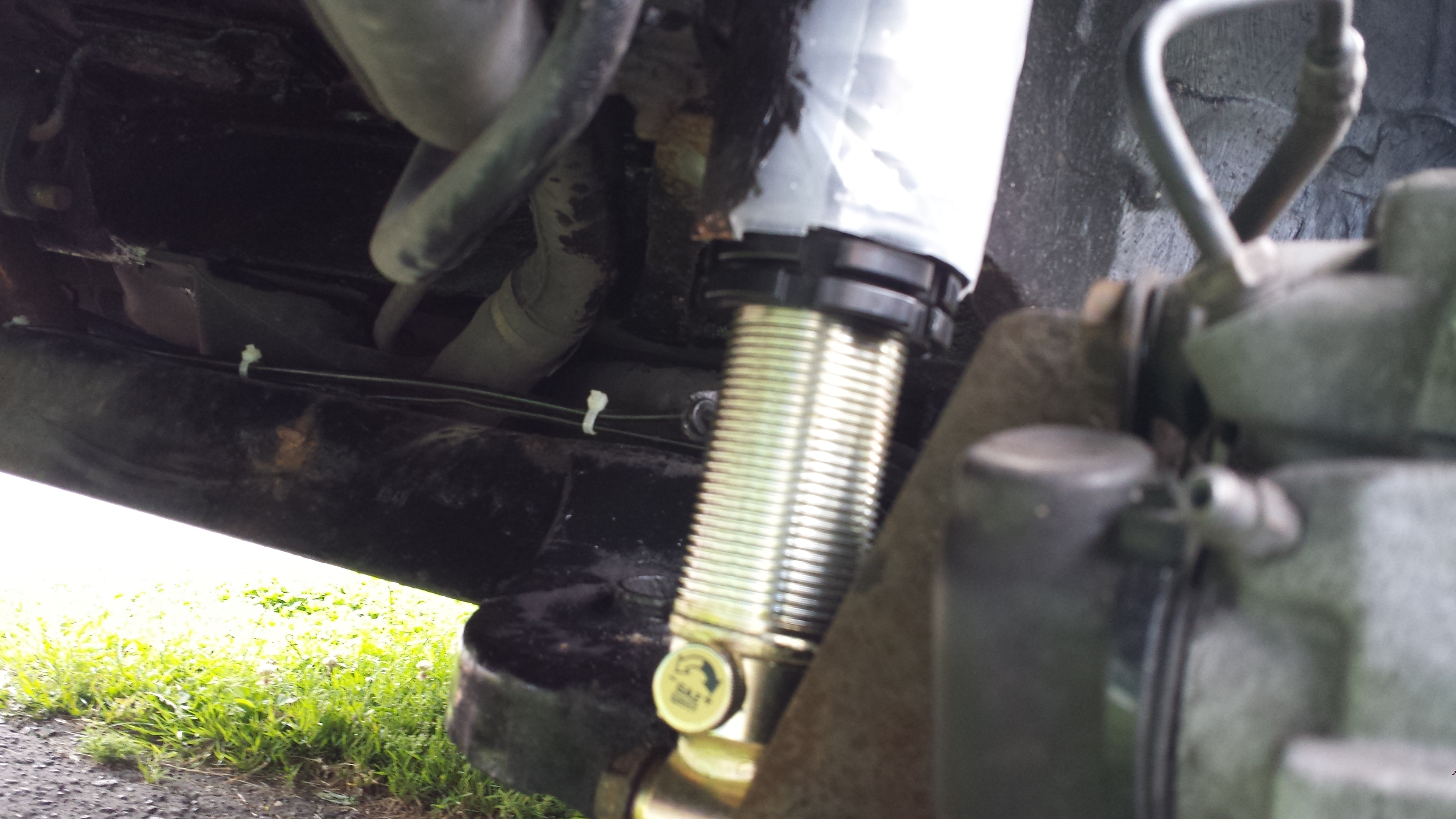

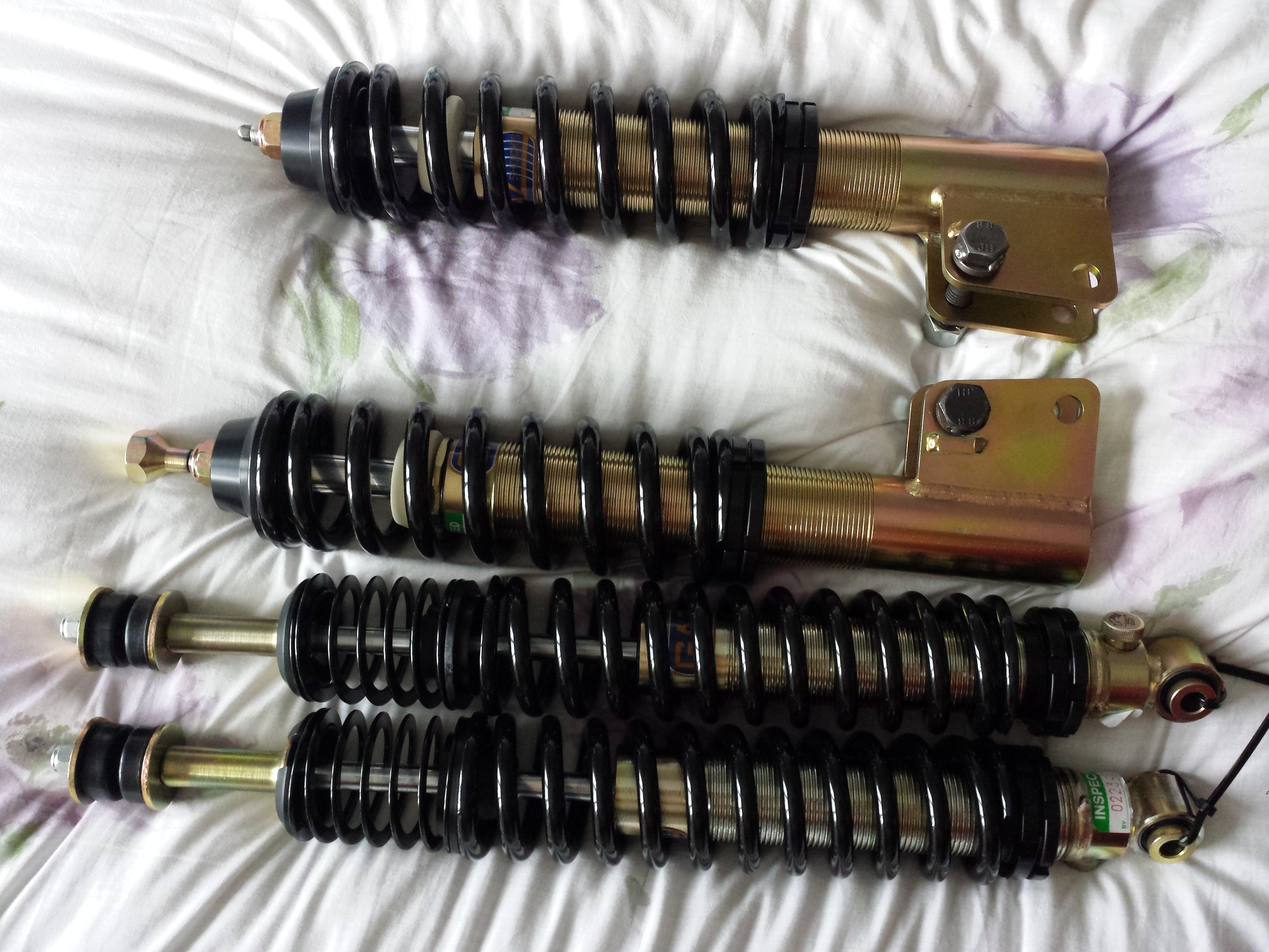

today i managed to get coilovers fitted
430 front lbs
300 rear lbs

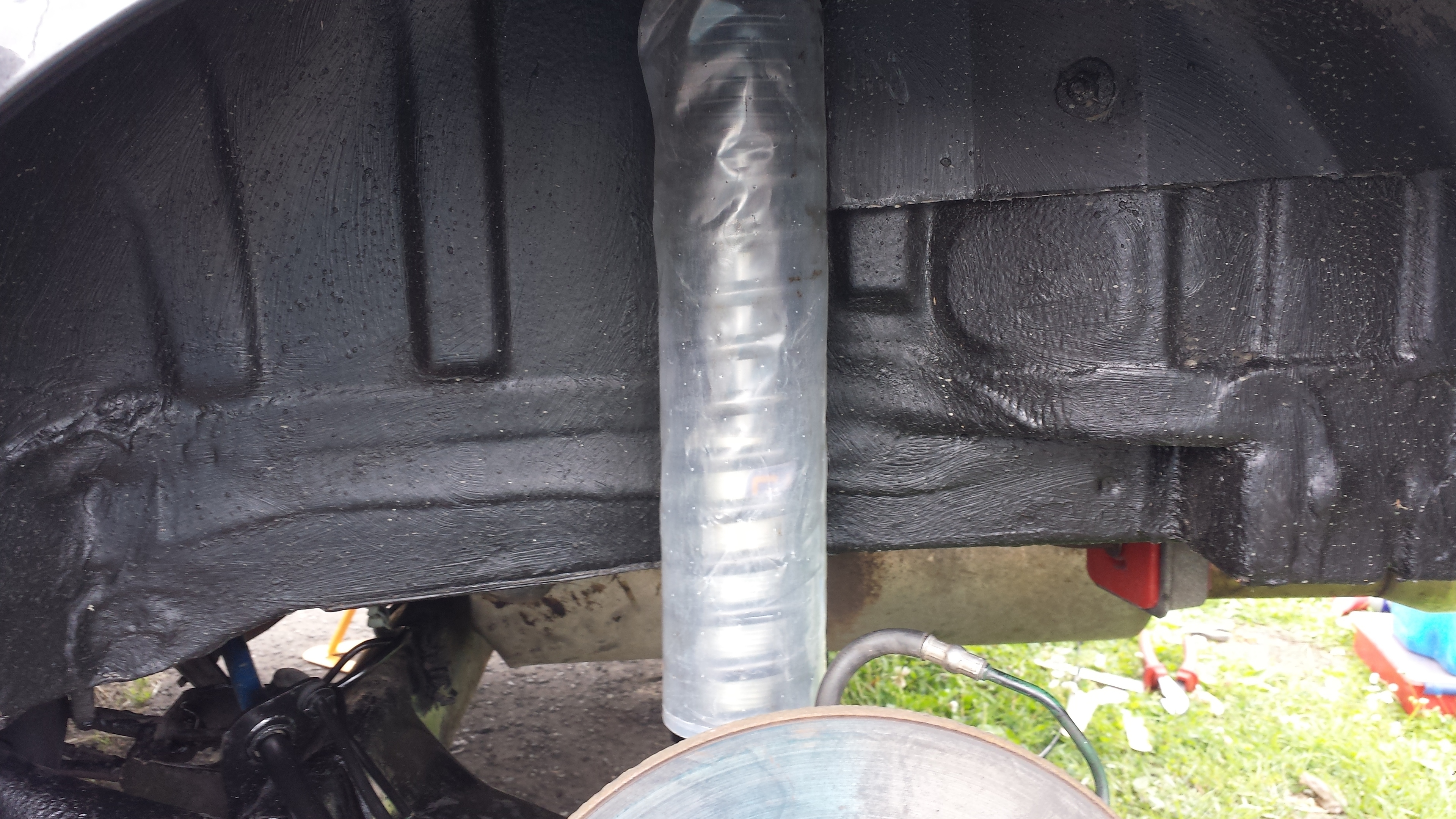

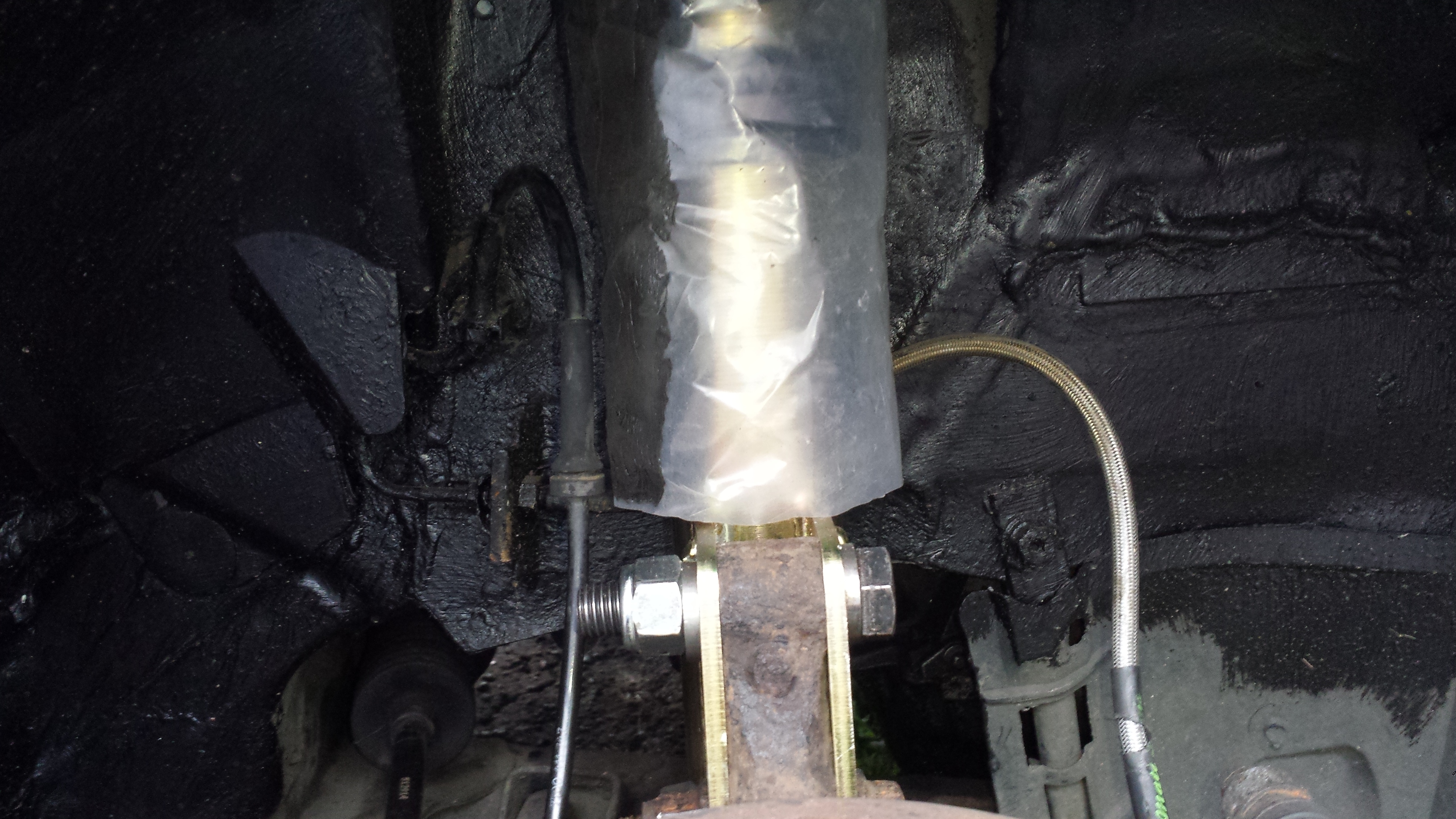

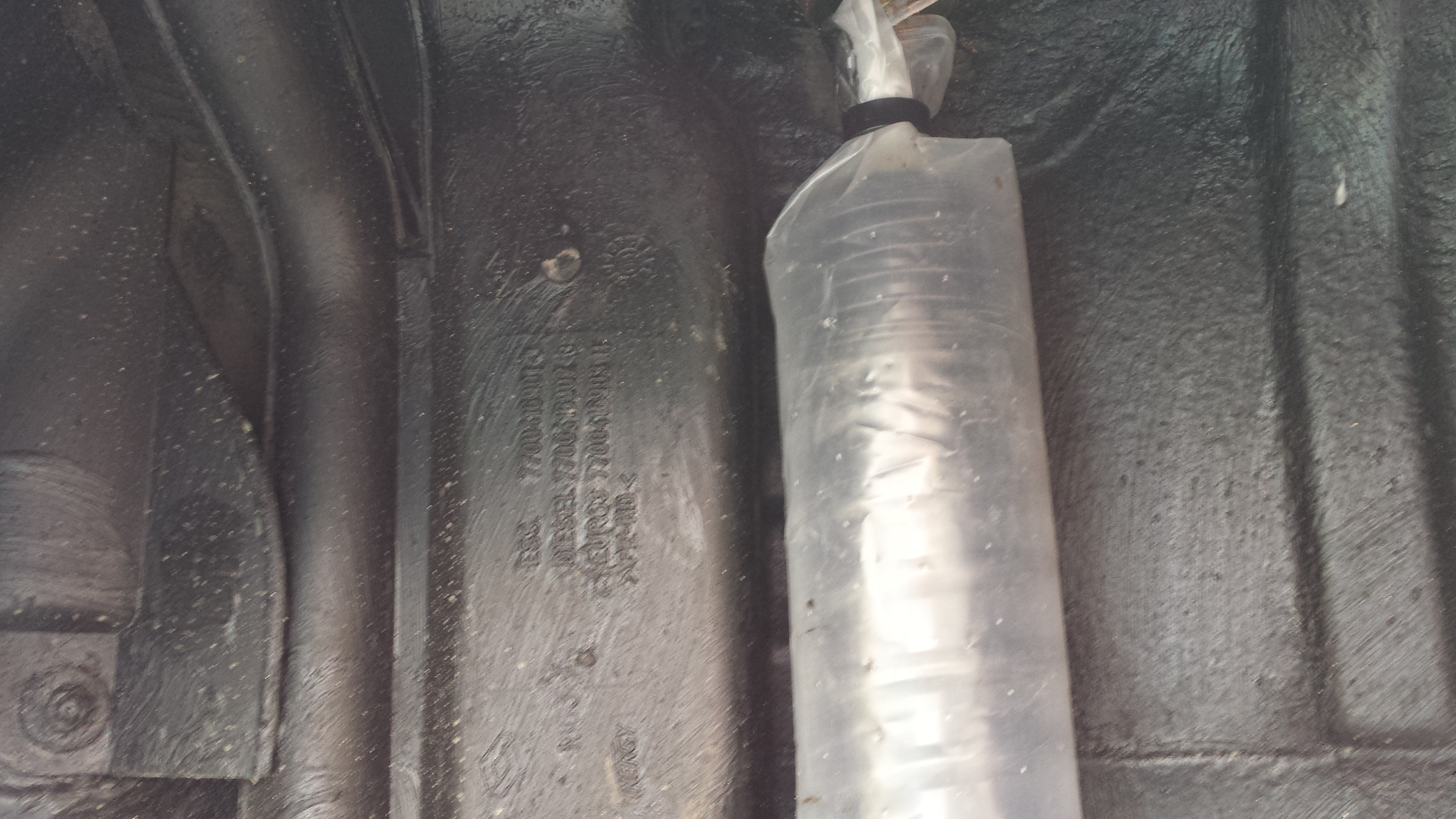

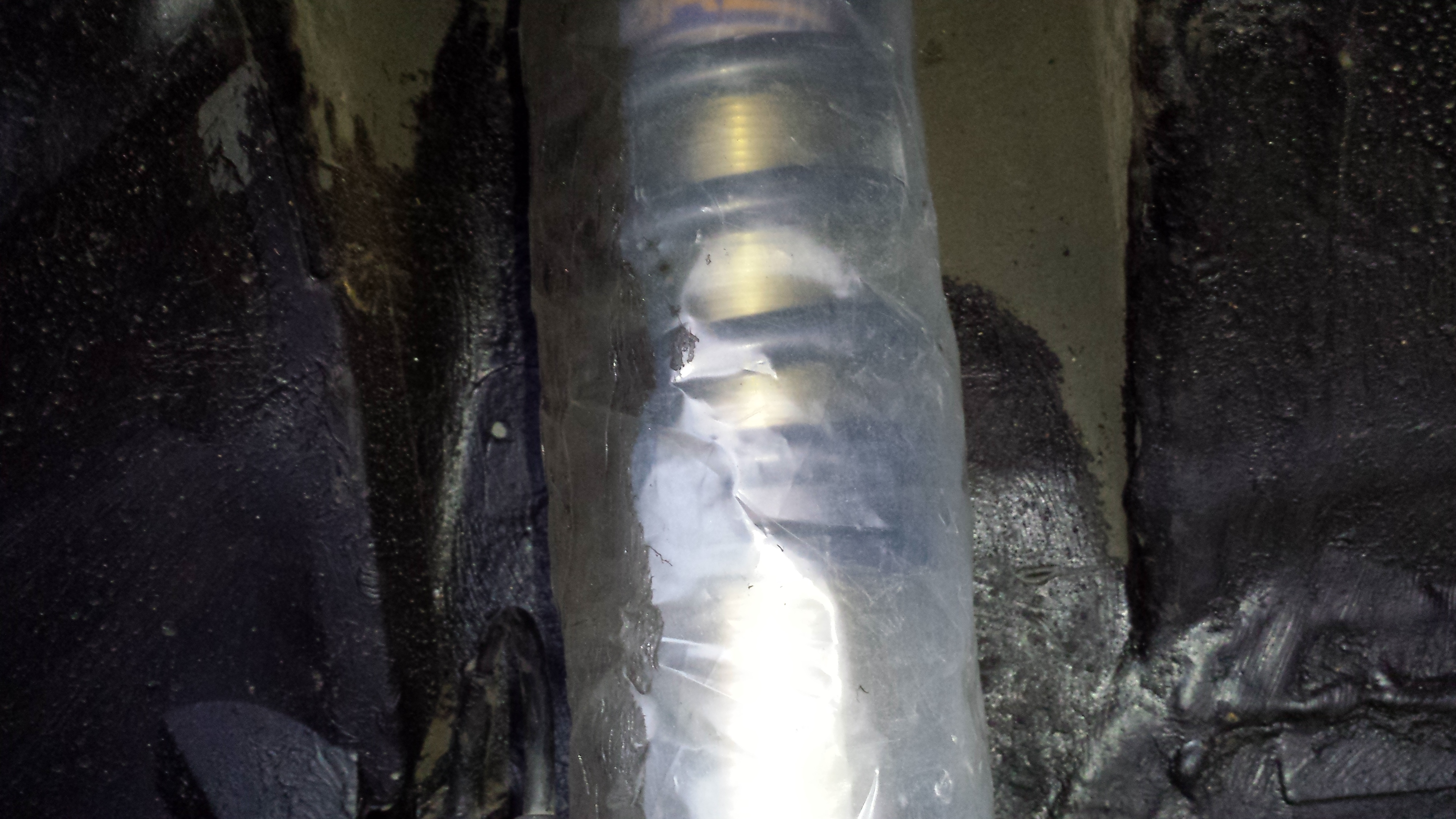

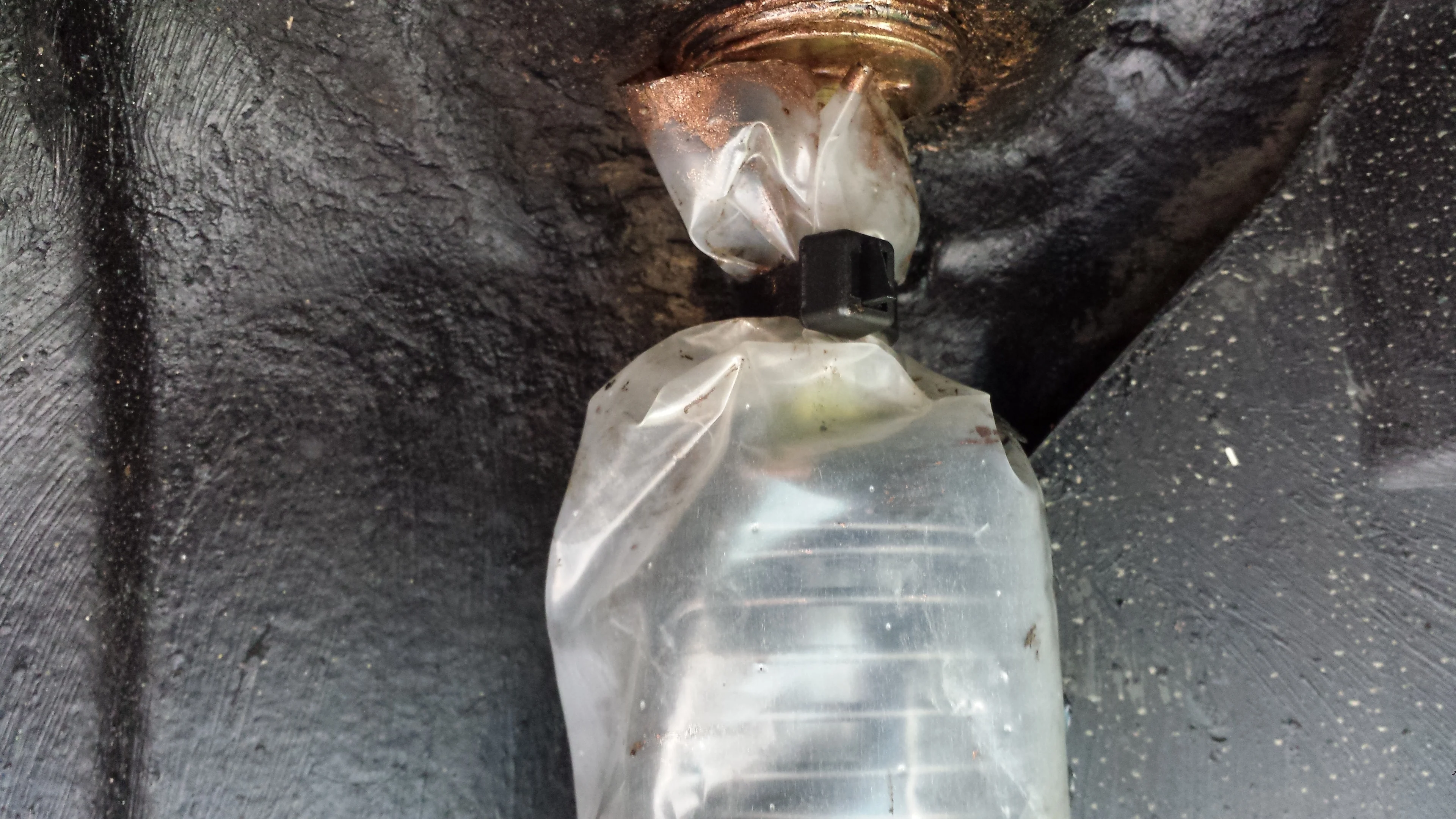

in preperation for fitting these i thought it a good idea to make up some protective sleeves.i made them from thick polyurethane bags and stuck them in a cylinder shape with polyurethane sealant. they have worked real well. also spray painted the rear beam were possible and all parts on the suspension were copper greased were possible also
heres the piccys
fronts are a little high atm so will post pics tommorow once lowered.

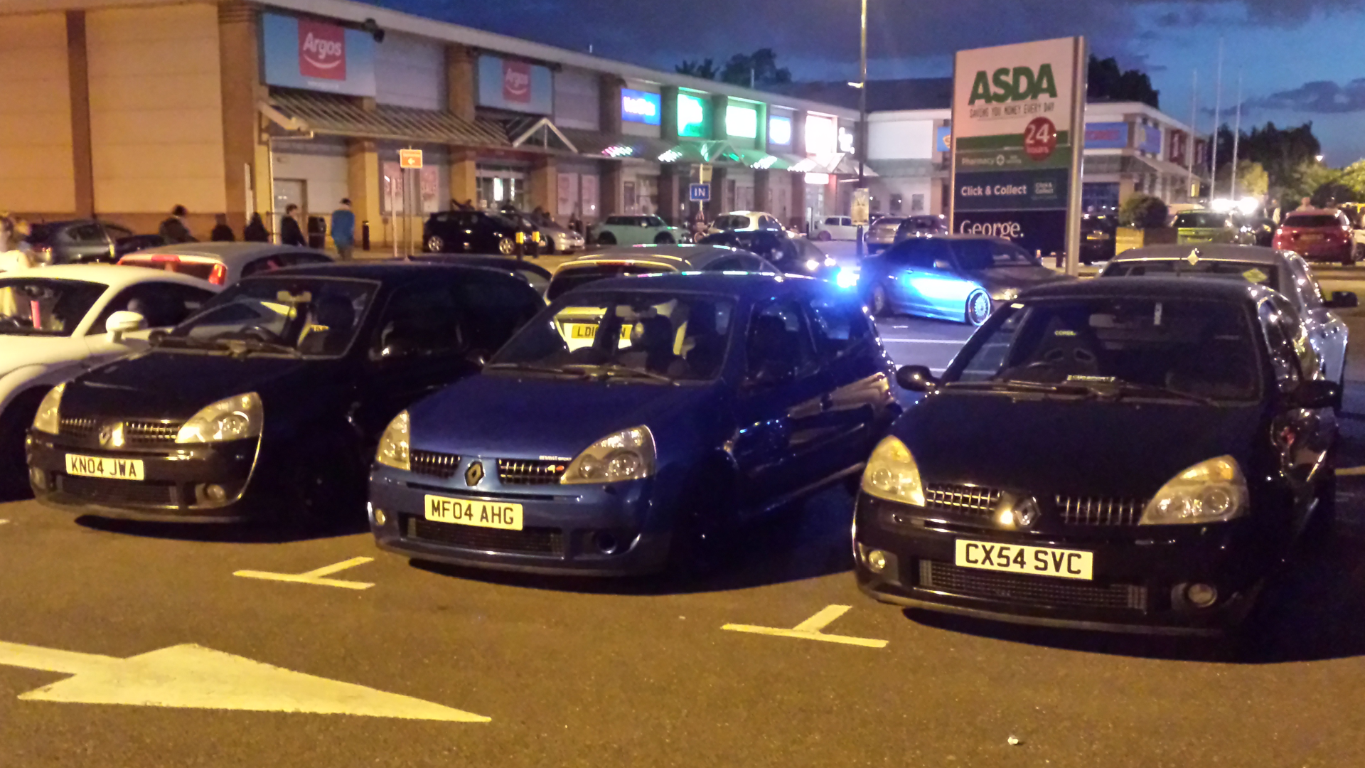

went out with some car mates last night up london to a car meet and there was quite a few nice lil clios. heres a pic

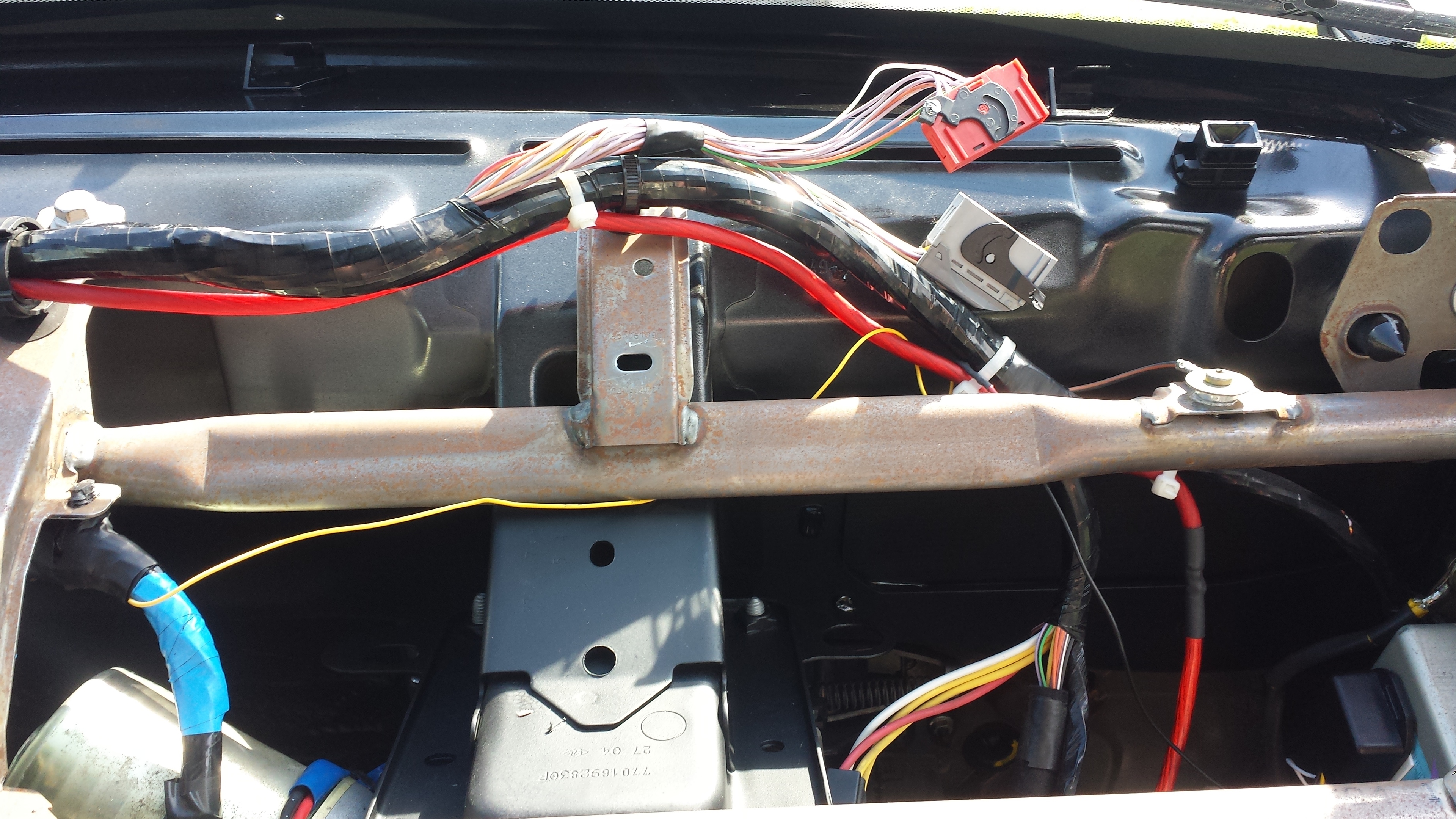

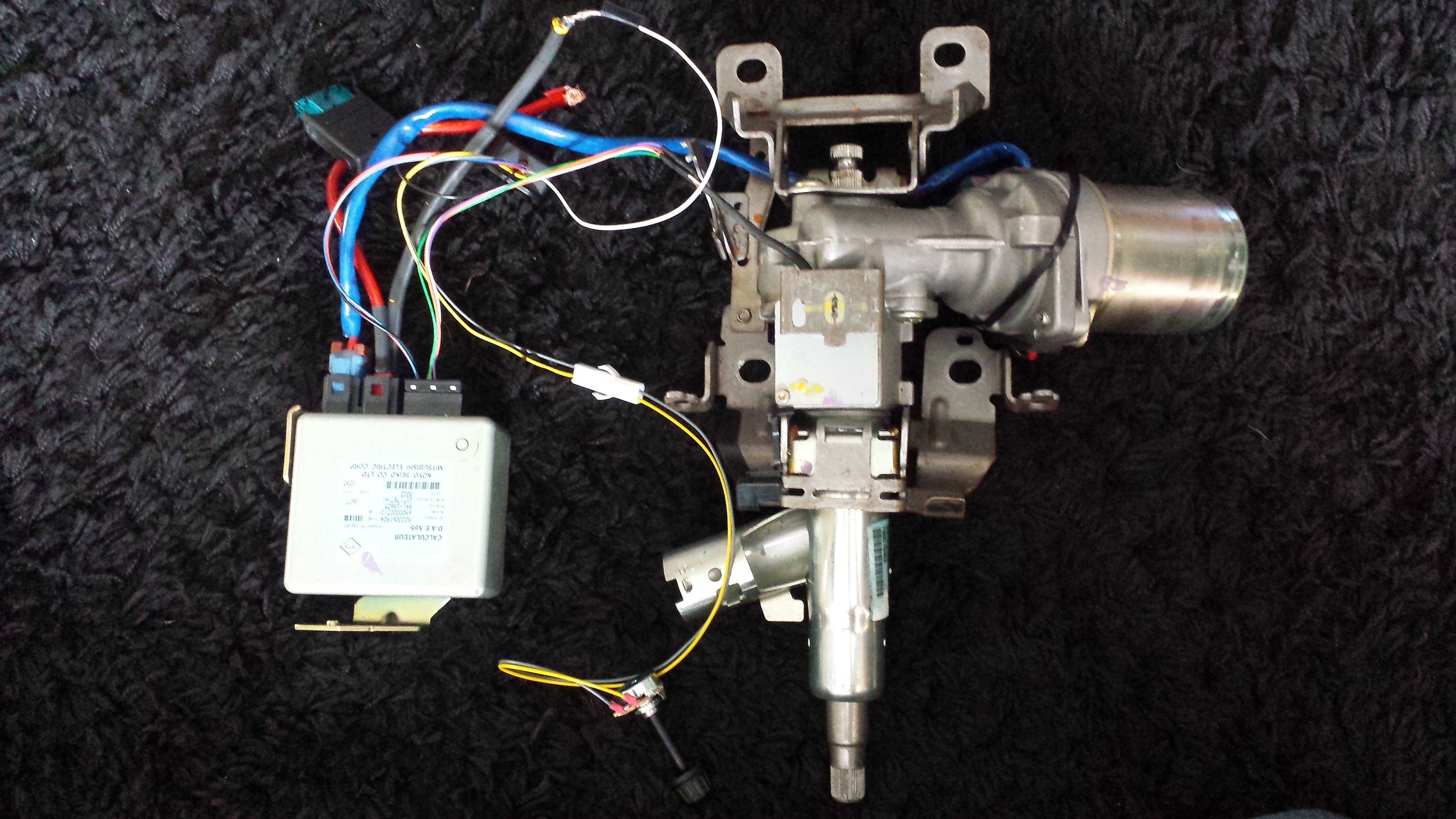

i have been looking into epas recently and have made a few purchases/made up some wiring to make it work,as always all my electrics are soldered and heatshrunk were possible
  2004 clio 182
so ,so far i have aquired
epas and epas ecu from 2001-2005 clio
epas control unit (from ebay guy in portugal
steering column from 2001-2005 clio with epas
made up power lead and earth lead with giant spade connectors
also a mega fuse (60 amp)

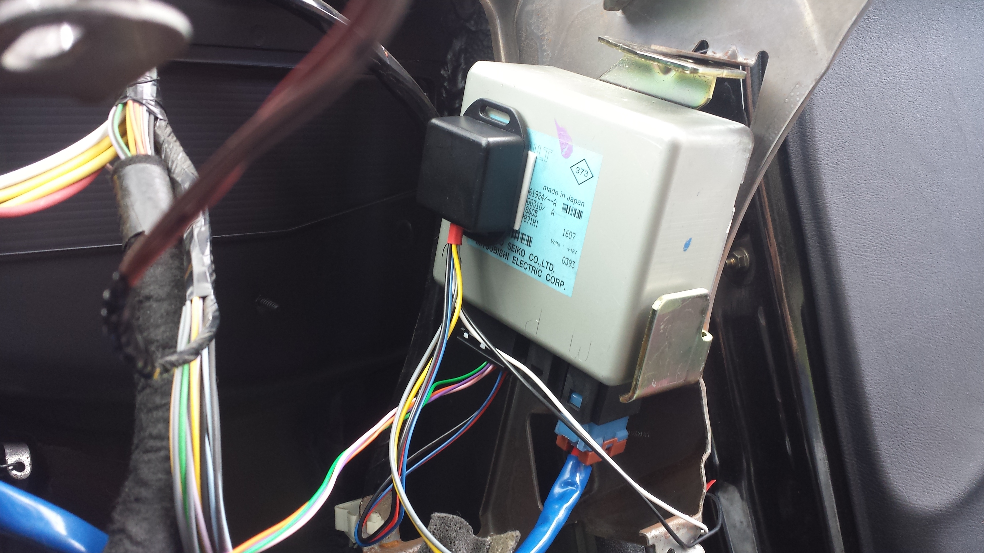

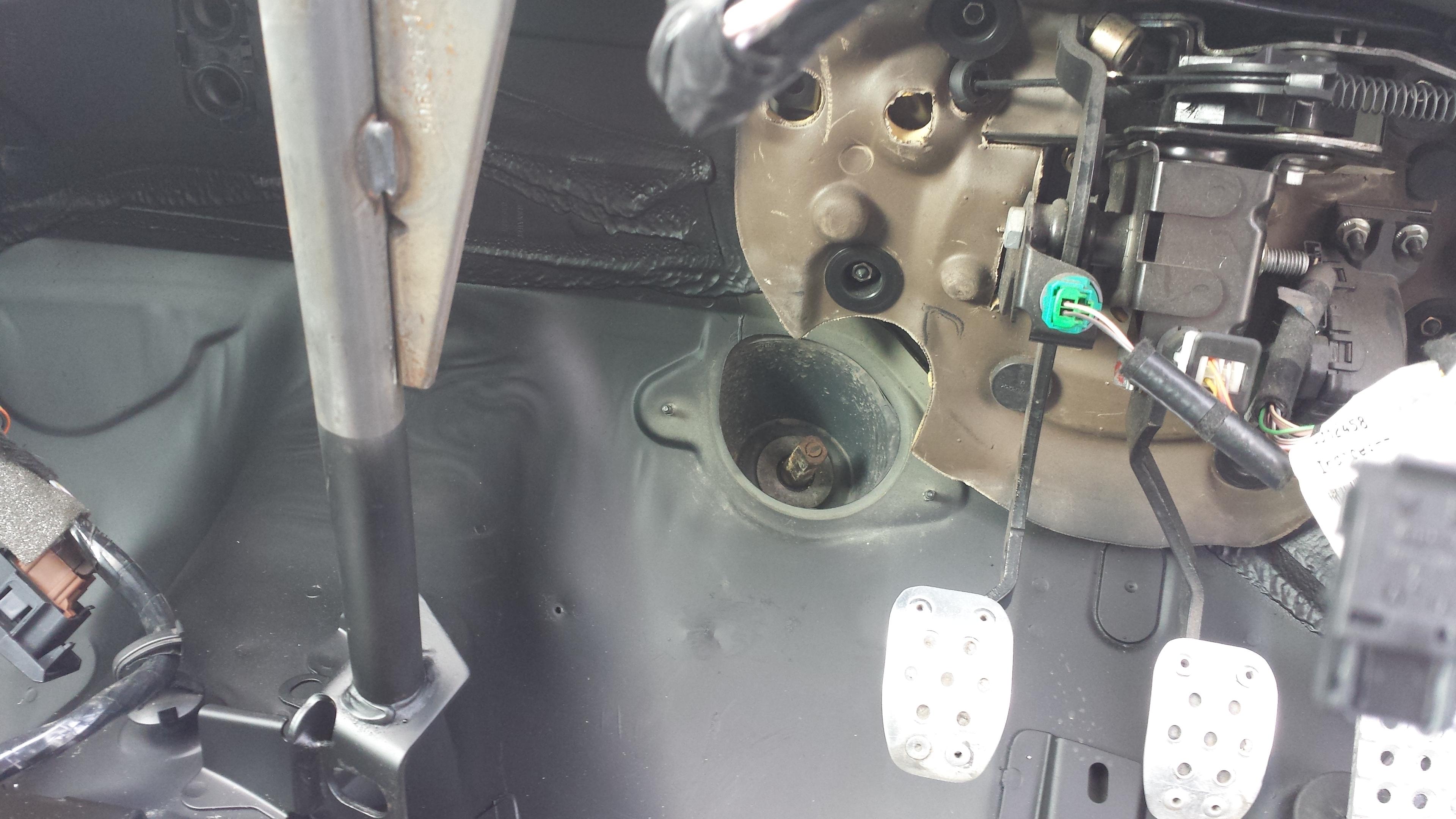

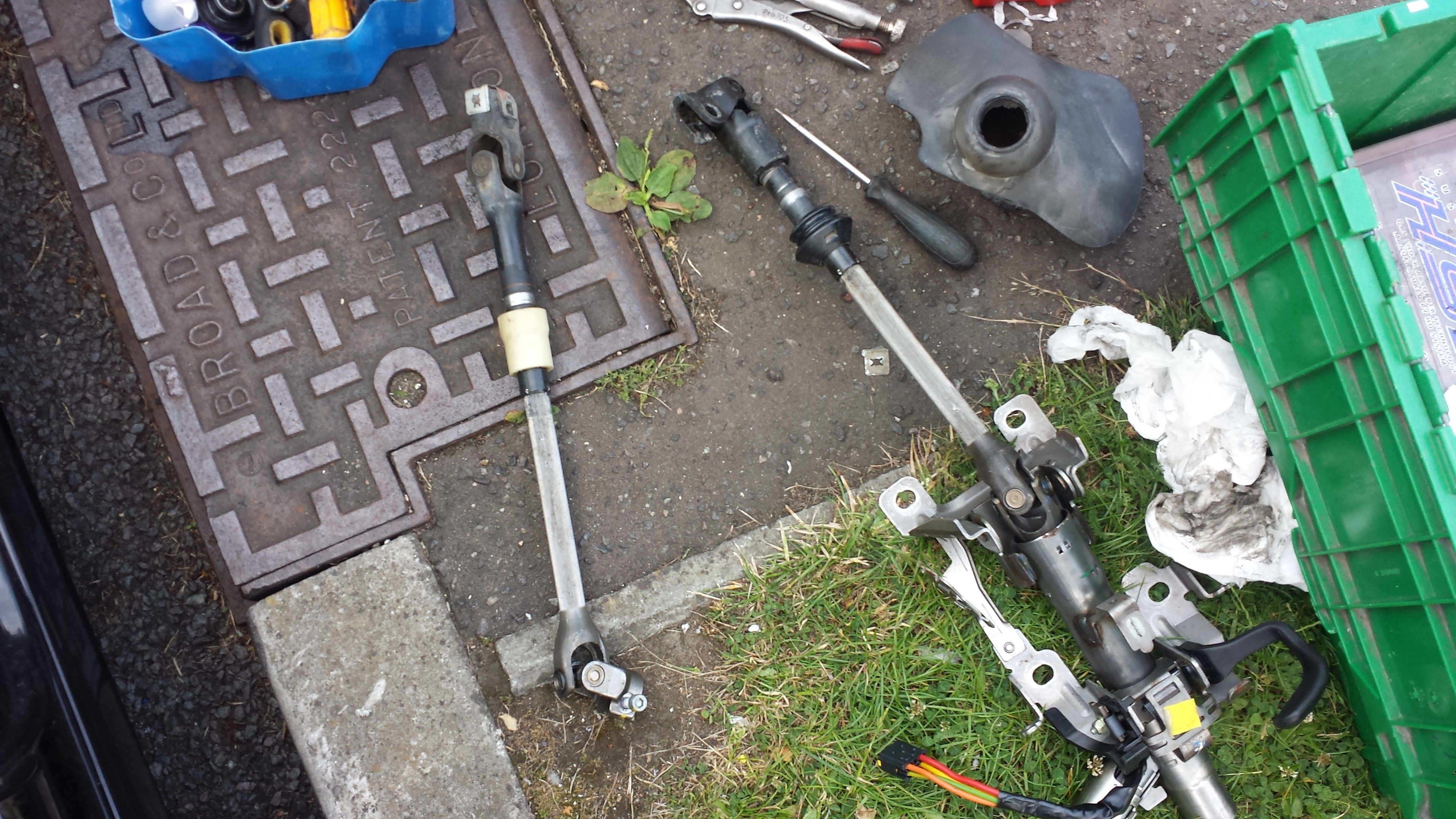

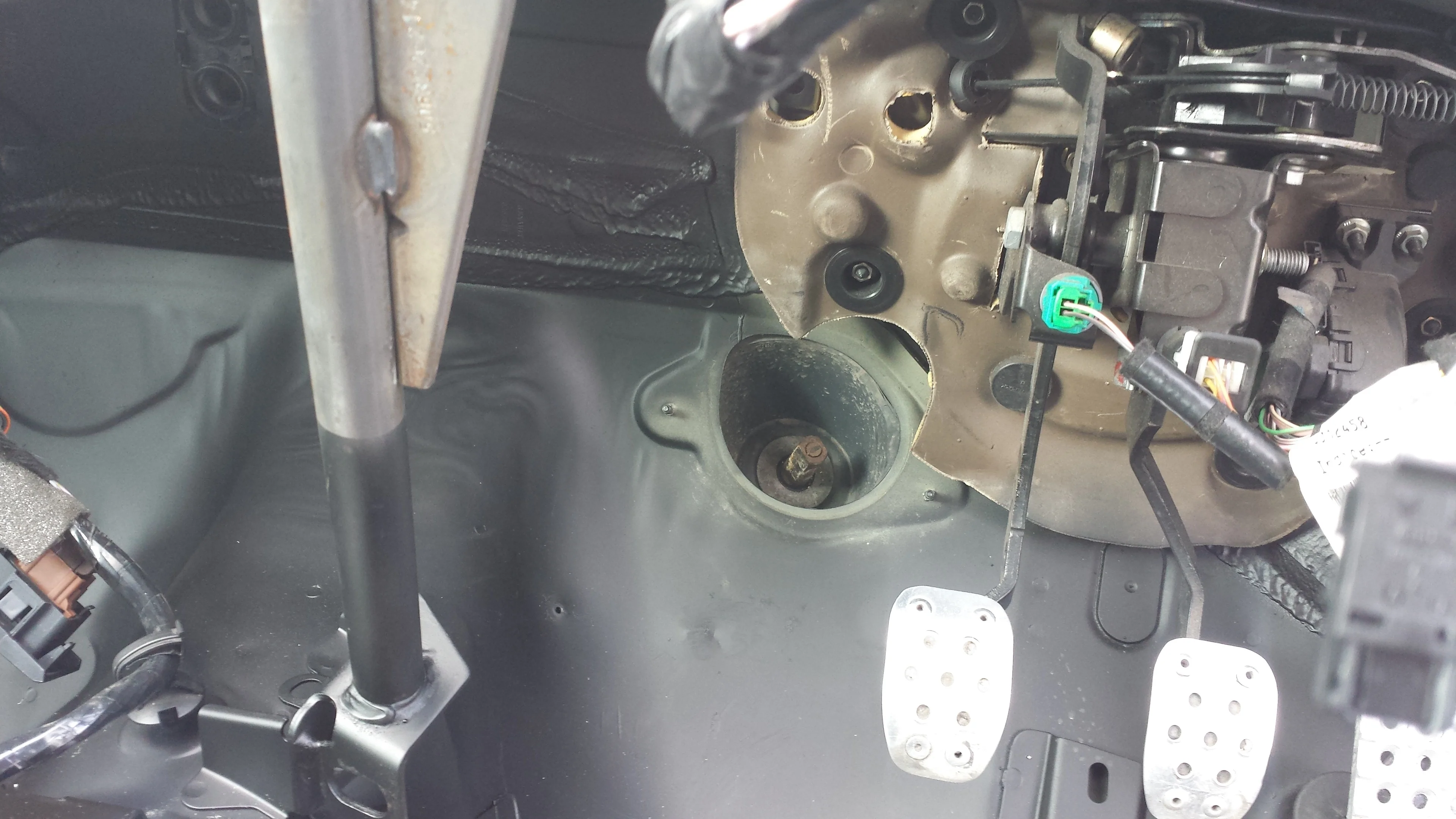

this morning i continued on with fitting the epas.

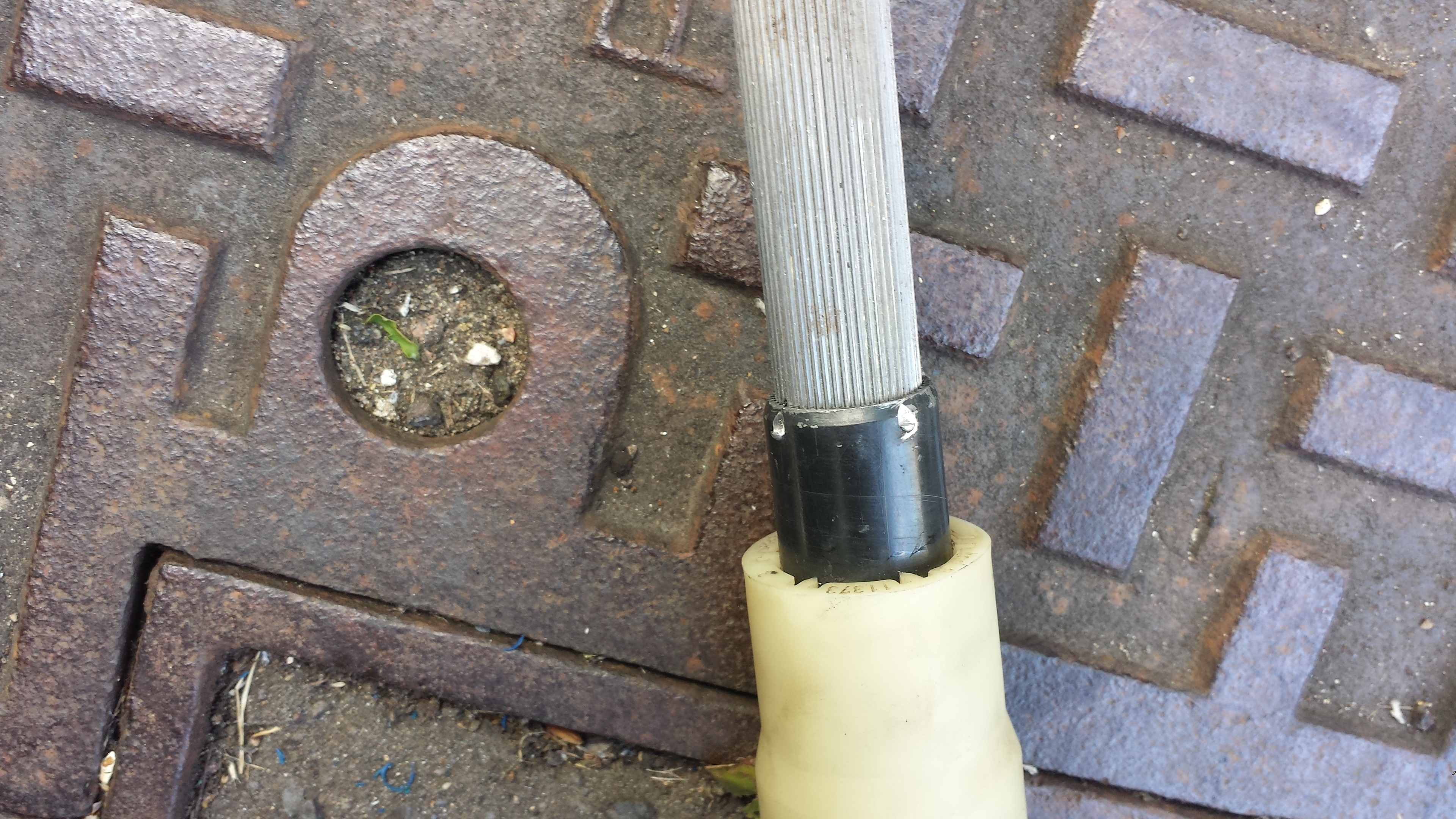

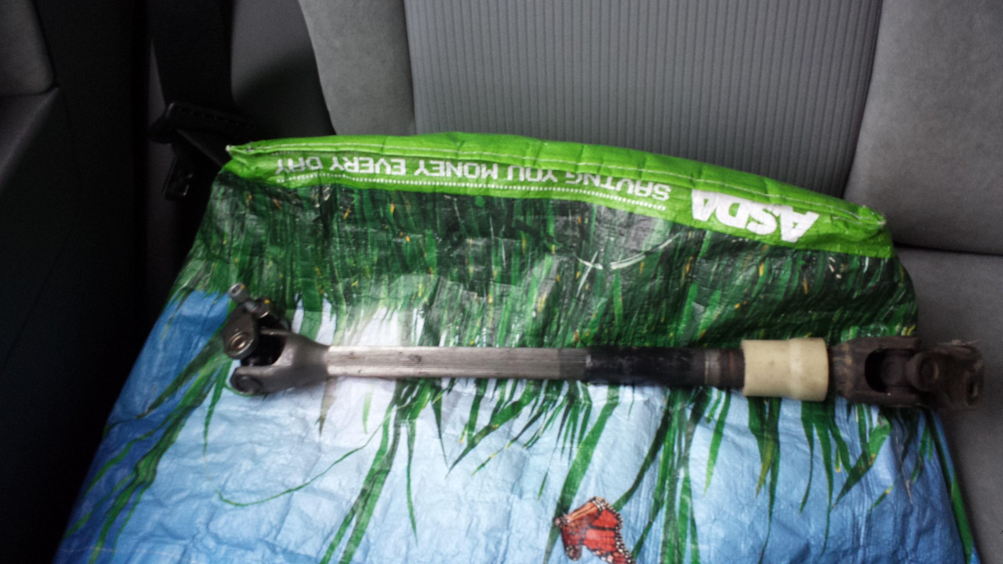

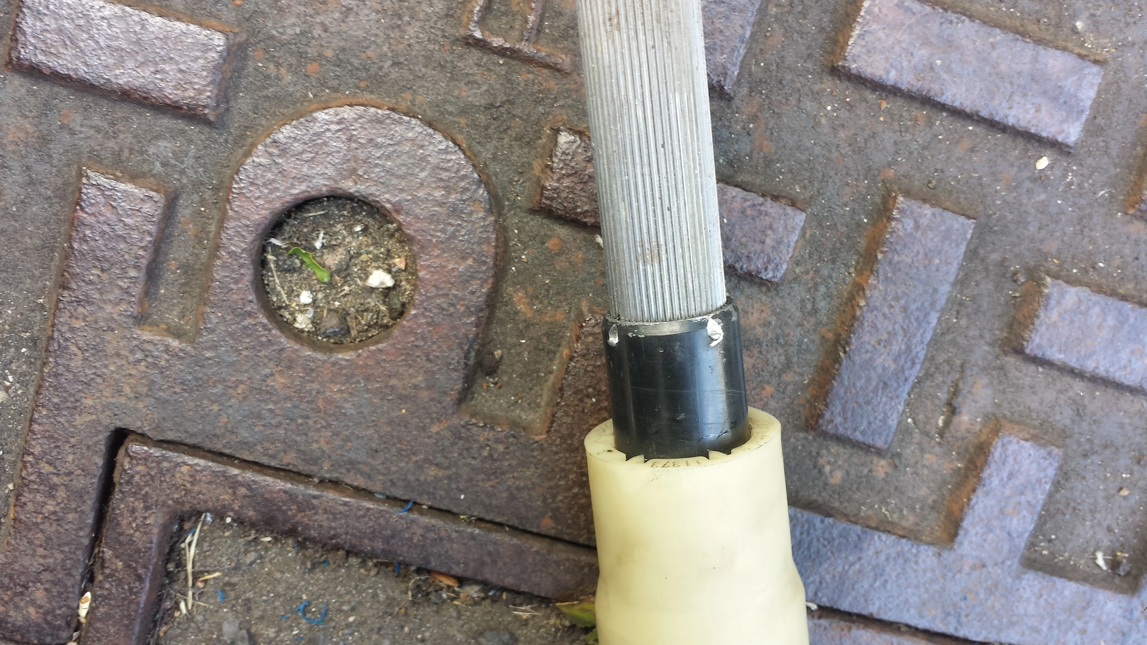

when i went to fit the the new colomn i realised it was about 6-7mm to long but this is easily remided buy carefully tapping the the column with both universal joints moved to one side to slowly shorten it.
be very careful not to go to mad otherwise you will have to short of a shaft and you cant relengthen it. below shows were the two parts "sleeve" each other.

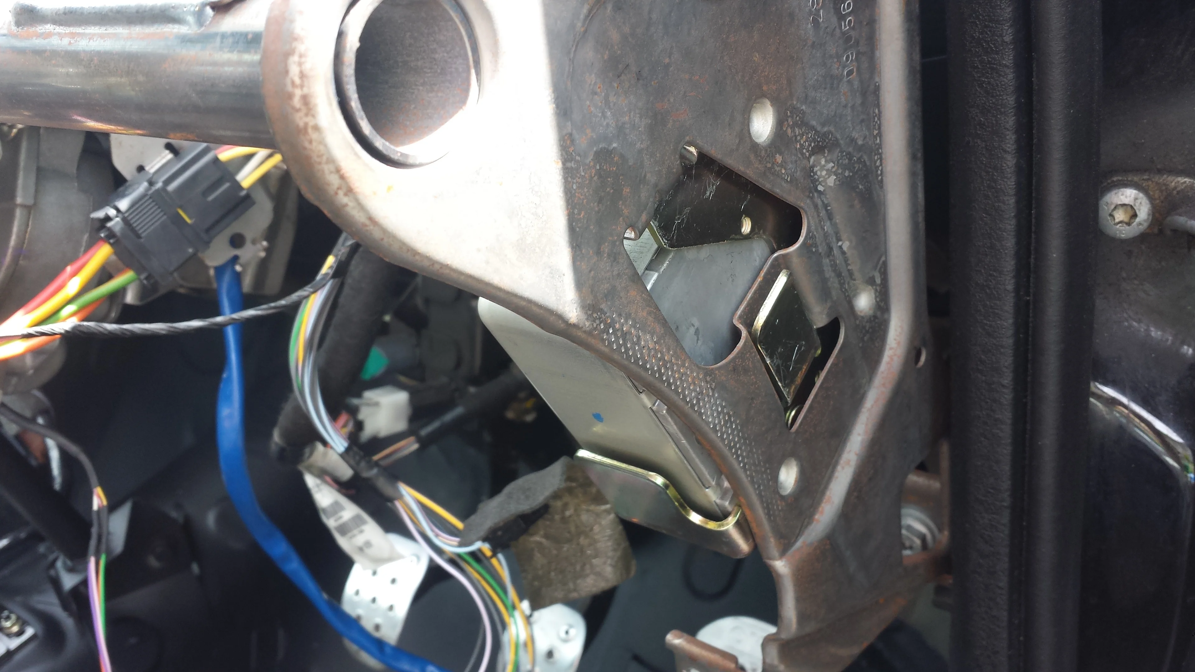

  2004 clio 182
finally got shaft correct length and went about fitting the epas unit (after many on and offs getting it right) and then fitting all the indicator units,ignition barrel,etc onto the new unit.Next up was fitting the epas ecu to a save place which is actually fits to the right of the steering wheel in a purpose made bracket already there
then wired in a switched live to the control box,and an earth linked up to the epas ecu.then the positive was run up to the battery.
at this stage it was all powered up and ready so i tried it with just the adaptor boss and one hand and wow.cant believe just how bloody good it is.
now all thats left to do is get all the dash back in and get out on the road and try it with the engine on and car actually moving lol.

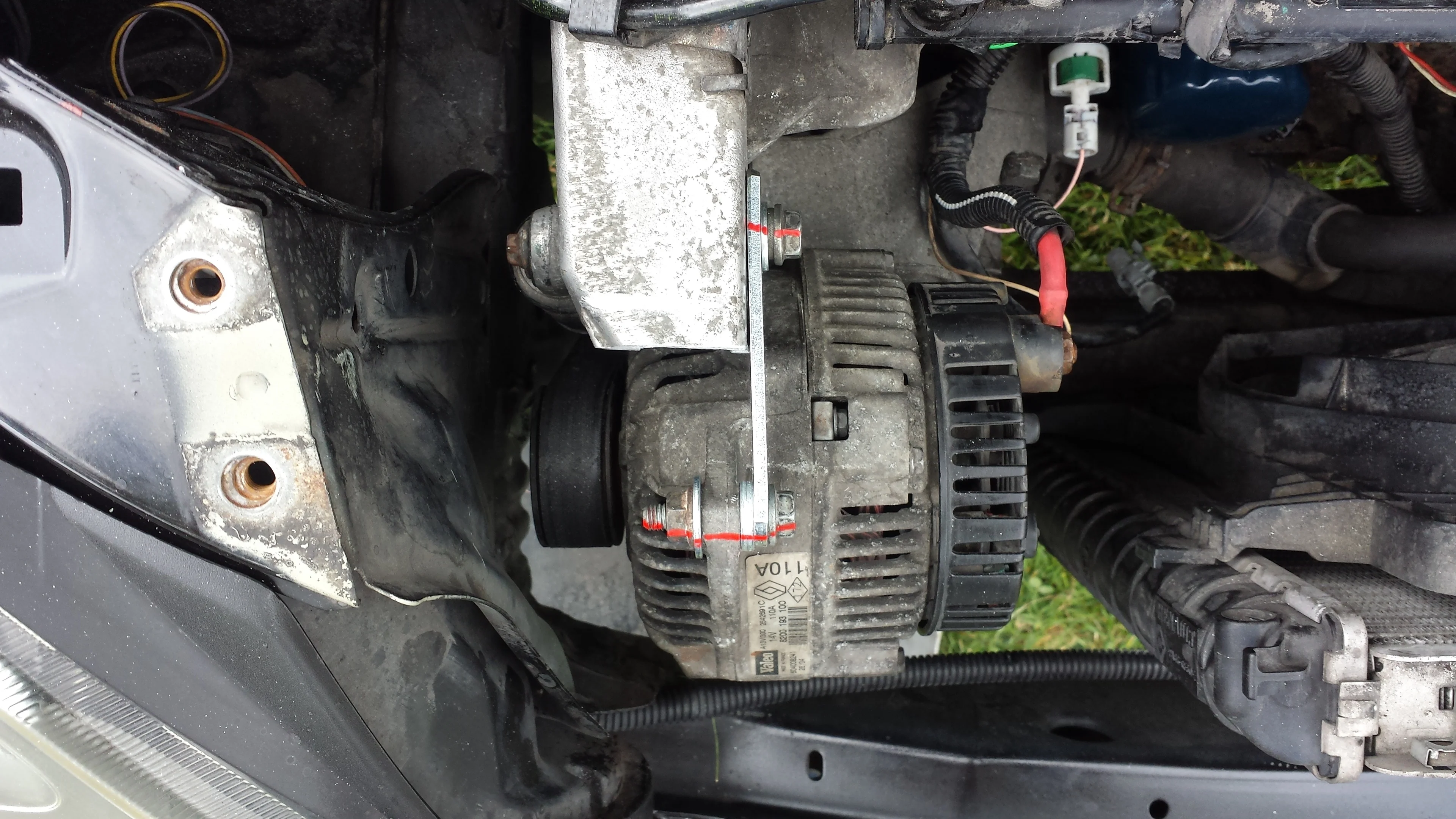

  2004 clio 182

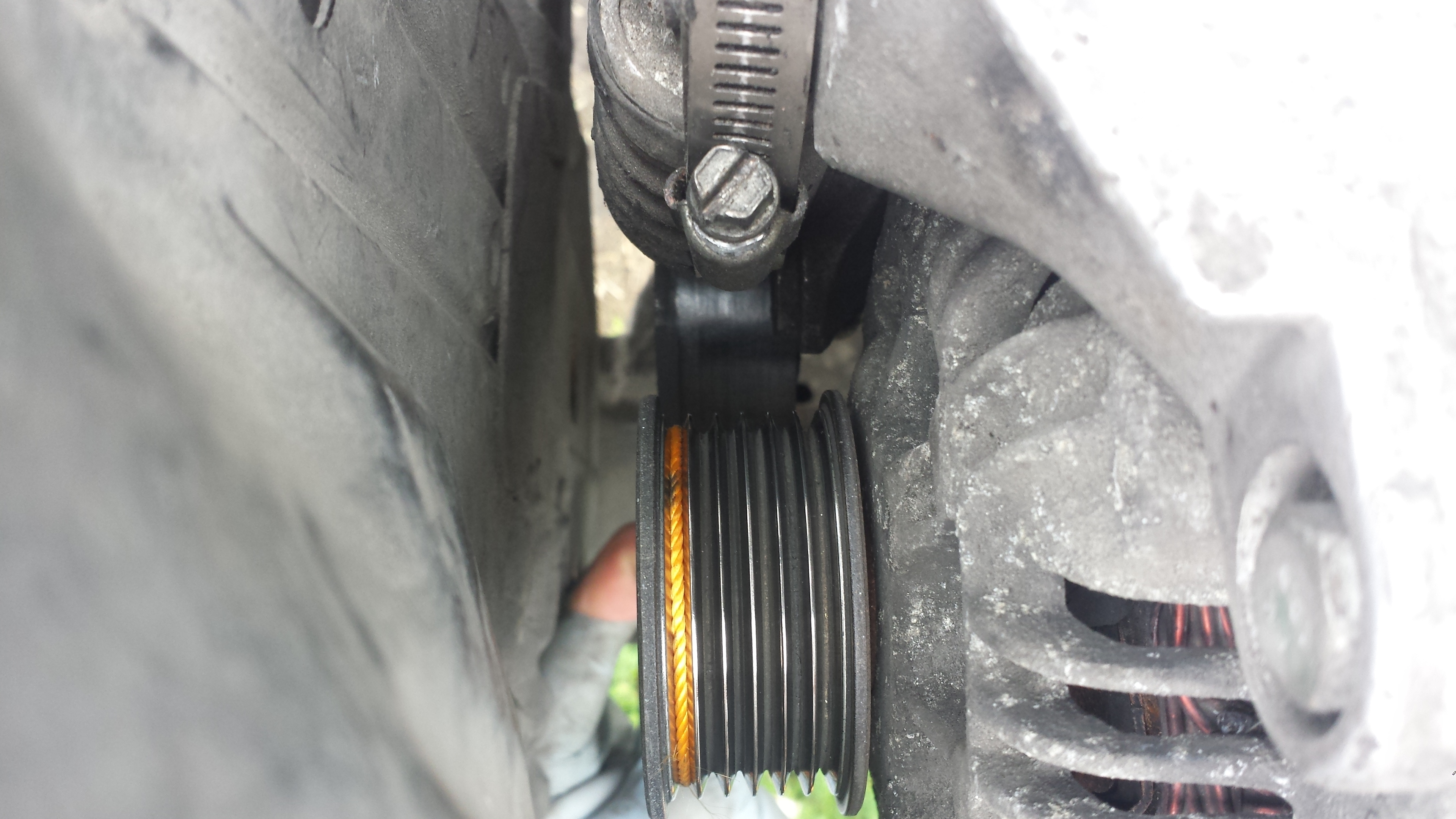

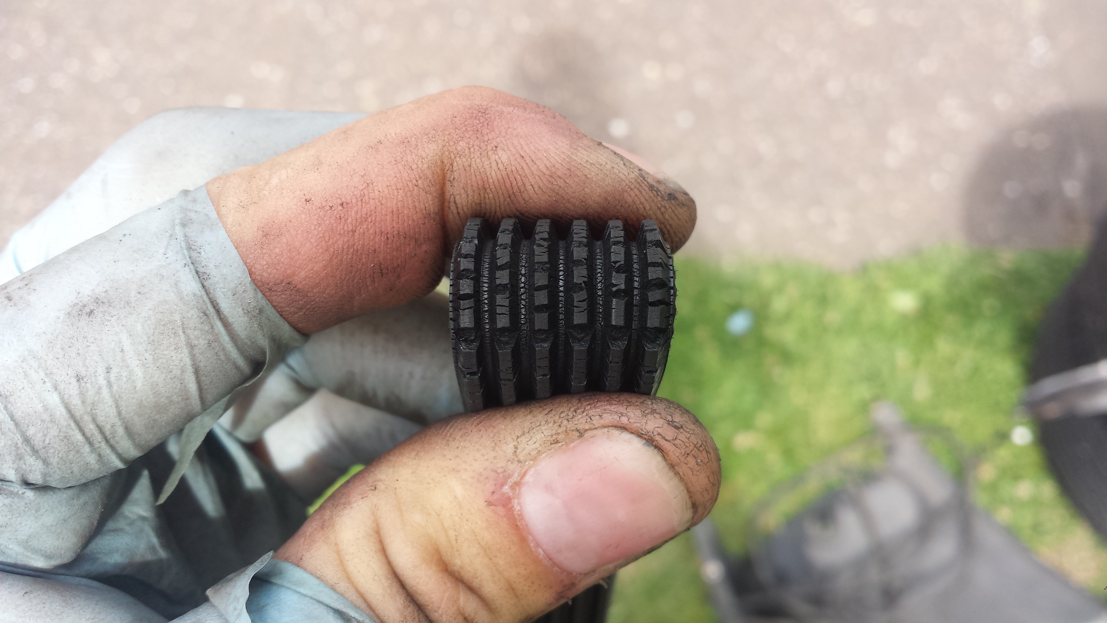

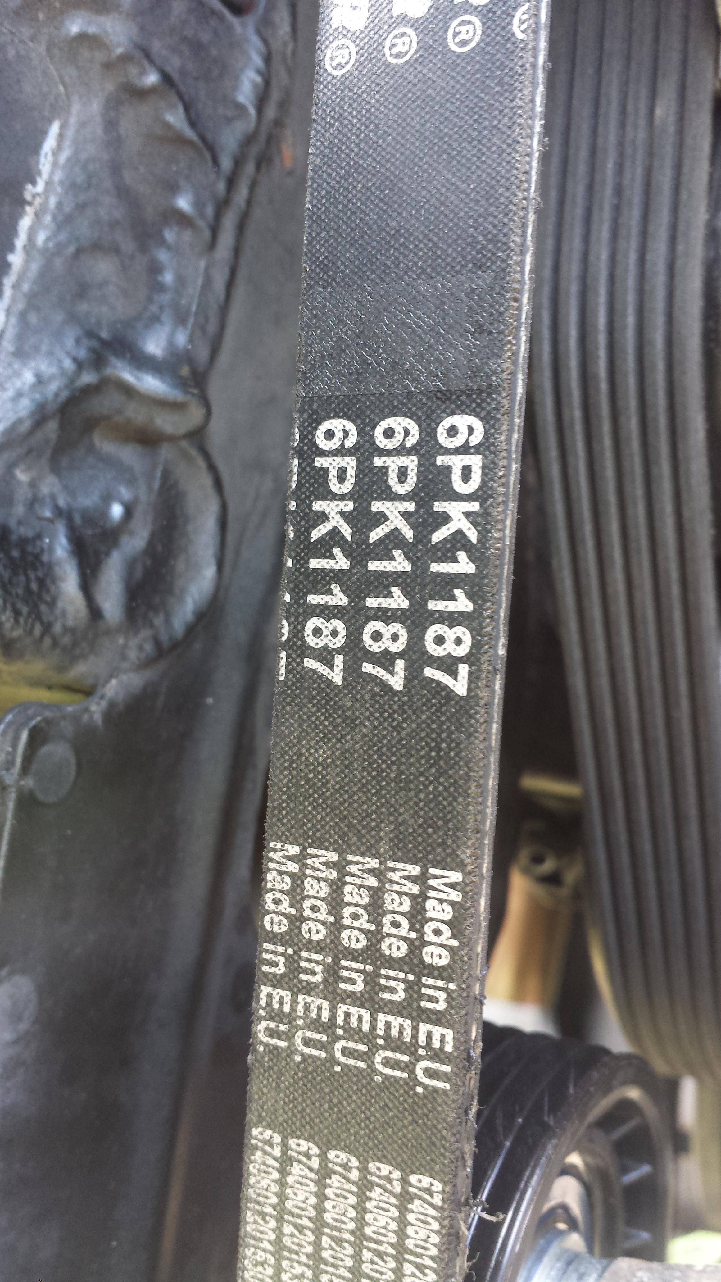

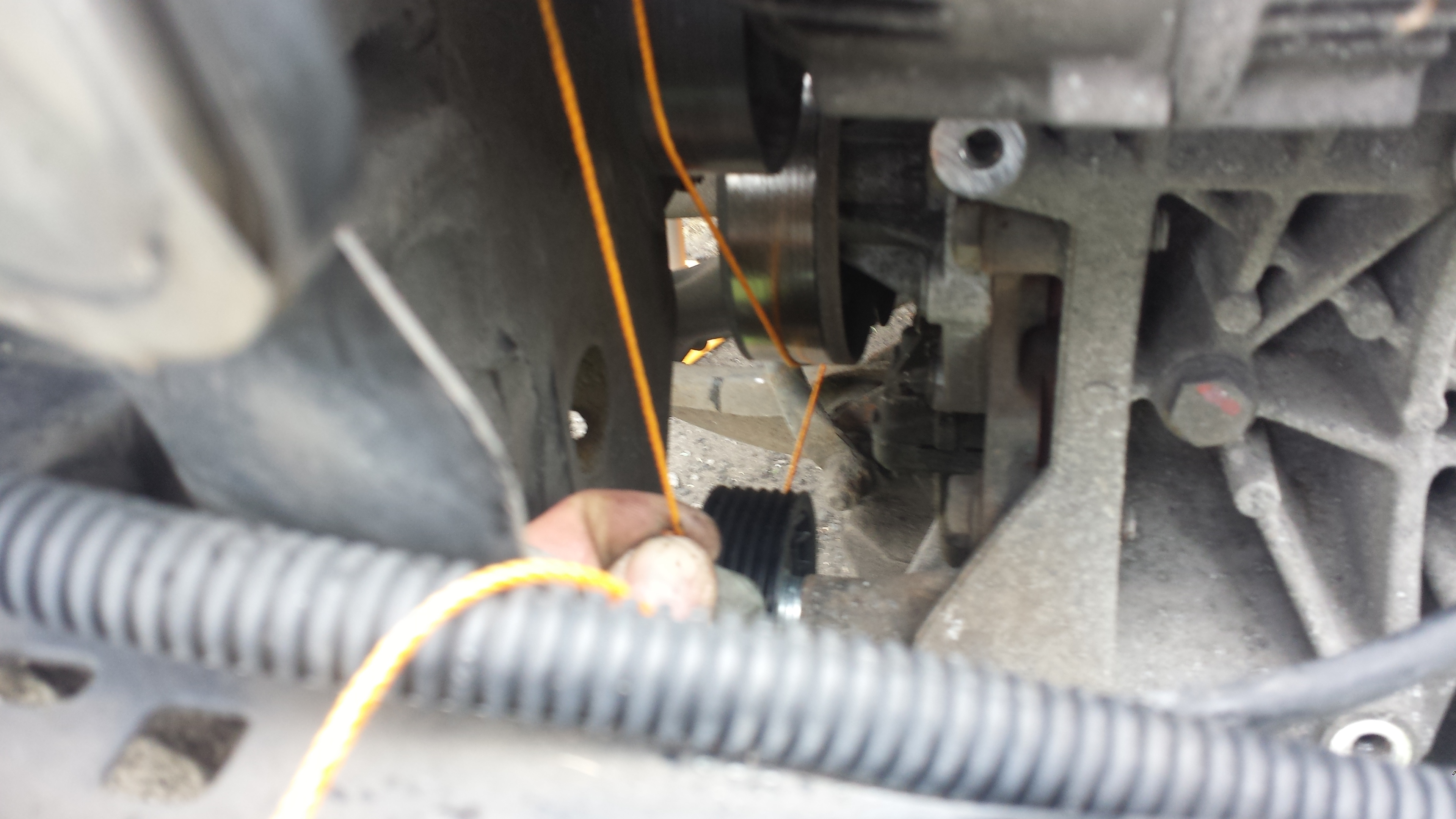

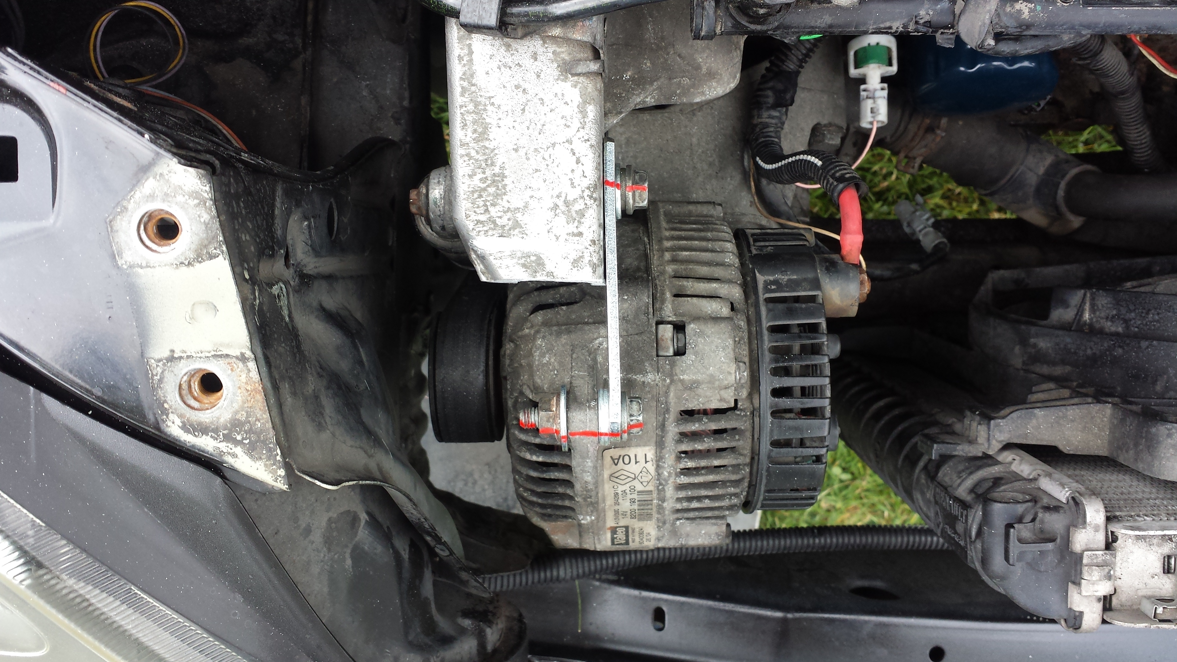

yesterday i had to remove the hydraulic power steering, remove the pump,remove the air con pump, air con rad and also work out new belt size using string method.THe old belt was knackered anyway so just aswell i replaced it haha.........all this took all day as it was mostly awkward places to get to and trial and error.
after many many hours and few swear words its all finally sorted and a newly fashioned tensioner is in full working order.
for reference belt used is 6pk1187 and also the original tensioner is left in but does need a little bit of alloy filed away or it rubs the belt.

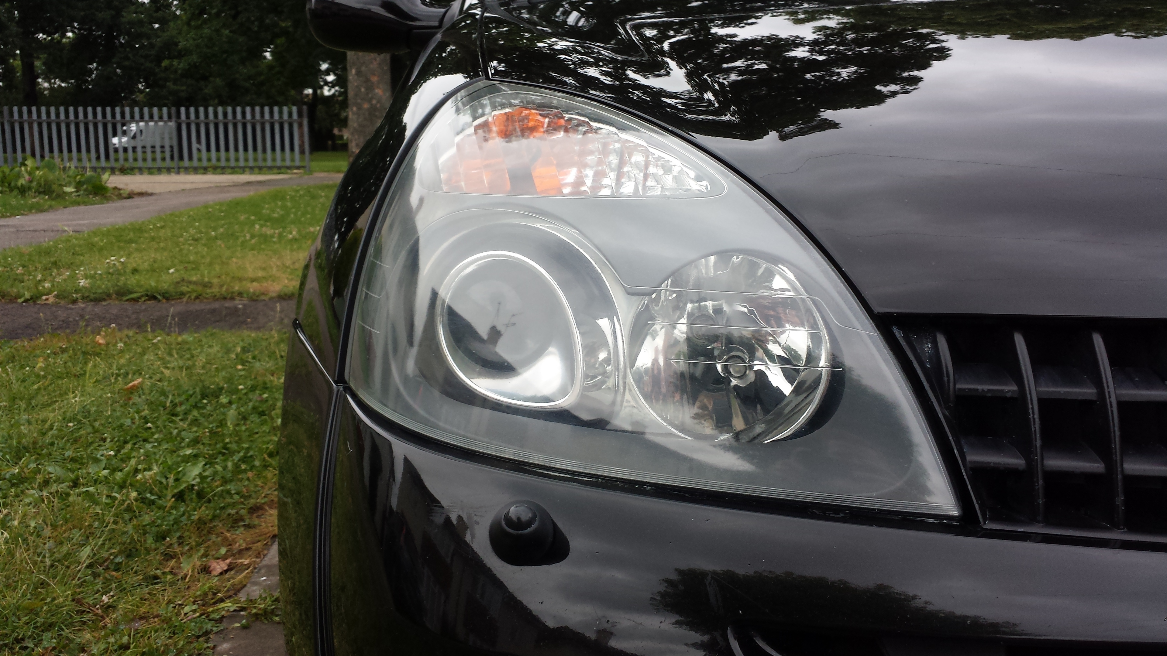

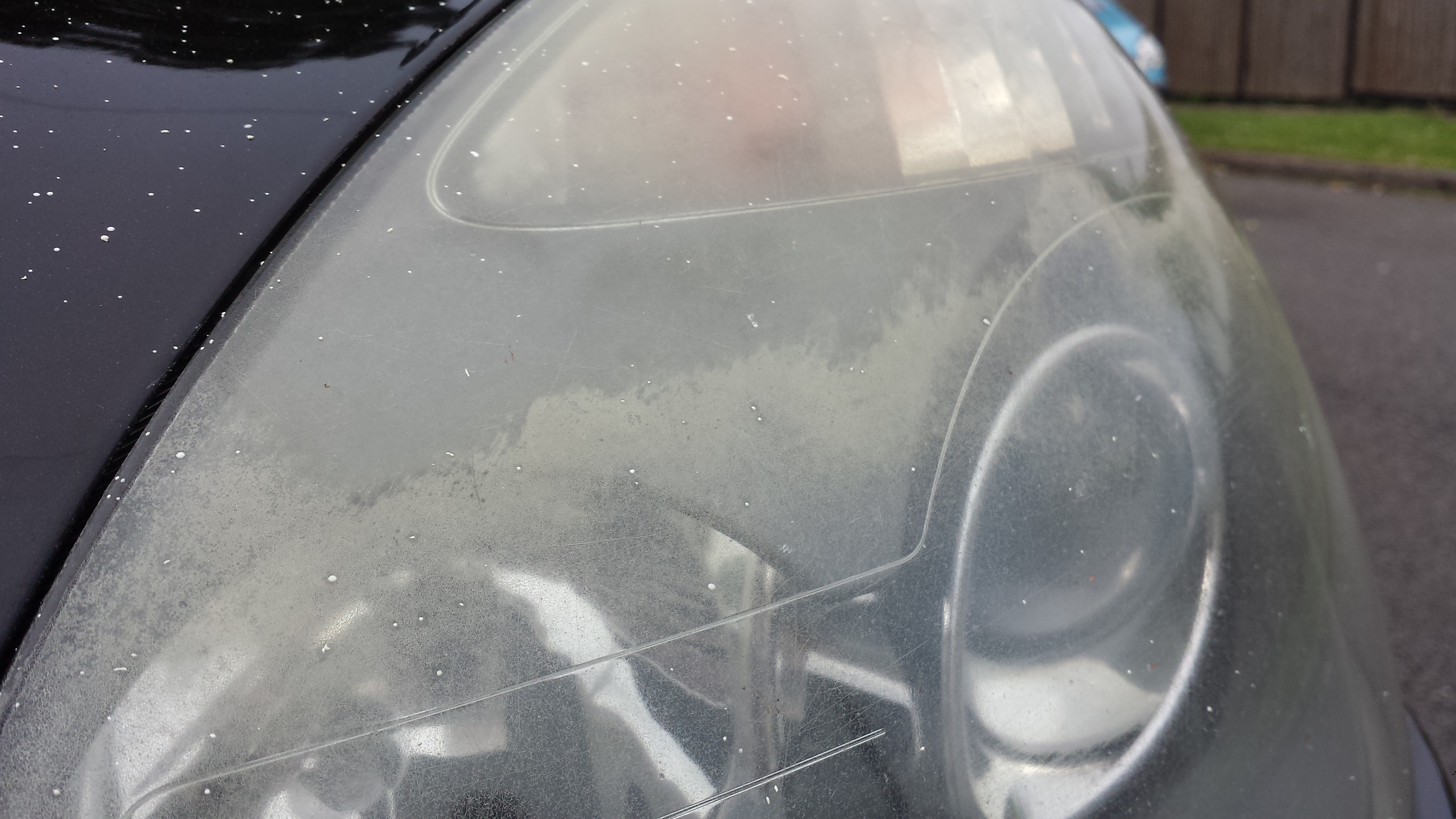

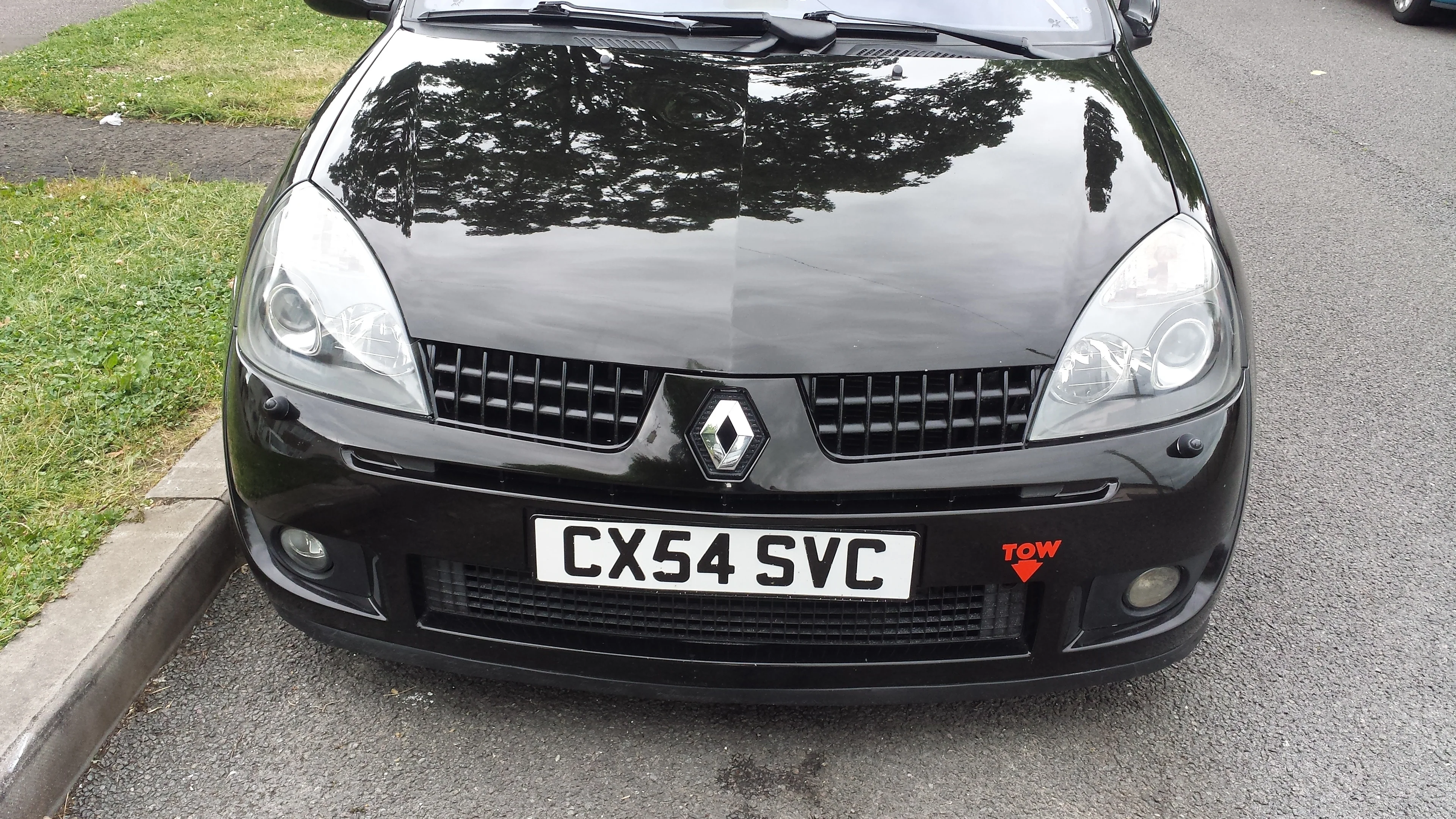

tonight i started working on the badly glazed over headlights.
only managed to get one done but the difference is massive
this is before

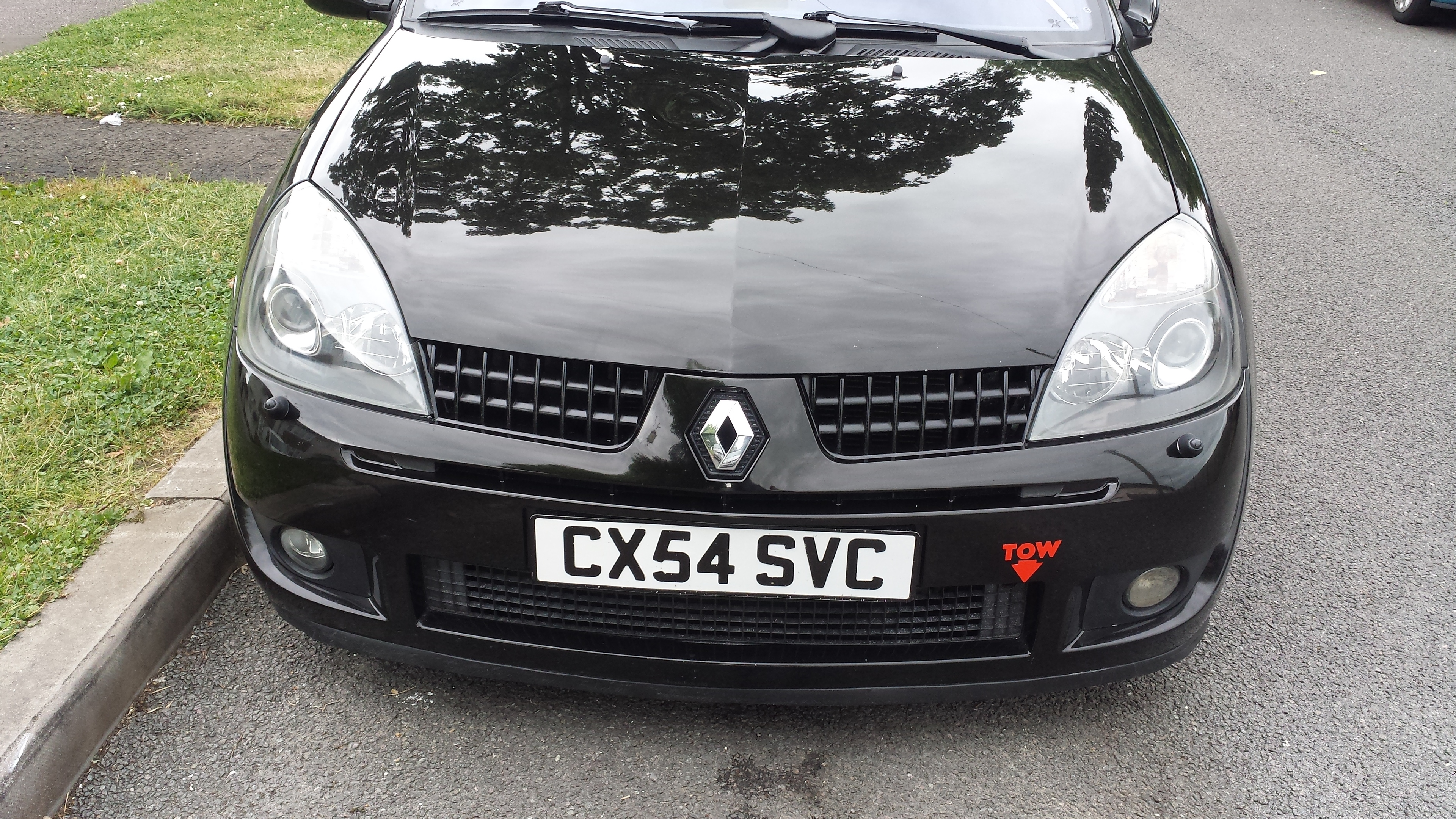

this is after
very happy with results
just gotta do the other light tommorow
GCC
  1.2Clio / 182!!
What did you use on yours?? I did mine this week, which also turned into a two day job as I ran out of time and patience the first day... I ended up having to go as course as 600 to get shot of my hazing though and still need to go back again on the second light.... Somehow I feel ashamed of my efforts though after seeing yours!!
  2004 clio 182
i used autosol metal polish which is like 2.50 a tube.
took around 50mins to do one with a buff pad attached to a drill. wouldnt ever use sandpaper at all. it a delicate plastic
