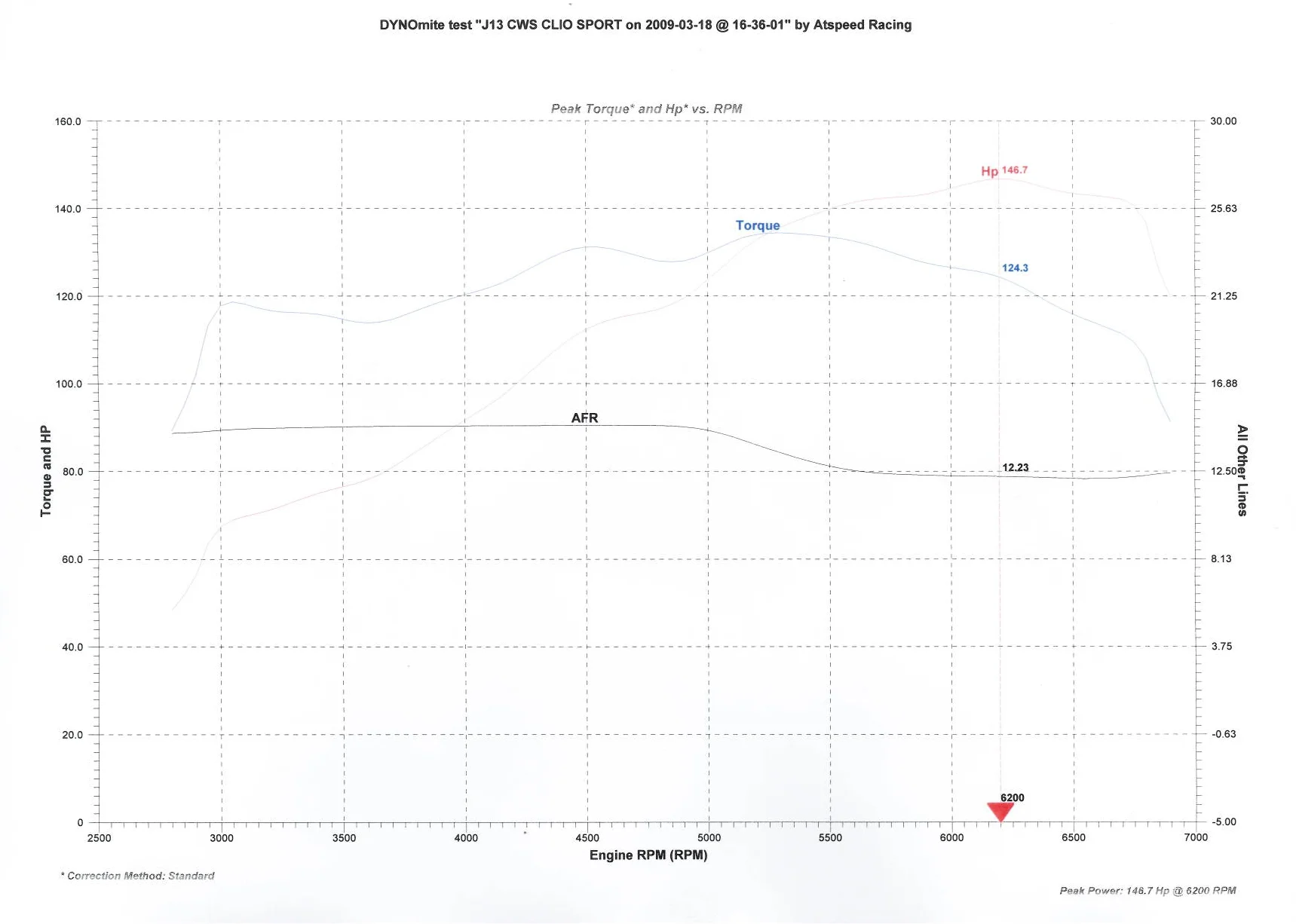

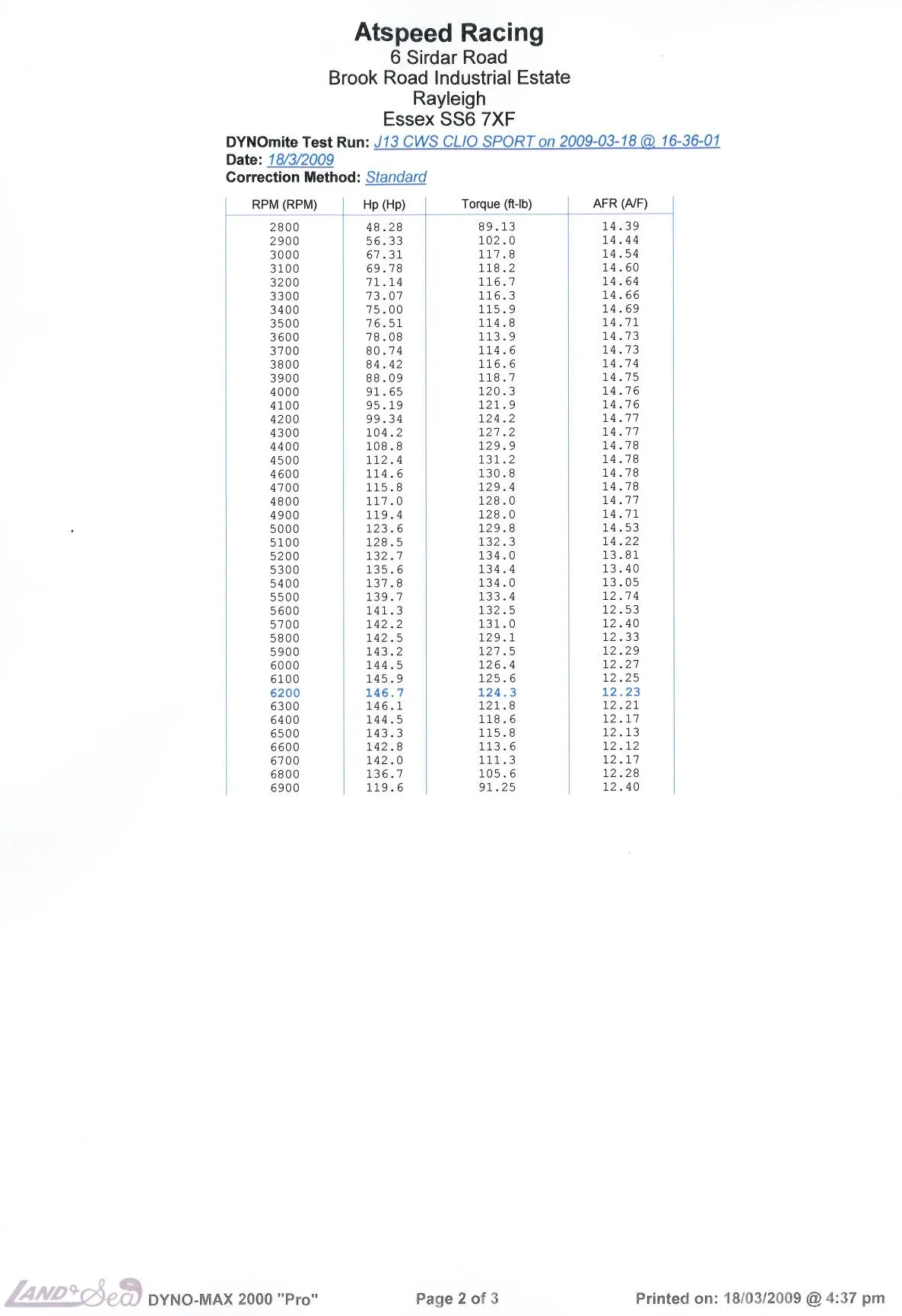

Got my car to ATSpeed in Rayleigh, Basildon today. Top guys, really helpful and chatty, had a good laugh. Got an at the wheels peak power figure of 146.7bhp and peak torque of 182.2Nm. My cars got a Pipercross Viper and RS Tuner 98RON cal and thats it.
Will scan in the curves at work tomorrow. Pretty chuffed.
Oh by the way, for anyone who wants that atw figure in fly figure, then very roughly (working with an 18% loss figure) its 174bhp at fly. But that figures kind of pointless IMO.

I'm very happy with it. Here's the printouts.
