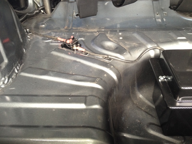

You can either try and mount it down in the wheel well to get it out the way, or just bolt a cradle or box for it into the boot, mine is just bolted down on the pass side of the boot in a metal cradle.
BMW cable is a good one to go for, can be had cheap from the scrappies and has a good jump start point at the front and a couple of decent sized connections.

On my mk1 i have it where the rear seat used to be, behind the pass seat is fine too but mine is mounted too far back to allow that.
You can just use a decent quality jump lead or buy a length of cable. Ive added a megablade fuse on my mk1 too just in case, and I will be doing the same on the mk2 turbo as well but just havent got round to it yet, ive seen cars catch fire due to the main battery cable being damaged before (run through the car is a good idea)

As mentioned above, I would fuse it right by the battery too, with a 200AMP or so fuse (ie enough for starter motor to still turn)

I mounted mine in the spare wheel well and fitted a inline breaker rather than a fuse so if it trips its quick and easy to reset.

Junction box in engine bay-cable from junction box to rear with 200amp mega fuse then connect cable to battery-earth from battery to car job done?
  182/RS2/ Turbo/Mk1
Doesnt really matter as you can always bolt more than one item to one junction, or leave one spare etc.
Yeah 200amp next to battery is ideal.
