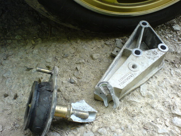

The gearbox mount has sheared rite off on the Williams.Only done about 10k!
Not driven it more than 12ft since,cuz it started to crunch as soon as it dropped.
I can probably change the mount myself,but is it possible this has damaged more(Driveshaft or Drive from Gearbox?) and Im guessing just bolting a new one on and trying to drive off is not a good idea?

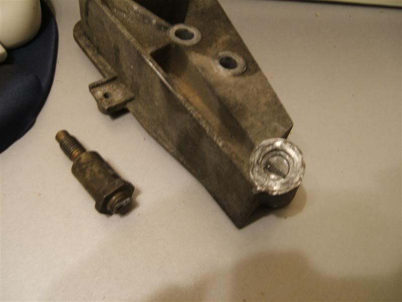

Just got the offending item out:

Looks like your almost finished. Now the easy bit, trying to find someone whos got the part...

the same thing happend to me about 2months ago, i hit 2 big potholes and the mount smashed. i had to drive 10miles with the gearbox hanging down, sounded awful till i got to a friends house. just jacked the whole engine/box back up and changed the mount job done drove home, yours will be fine just change the mount and pin, might be worth changing the rubber aswell as it looks like it could do with a change:D

Just road tested after fitting a new mount,and all appears fine.
fairly simple job to fit the new one in, took around 30 mins.
