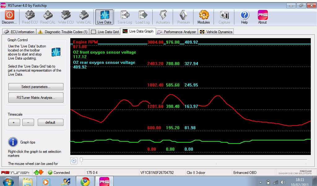

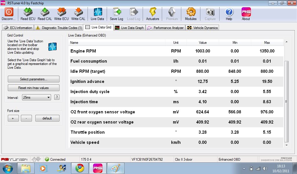

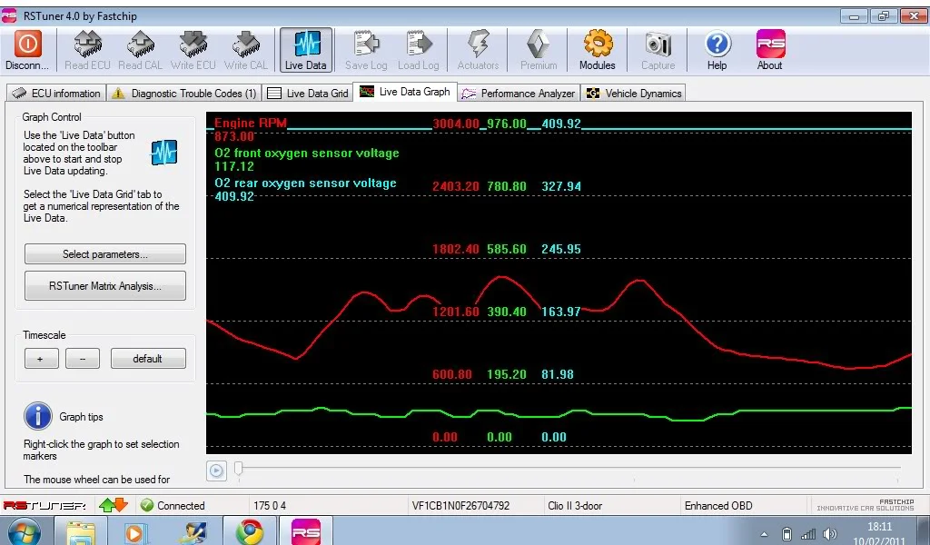

To me it looks like rear Lambda as its voltage doesn't adjust with the revs like the front lambda does. Does this sound right?

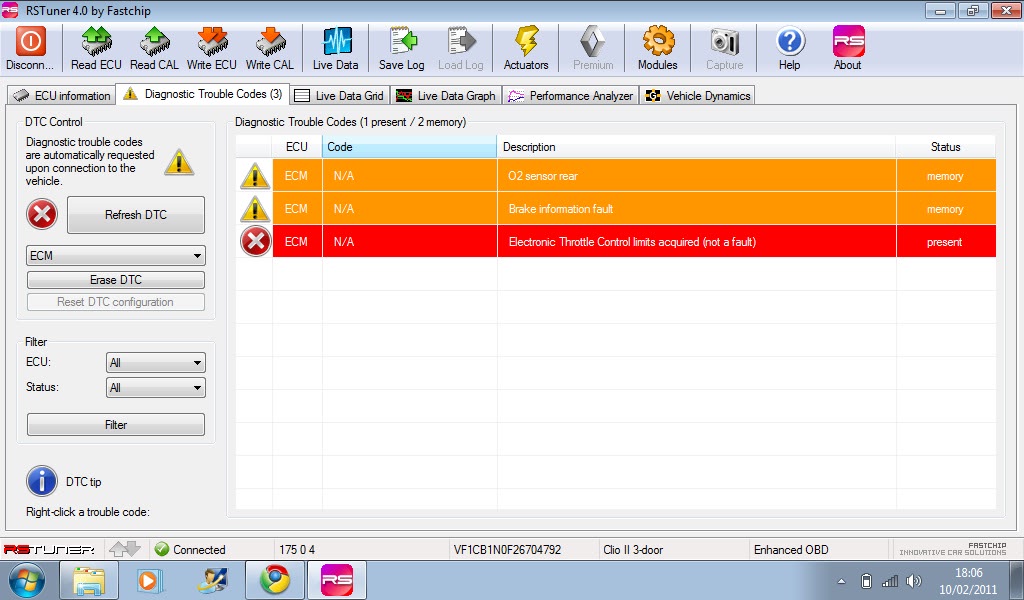

RS Tuner shows rear O2 sensor so think it may be getting changed.

Front o2 sensor by the looks of the graph bud. Should be a healthy "up and down" signal varying from 150mv to 800mv aprox.
I take it it was hot when you did those graphs?
It had been run home from work, about half hours drive and left to sit for about 5 mins while i ran up for the rs tuner and then started again. Gotta go out for a quick spin in a min so when its hot i'll do another reading.

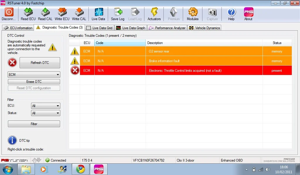

Cleared the faults, took it for a drive and the O2 sensor error hasn't reappeared.

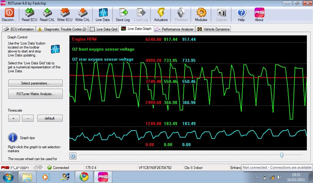

Ive seen another RS Tuner log of a front O2 sensor and his waves are alot taller than mine so i think its buggered.

EDIT : This thread, when compared to mine his sensor does alot more voltage changing.
