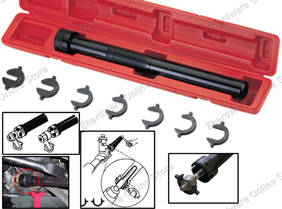

What's the special tool needed?
  Ph2 Clio 172
What part would the specifically mean when they refer to 'inner joints'? Rack mounts or inner track rod? Or something else?
Looking at part numbers from West here
Inner tie rods you'll need
There's a series of special tools you can buy to undo them as the nut for them is deep in the bay
Or Fred has his own special tool (ooh-err) lol
The tie rods are about £20 each from GSF - but the tool is £40-60 so it's cheaper to just book your car in with a reputable garage and let them do the lot

Tool to do it yourself is only 40 quid or so, so worth considering as its not exactly a hard job, but depends how confident you are working on your car in the first place really.
