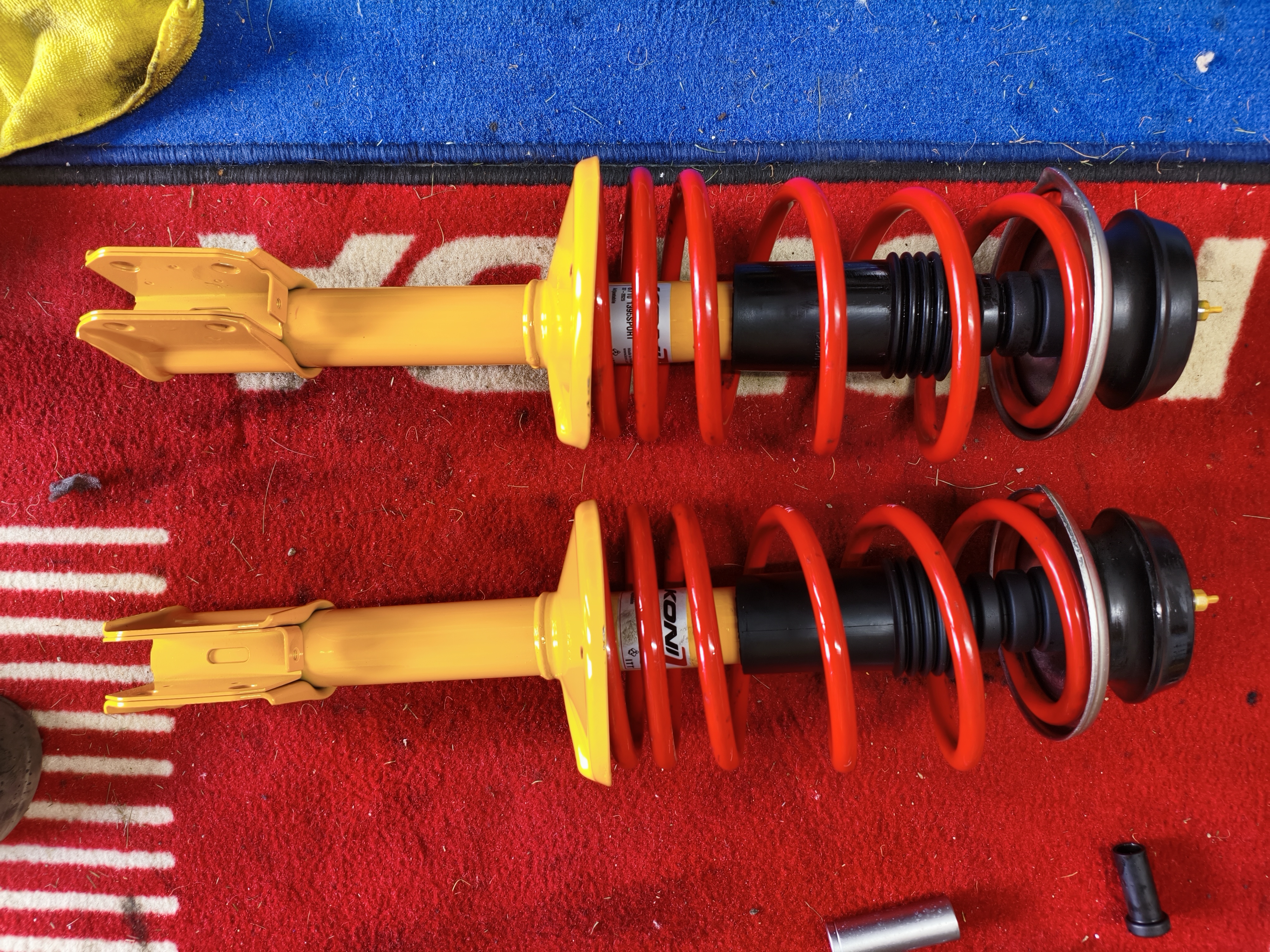

OEM dust covers/bump stops fit fine on fronts. Rear dust covers not so much, on mine one has fallen to shock housing other stays up. Have asked two others who’ve had these, they didn’t have issues but personally would see if you can find a suitable aftermarket option before fitting. Haven’t had time to look myself yet but sure there’ll be an option that’ll fit and work appropriately.
Looking at your pictures again, you only get front shocks?
What springs are you going to use?

Yeah, front shocks only, I've got a set of GAZ adjustable dampers for the rear. Already running eibach sportlines on cup shocks at the minute so will be re-using the eibach springs

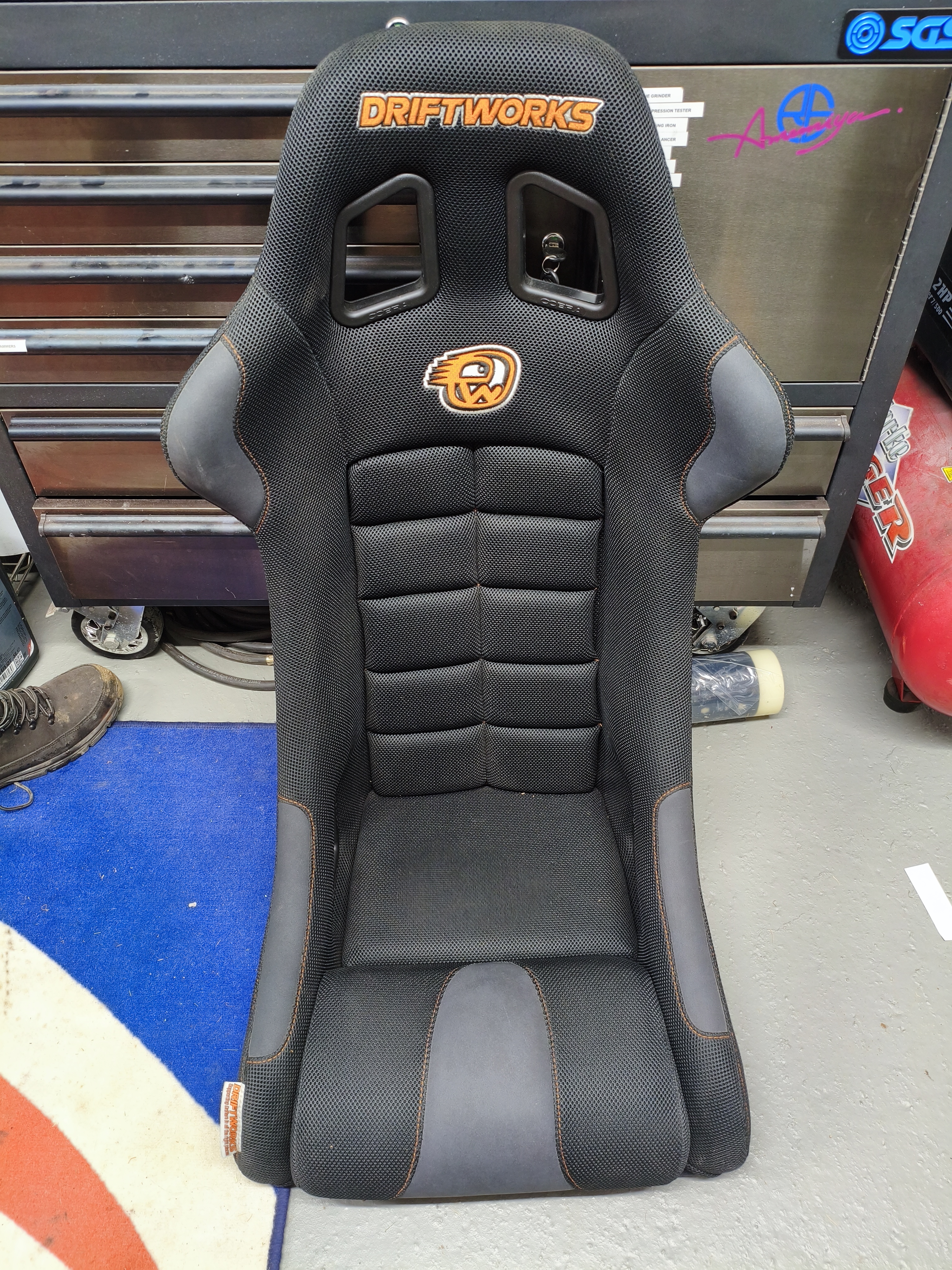

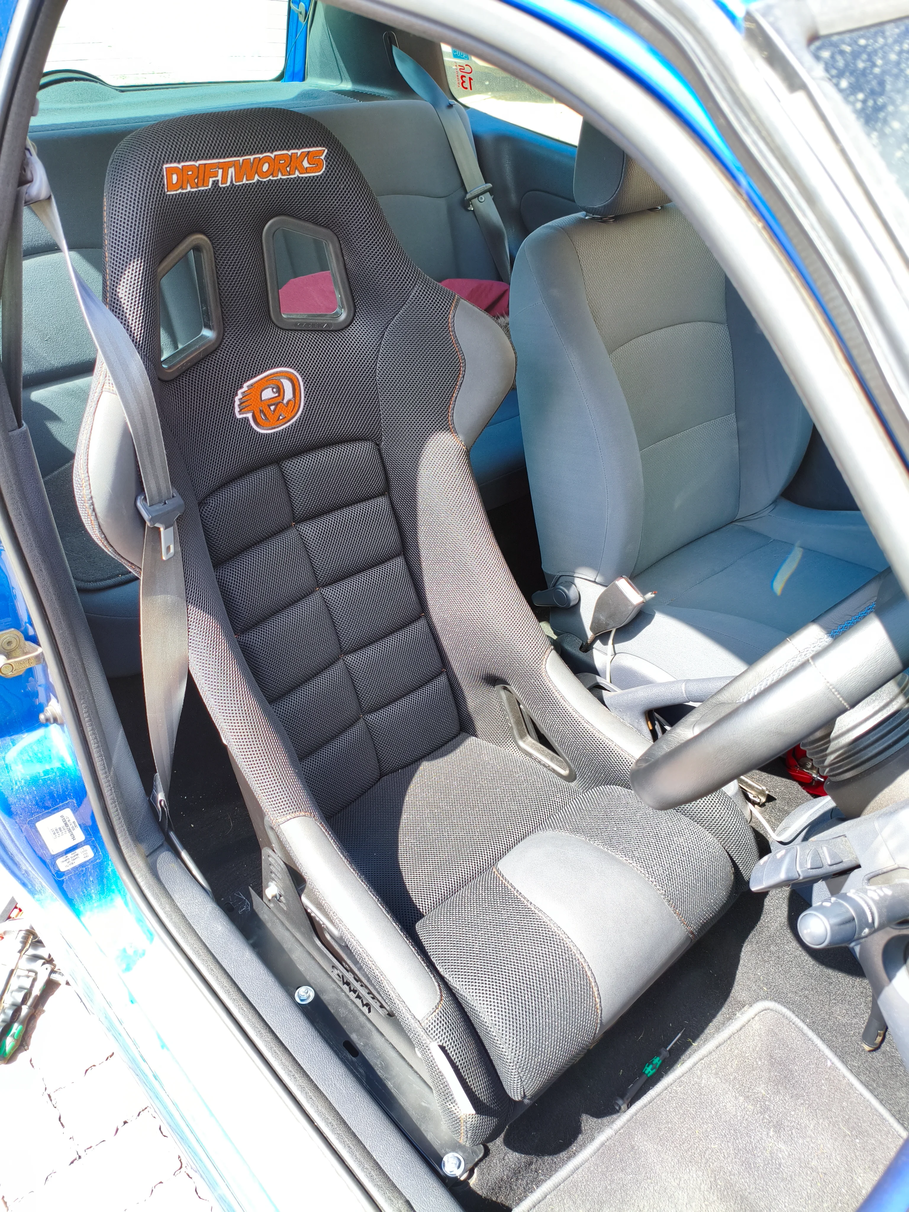

Got my new seat thanks to @Maccy for sending it on to me, it's a Driftworks branded Cobra imola, I don't love the DW branding but for £140 I can live with it Vs spending £640 on the cobra nogaro Ive had in my watchlist for ages.
I'll see how I get on with it at CSF, if I like it enough I might black the logos out with some fabric dye.

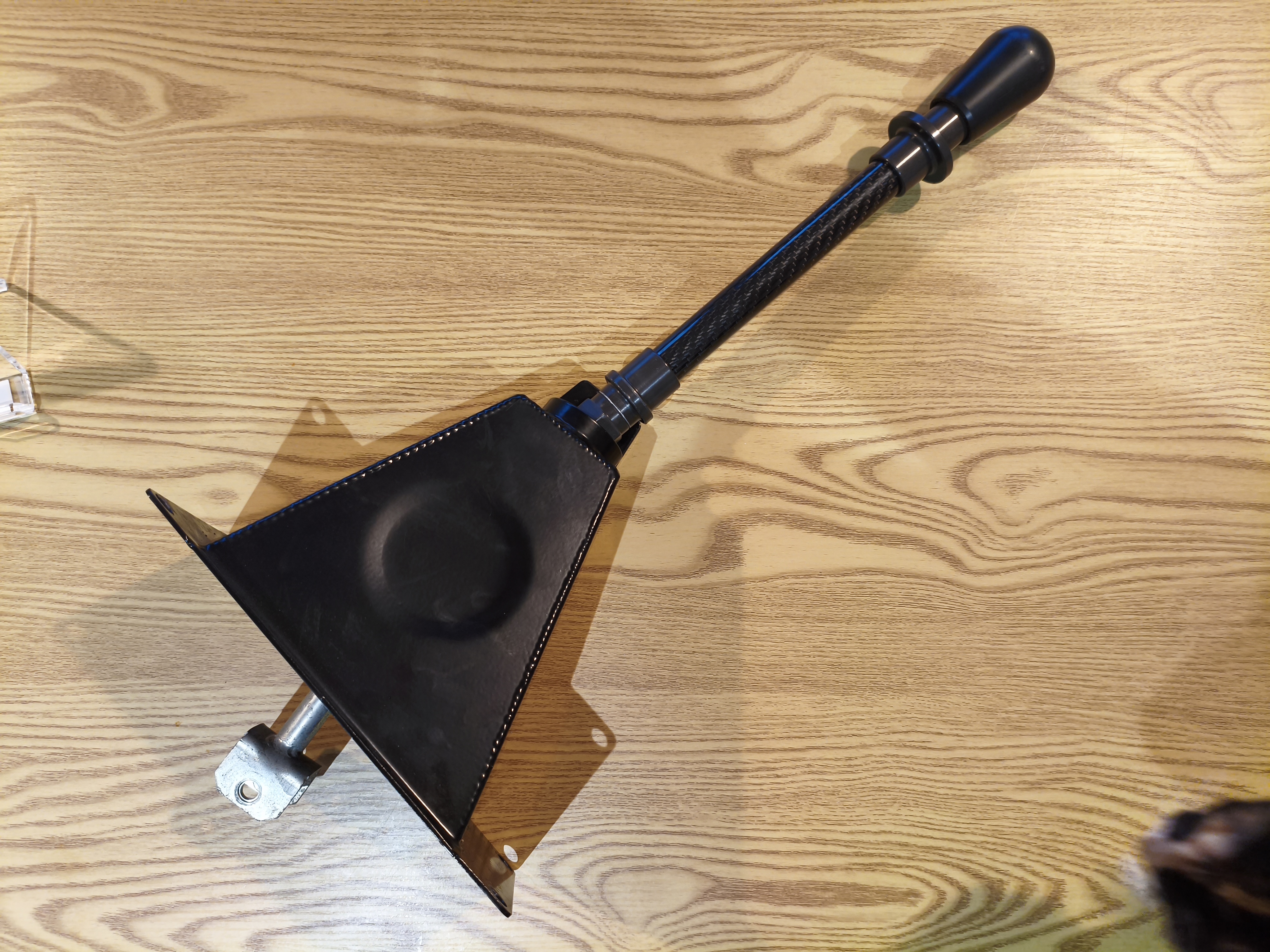

Also picked up a PMS shifter and a set of scruffy 182 wheels with AD08RS tyres on out of the classifieds.. I'll get the AD08's put on my turini's and probably move the 182 wheels on as I've no real use for them.

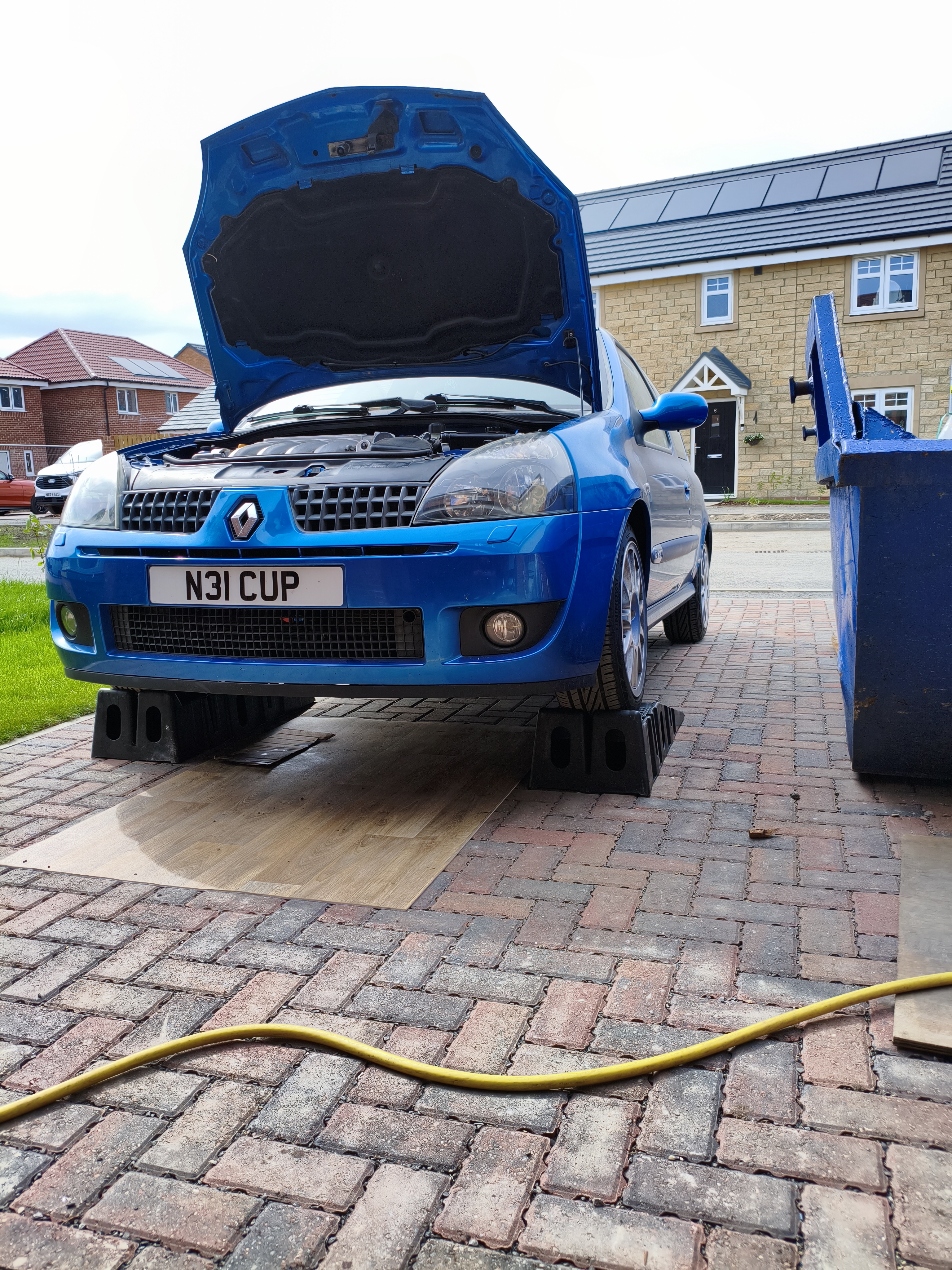

Done a little bit to the car today as the landscapers weren't around needing access to the skip.

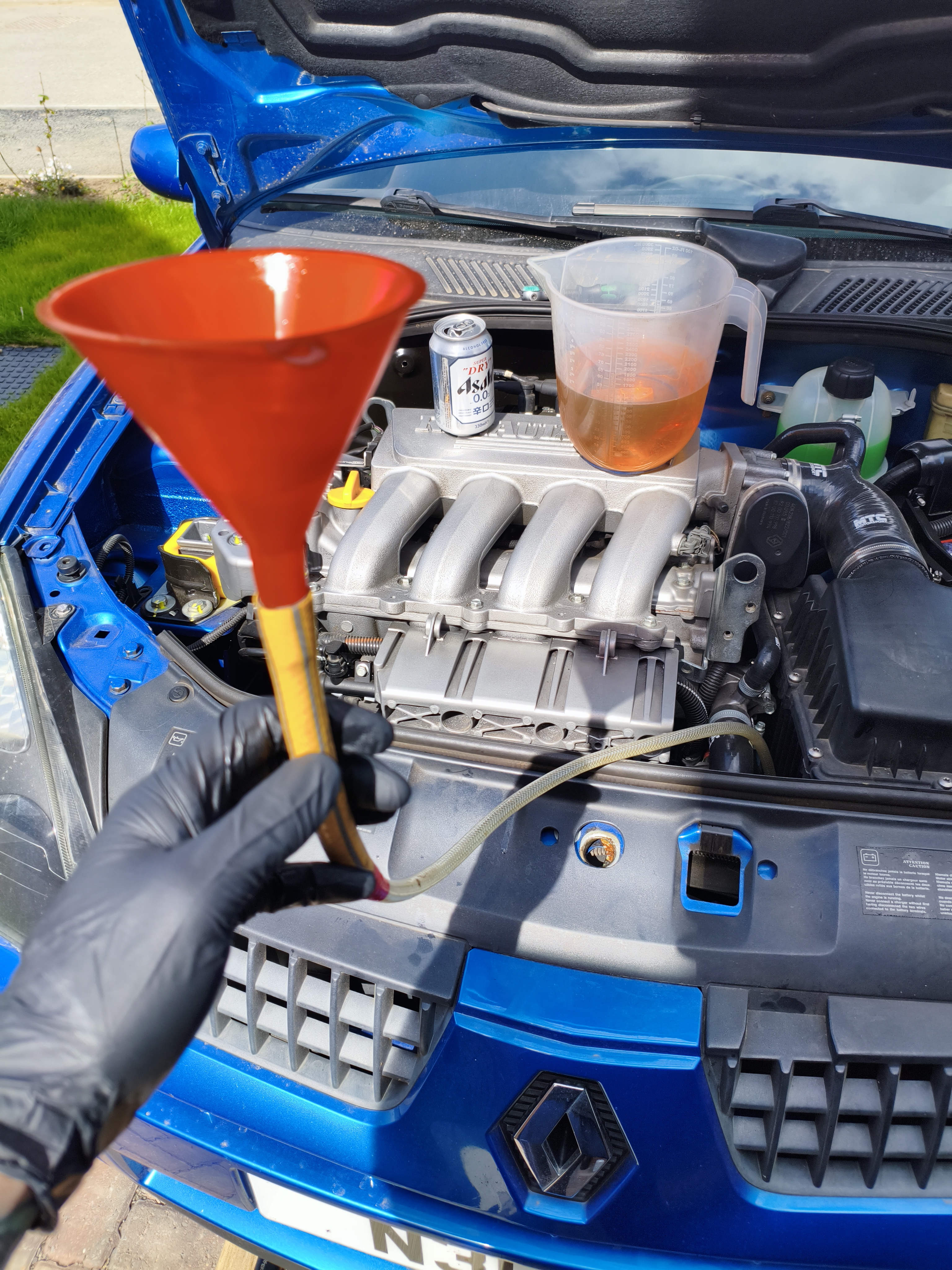

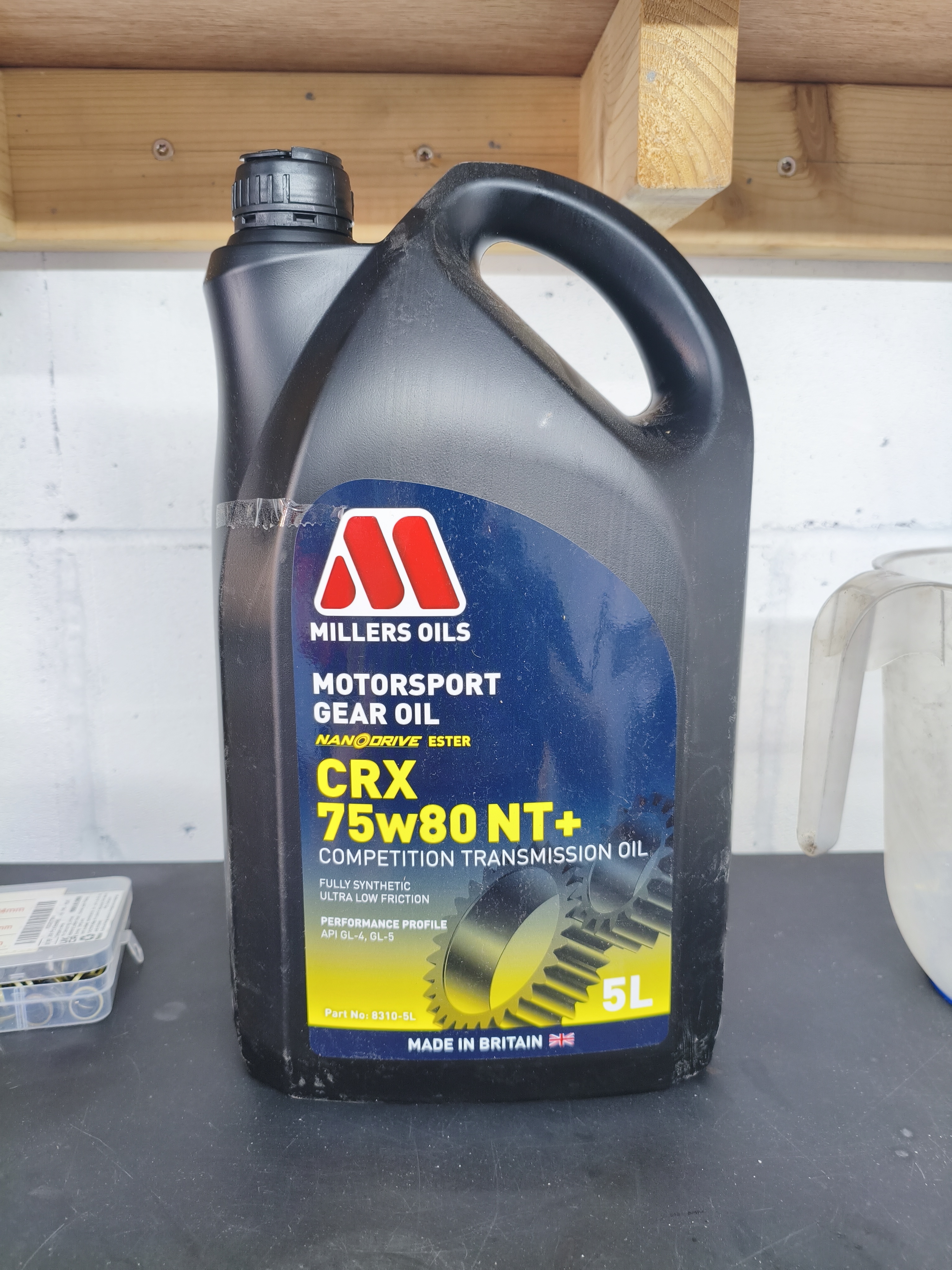

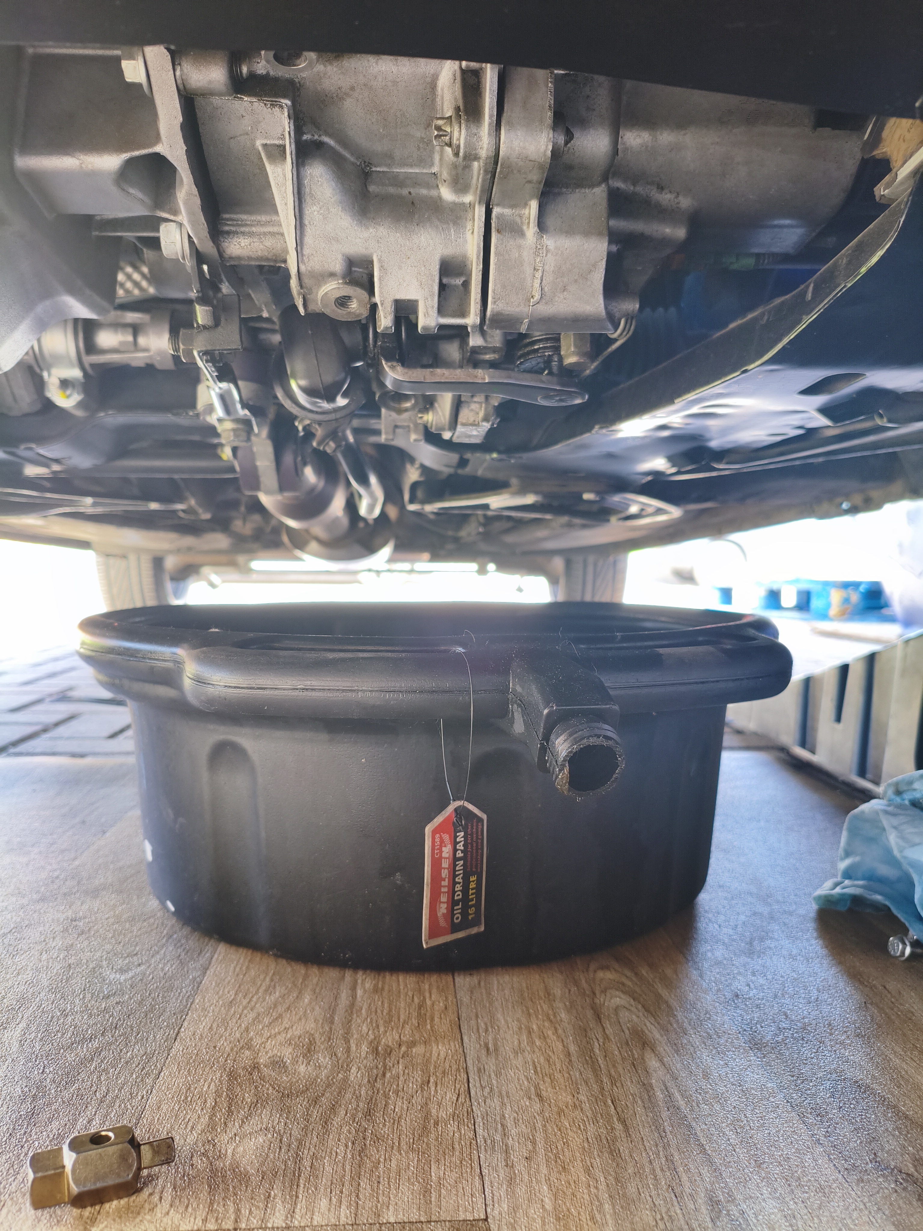

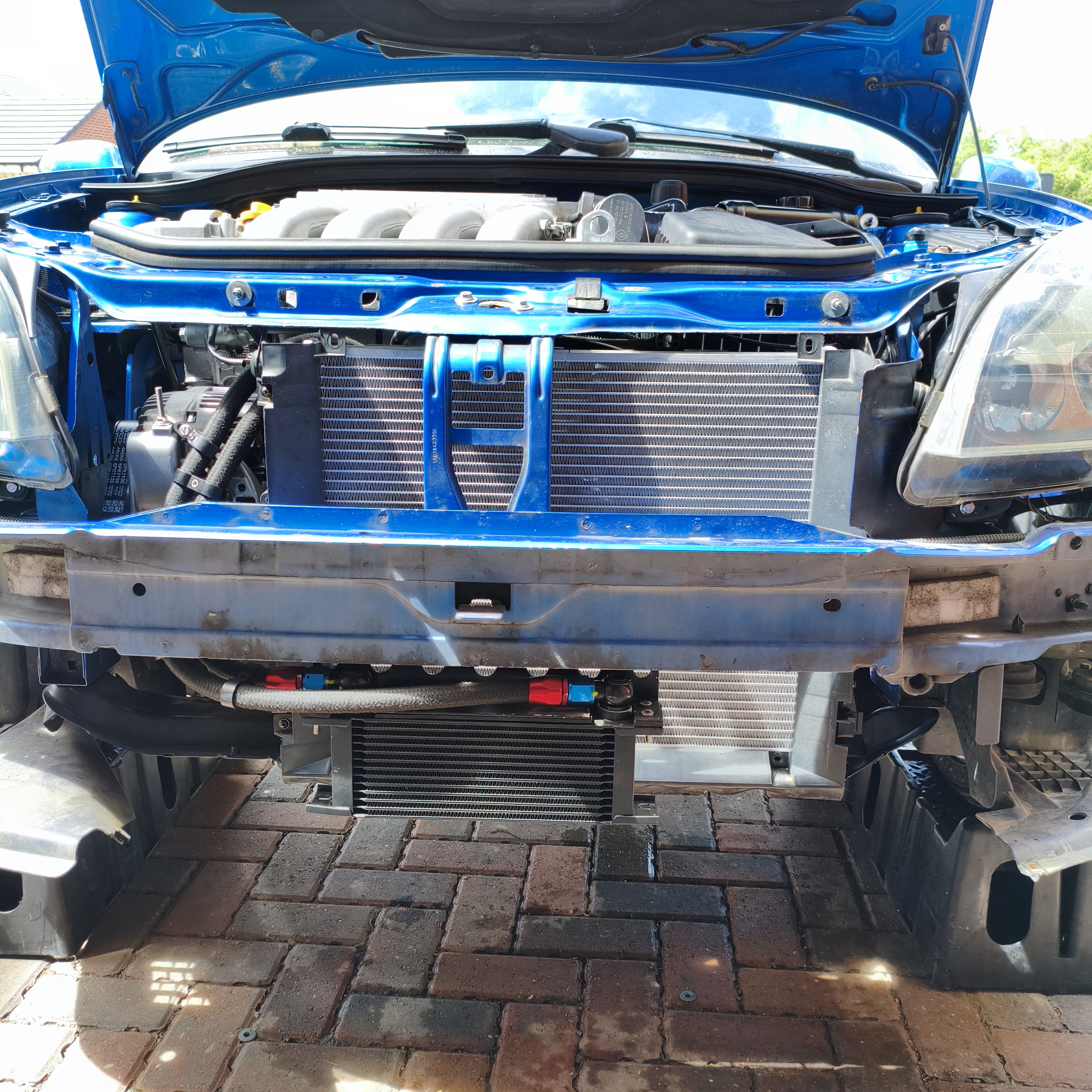

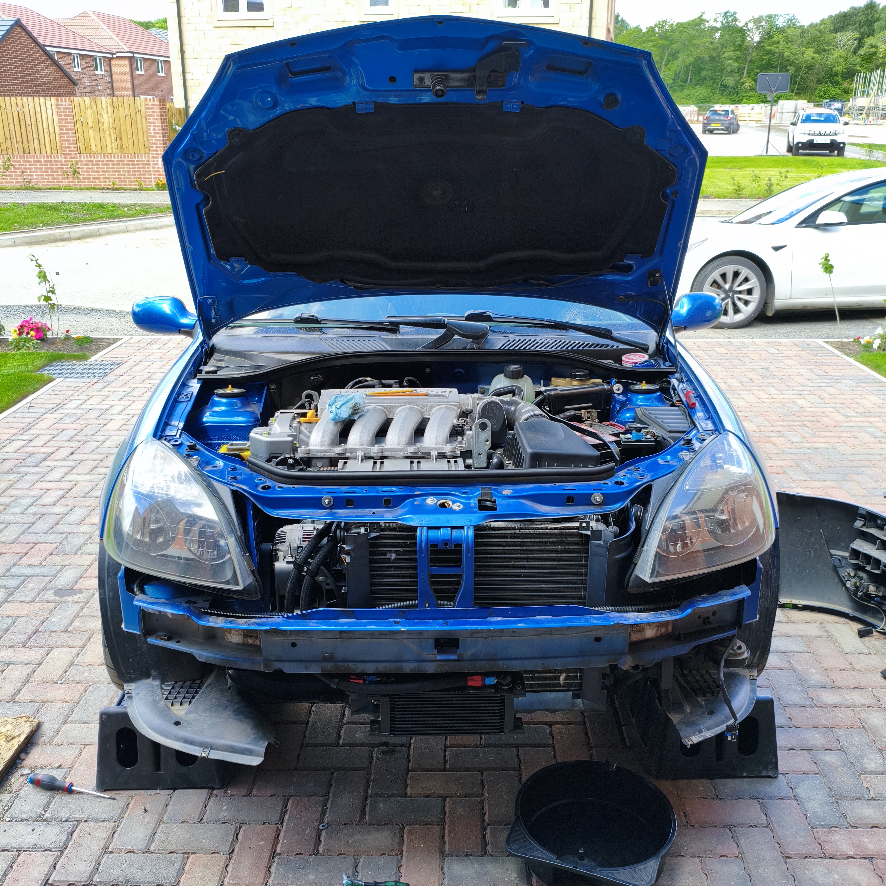

It's done 1000 miles since the engine and box went in so I've dropped the gearbox oil and put some fresh millers crx oil back in it, took an age to fill it as the only clean hose I had was about 6mm ID

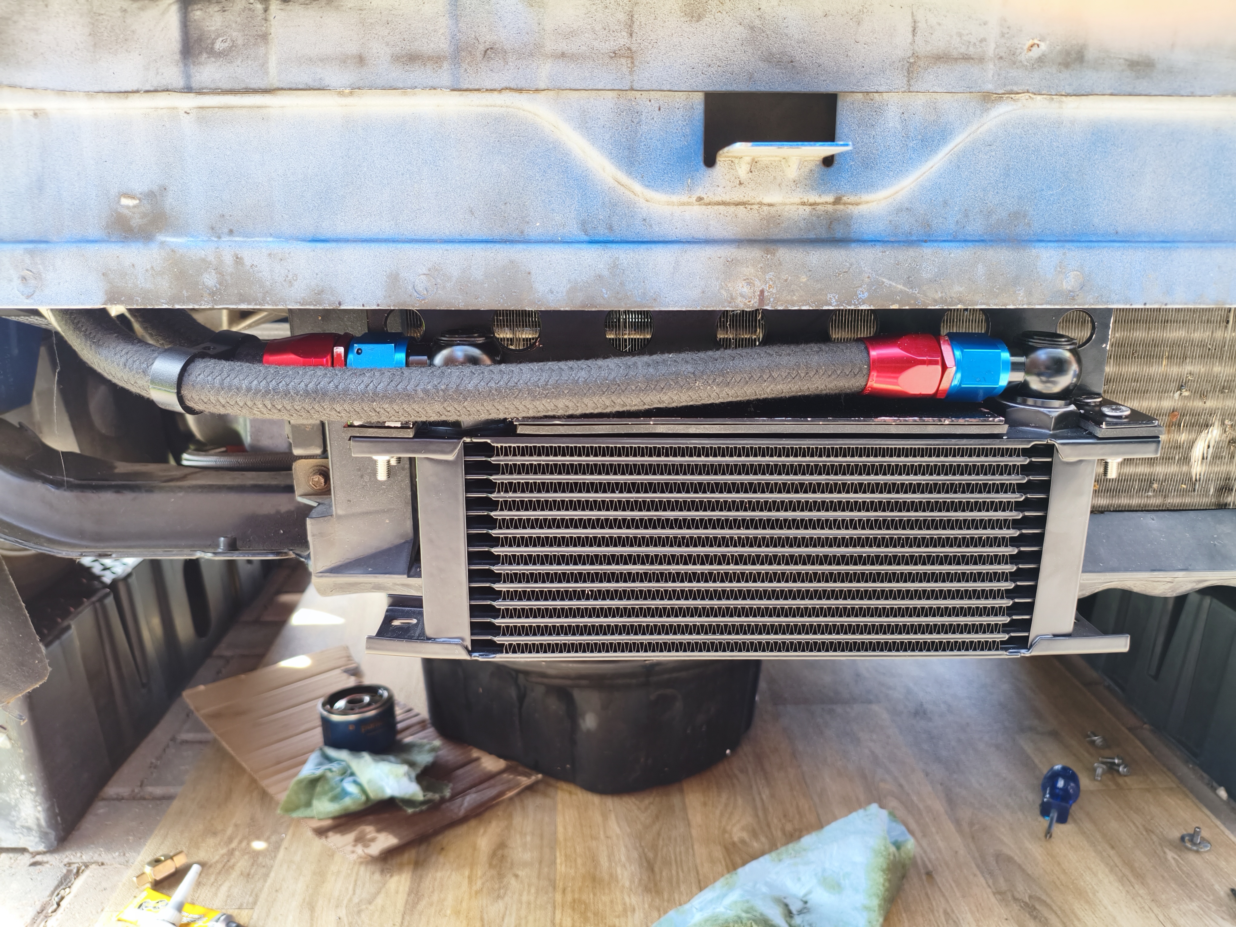

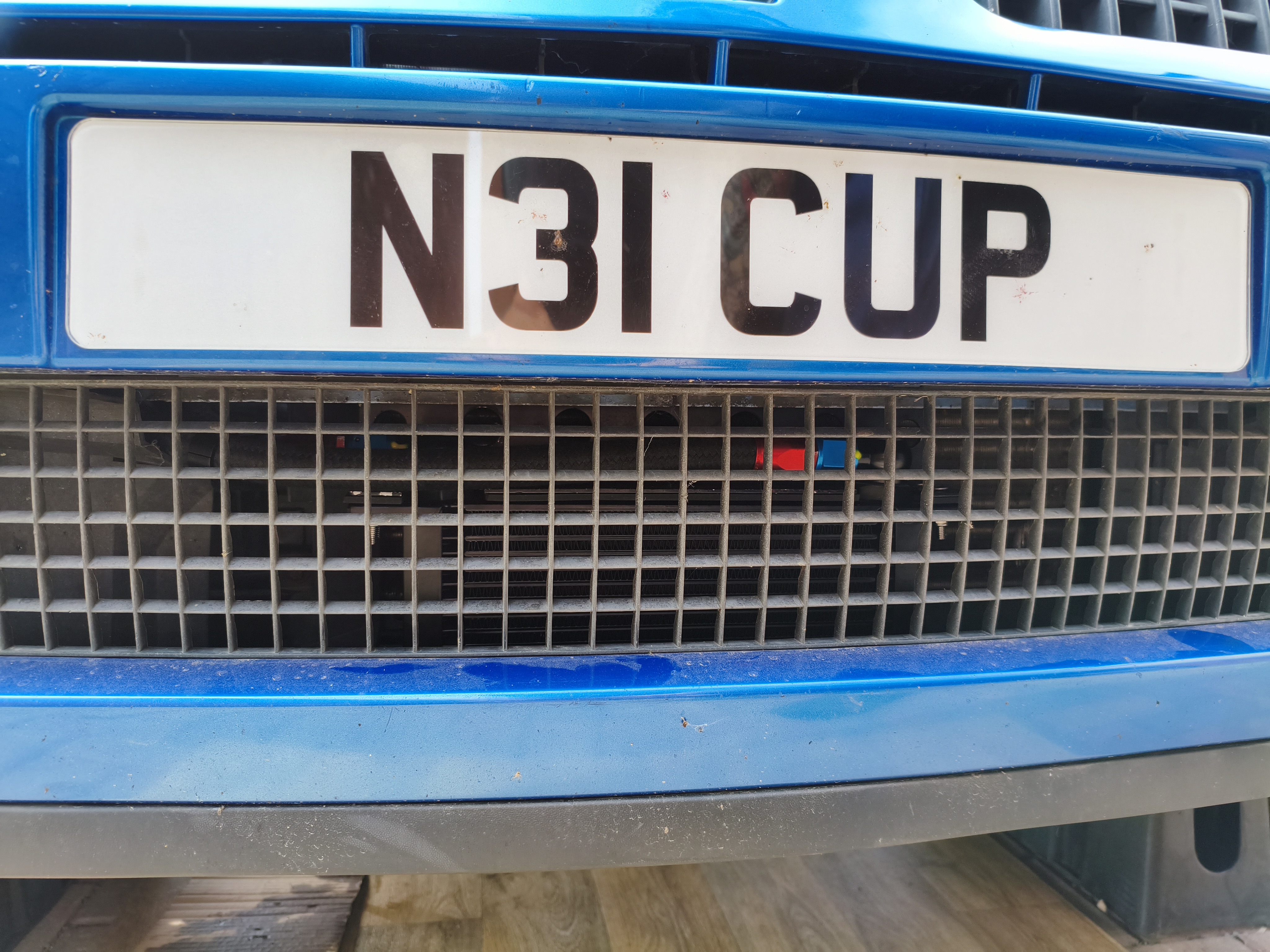

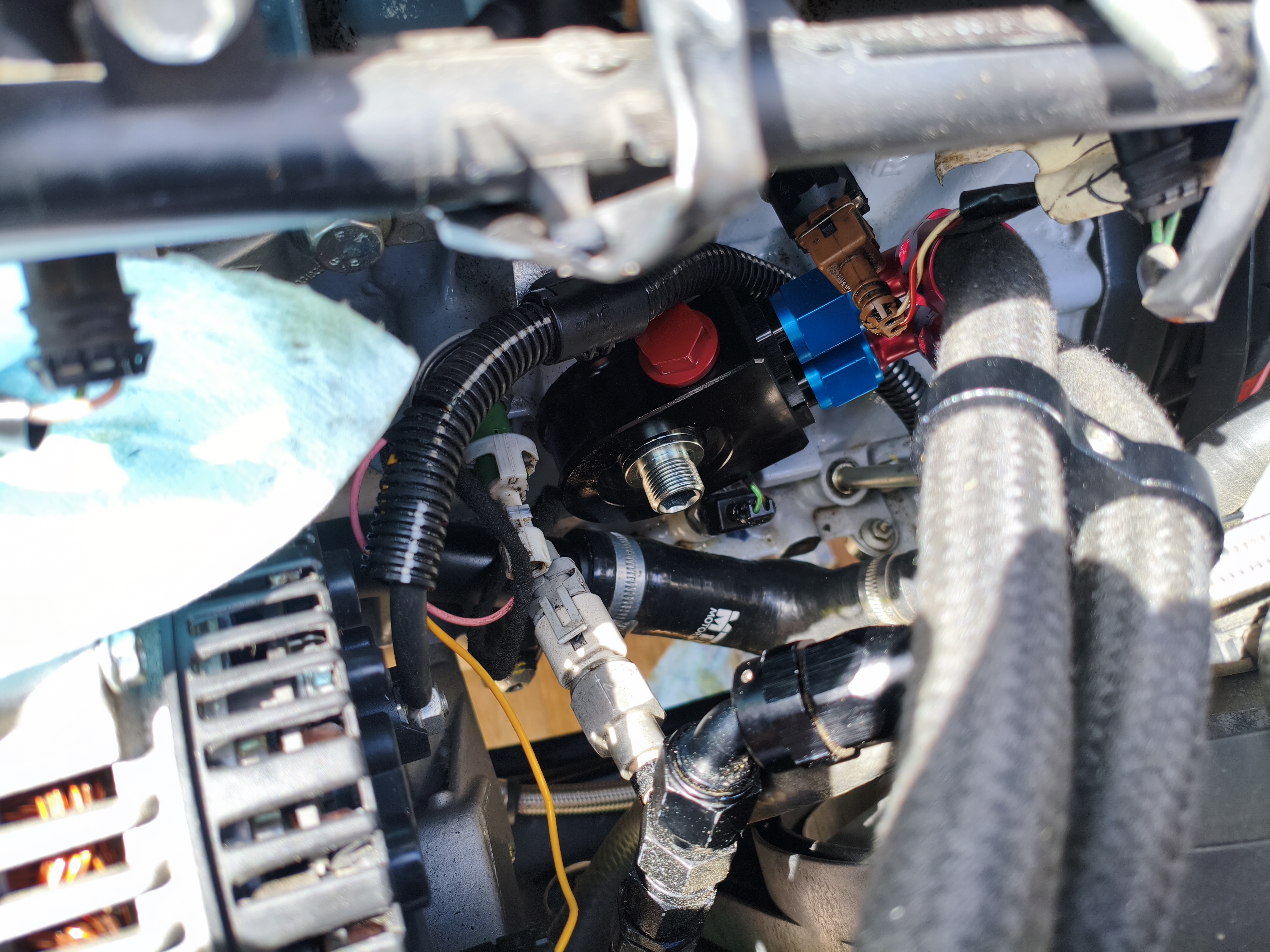

Then I dropped the engine oil and fitted the oil cooler

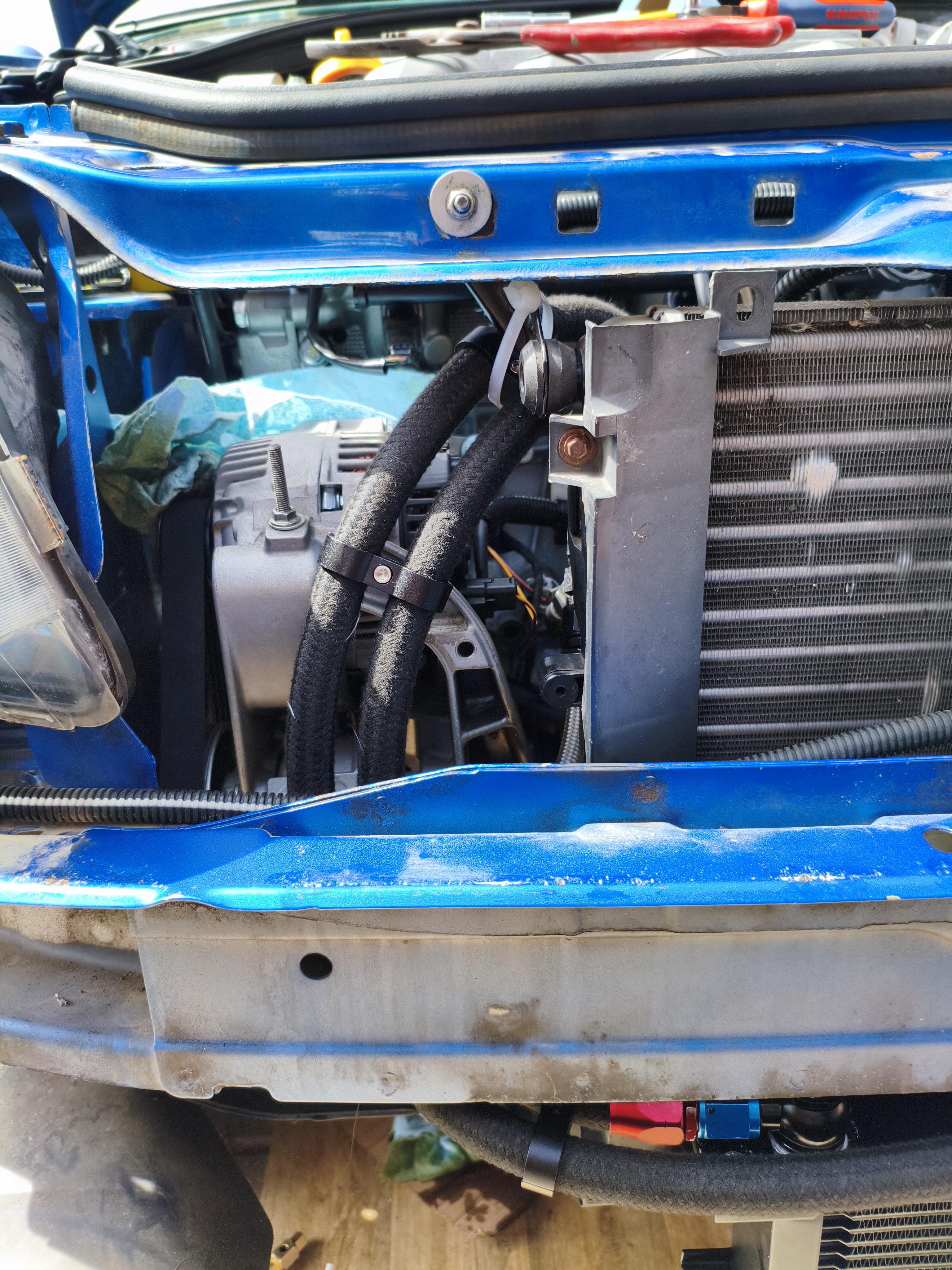

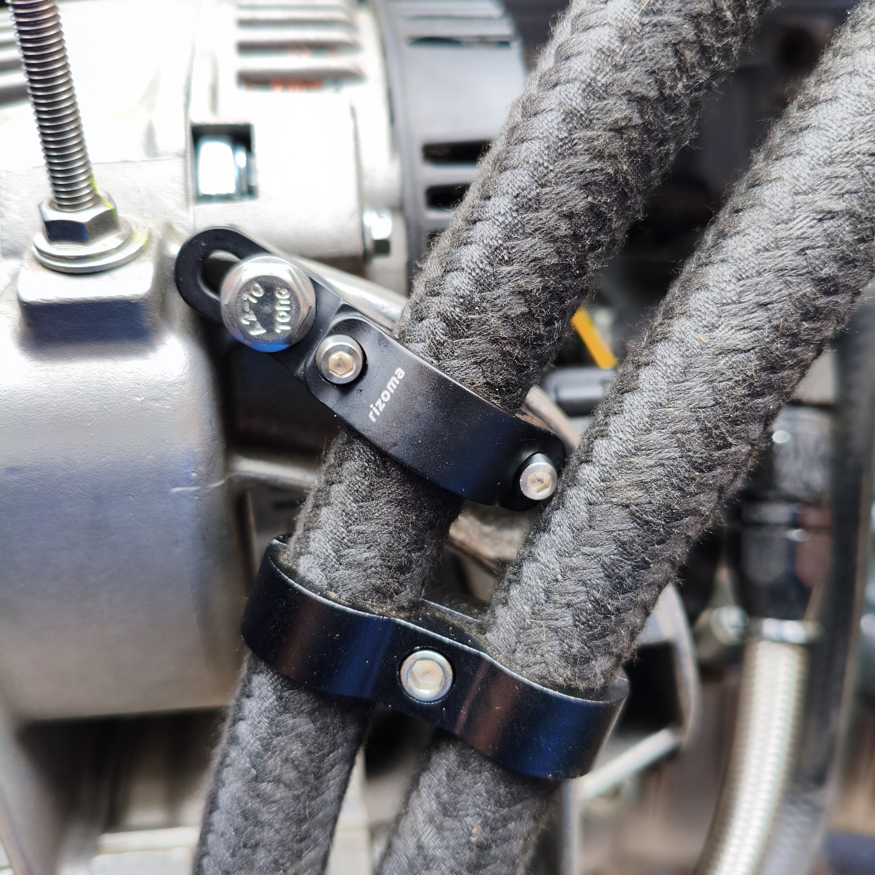

The hose is secured to the rad bracket with a cable tie for now, but I've ordered some 20mm P clips so I'll be able to secure it to a threaded hole in the alternator bracket when they arrive.
I'm pretty happy with how it looks, can't really see it behind the bumper other than the one AN fitting, I should have bought black but the red and blue ones were on clearance and I love a bargain.

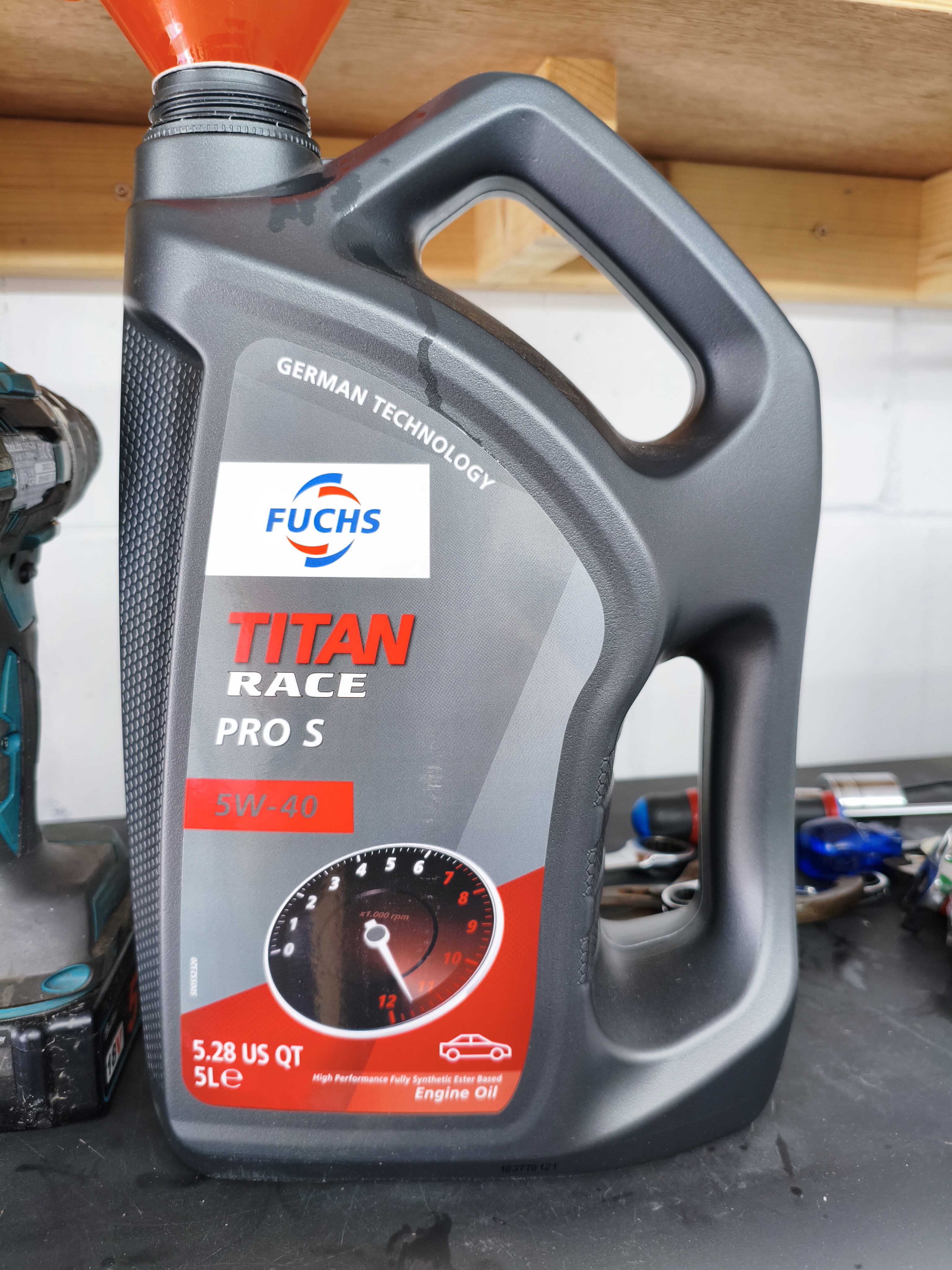

I've gone back to a 5w-40 oil too, rather than the Total Quartz 10w-50 that was in it before, it had a little bit of lifter tick on cold start with the thicker stuff, and I don't think it'll need the thicker oil with the oil cooler stopping it from getting too hot. The tick has gone again with the Fuchs oil in it.

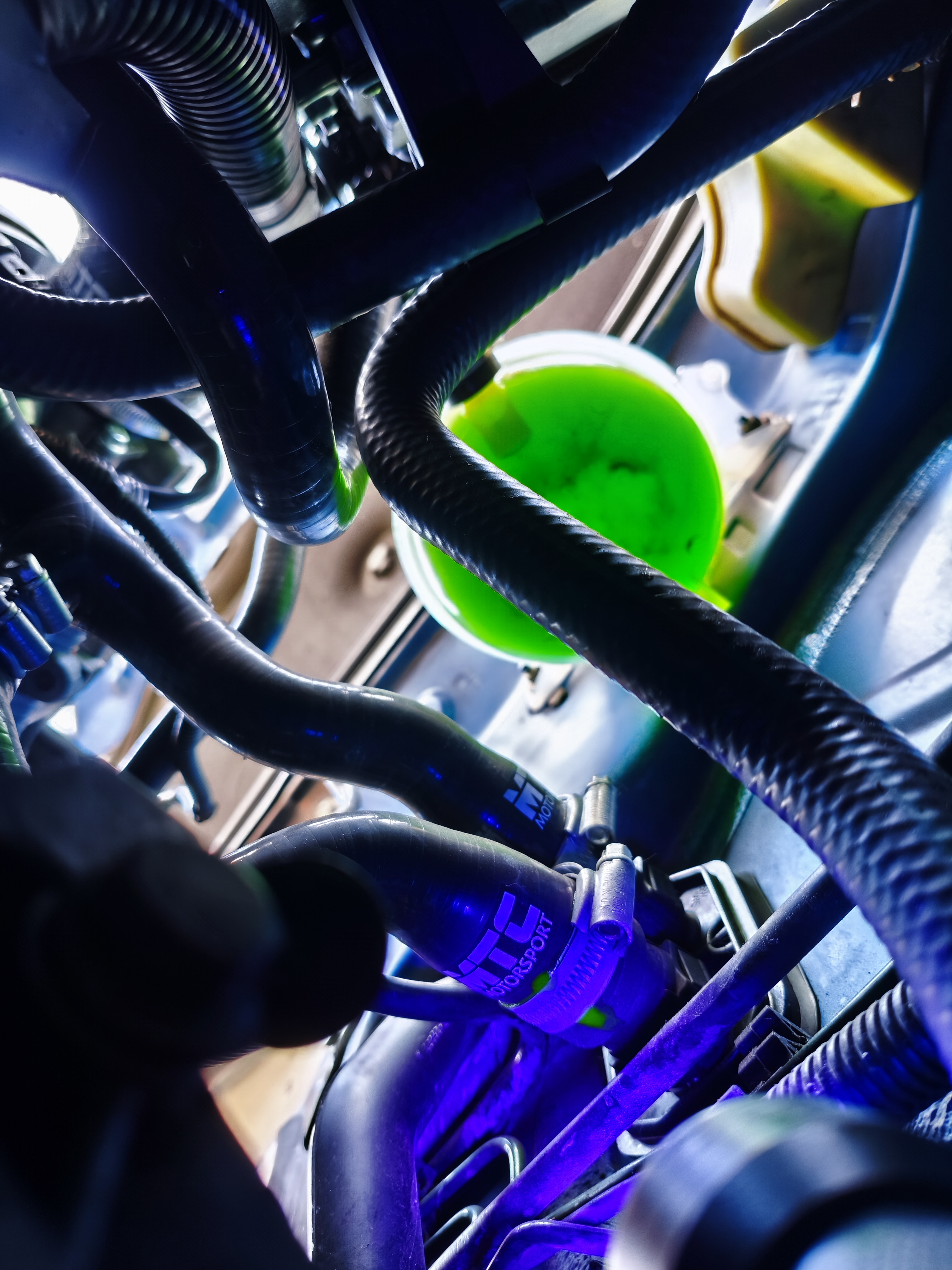

I also spotted a little coolant leak that I've nipped up on, it had lost a little bit since I filled the system initially, so I'd put a bit of UV dye in it a little while back and spotted it today with the black light.

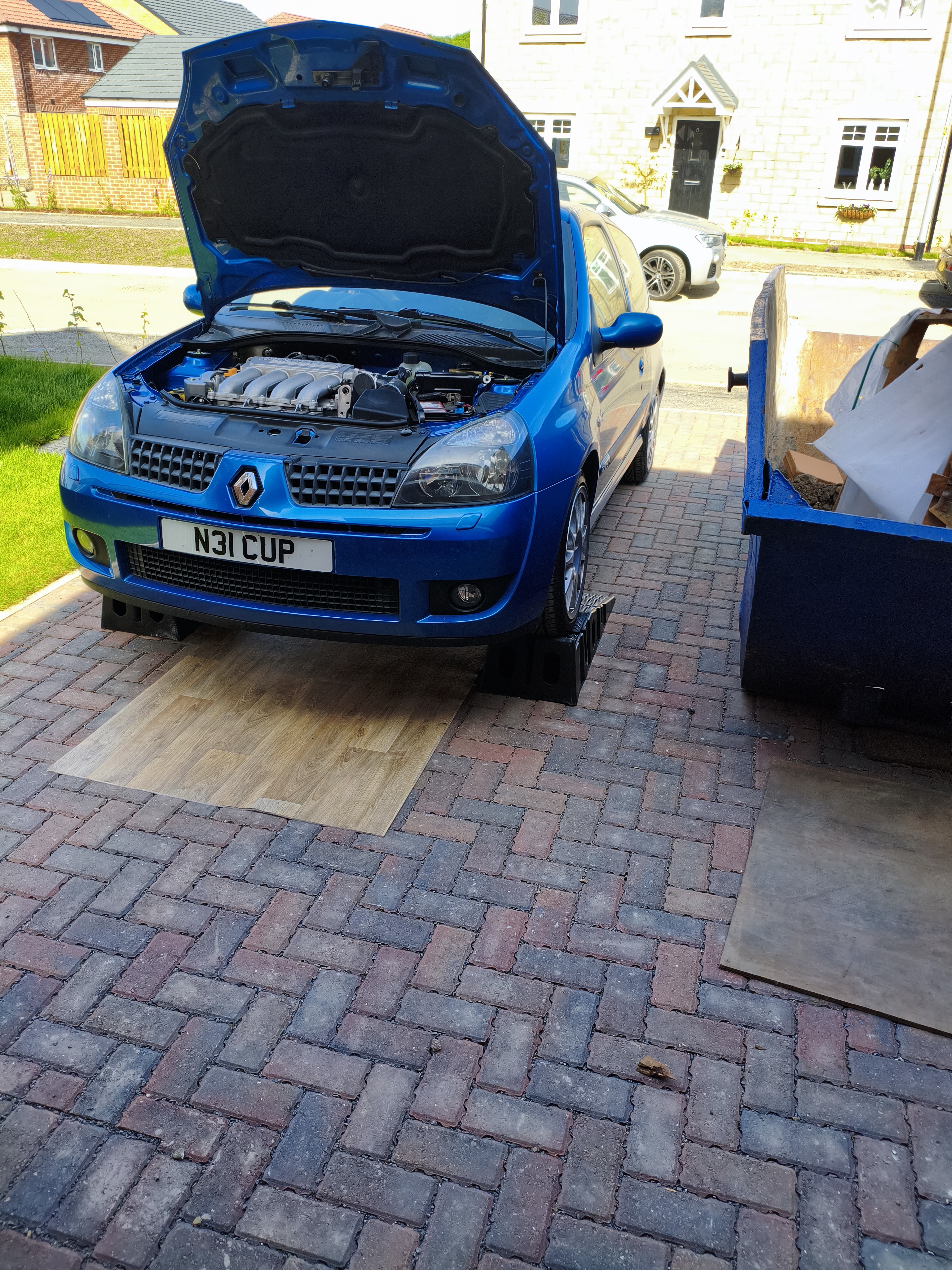

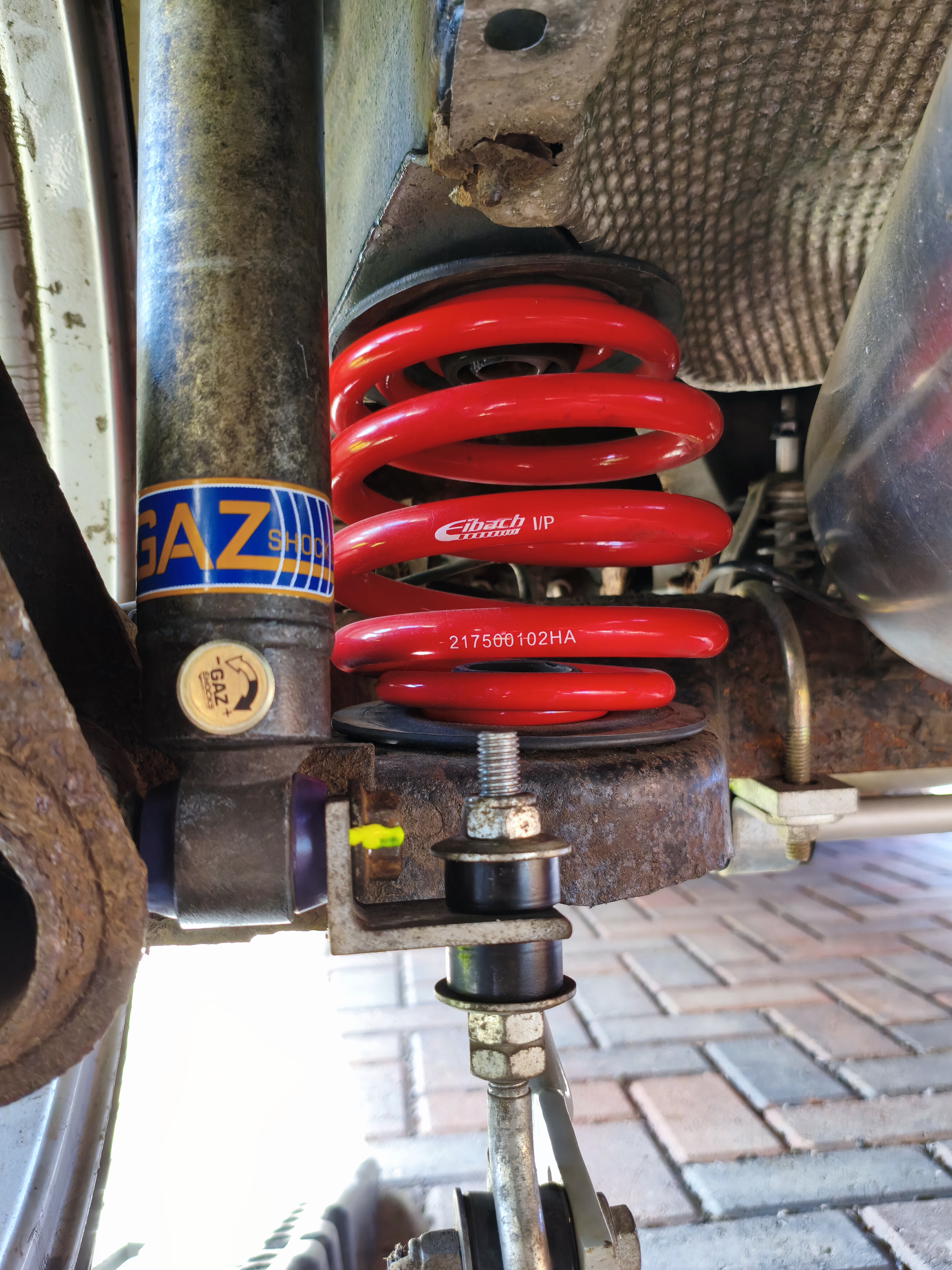

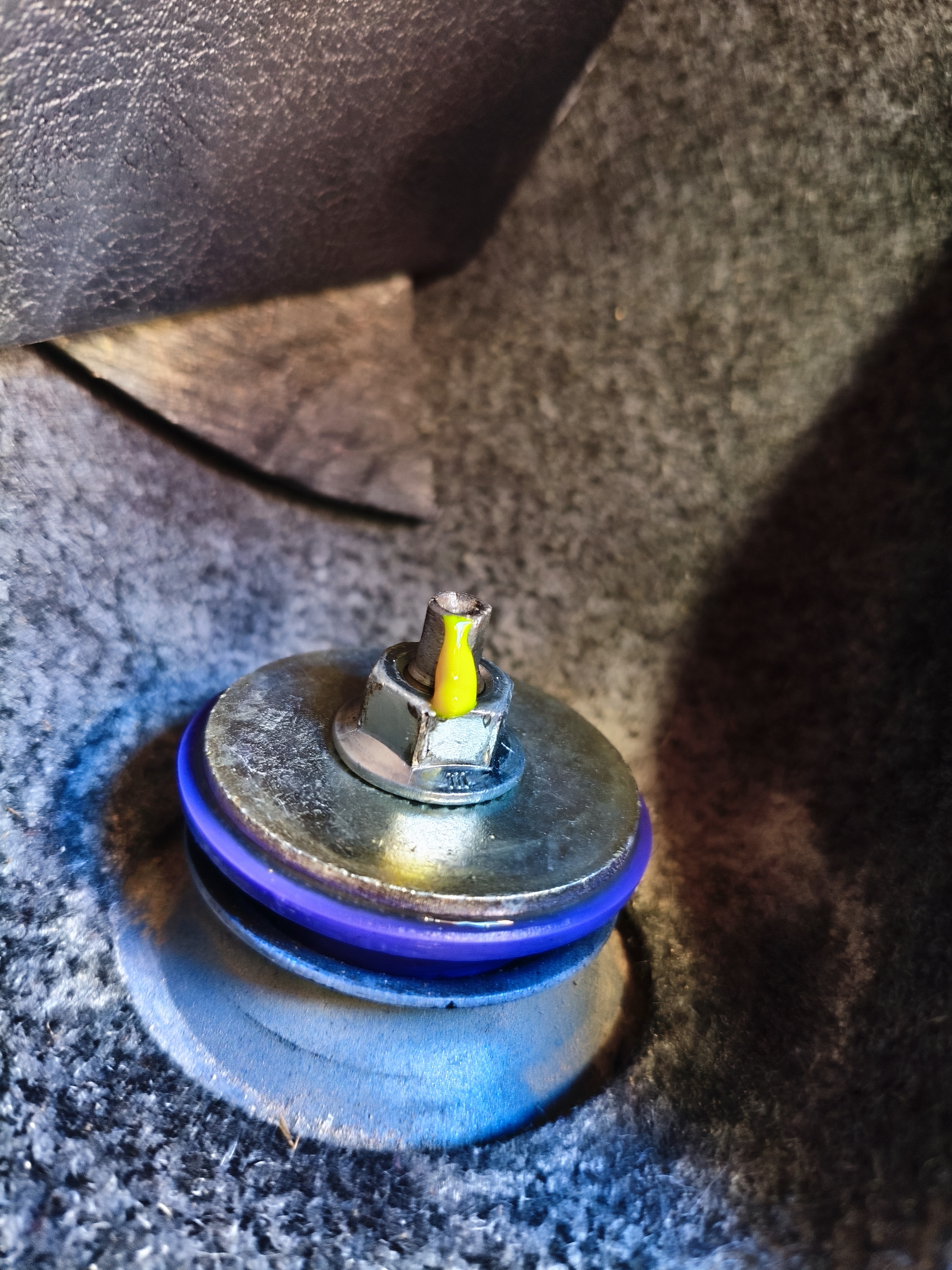

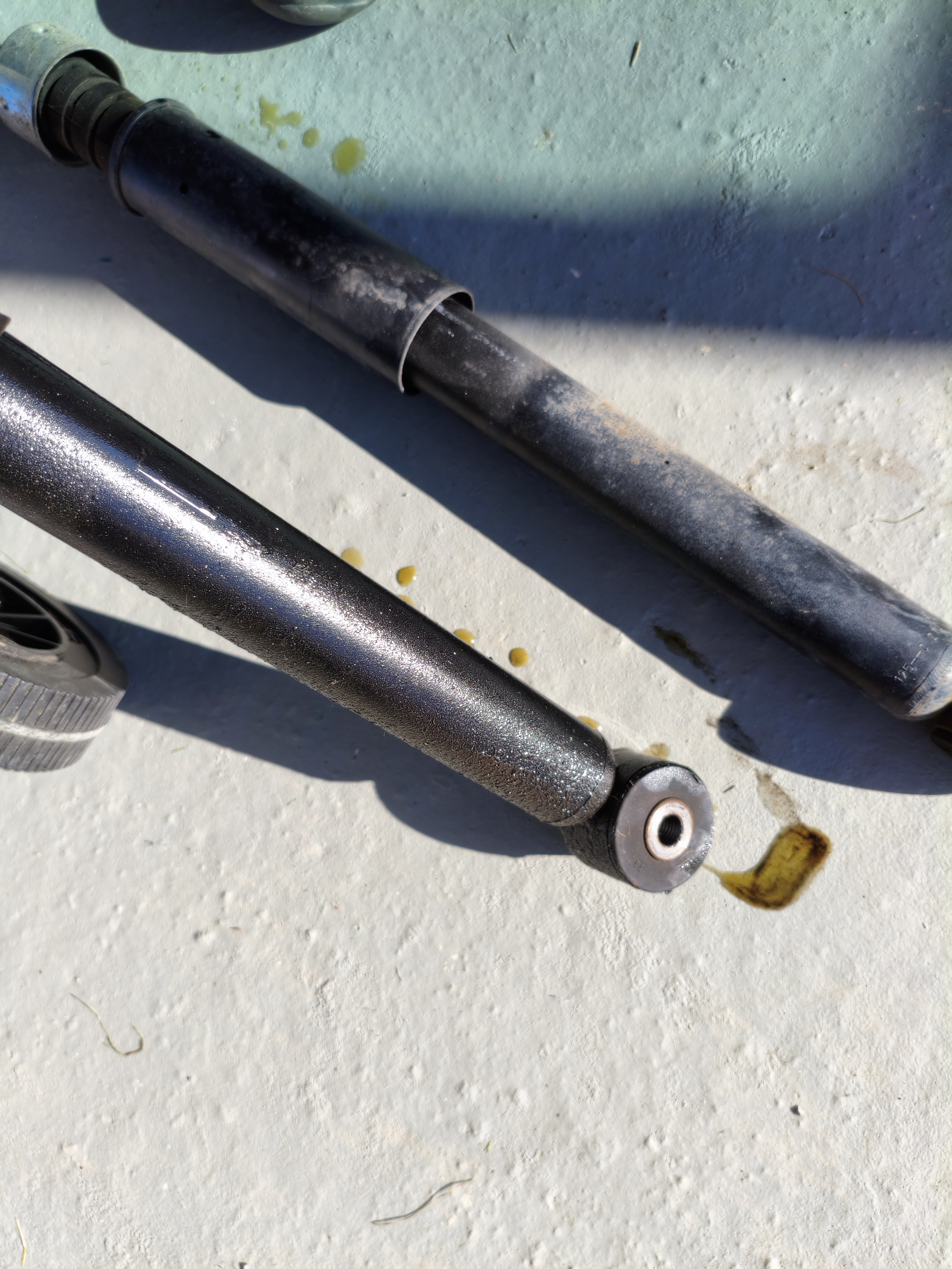

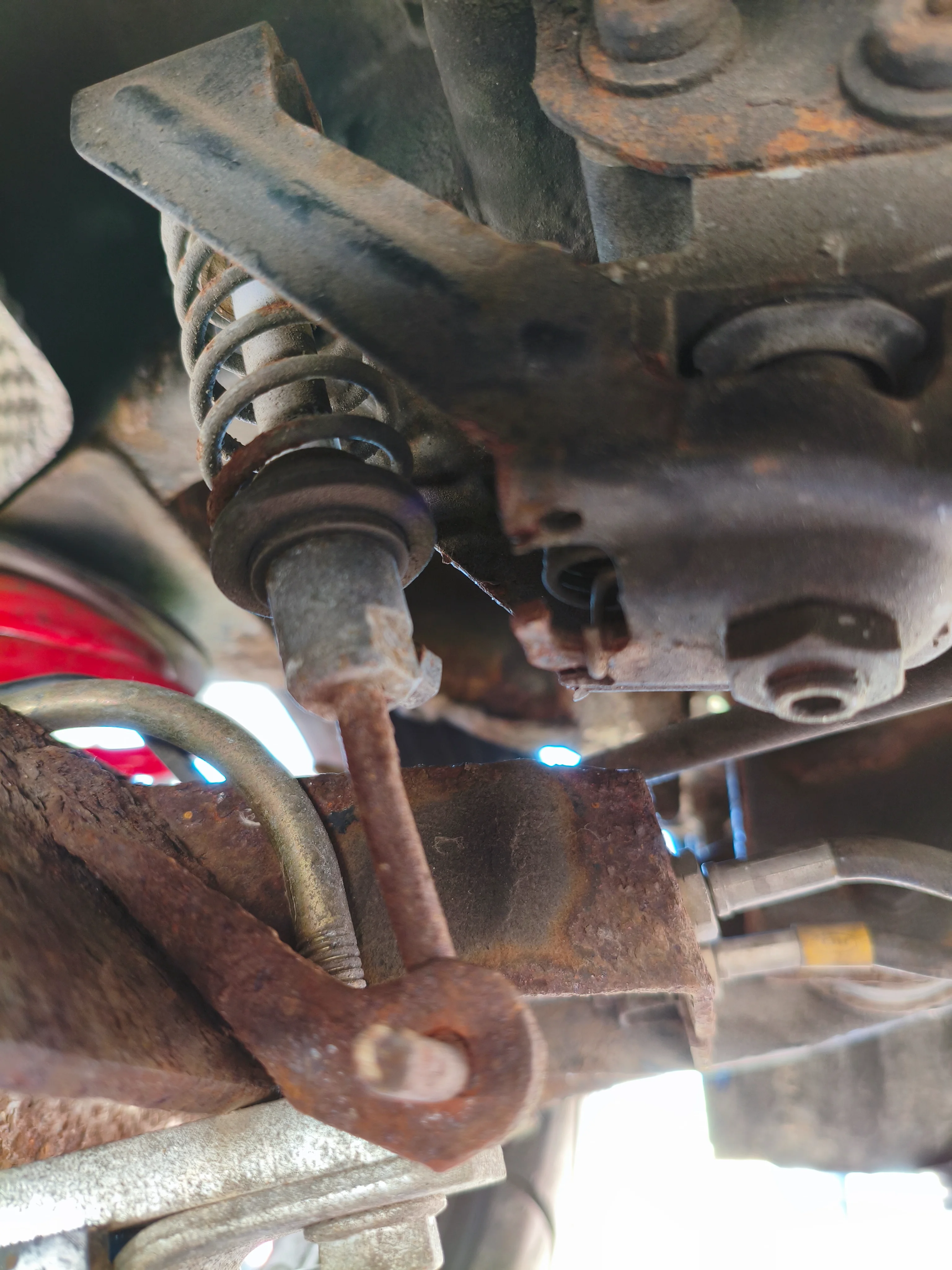

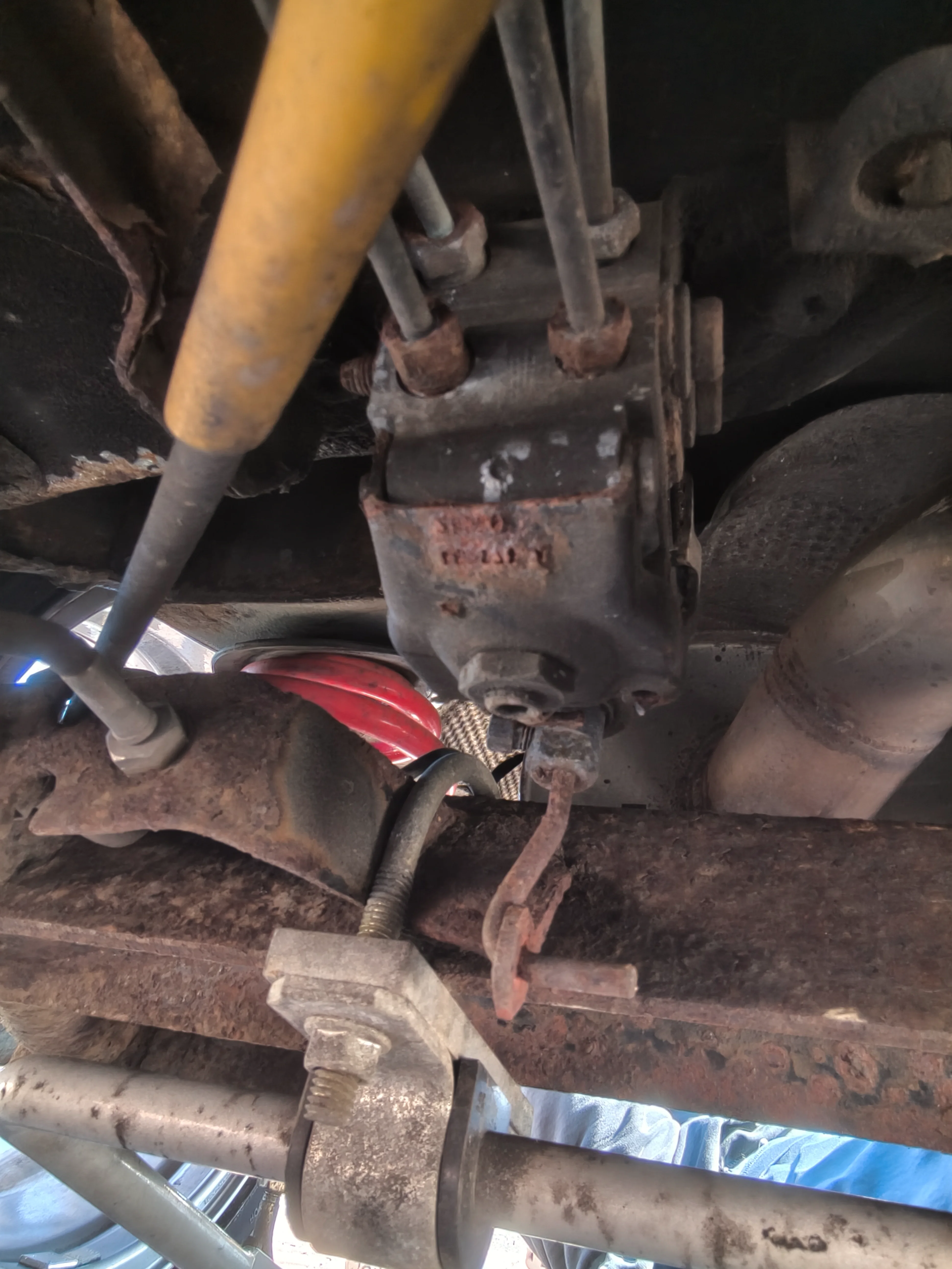

I went to move the Clio off the drive this afternoon to plug the daily driver in and noticed a little patch of oil under the NSR wheel, thought it was brake fluid at first but had a look under it and the damper was covered in oil, strange as they were bone dry last time I looked which was only a couple of weeks ago. It's forecast heavy rain for the weekend so I made the most of the sunshine and swapped the knackered shocks for the Gaz adjustables I had serviced by Gaz a couple of months ago and some new powerflex top mounts.
I wanted to do the stub axle spacers and camber shims at the same time as swapping the rear shocks but haven't got time today.
The state of the rear beam makes me sad, I can't wait to get it off the car and powder coated this winter.

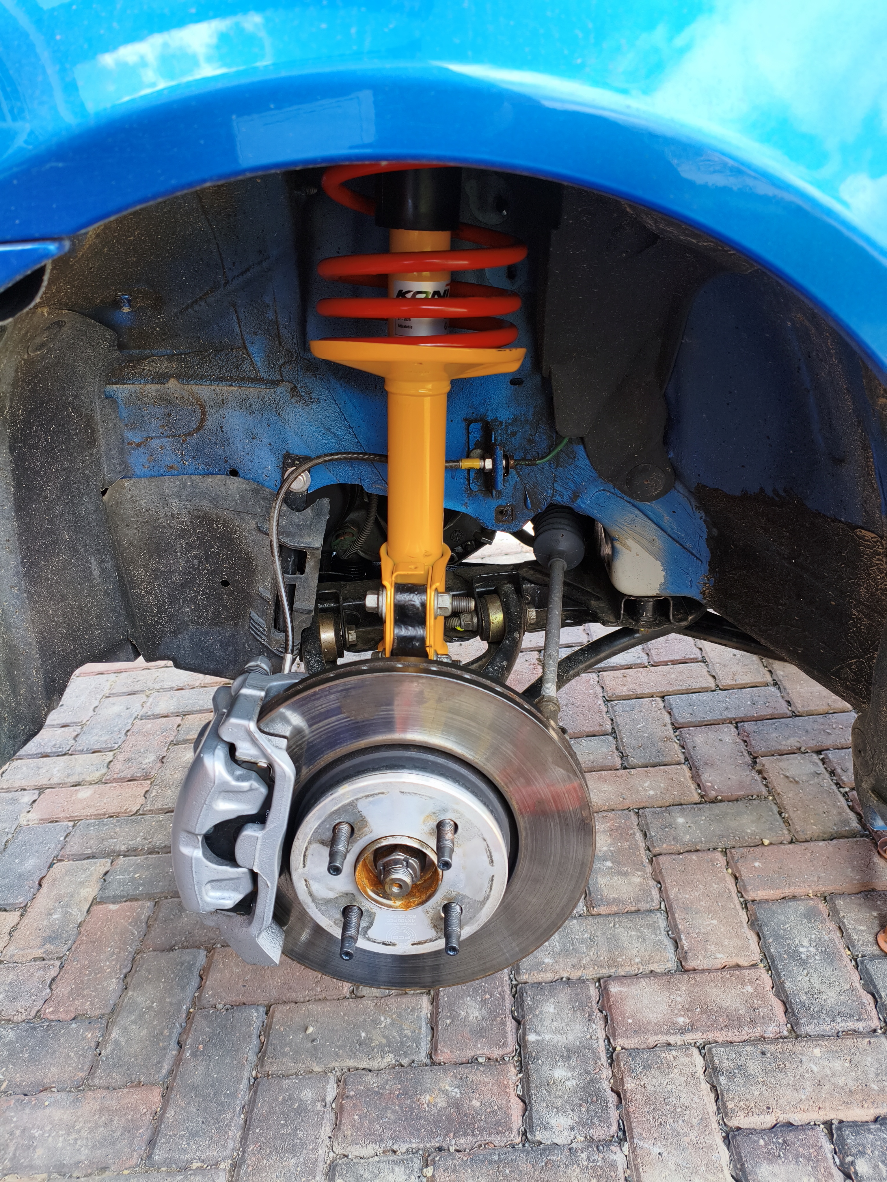

Got the Konis fitted today
Arches are filthy from driving it in the rain to get the AD08's fitted earlier in the week, I'll get a few hours this afternoon to give it a proper clean.

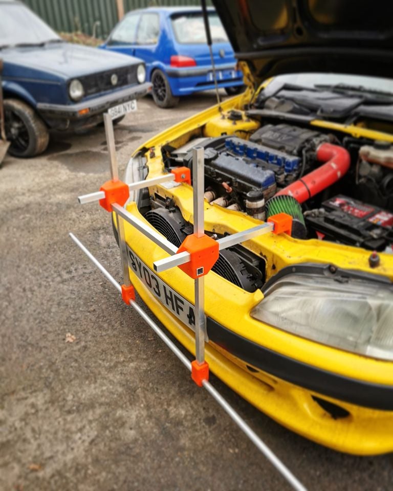

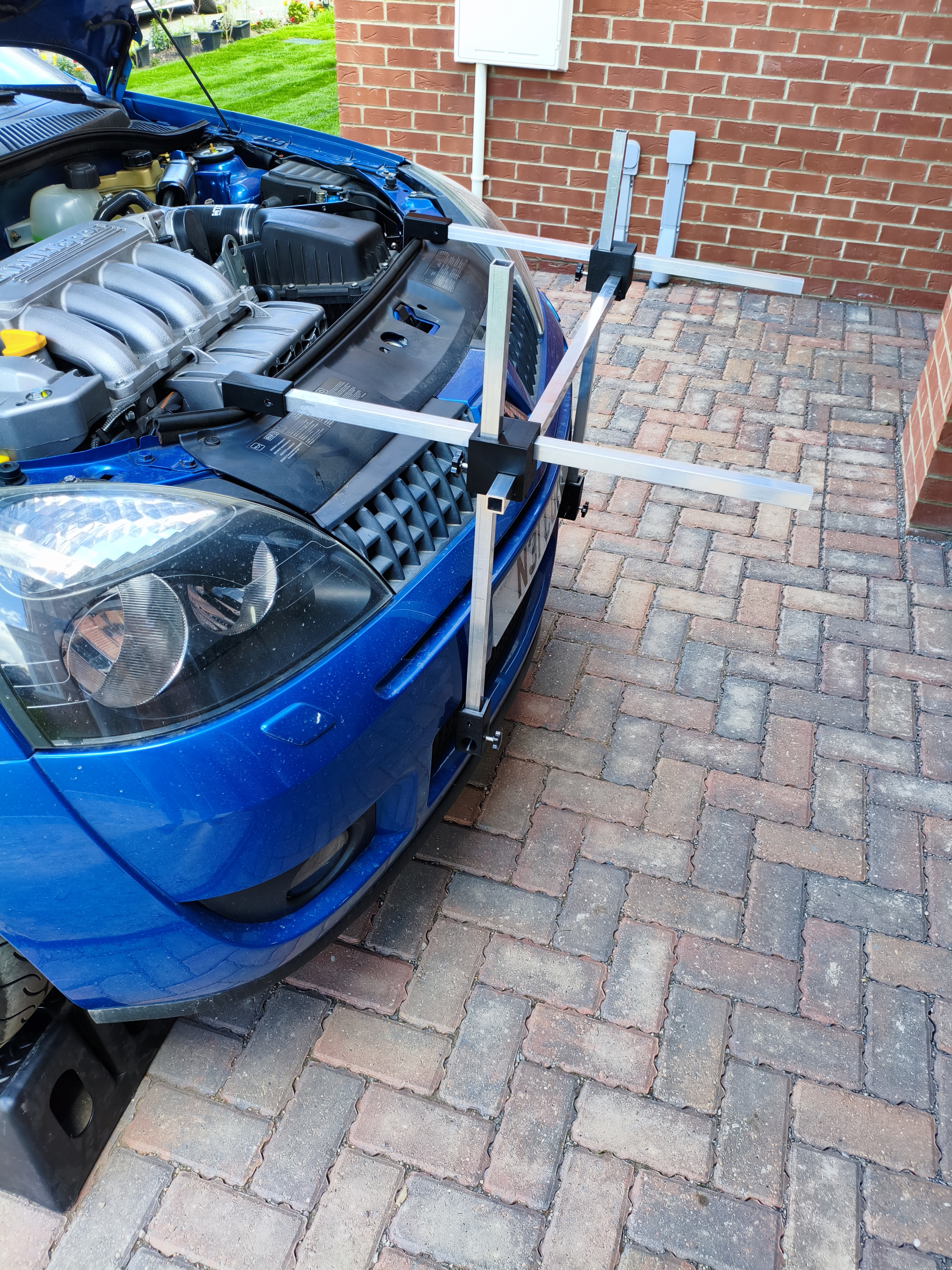

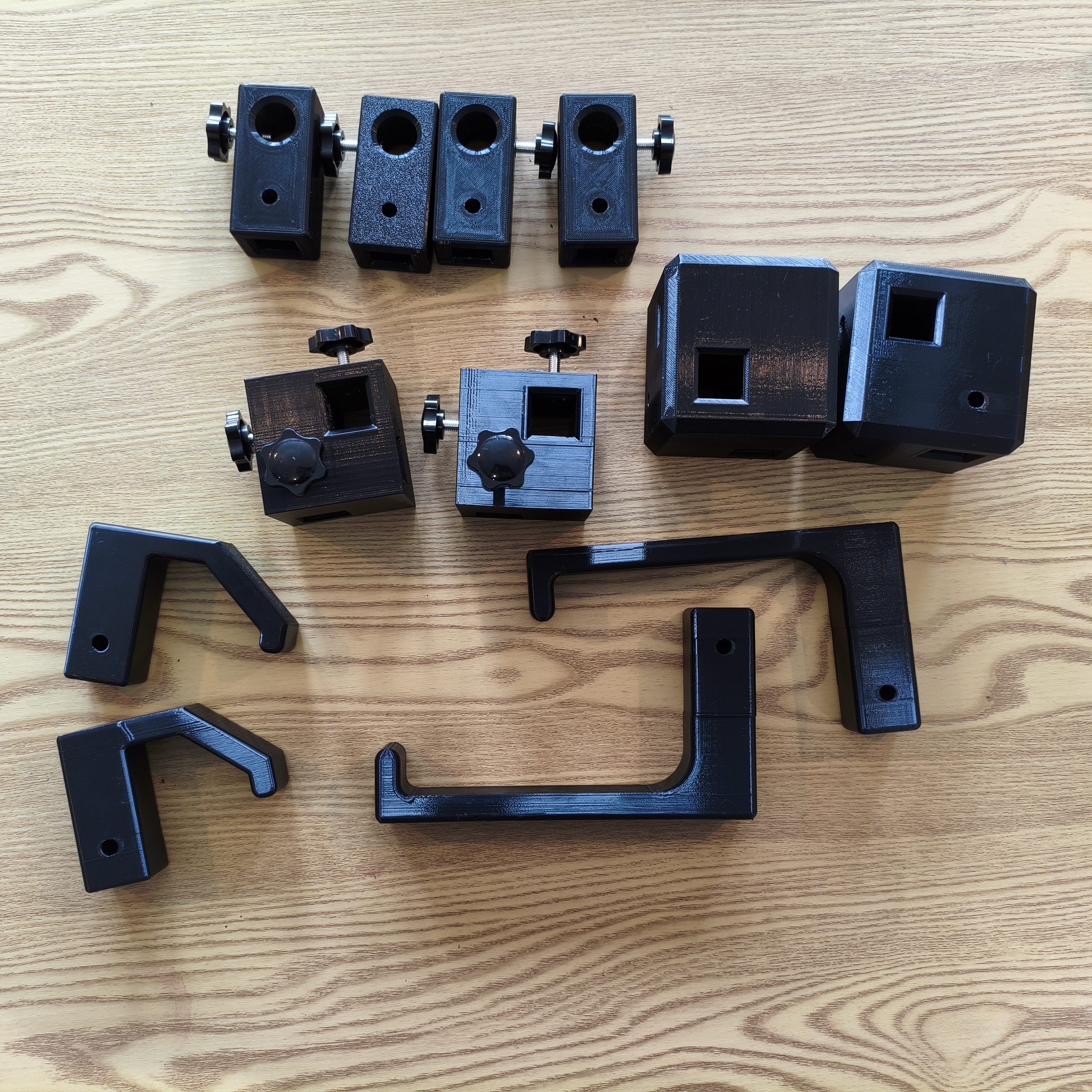

I haven't driven it yet to see how much the alignment is out but I've had a lad at work 3d print a set of string alignment kit parts, just waiting on some Ali bar turning up so I can get it squared up before CSF

Interested in the 3d printed string alignment kit, keep us updated.

Will this kit be able to buy?
I won't be selling it, I haven't got a printer (yet) and the lad that printed them for me is maxed out with his sideline of printing military trinkets.
That's the link to the free STL files I used, anyone with a printer can produce them, you'll just need to put the heating set inserts in, buy some thumb screws and some aluminium tube.
I'll happily give a materials shopping list for what I've used if anyone wants it

My aluminium arrived on Friday, so I've put the printed bits together and test fitted it
For anyone wanting to do the same you'll need:
2200mm 19mmx1.6mm round tube X2
800mm 19x19x1.6 square tube X2
600mm 19x19x1.6 square tube X8
280x280x3mm aluminium plate X4 (this is for the turning plates to go under the wheels)
A roll of anti slip deck tread (for the turn plates the tyres sit on
M6 thumb screws X16 (I got a bag of 20)
M6 heat set inserts X16 (I bought a cheap kit off Amazon)
M6X50 button head bolts X8
M6 nylock nuts X8
1mm paracord (I got a 50m reel for about £7)

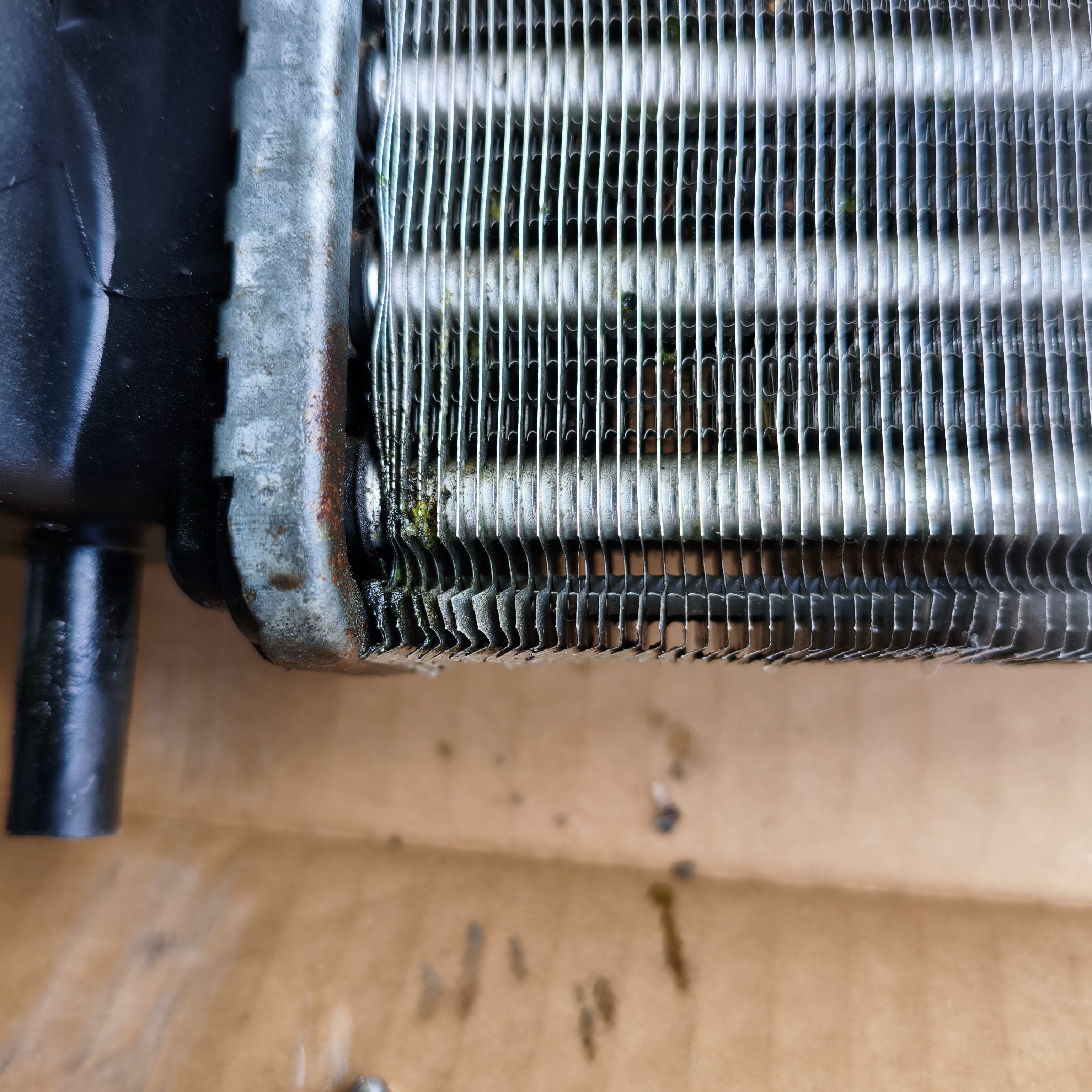

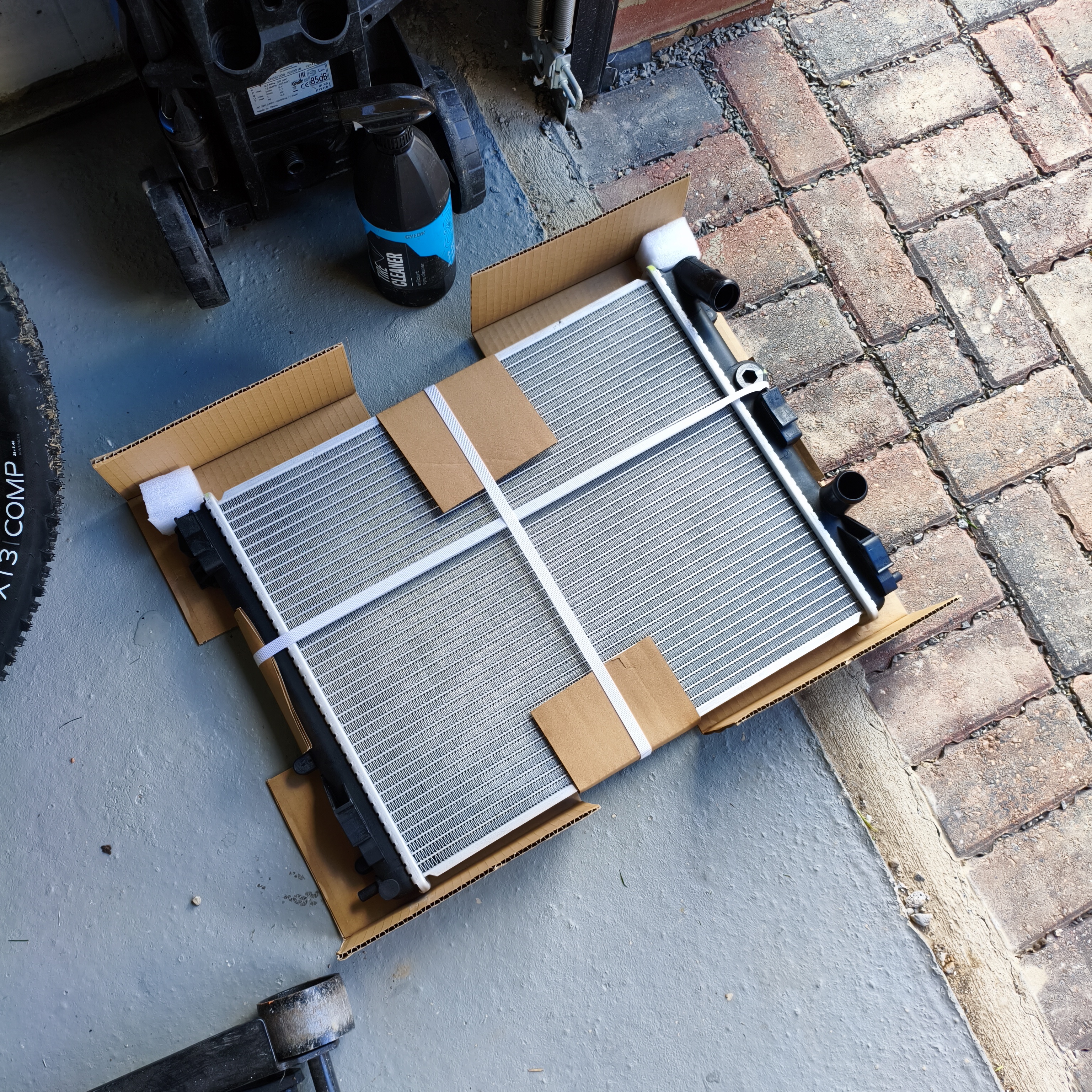

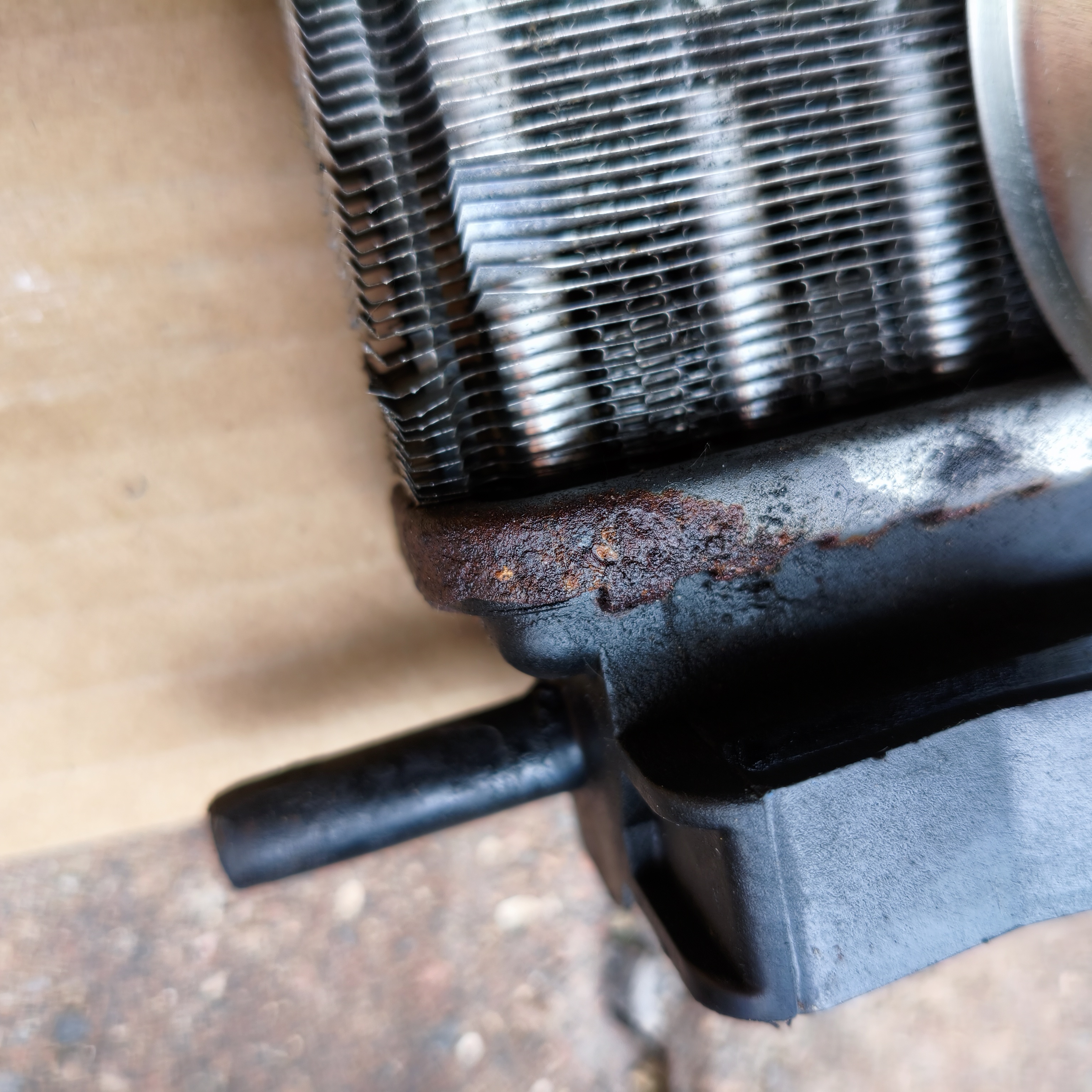

When I was fitting the oil cooler I noticed the bottom corners of the radiator looked a bit wet, not willing to risk a failed rad leaving me at the side of the road I ordered a Nissens replacement. It was on offer with euro car parts, £38 Vs the £100 or so PMS, Kam etc sell it for
I've also secured the oil cooler line to the alternator bracket, luckily I found this Rizoma bracket in the box of Ducati stuff, it was supposed to be a brake reservoir mount for a renthal handle bar, but it fit perfectly here, no more Pikey cable tie.
