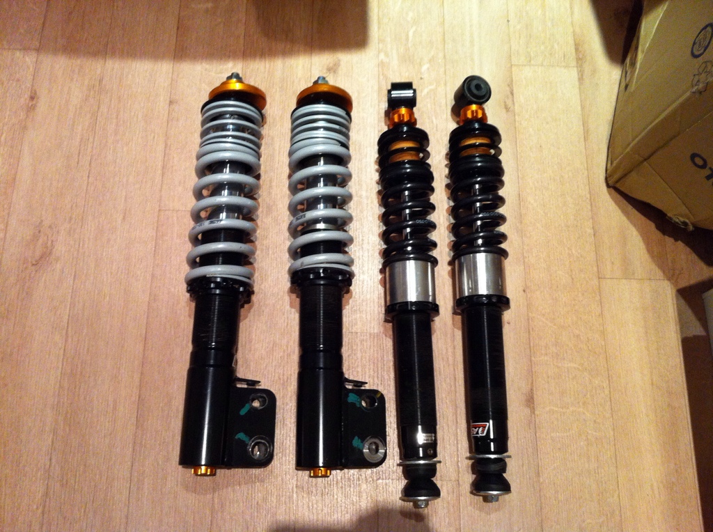

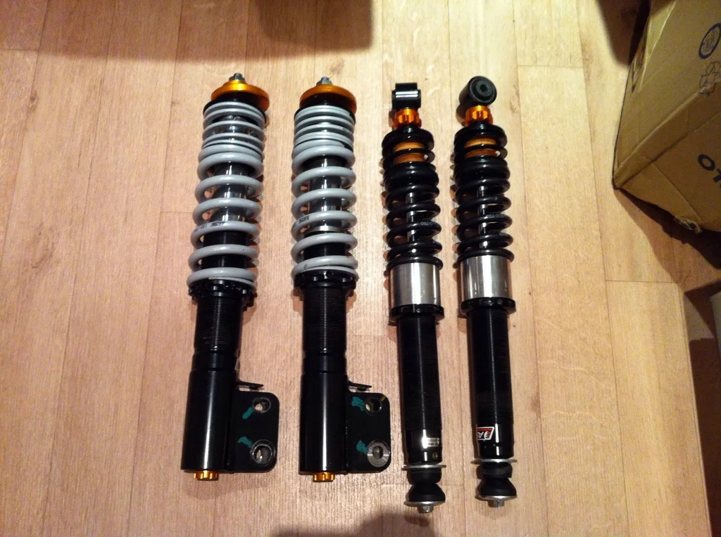

modifying coilovers from 182 FF to 172 cup
  RB 182
Who has done this and what was involved? What is the spacing difference between centres for each model?
If I machine the hole centres, is there anything stopping me slotting one hole, or making the one hole larger and machining a rocker spacer like the AST Sportline II coilovers? as below...
I don't really want to weld anything.
  182 FF
Would it be easier just to change the 182 cup hubs to the 172? Never done it but sounds easier than modifying the coilovers to a layman like me
  Clio182 RB Blue
They fit straight on because 172 cup and 182FF has the same bolt spacing! only the cup is different
