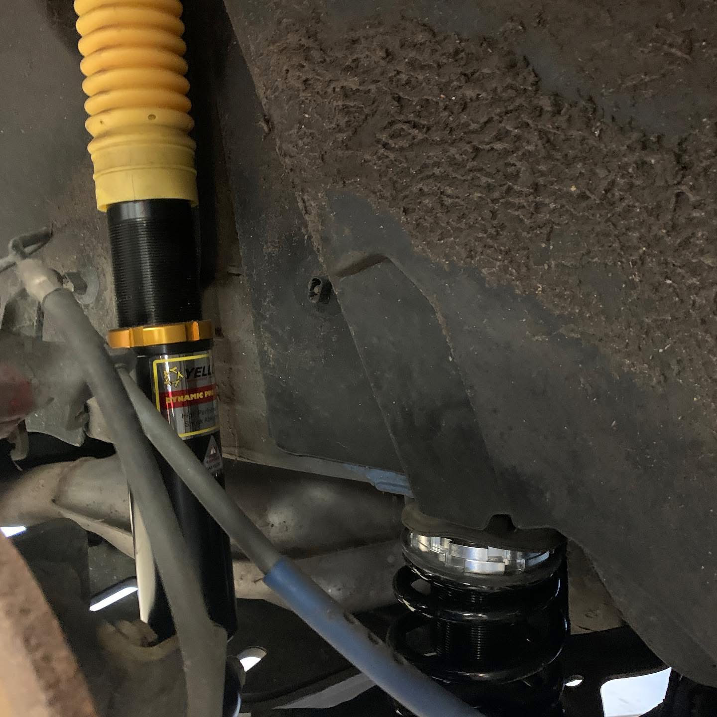

My RS200 is fitted with Yellowspeed suspension (previous owner fitted) and I'm now looking to adjust the ride height up to prevent rubbing / allow some suspension travel.
Having stripped down the rear suspension, I can see that the adjustable top mount (inverted top hat with adjustment threads) has a recess in the top to fit over the locating lug on the chassis. The lug is a lot smaller than the recess in the adjuster, so the adjuster is not located in a fixed position at the top and can move around on the chassis rail. Is this correct? It looks like there should be an insert in the top of the adjuster to give proper location, but this isn't present.
