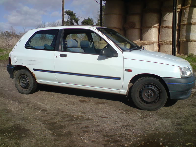

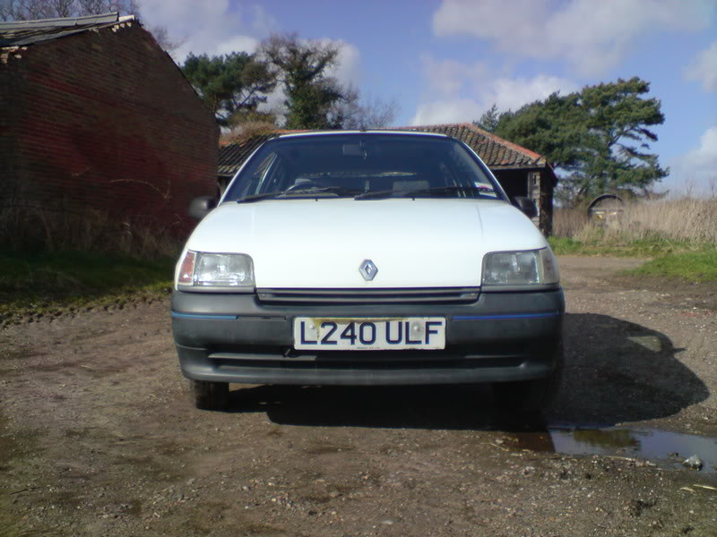

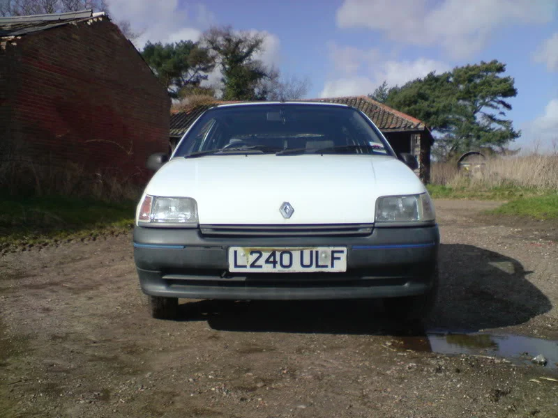

And so it begins, after being given my 1.2 mk1 clio oasis i have been struggling what to do with it, originally the idea was to 16v rep it, all well and good until i found out that the base model mk1's have a shallower body than the 16v so putting the front end on would look a tad wrong compared to the back. Now i am totally at a loss as to what look to go for, thinking maybe rsi may be the only way to go, however any suggestions would be greatly appreciated!!!!

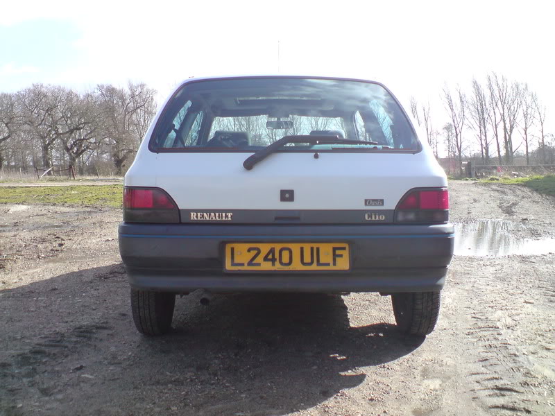

Day of arrival

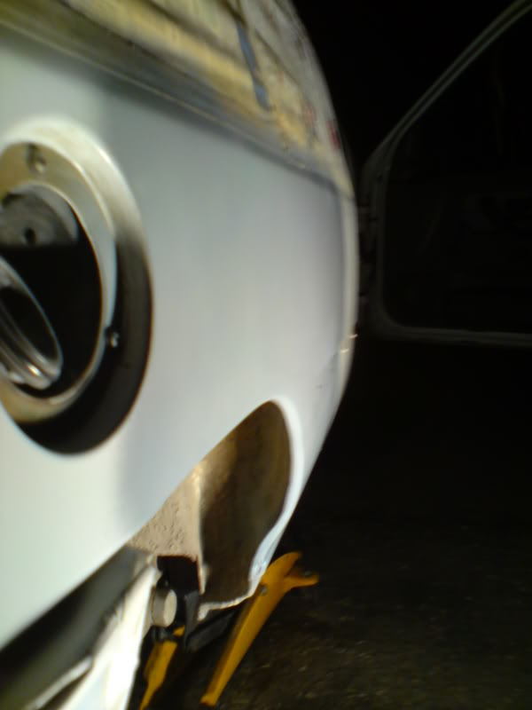

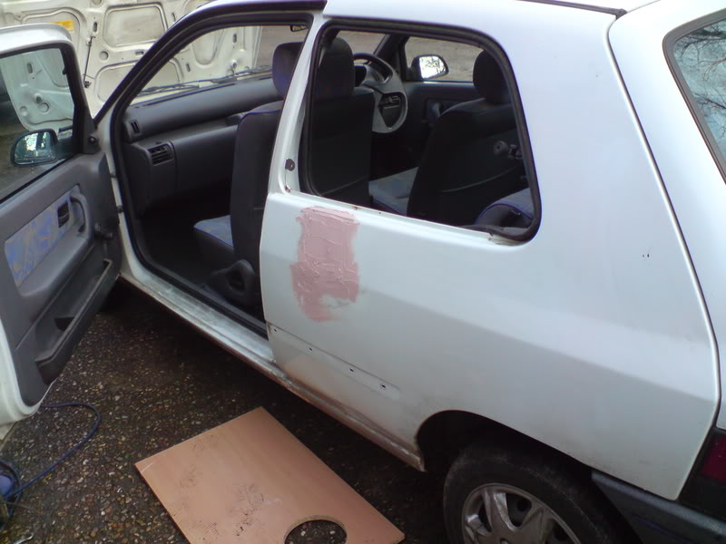

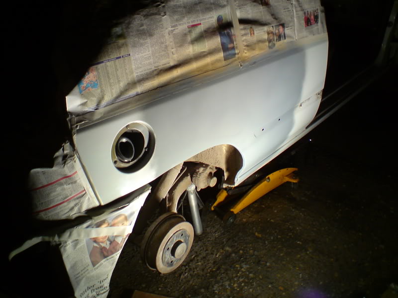

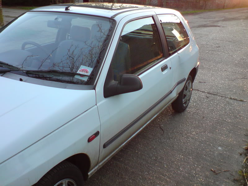

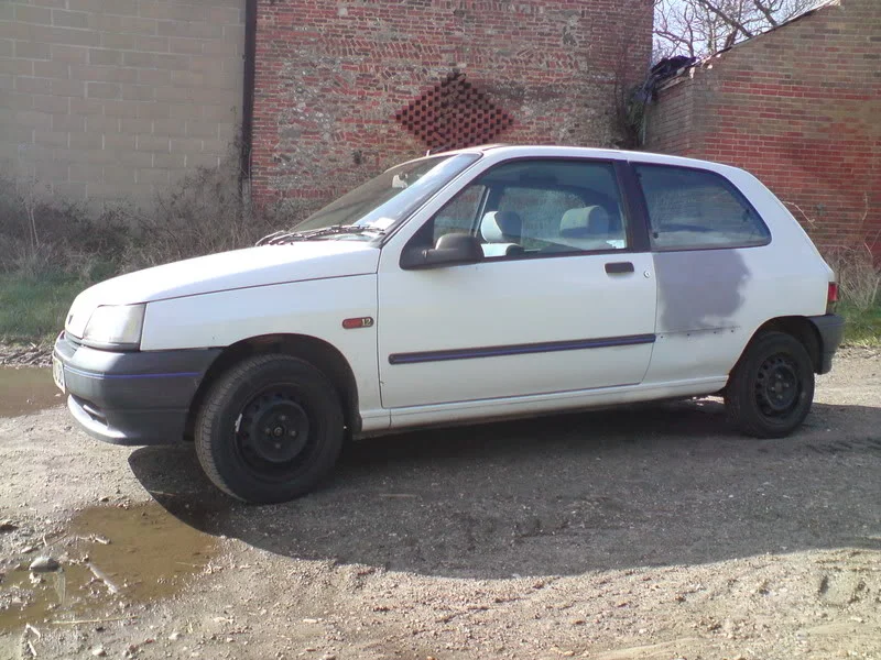

Conniseurs amongst you will notice the large dent in the rear quarter, fortunately most of this popped out so a little smoothing is all thats needed, started yesterday but weather turned a bit pants so had to cut it short...

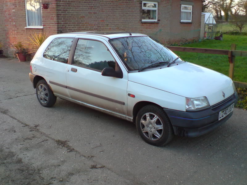

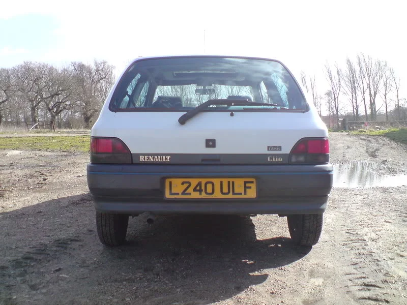

And as she is today....
But as i previously mentioned i dont really know what to do with it, thinking 16v interior adding the creature comforts, central locking, leccy windows 16v dials etc, colour coded bumpers, off rsi possibly, de lock and smooth tailgate, respray in original colour, lowered and turbine wheels, However any suggestions are welcome!!!! Also at a loss on what to do engine wise, originally was thinking 1.8 16v but was wondering whether a. I could fit a 2.0l in or b. 1.4 turbo form r5. Anyways kinda rambling for now, will keep the thread updated and would appreciate any tips or tricks and any offers of parts that i need!

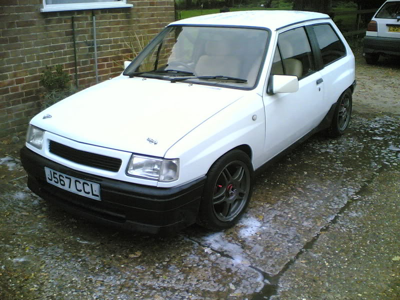

  Clio IV 0,9 Tce
You know the front wide arches from a 16V is just plastic and a straight swap over. Quite a few people have build 16V reps without the wide rear arches. You little car got potential

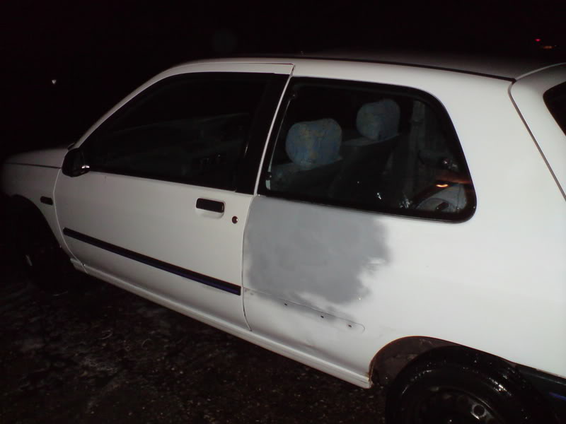

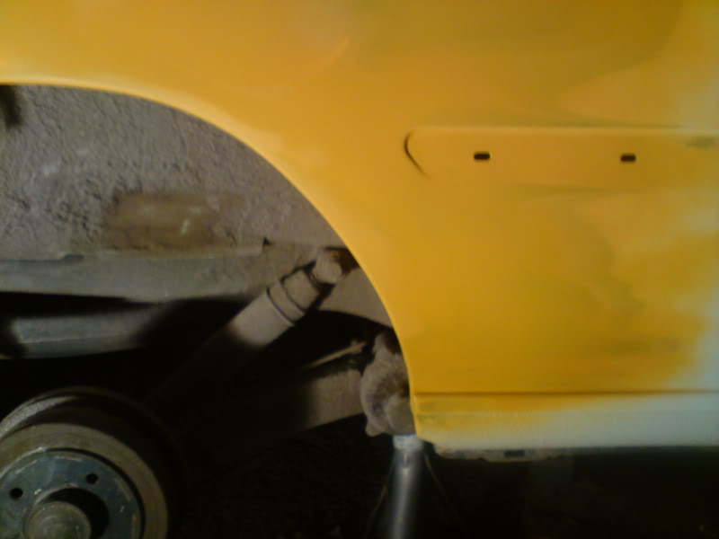

Small update, decided against the rear arches, sleeper/euro is gonna be the look me thinks! So got to work on the drivers side dents for now, pretty much done there, gonna start proper on the passenger side once the weather clears up! Advice: dont have a project car on a farm! stupid farm gate caused the dent in the first place and trying to fill and paint on a dusty drive in the wind is a waste of time! Gonna hire one of the barns to work in i reckon! Anyway here's the driver rear arch, not much for now, Poss got my interior sorted, Need some more advice though guys!

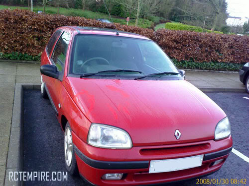

Example is my car, red and black, suits it nicely.
