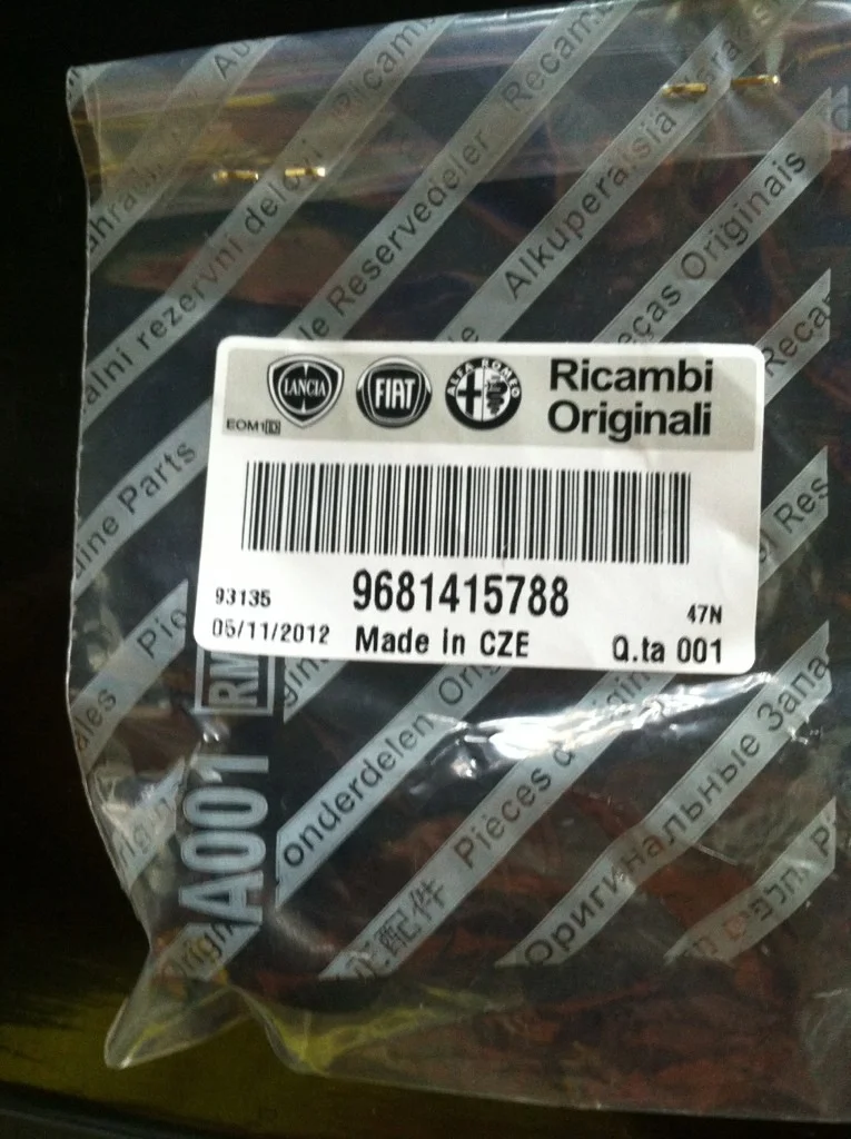

Ive just brought these also, i was surprised when they turned up in a alfa, lancia packet aswell lol
  172 Cup & Mini C 1.6
Heres the packet lads

Ha well it seems its not just me receiving alfa/fiat/lancia ones.
They work well though so im pleased with them.
