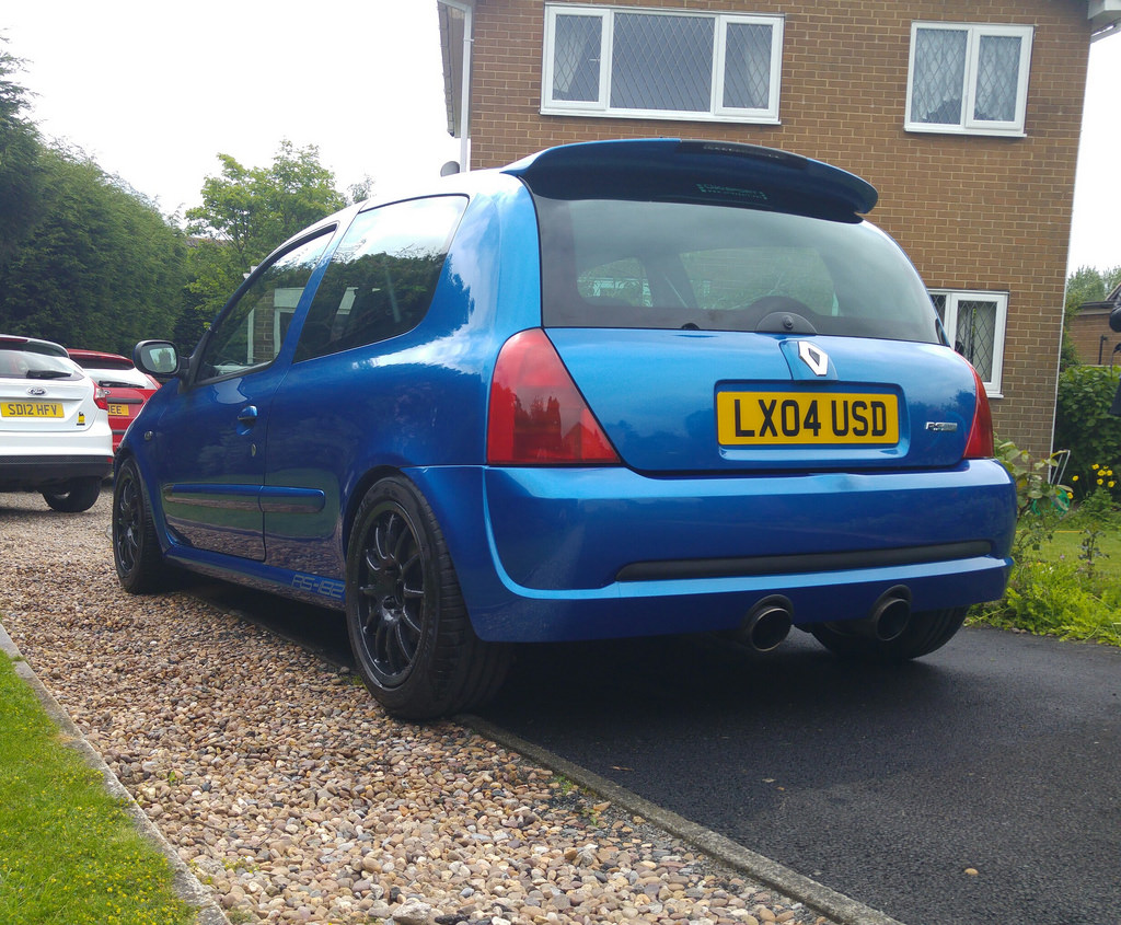

I run 15" ET25 on the rear with no spacers and this is what it looks like
2016-06-22_08-44-15 by dann2707, on Flickr
That's on Bilsteins with the adjusters removed so it's pretty low.

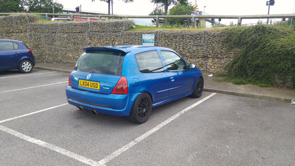

And this is with ET40 with 10mm rear spacers
20160530_132102-1 by dann2707, on Flickr
I get no scrubbing, only when going a bit too fast over speed bumps.

What size tyres? I had rubbing when running et35 with 450lb Spring rate aswell

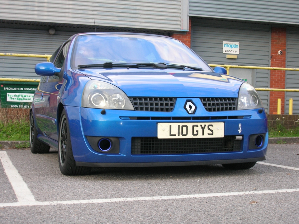

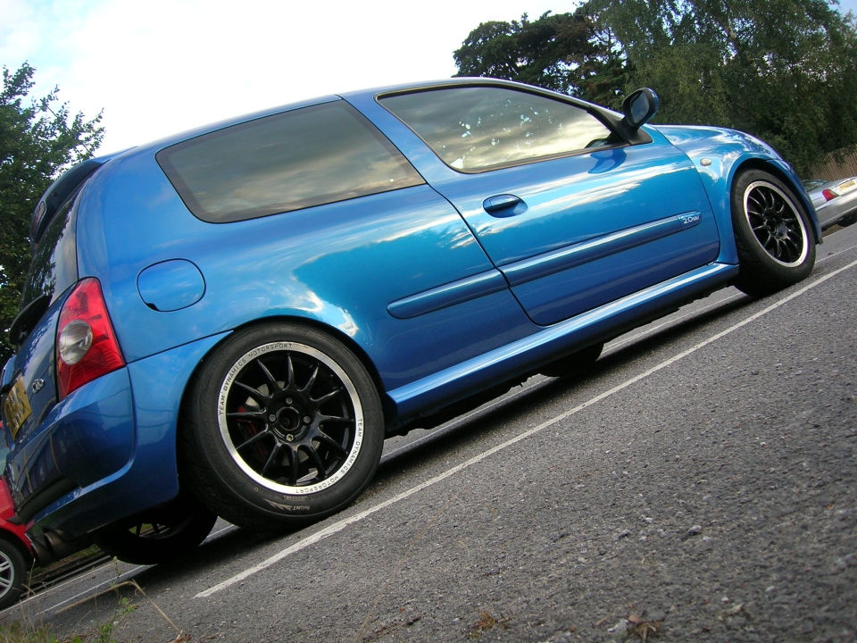

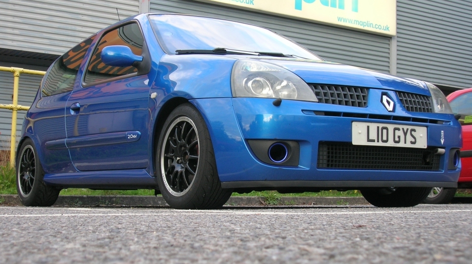

Dont forget its width that also effects where the offset makes them sit. a 6 inch wide rim with 30mm offset will sit in the same position (in relation to the outer face) as a 7 inch rim with 42mm offset, but the same 7 inch rim will be 25mm further towards inner arches/springs.
Heres mine (7 x15 with ET35), lowered with all round GAZ coilovers, as far as possible so standard 16s dont catch. (use the 15s for track). The fronts catch on inner arches when car is pushed on track, but hardly at all when not on limits. So this wouldnt matter what offset as its just the lowering that affects where they catch.
