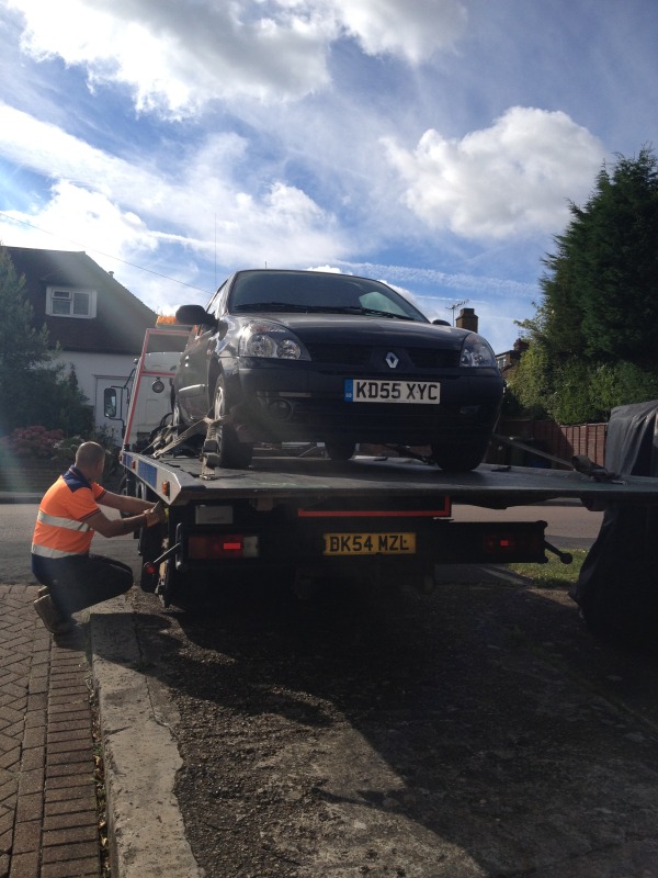

Have given up on this now, Car left for Renault Watford this AM:
