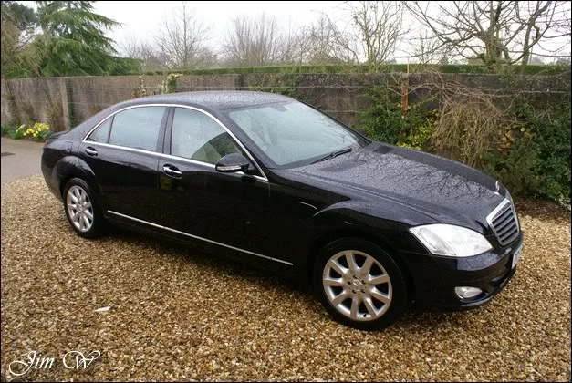

Mercedes-Benz S-320 CDi
After completing both the black 650i Cabriolet and the black GL420 CDi, the Father of the household wanted his (yes, you guessed it) BLACK S-Class doing. This time going through a single-stage machine correction..

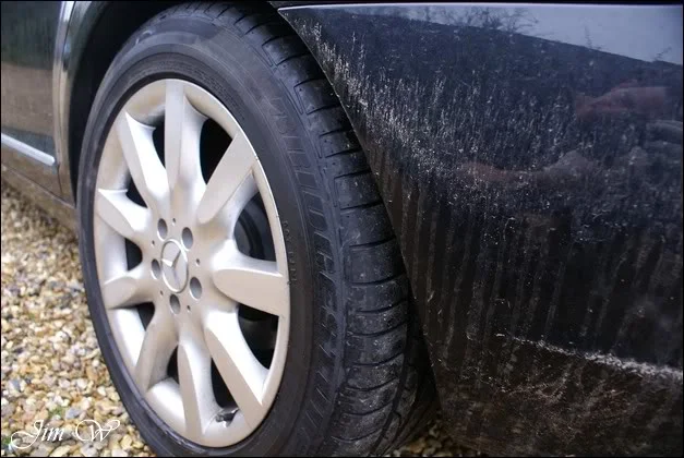

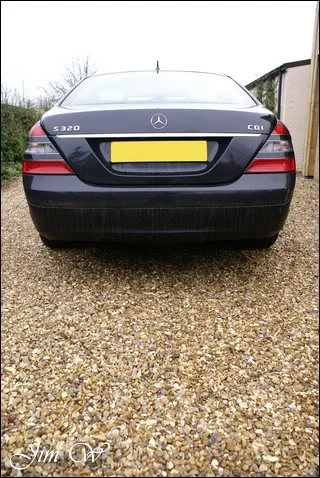

Hidden beneath the dirt, the paint’s looking a little flat.

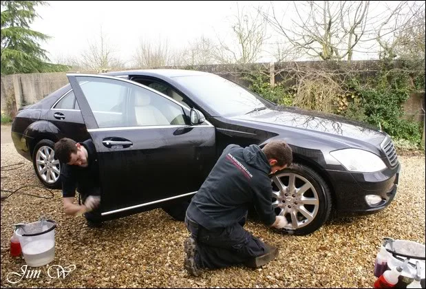

After setting up base, I always start with the wheels/shuts.

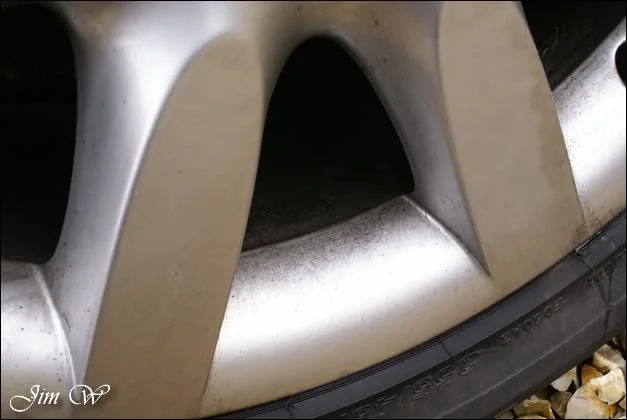

Wheels/Tyres/Arches – Megs Wheel Brightener. AutoSmart G101. AutoSmart Tardis. Megs Super-Degreaser. EZ Wheel Brush. Wheel mitts. Vikan Long Reach brush. Envy Brushes. Sonus Green clay

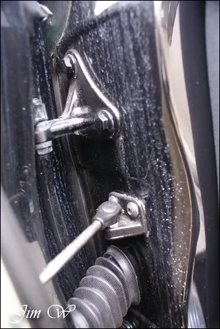

Shuts – AutoSmart G101. AutoSmart Tardis.
I spent close to an hour on the wheels alone; the inner rim was far gone. The facings suffered from pitting in the corners, Sonus Clay and Tardis were able to shift the most of.

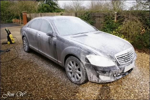

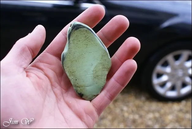

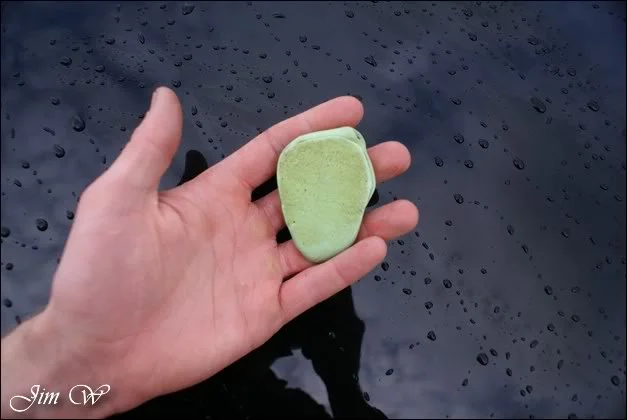

Snowfoamed > Washed > De-tar > De-contaminate (Clay!)
A selection of sap and tar being dissolved by Tardis:
This car had LOTS of tree-sap on. Little yellow specs that were an absolute bugger to shift!

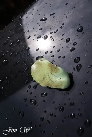

Claybar after half of the bonnet: (yellowing from sap build-up)

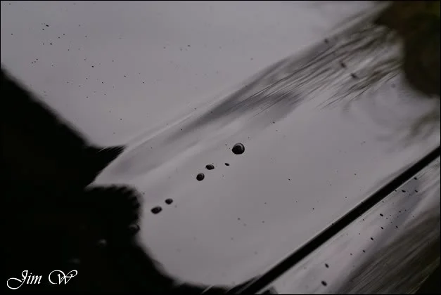

Car re-washed and water-sheeted over the panels to aid the drying stages.

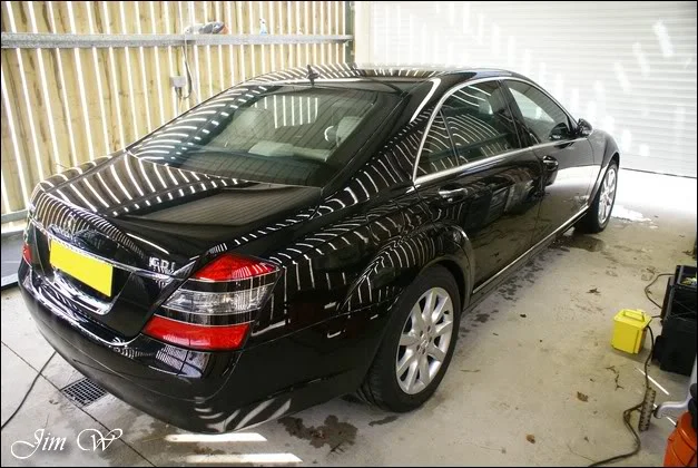

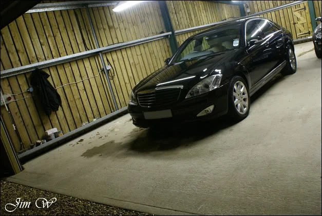

Once inside and garaged, the scale of the job became apparent.

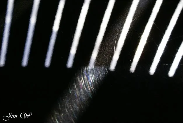

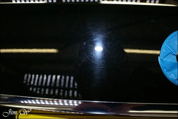

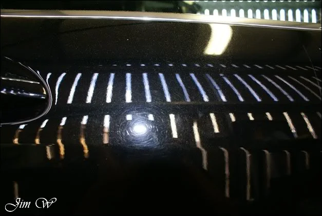

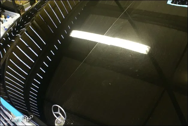

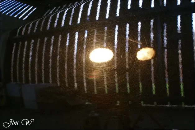

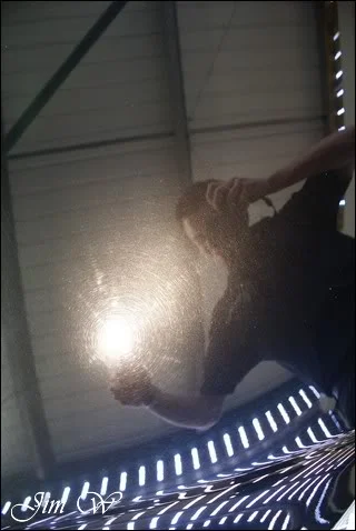

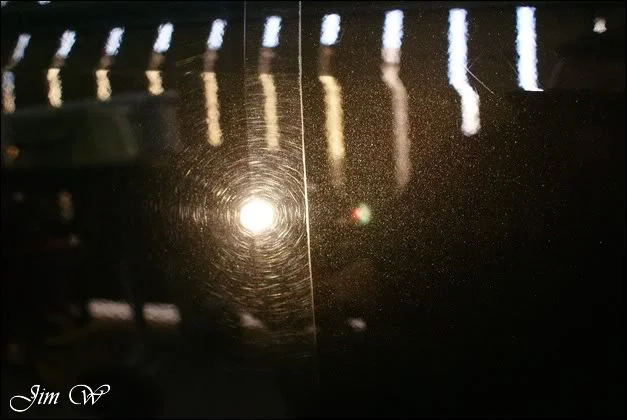

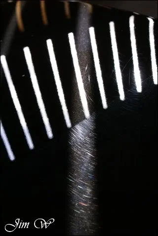

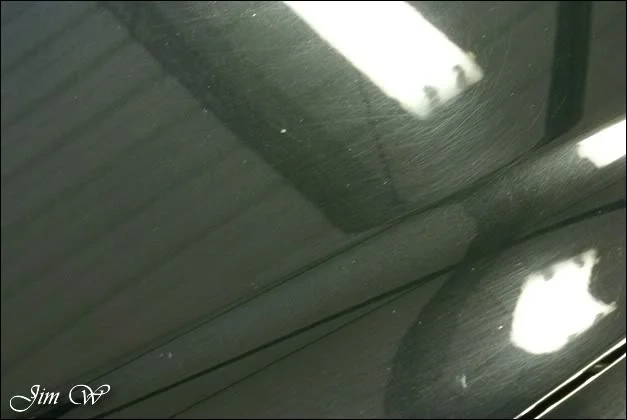

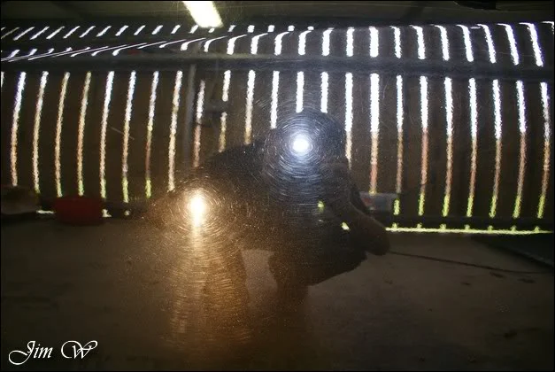

A grey haze caused by a sea of swirls. But check out the above photo on the bootlid, some awesomely deep scratches on there!

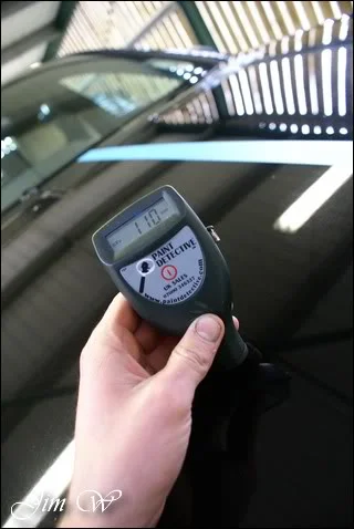

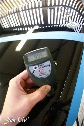

Under the Brinkmann:

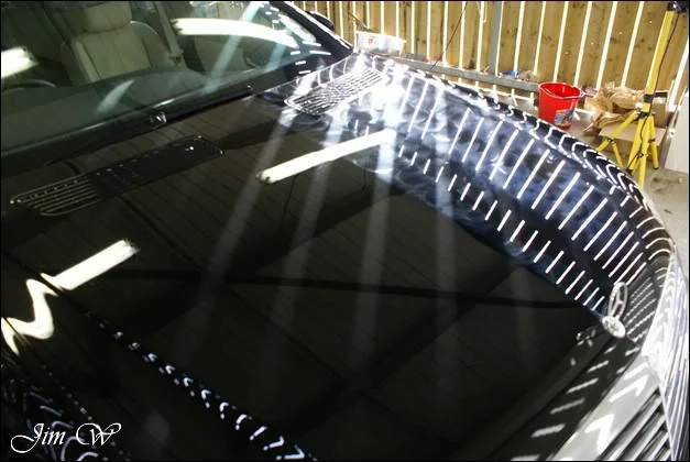

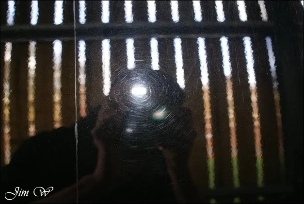

Starting with a test section on the bonnet,
Menz 203s de-swirled the car, but, struggling with the deeper stuff.

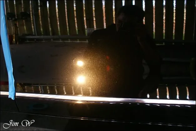

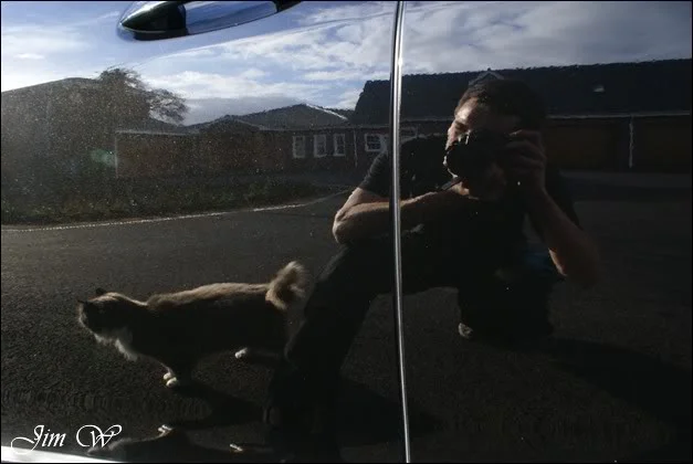

50/50 on the o/s front door:
Bonnet 50/50:

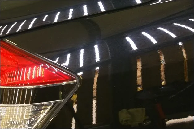

o/s rear quarter before and after (a hazy grey, to black)
A big 50/50 on the bonnet under strip lights:

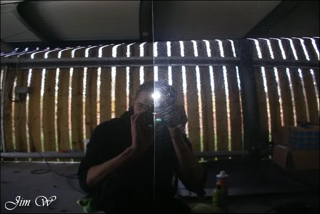

50/50 in the morning on the boot-lid. LOTS of deep scratches.

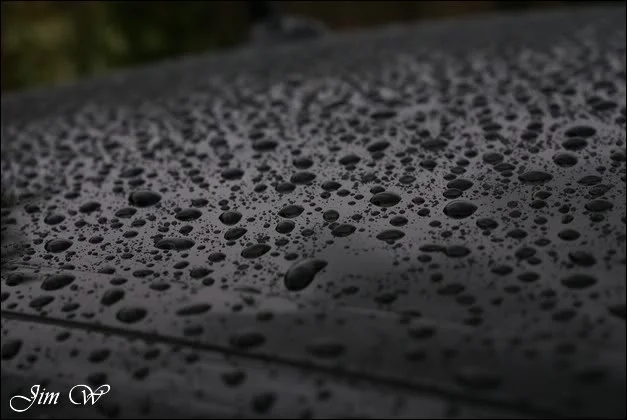

Whilst dodging a brief rain-storm, I managed to again sheet-water over the car to aid drying.
…as seen, only a few dots of water left to collect now.

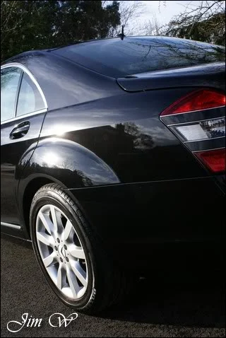

S-Class after being BlackHole’d.
Wax on, Wax off:
At this point, I quickly dressed the tyres as I wanted to catch the last of the afternoon’s sun for some photos. Windows, wheels, final wipedown etc yet to follow..
…and back inside before the rain returns! (Which it did)

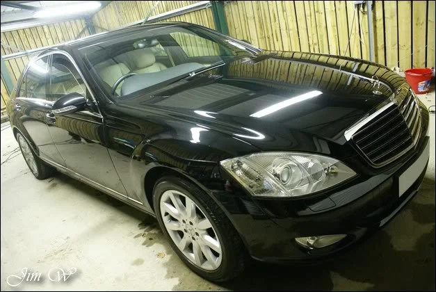

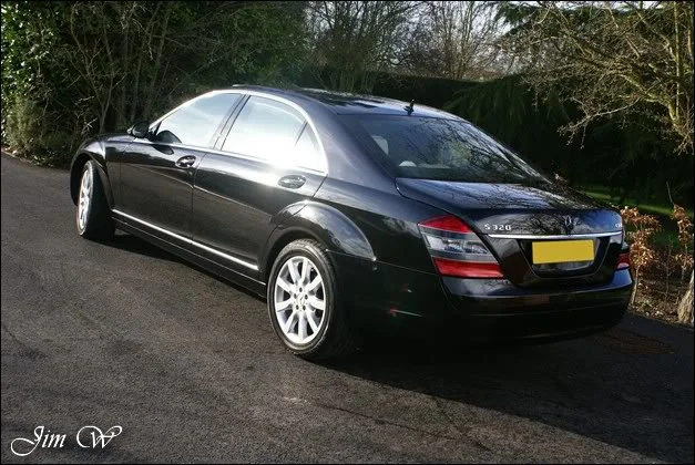

Final exterior touches were finished..

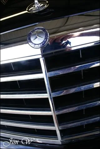

Grille and other britework polished and protected with Jeffs Werkstat Prime.
After:
