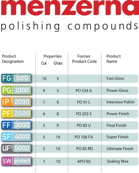

This will help with the new labelling

Thanks for the info guys, I think it's the new labelling that's confused me with my searches.
so I'll order PF2500 and UF5000 and I'll start with the 5000 with the softest pad and work up from there cheers guys

I bought the i4 Menzerna DAS-6 package way back in March and have only really looked at it properly today! After reading the bottle and looking on i4's website I'm a bit concerned that the PF2500 I got with the kit will be too coarse as it talks about sanding marks rather than swirling?!? Am I fine to use or should I invest in something less harsh??

There are 2 mate. Look on the bottom of the bottle and let me know what it says.

It's the PO203S one that you talked about on your previous post. My concern is that having had my car detailed by Jim White last year and not really washing it much since is the polish too much??

203's is fine mate. Just don't use too harsh a pad.
I'd personally use 106fa or a finishing polish but 203's is fine mate.
