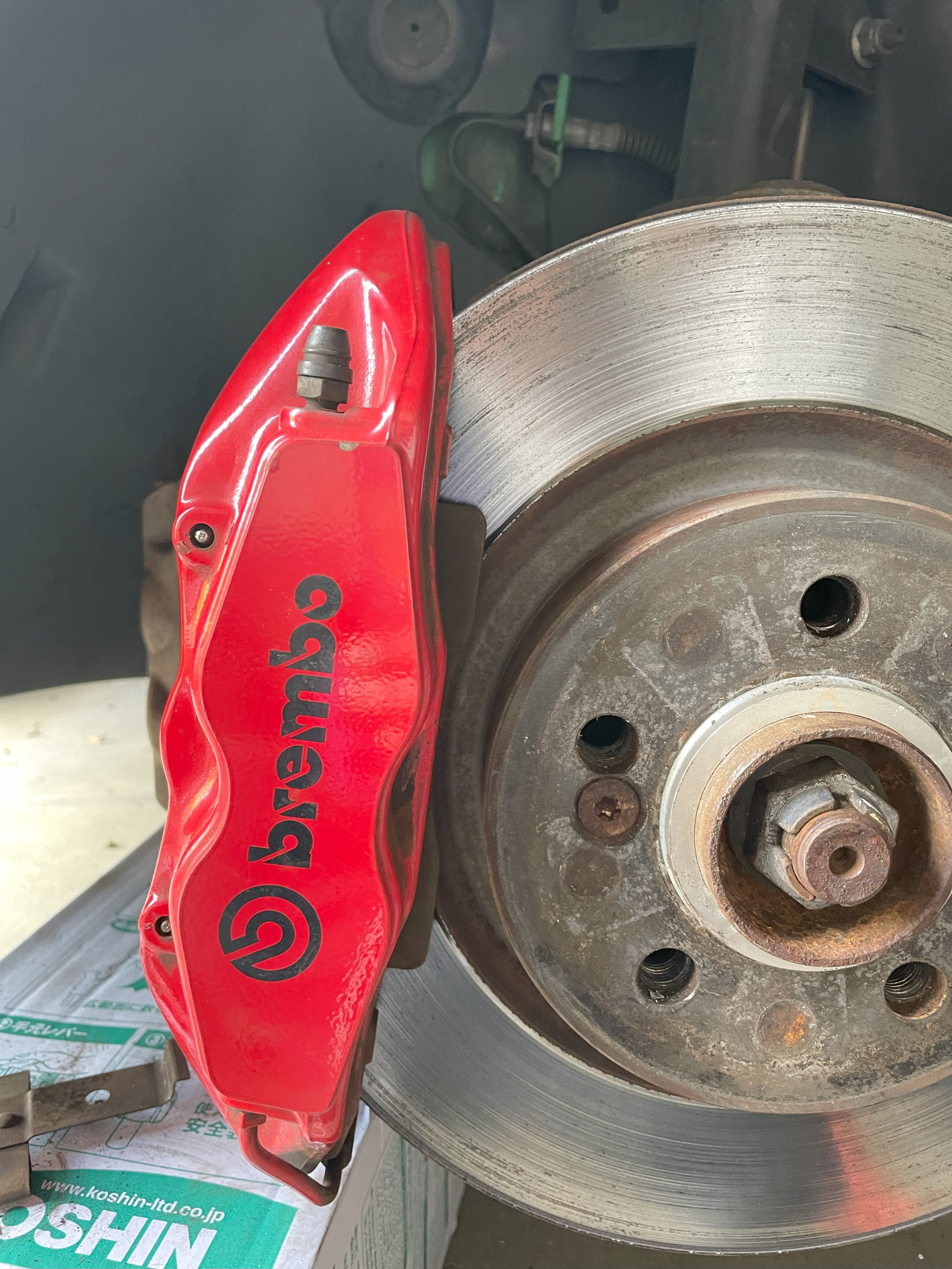

Do you have any pictures of the problem?
Remember that the Megane brake pad is meant to be used on a 340mm disc normally, so there will be slight differences when using the Godspeed 330mm discs

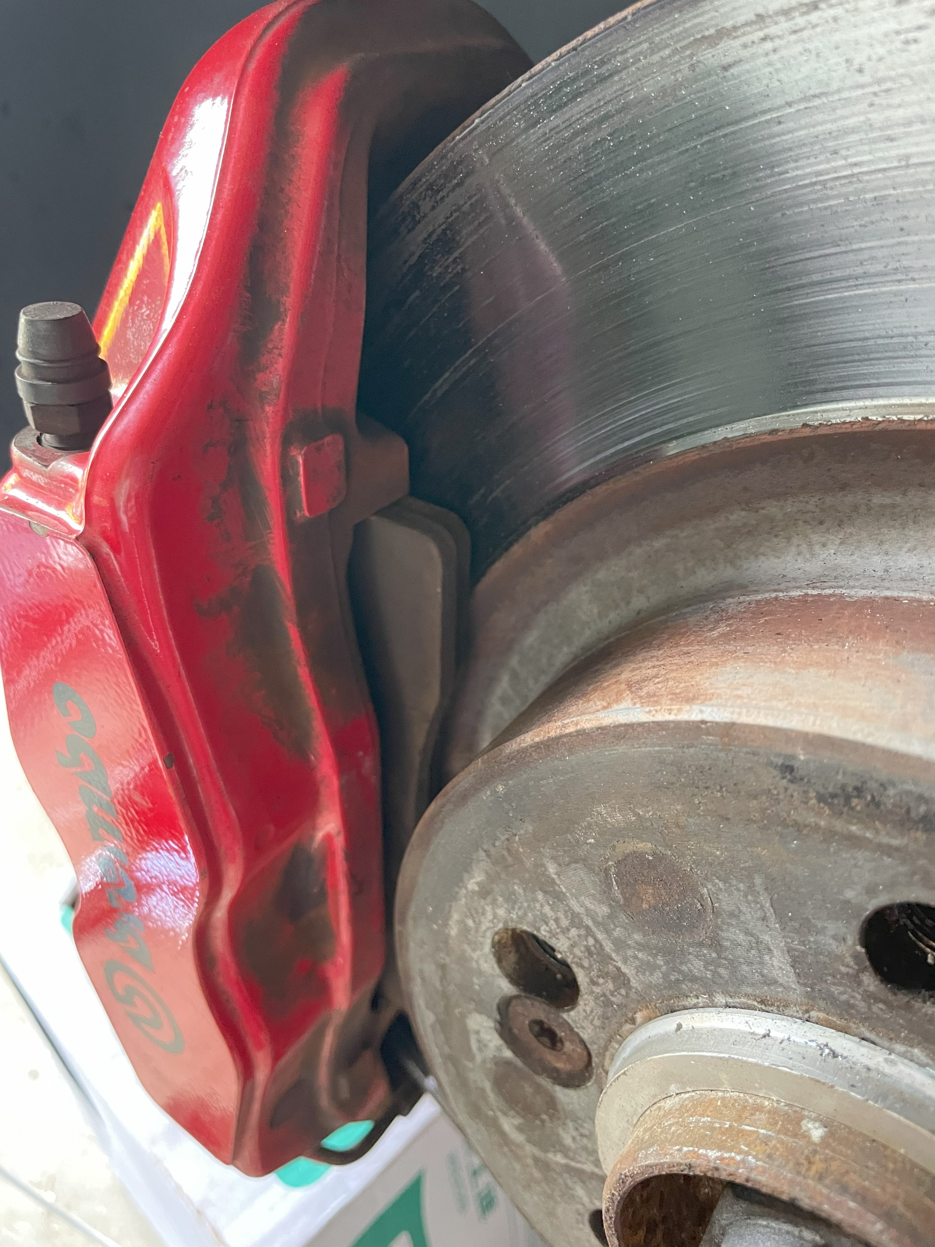

Thank you for your reply.
As you can see, the brake pads are sticking out.
This caliper remains the original Clio3, so it remains 312mm.
If it's up to 330mm, it seems like a 17-inch wheel can handle it, so I'd like to go with 330mm if possible.
RSRowe
  Megane 250 Cup
Ok I understand. Really you need to use the 330mm disc. I appreciate that they are costly, but they do fit ok inside of the standard Clio wheels.

Phase 2 Clio V6 are pretty close and I think you could make work with a spacer behind the disc. The problem is, they're 2mm thicker than the 197 disc and I'm not sure if the calliper is wide enough to accept that without reducing the pad thickness.
Hi
Just to correct you , we make a special curved vane race disc for this applications , yes it's 330mm x 28mm , but with a pad width area of 62mm , so works perfectly with the Meg 3 calipers and pads
Cheers Ian
