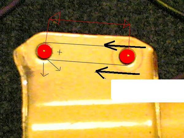

This may sound silly but do I measure the space inside the two bolt holes or start just after the hole, if you get what I mean as it's coming back as 38mm.
Nothing sounds silly if you don't know the answer.
See the attached photos the black lines ignore its just a picture I had to hand. The lines you want to look at are the red ones the red circles are where the bolt goes the distance is between the yellow spots .

Hi Edde, thanks ever so much for that cleared it up fine for me.
The measurment is returning back at just over 2inches which is about 51mm
  Oyster Card
Okay the ruler was out, measured with a Stanley tape measure and it came back at 52mm
