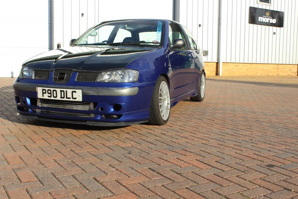

I fitted a manual rack to my track Ibiza and loved it. Was hard around town but shift it was good. Running too much camber tho made it very snatchy if the weight shifted to much, which could be hard catch when really pressing on.
