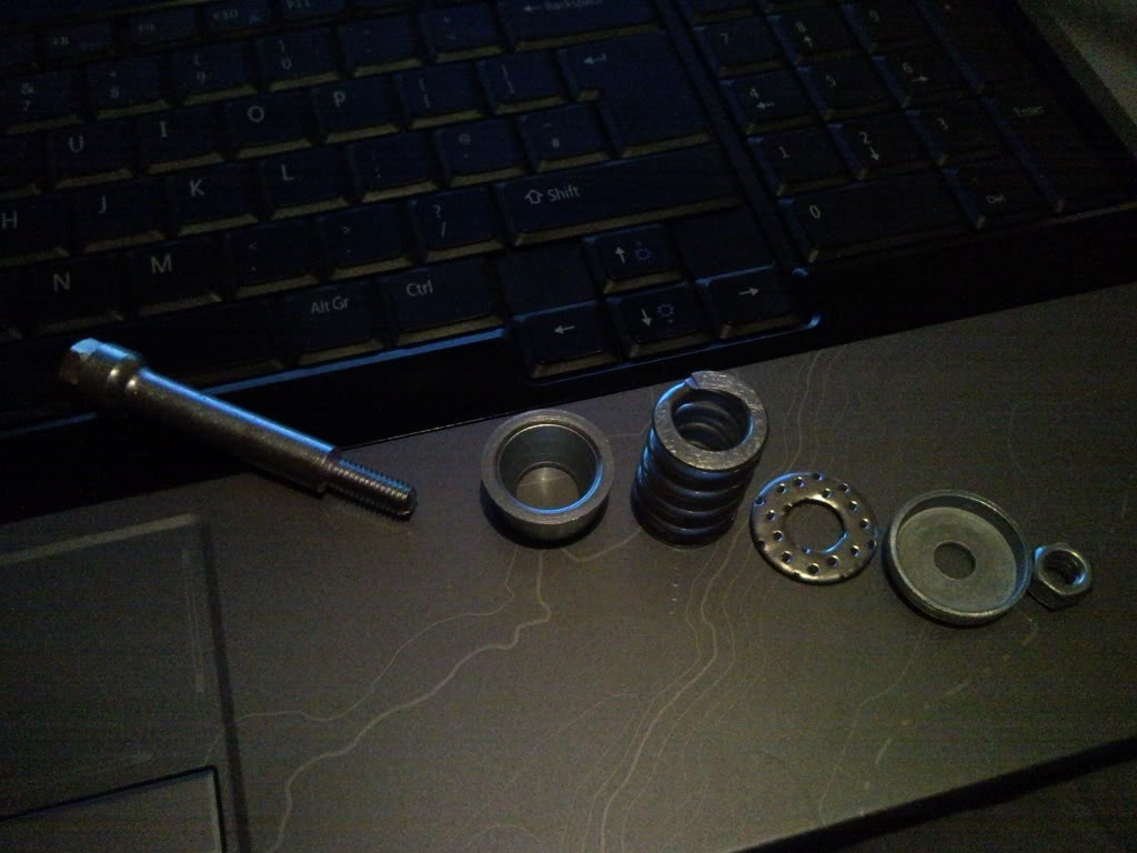

Right here are some pictures.
If I put the deep cup before the mani I cannot get the nut on the bolt.
Here is the standard bolt i took off, compared to the new one... have i put it together right?

Here you can see what I thought you meant by the deep cup before the mani..
http://img.photobucket.com/albums/v466/cragger/IMG_0136.jpg
BUt if i do that, i have this problem,
http://img.photobucket.com/albums/v466/cragger/IMG_0137.jpg
I.e, Do not have enough thread to get the nut on the end!.. I can JUST get it on one bolt, but then there is no chance in hell of getting it on the other.

And finally, This is how the OEM one looked, it fitted perfect and did not have a deep cup, on the manifold side all there is, is the 9mm bolt head nothing else.
http://img.photobucket.com/albums/v466/cragger/IMG_0144.jpg

the old cups are still in the mani ;)
yeah. just need to knock them out with hammer/screwdriver. should be easy on a 182; it's awkward on a 172 as the mani's much shorter

Ah right cheers guys, I presumed the manifold flange was all one piece.
No wonder i couldnt get the nuts on with two cups Hah.
Thanks for the help, will crack on again in the morning.

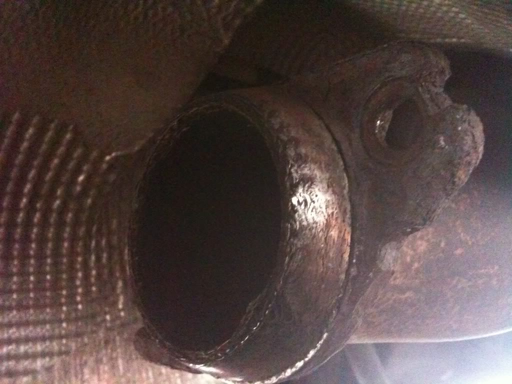

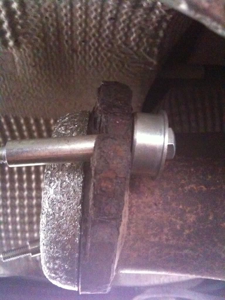

Was getting dark so had to leave it like this for now:
Didn't think the silver bit in the middle (sure it has some fancy name) should be showing? Do I just keep tightening it up to seal it?
Also the new bolts I got were shorter than the original ones so had trouble getting the bolt on the end, is this right? Have reused the old ones for now.

Really? Went for a quick drive and it sounded a bit raspy, maybe the rest of the exhaust is gubbed then!!
Might have another go at fitting the new bolts again tomorrow.
