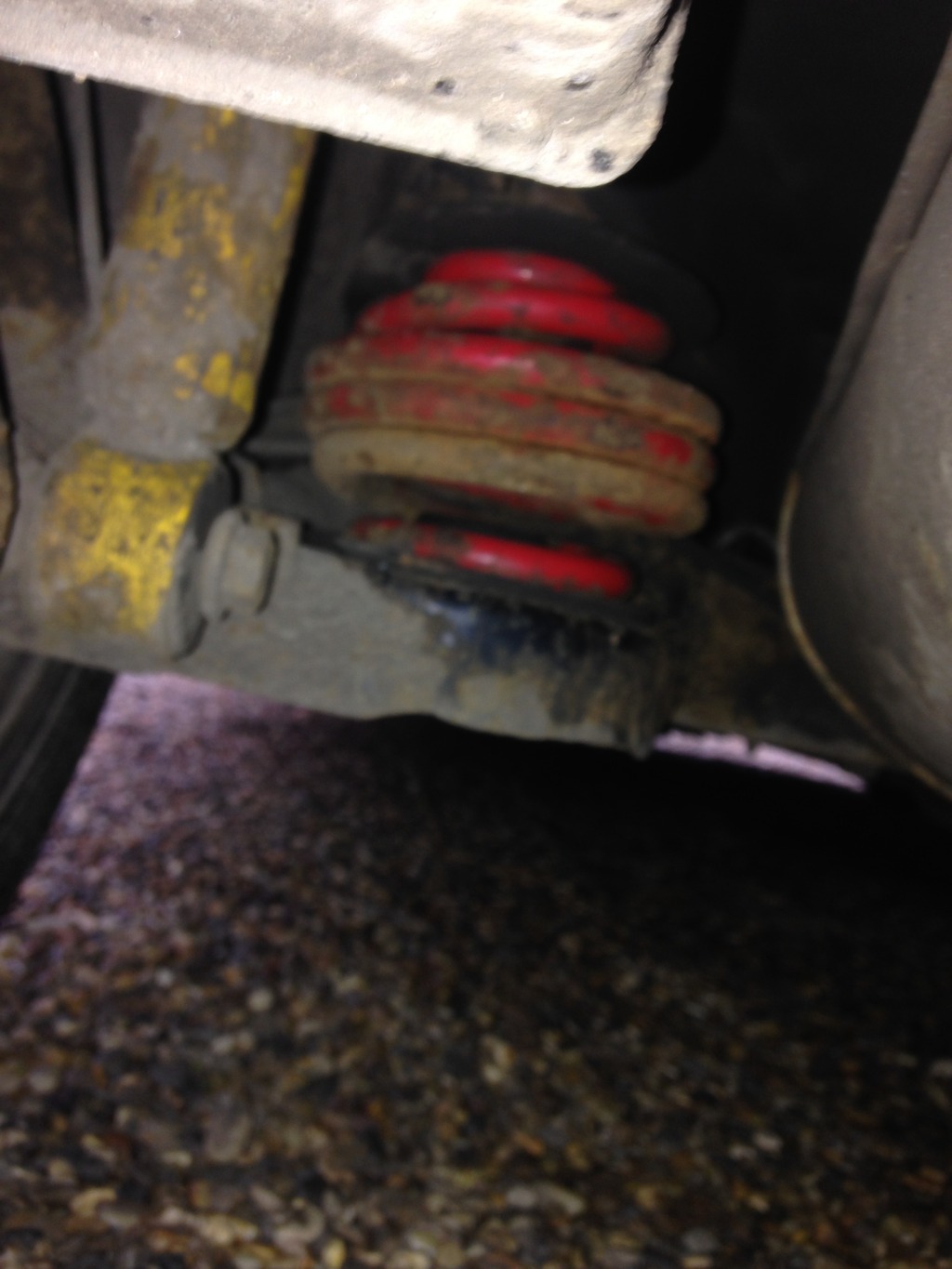

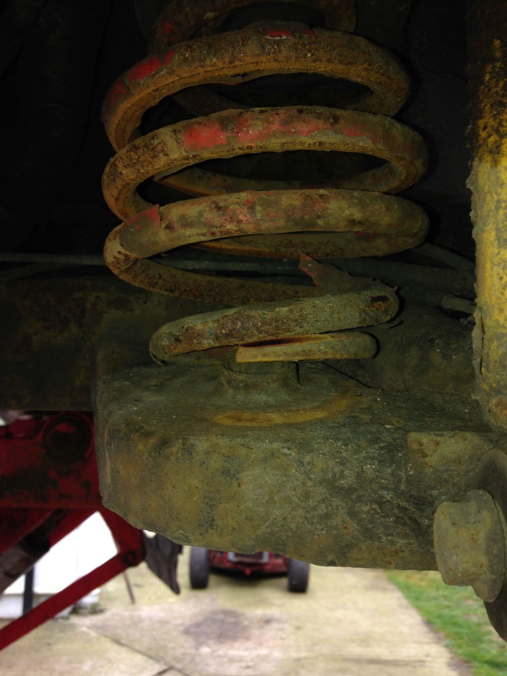

Hi hoping some body can give me some advise about my springs . Yesterday I was doing some work on my car and noticed the rear springs were very lose, infact you could just pull them out, so I would like to know if this is normal for lowering springs? Would it be okay if I was to by some new -40mm springs or is it just going to do the same. Also should I have any rubber/ spring cups or somthing like that or am I missing them as well?

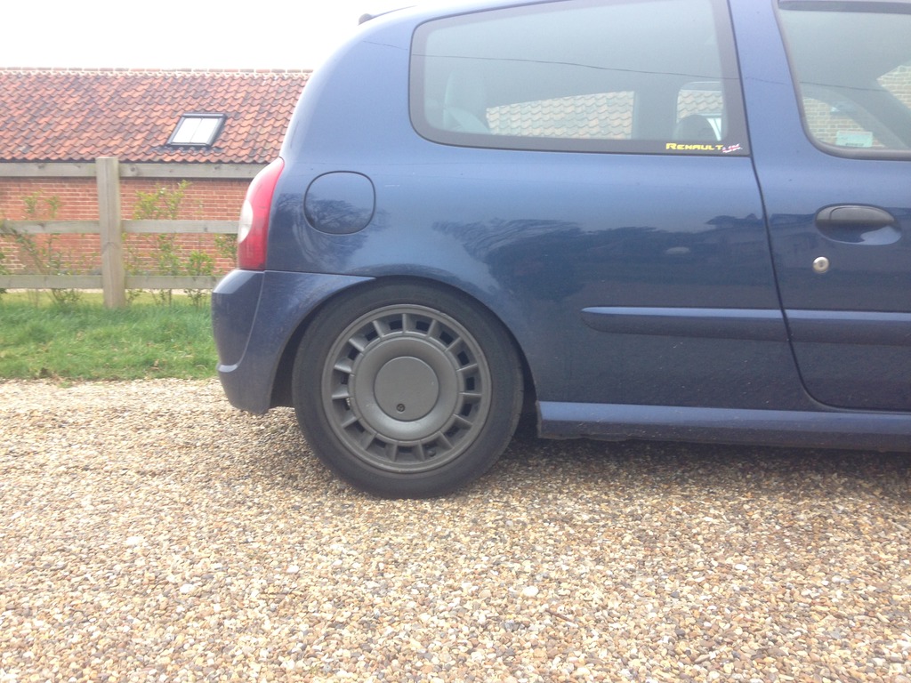

This is how low it is on 15s if this helps

Yes, it's supposed to have rubber spring seats which A) reduce wear & noise by eliminating metal on metal contact and B) stop the spring falling out (lowering springs still aren't the most secure thing you've ever seen even with the rubber spring seats)

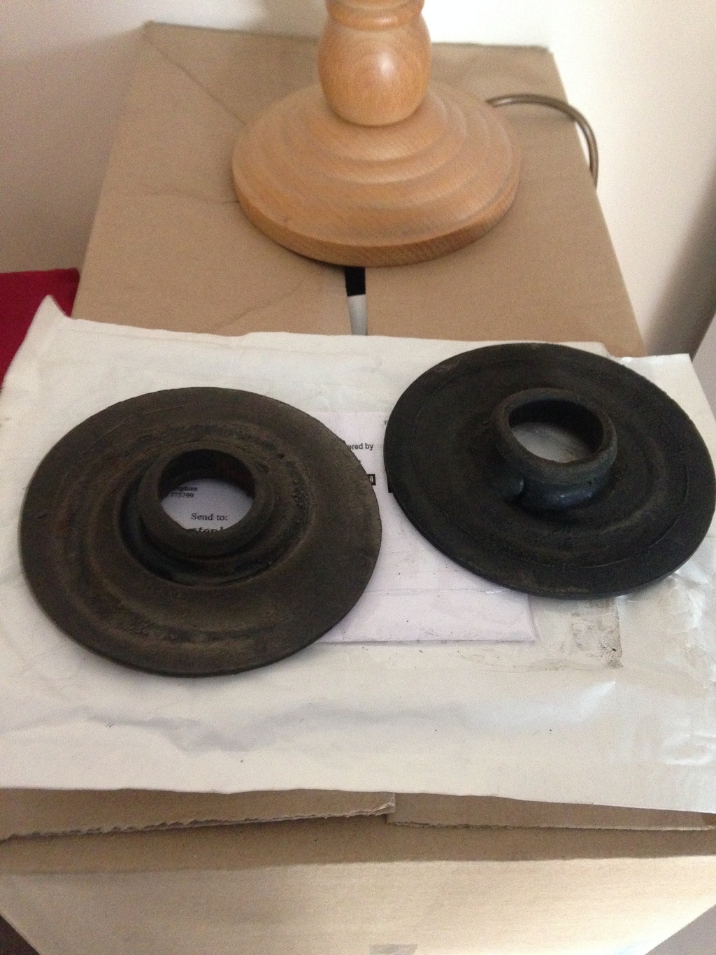

Ah fair enough do u know where I can get some spring seats from then or a picture so I know what in looking for please, as I think in going to try that then get some longer springs if the carats don't help

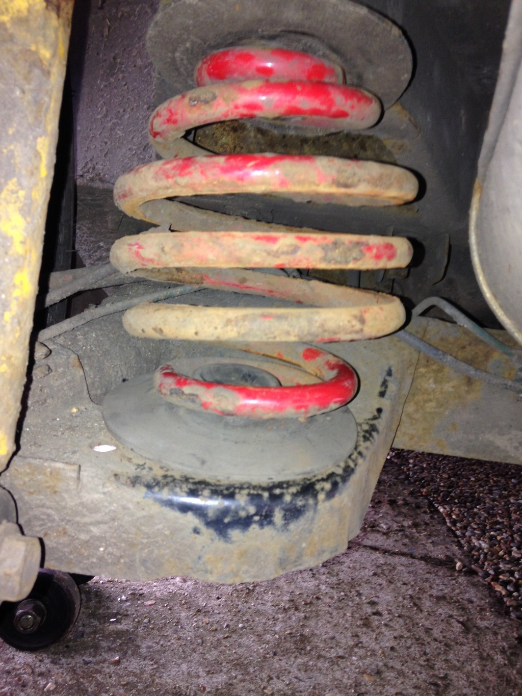

Okay then I manages to find some rubber spring seats off eBay so brought then and there now fitted , how ever after fitting them I noticed when the car is lowered back off the jack the spring is very compressed,- is this because my springs are old and weak, -incorrect for my model clio or are my shocks nakered as well ,

Remove them, check for leaks, push them in and check the resistance and that they return.. If they do they're ok..
If not they're fcked...
