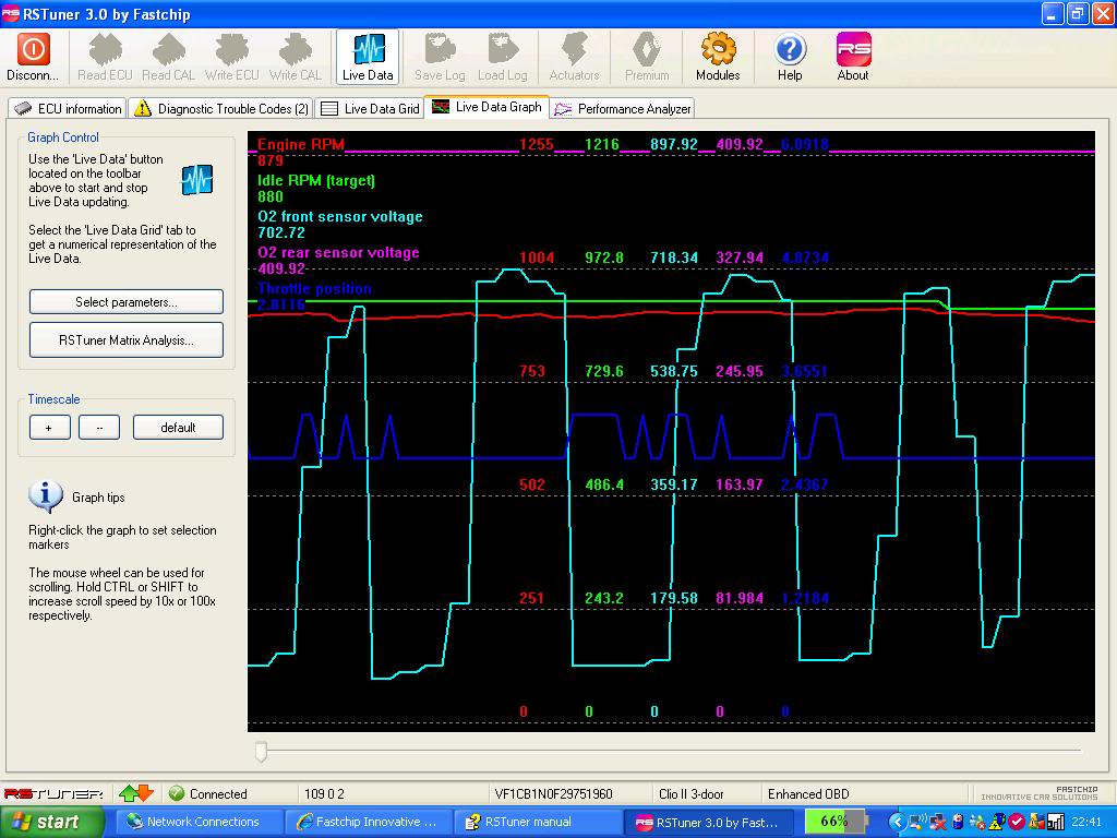

just bought my rs tuner and before unlocking it I wanted to plug it in to see how it works. but when I click on the live data button the rs tuner shuts down with an error - rs tuner has encountered a problem and needs to close..
any thoughts on this?
ripp
  182 FFAT
yes I made the update. it works now after I selected only about 15 parameters to be shown. I also encountered some problems when connecting to the ecu ("connection to the ECU could not been established" or smth like that) but after a system reboot this issue went away.
Henk, you will receive an email when I will request my unlock code along with the cal and rst files ;)
