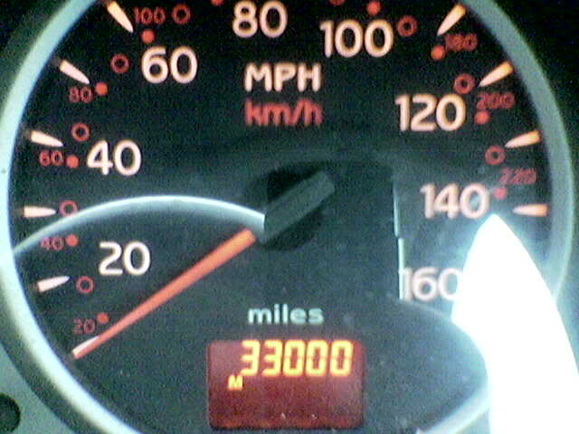

On a seperate note, it's my cars 33'000 birthday today! :D
