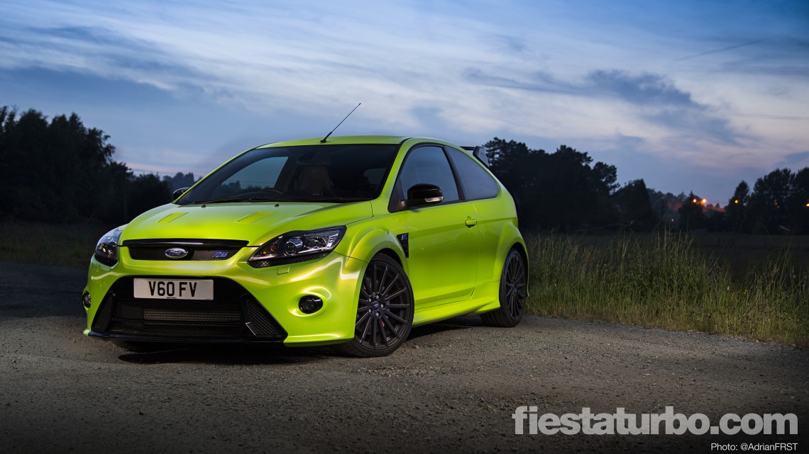

Went out for some experimentation last night. Not a great location, just out of the way and close to home. First up, strobes. 3x Canon Speedlight 600s:

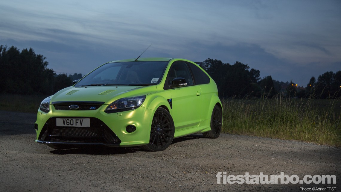

Then light painted with an LED video light:
It's a bit patchy in places and I had to clone a few bits where the light lines were too visible but I know for next time.
These two have the exact same raw conversion settings, except saturation on the sky on the second, the green of the car is the same - it's mad how much the light painting makes the colour pop!

I should have mentioned that the strobe shot is a single regular exposure with all three firing at once. The LED one is multiples, around five at 5-10 seconds each.
The second one is loads better. The first one doesn't really look that light painted in all honesty. But like Naill said, there are dark patches that take away from it a little. With that said, you can really see the potential in the second method.

Sorry, the first shot isn't light painted - it's regular strobes and a single shot hence why it looks that way.
This was around dusk so not pitch black. I think I finished about 10pm and it still wasn't totally dark then.

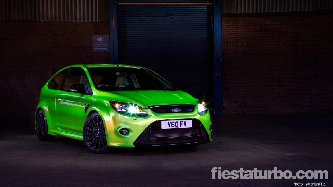

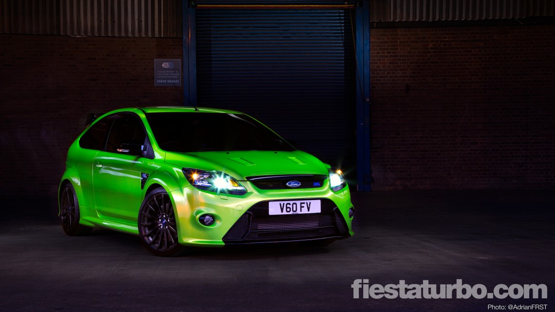

Here's last nights attempt.
Took an exposure with the headlights on and blended that in. Works quite well, and being a separate layer it's simple to adjust the intensity of the headlights.
Still some messy streaks and it's a bit dark overall but I reckon once nailed, this method should be capable of some pretty spectacular results :D

If you do a single exposure two things happen which aren't ideal - more ambient light leaks in and you "overspill" light into areas you don't want to paint. You get more control with multiples but it takes longer and require more time in PS. These ones I'm doing multiples as I'm trying to get the best results regardless of time. I'm fairly handy with PS so that's a bonus too.
I reckon if you added some more light on the wheels and possibly a flash inside to properly expose the interior, that recent shot would be nigh on perfect.
Good call! I managed to get a bit of an interior from another exposure, it's a bit grainy up close but looks passable when at web size. I also redid the wheels, the back one is not perfect, even when pulling the shadows in the raw there just isn't enough light there.
I also tried to fix the orange a bit. I had to clone lots of small orange spots out as well - I think reflected from a street light way over the other side of the road. More darkness needed!
