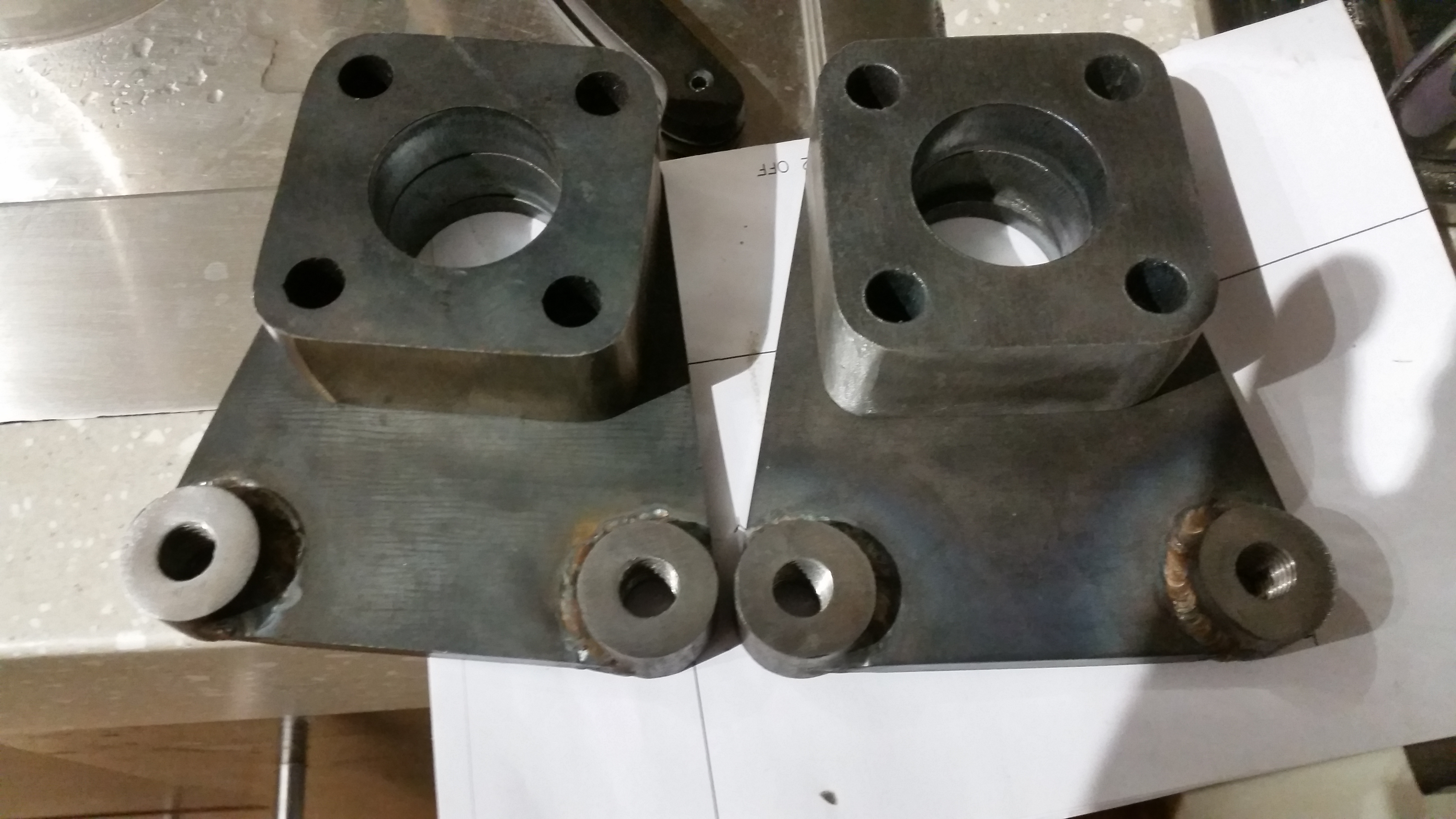

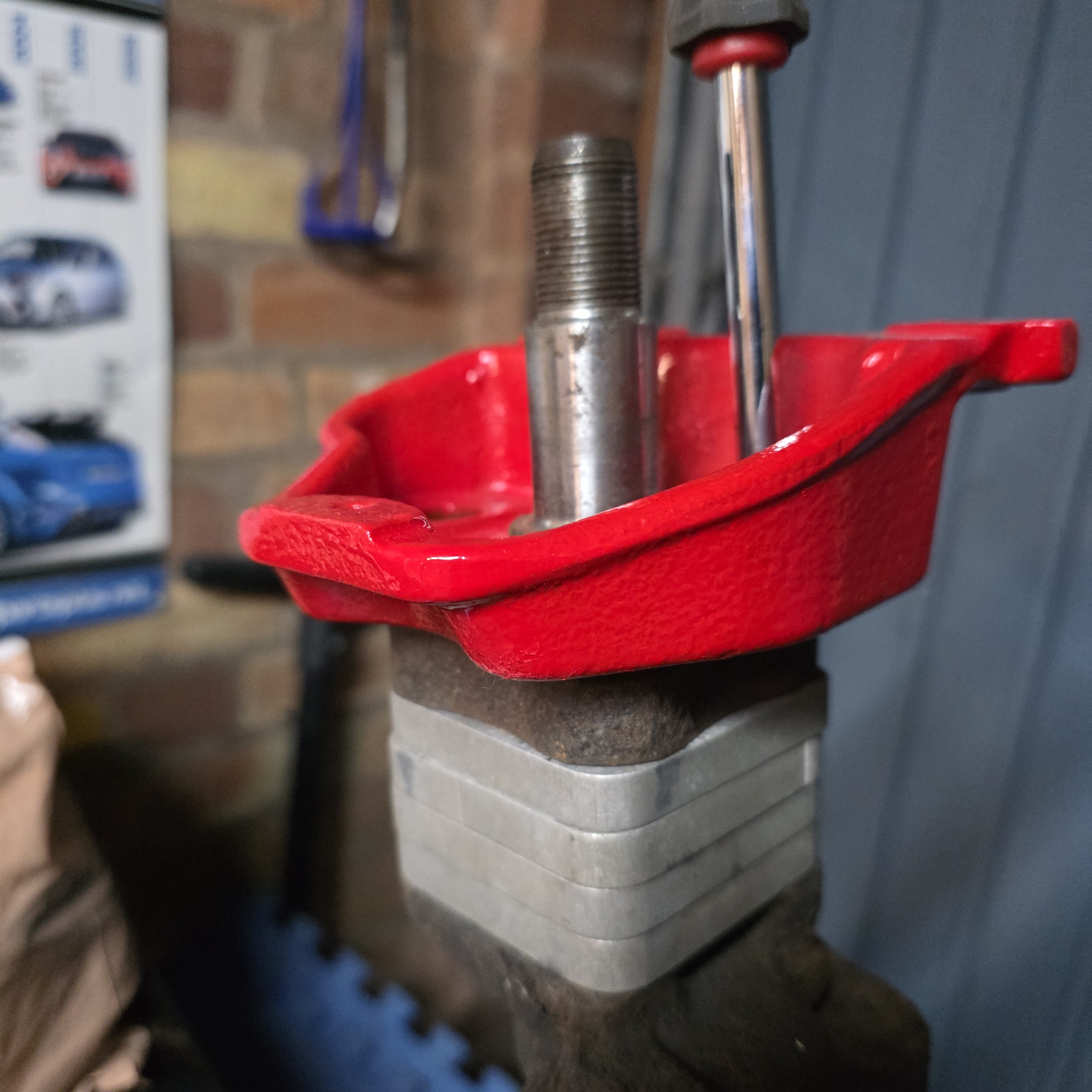

yes they push out inwards.. i needed a 20 tonne press and 2 people to steady itHow did you get the mk1 rear stub axles out? Does it go back through away from where the wheel would be?
The mk1 stub axle seems to be part of the rear beam?
