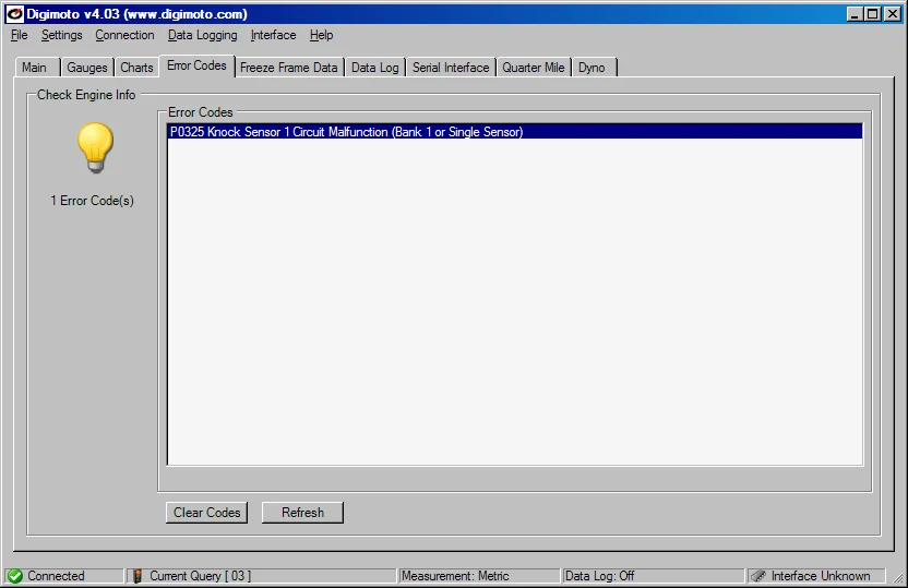

My emission warning light came on yesterday, and after plugging the car into a generic ODB reader, this was the outcome.
P0325 Knock sensor 1 malfunction (bank 1 or single sensor)
The code was cleared, and the light hasnt come back on in 40 miles...Now my dad, a mechanic of 30+ years explained what this is, and reckons that aslong as the light doesn't come back on it should be fine.
