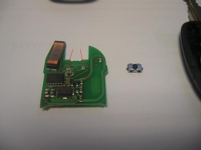

The key needs reprogramming on a clip diagnostic computer. If this fails its more than likely the switch on the circuit board has broke free from its solder and isnt functioning correctly. They can sometimes be repaired by a nimble fingered auto electrician. If this doesnt work it will need new keys.

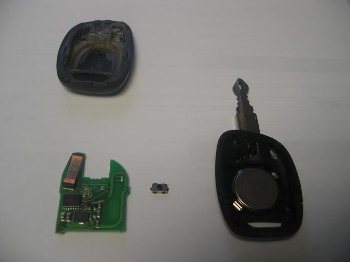

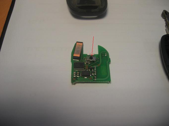

heres a few pics of the internal fault - this is the thumb switch that controls the locking and unlocking of the car

I can re-solder the keys providing you still have the tiny micro-button as mentioned by Matt.
Freebone, yours has probably lost the little button I'm referring to, however if you've tried swapping the battery chances are that the button will have fallen out and be lost forever. :dapprove:
