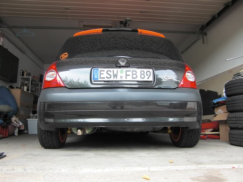

Any issues with the tail pipe sitting too low?
I think it sitting good as well...
here's a Picture from behind
Can't you get an exhaust place to modify the exhaust hanger or anything?
Anyone have a stealth system on a non sport that fits good or are they all like it?

Iv got a stealth on mine and id doesnt sit that low..you can still see it but not that much. If you loosen the U clamp which connects the backbox and then twist the backbox and tighten it, it will sit higher :)

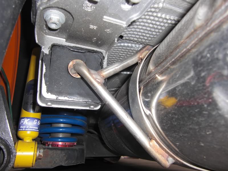

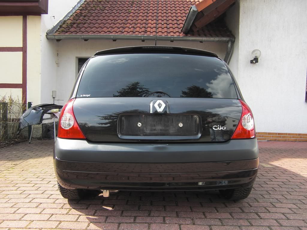

Have you a Picture? I have modify my hanger with "bodyglue".

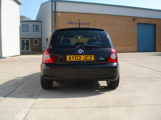

Here's my 'stealth'. Real ballache to get sitting right - you can still see it poking out the bottom of the bumper.
Decatted too. Stinks of petrol & sounds sh*t :cool:

It sits that low because it is so heavy, you have to pack the mount with sockets and cable tie them in, even then it's difficult to get it flush.
