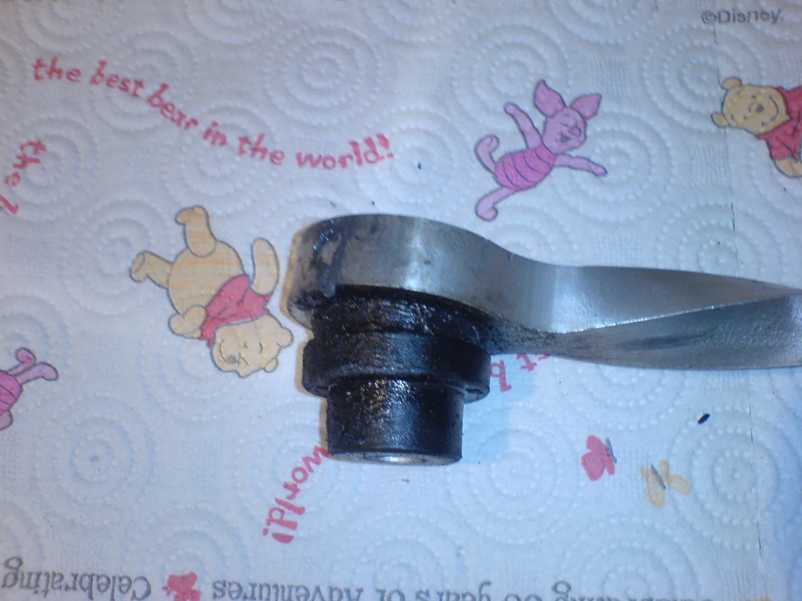

Took about 2 hours as there was a b*****d bolt that wouldnt loosen without extreme persuation, and the big rubber bush on it was a git to remove. The mount was quite worn by the looks of it. took some pics before/after .. looks much better ;)

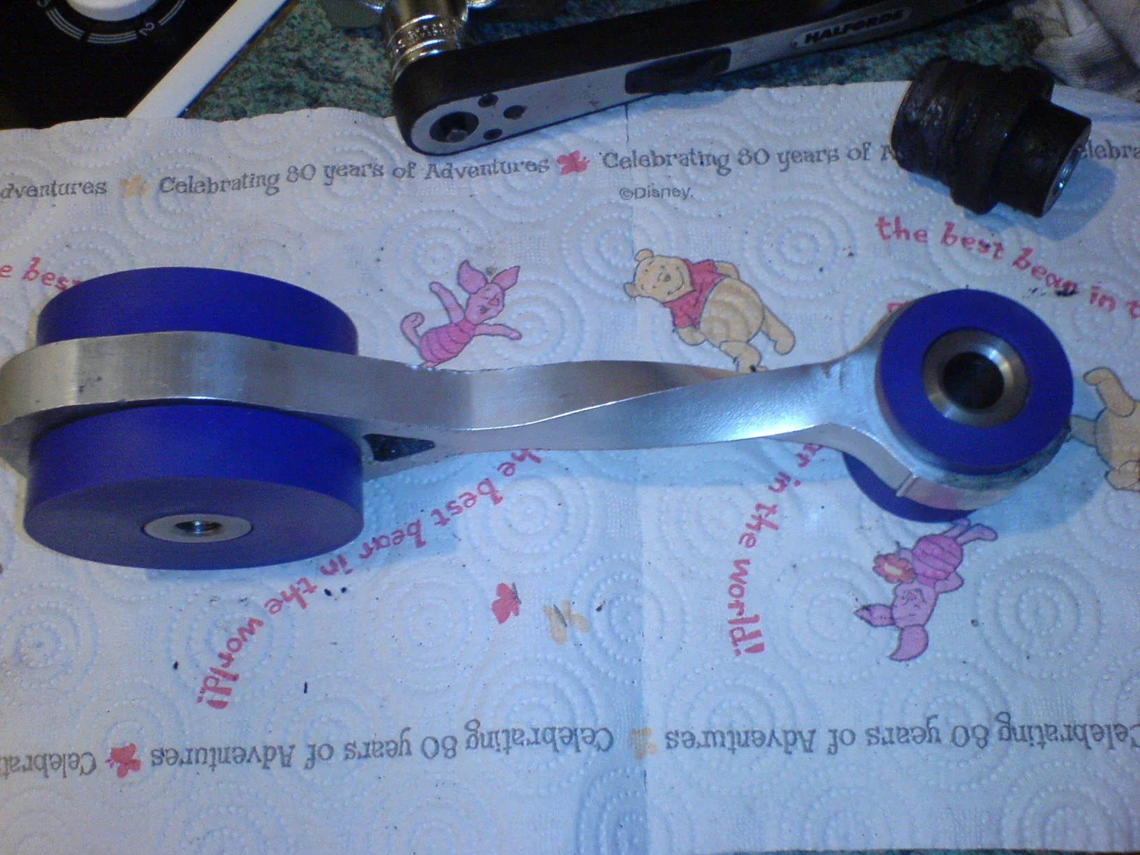

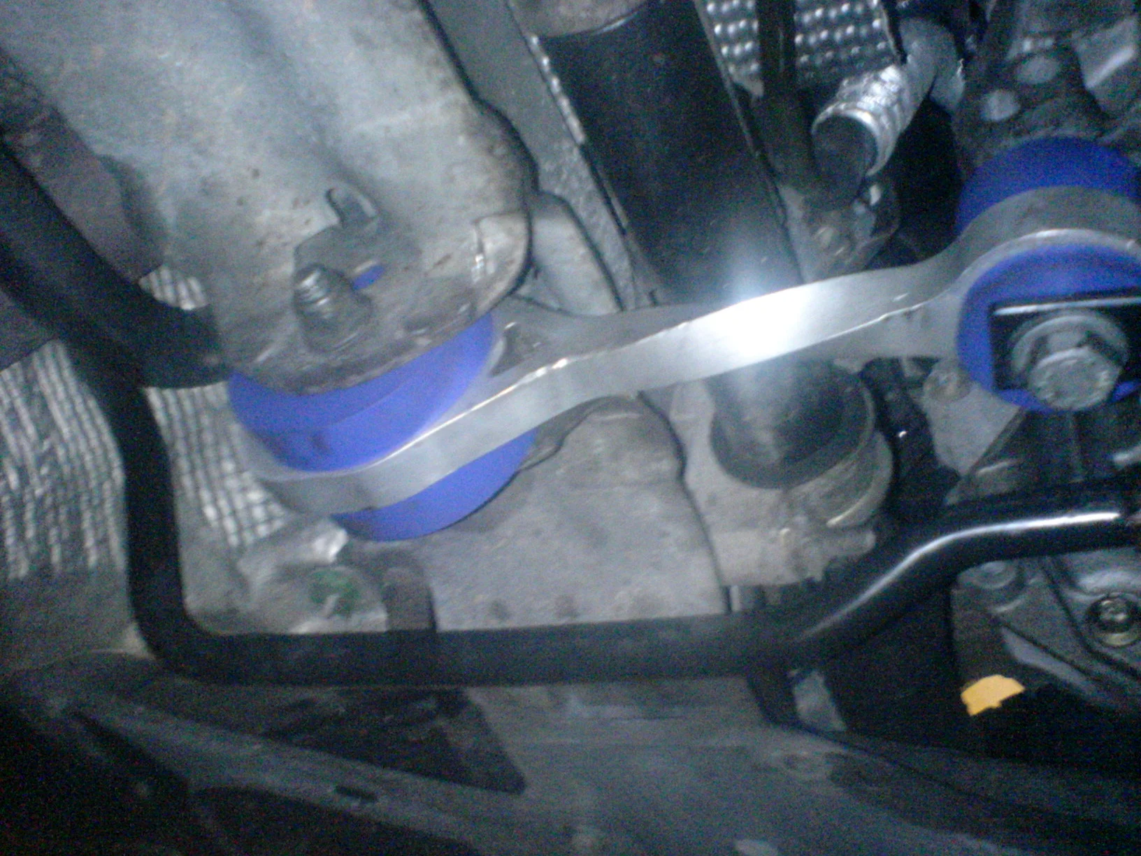

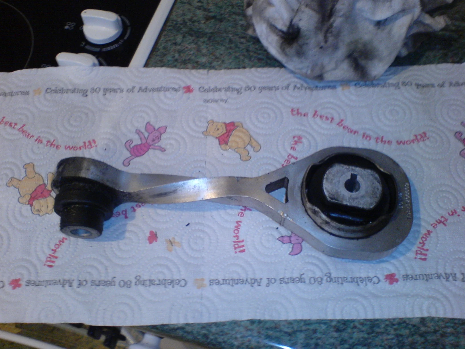

1st pic you can clearly see the dog bone wasnt sitting correctly on the bush.. it was actually on the car like that.. 2nd pic shows the full thing removed. 3rd pic shows the new powerflex bushes in place, 4th pic shows it fitted.
The new ball joint got rid of that annoying clunking sound when turning and going over a small pothole, but the dog bone mount has made a huge difference, there is no engine banging at all no matter what I try to do to get it to bang ! I also had a funny noise when accelerating quickly (but not floored) that sounded like a tyre loosing grip even though it wasnt, this is now completly cured aswell. As previously stated in other threads you do get a bit more vibration when at idle comming through the car as the mount is much stiffer but nothing major..
