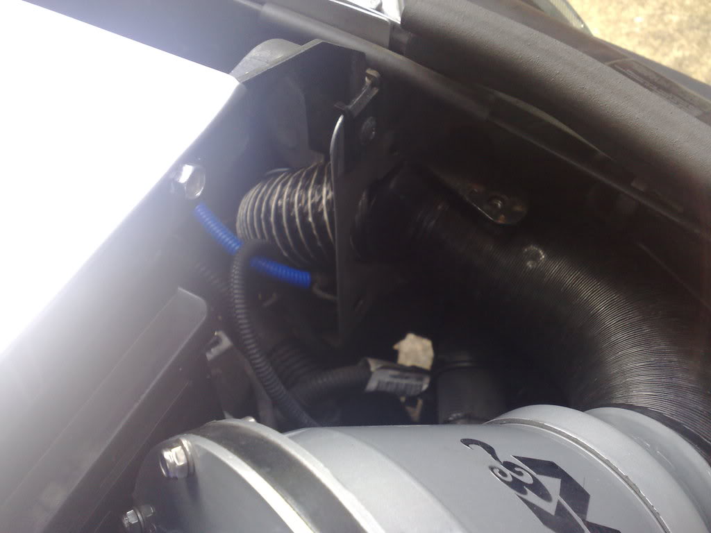

i have take a pic to show you that i have nothing for it to connect too...
also how could i improve my caf??
  b/g 182, meg tourer
just run the caf to the upper grille, plenty of cold air there.
there is a nut that screws into the side of the engine block that the bracket screws into. hang on... i will edit your pic as a diagram
  b/g 182, meg tourer
look for a space in the upper grille and just bend the pipe towards it, tucking it close up to the grille. there should be some spacde for it up there. you may need to cut some off the length of the pipe tho

just looked at my bay and the only place that i can see that is suitable for it is upper grille (driver side) or lower grille (passenger side) or where you have it fitted. in such a small bay its hard to run a feed anywhere!

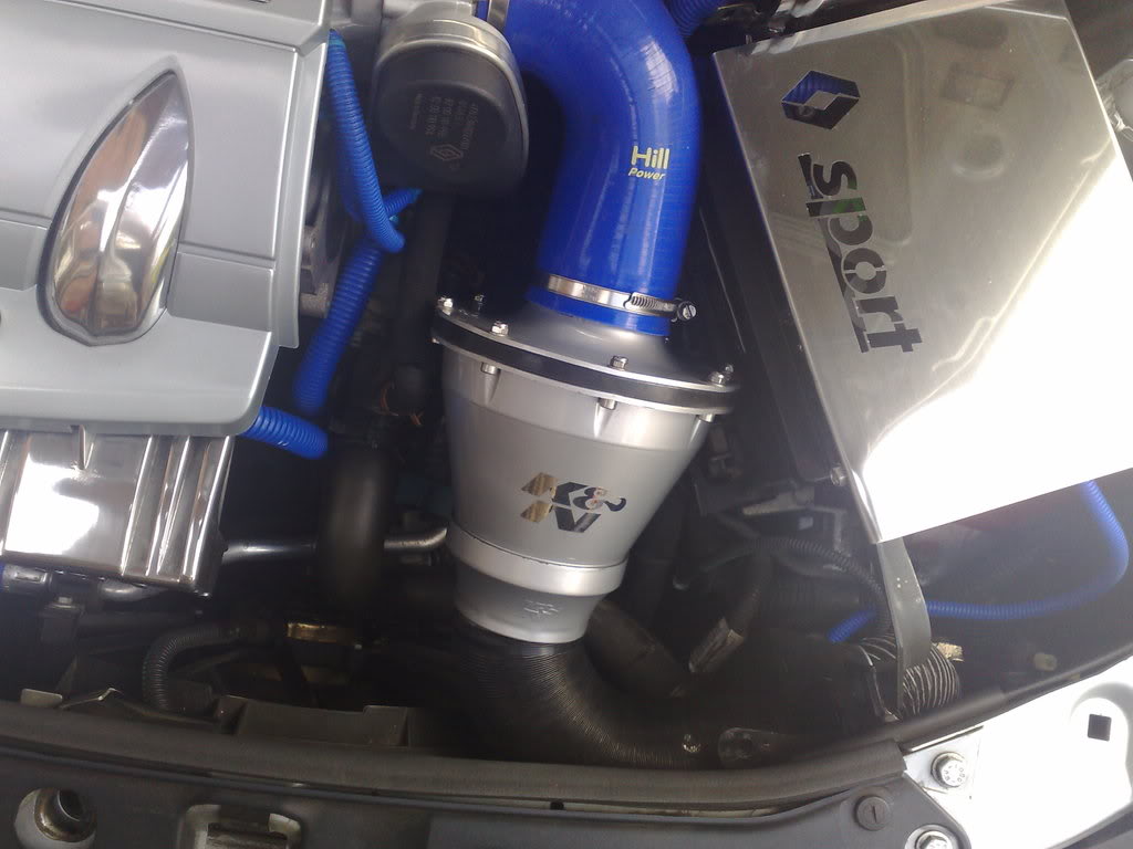

Ewww what a horrible setup lol, Your never gunna get a decent feed there just look at all those restrictive bends, id either put a phase one airbox on or relocate the battery to the boot and put a straight feed on the K-N
Ps you might make it a little better if you trim the samco bend down a bit.
