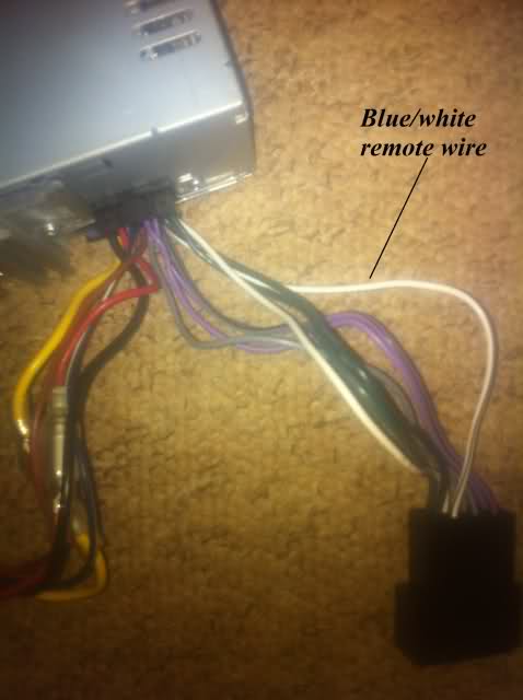

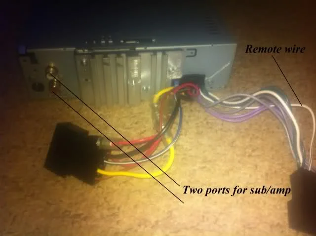

Hi guys, im a complete noob with audio and im fitting my own sub and amp i have got all the main cables in just having a small issue with connecting the remote wire, i cant find anything on the internet, i thought there would be a port to connect my amp remote wire into and crimp it but as you can see from the pictures the wire is connected into two connecters and i have no idea how to connect my amp wire to this one (blue and white) its a jvc head unit heres some pics, help would be much appreciated!

Who said that the white/blue wire your indicating is the 'remote feed', just the majority of HU's ive fitted the remote is blue - and big give away... on the power iso, not speaker iso terminal, whats the model of the headunit? JVX XXXX?
The one youve got indicated looks awfly like speakers (thus + & - wires)
The wire you've highlighted as being the remote wire is not the remote wire. That's the negative Front Left speaker wire.
On the other black block, there is an actual blue and white wire. Use that one.

hi guys thanks for all your info, i will be sure to go onto the opposite connector wire! my head unit is a JVC KD-R401, so how do i connect this wire? i would really appreciate some help tonight as tonight is my only free night and really want to install it tonight :( thanks guys

Remotes are normally blue wires, off the power block. Normally you get 2 blocks out of the HU - sound and power. The remote is normally always off the power ISO.

no manual unfortunately, im pretty sure its the blue and white wire in the other connector (not the one i labelled) just stuck on how to connect the one from the amp to this wire :/

Might be of some help. Can't find any pics online to show you what I mean.
Mine has a female bullet on the HU wiring loom, so obviously I've got a male bullet on one end of my remote wire, and then it's a spade to fit the amp end.

jvc dont supply a dedicated remote wire on more basic models, the blue/white wire (clustered with the red/yellow/black) is your remote/antenna wire

Have you definitely connected the Phono leads properly? (The red/white plugs on head unit and on sub)
On your Amp. You will have three inputs for power +ve REM -ve
+ve = connected direct to your battery (big red wire)
REM = connected to your white/blue wire on headunit (normally thin blue speaker wire size)
-ve = connected to the chassis, using a bolt, to ground the amp.
The Phono leads (red and white) Need to be connected to the input red/white ports on your amp, and the red/white ports on your headunit.
