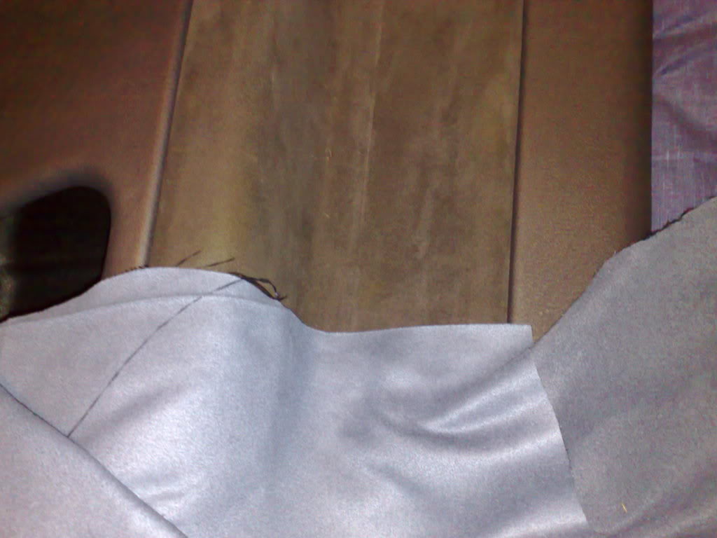

I've cleaned my throttle body today with the Hycote carb cleaner and whilst my bmc was off i cleaned that aswell and all i can say is WOW my car feel's much better it run's smoother and pull's like a train again :D
This came out of the bmc lol
Cheer's for the head's up
